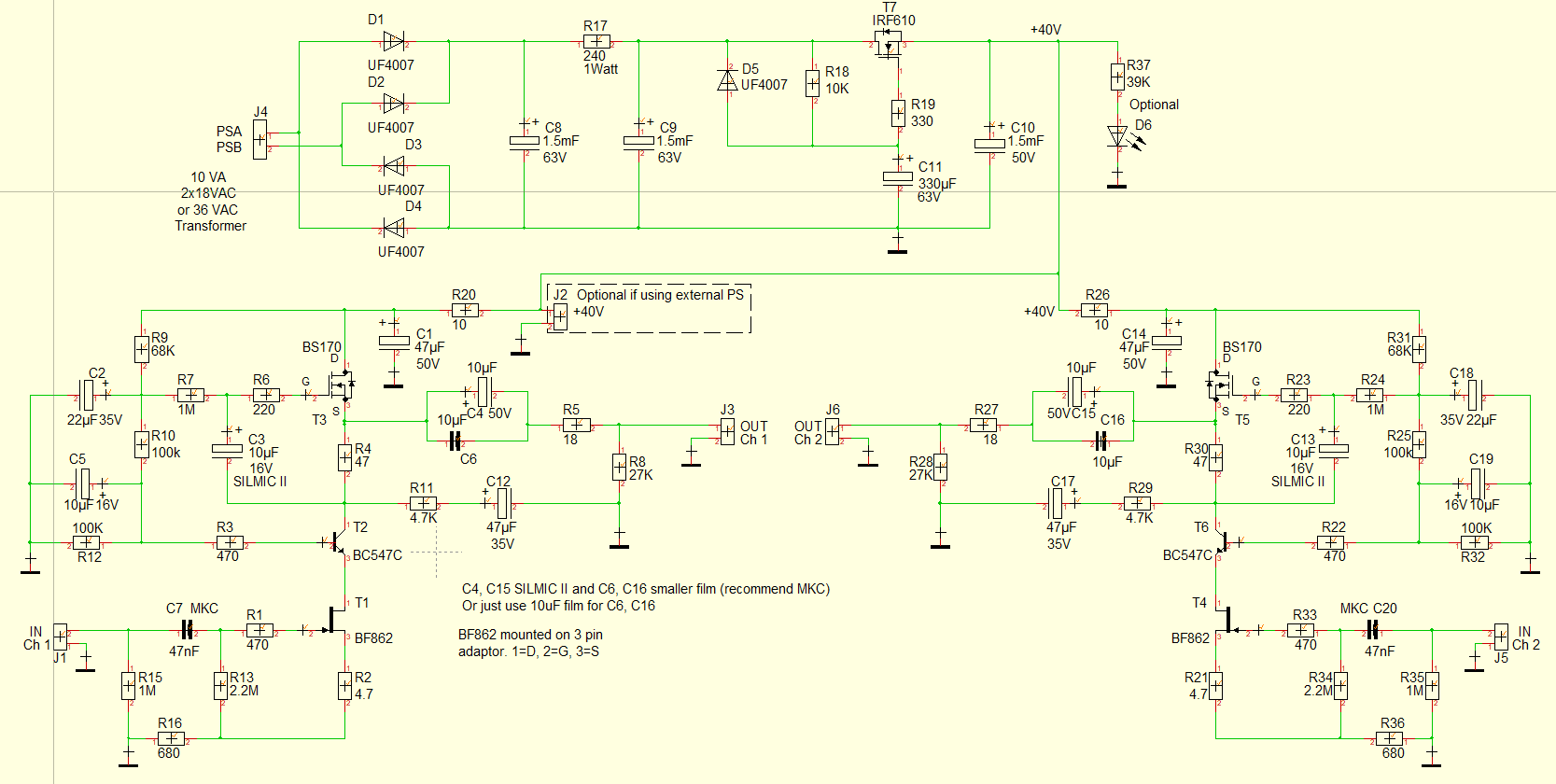

Hi Gregje, I was curious so did a sim on the cicuit. the gate stopper 220 ohm on the BS170 seems to be the largest contributor to noise in the circuit at around 80nV/hz in the sim... Note that I'm getting poor distortion performance much worse than what Juma reported, so the sim's value could be questionable.
edit: the 47R on collector of the bc550 also contributes around 30nV/Hz, the 47K around 8nV/Hz.
Perhaps replacing these with some high quality low noise resistors will help. Something like vishay dale cmf55's, probably worth a shot, especially if you are just using some generic resistors here,

I lowered the 4.7 ohm resistor to 2.2 ohms in the sim (as per a previous post by Juma for reducing distortion) and the distortion in the sim became a lot more reasonable, so the noise results may also be reasonable.
Reducing the value of the gate stopper 220 on the bs170 also reduced the noise in the sim, but I don't know how low you can go without risking instability.

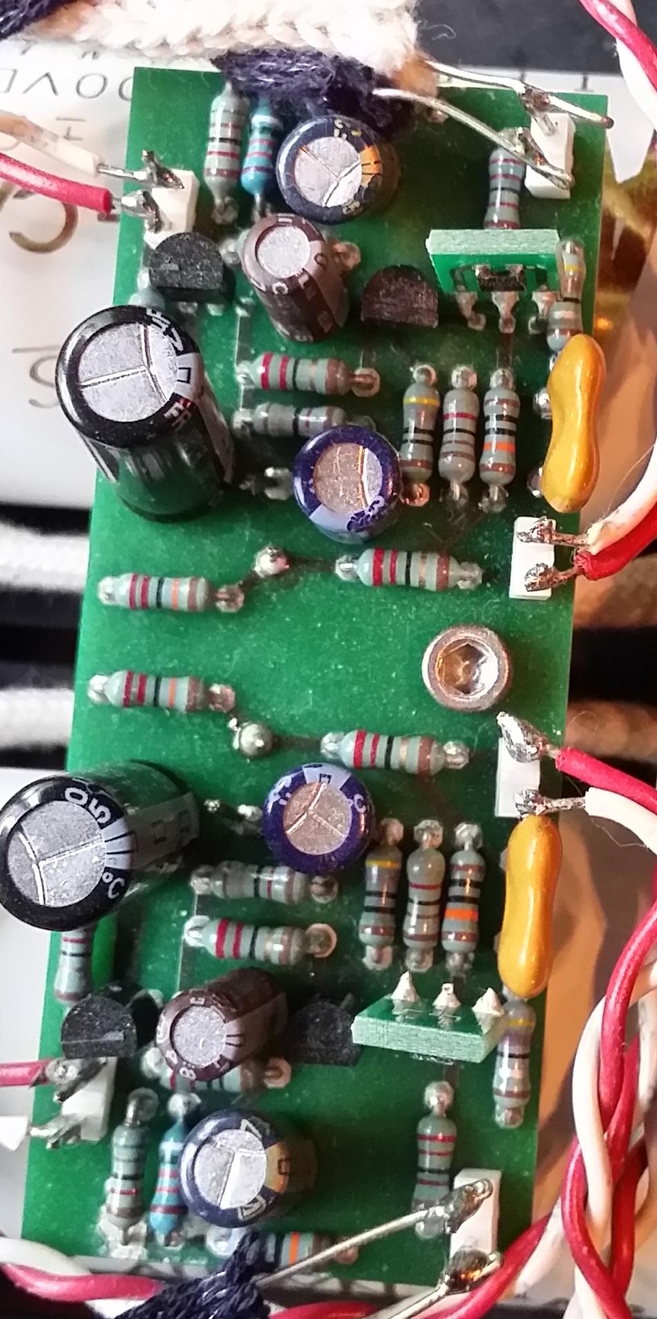

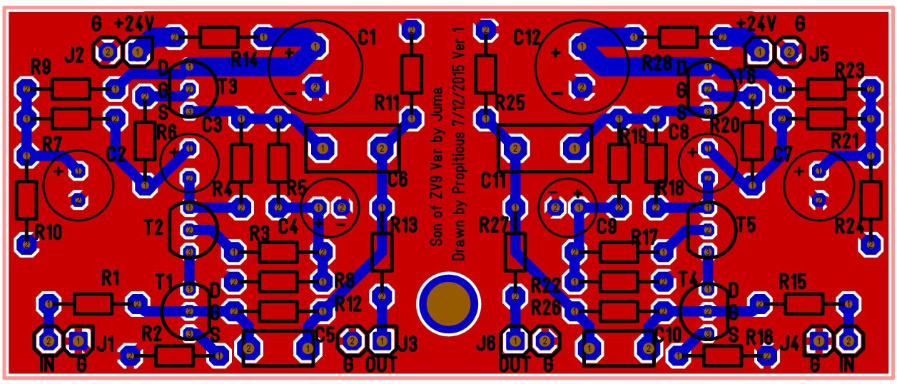

Hi Gregje: I was thinking that you might be interested in building the ver 1 of juma's preamp. As juma said, the ver 1 will like it better being set to 6 dB of gain, since that is all the gain you want/need. Below, in the pic of my build, the output caps are below. The sound is excellent. It is definitely better than coming straight from a D/A to the Aleph J. I replaced the Aleph J with a Cubie3 and it sounds even better to me. The bottom layer, shown in red, is a ground plane. If you are interested, I can email you the xgerber zip file. On the prototype pcb I had build, I forgot to check "Include top layer silkscreen", but it is there in the file. You can have a prototype pcb build at a low cost at PCB Pool in Ireland, I think, which is where I had that pcb made.

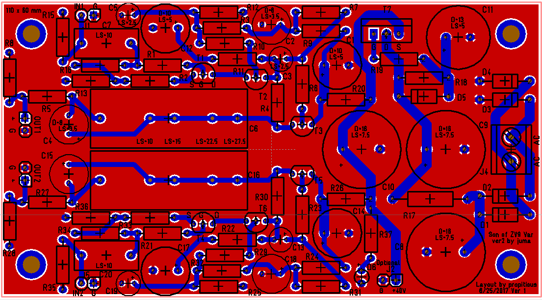

Someone else asked me for gerber files for version 1 that I drew. I thought I should say that I just finished drawing up a pcb for ver 2, which includes the power supply on a 110 x 60 mm pcb. I am about to get a prototype made to try out the design. So you might want to wait until then for this ver 2. It will accommodate different size output caps. For PS caps, I plan to use 1mF, low esr Panasonic, Nichicon, etc., though use any good cap larger if you want, if it fits. I put lead spacing sizes on the pcb. The bottom layer, shown in red, is a ground plane. A person may use the board with their own PS if desired.

I have found the source of the noise!
These were 1M resistors at the gate of BS170...
Replaced them with new 1% precision 50ppm/K.
Before that I looked at 1M and 2M at the input but these did not have much effect on the noise.
What exactly is the purpose of these resistors? Cannot the 220Ohm gate stopper resistor take the reference voltage from the voltage divider R22/R23?
