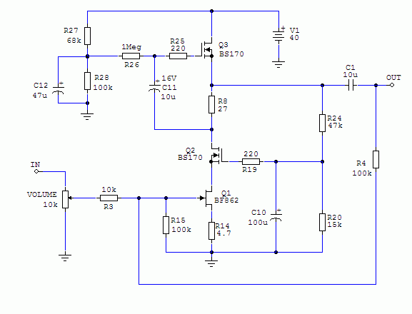

Gyrator loaded Son of ZV9/F3
Sorry Juma
The schematics in post #24 but I solder 10Ω on V+ like in post #37 on each channel just to verify the current. So on one channel across the 10Ω resistor I measure 10 mA (0,108V) and on the other 20mA (0,199V)
I'll start to check voltage nodes.
Bye
The current depends on Idss of bf862 so your Q3 in one channel is very different from the JFET in other channel.
You should either use parts with same/similar Idss or increase the value of R3 to lower the current to 10mA.
Using similar JFETs is a better solution.

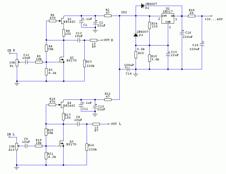

You want J310 with occasional BJT to deliver clean and high voltage swing to drive the unity gain power amp - it's a no go here; J310 can not easily replace neither BF862 nor BS170 in this circuit, it's too different.
It would have to be a whole new circuit and I would have to build a prototype to test it. I could do it on commission but it would cost you much more than few pennies for appropriate parts. 😀
Actually, for your needs, this (see attachment) is safest bet, stick to it ; #24 is too specific, no fooling around with it.
In attached circuit, you can use J310 instead BF862, but R14 should be 220R or so (for Id of 10mA or so), R20 should be 22k or so, and R27 should change to 56k. It will sound different, try it to find out if you like it

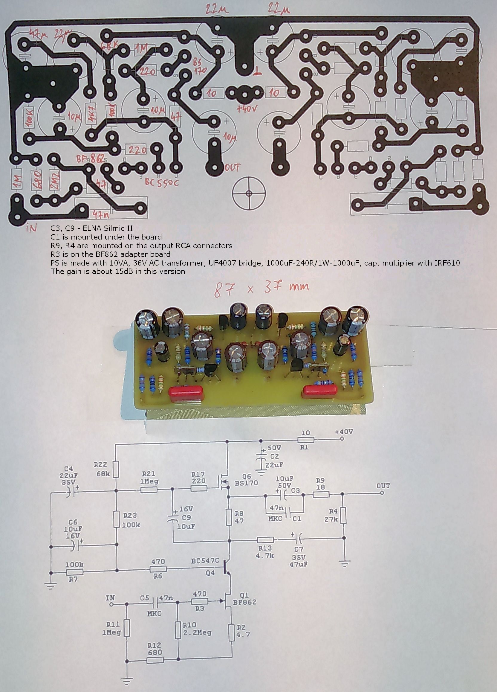

Well I finish
Hello Juma
Finally I found them. Two jfet one 15,93 mA and the next 16.2 mA. The preamp sound very good. Round with B'52 rude with Ramones and sweet with the radio. My son love it
Thanks Juma

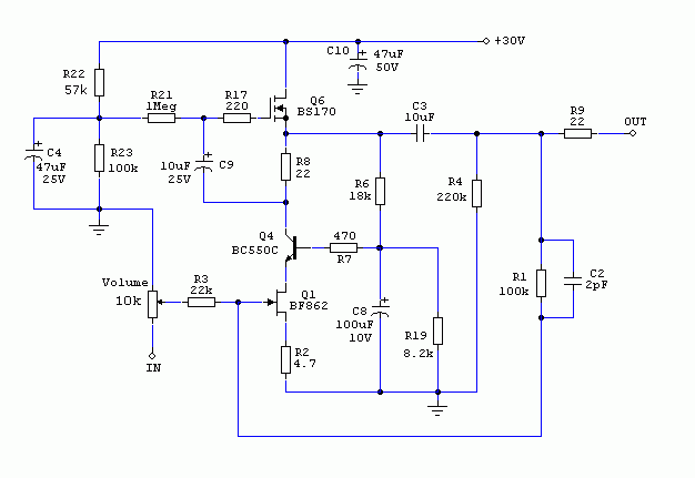

do you have the last schema of the Jfet BOZ with J310?
what is the gain and output impedance?
Can it be tweaked for 1K output impedance and still sound good?
Maybe using BF861C with higher Idss and lowering the Drain resistor
I need medium gain and low output Z

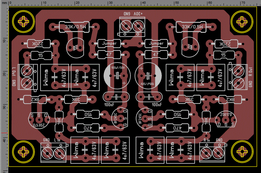

Juma,maybe i am offtopic but some years ago i found this schematic of yours on the net but i have no info about it and i cant remember where i found it.Is there a dedicated thread with info on sounding impressions,improvements (if any)and comments etc.?
It's a small MOSFET, common source connected, loaded with a CCS (JFET). Gain is defined through local, Schade feedback (R4/R5 ratio). R3 sets the Drain of Q2 at half of the power supply voltage. Any usual CCS (at about 10mA) can be used instead of JFET.
It sounds OK - I like the circuit from post #1 of this thread better, but it's easy and cheap to try both and decide for yourself... :cheers:
Thank you.I made a layout(not tested for errors yet) for this small MOSFET version to test.I read all posts from this thread and i saw on post #37 that you made an other version of schematic from post #1.Between those 2 schematics (post#1 and post#37) which one you like most in terms of sound?
