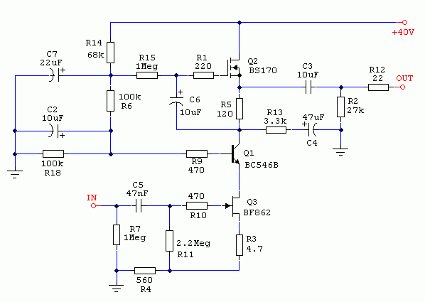

I've been doing some more work on this circuit to improve further it's sound and characteristics.
Now the feedback loop is gone and the input impedance is much higher (about 680k) while the Zout is still low (less than 50 R). The gain is about 14 dB and it depends on R4 and R13. R4 degenerates the JFET and R13 loads the gain stage, so more load (lower value of R13) and/or more degeneration (higher value of R4) means less gain, and vice versa. Practical values would be 1k5/680R for about 6dB gain and 3k9/330R for about 20dB.
Power supply voltage is somewhat higher (40V). Max output is about 9V_rms at 10k load. Current consumption is about 11mA and it depends on BF862's Idss. If your BF862 has Idss higher than 16mA make R3=10 R or so. The input cap is introduced (I use WIMA MKC) because JFET's gate sits at about 6V but since it is of a small value it's not of a great importance.

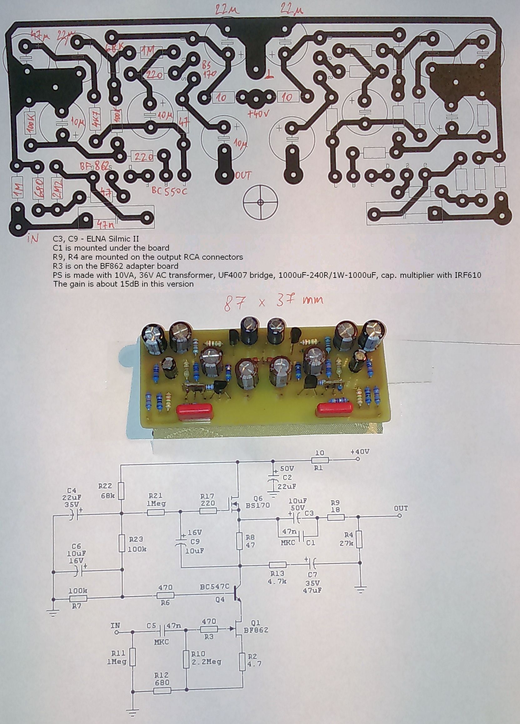

For the circuit in post #24 I use 10VA 2 x 18V~ transformer with secondaries connected in series which gives about +50V after rectification. The simple regulator follows - same as usual MOSFET cap multiplier with a small addition: 3 x 15V zeners connected in series, from gate to ground and a 5mA CCS from drain to gate to feed the zeners. That gives about +41V at the source pin.

A couple of questions if you have time:
Regarding the C3 output cap: why so large? Do you have a power amp with unusually low impedance? Even for 40k input impedance, 2uF should be fine (-3 db point at 2hz). Or am I missing something?..
Regarding voltage swing: If I wanted a bit more in reserve, could I increase rails to 50V without any other changes? (While keeping an eye on power dissipation of transistors).
Thanks :)
10k is not an unusual input impedance in the world of amplifiers and 10u is just OK in such a case. Coupling cap is not only about freq. response but also about phase shift it might bring in. And that can be clearly heard.
Changing the PS voltage to +50V for the circuit from the post #24 is not trivial. Besides recalculating the voltage divider values, more powerful cascode BJT had to be used which means upsetting a few parameters. Small MOSFET could be used in that position too but a change like that needs prototyping a new circuit and testing its performance too.
