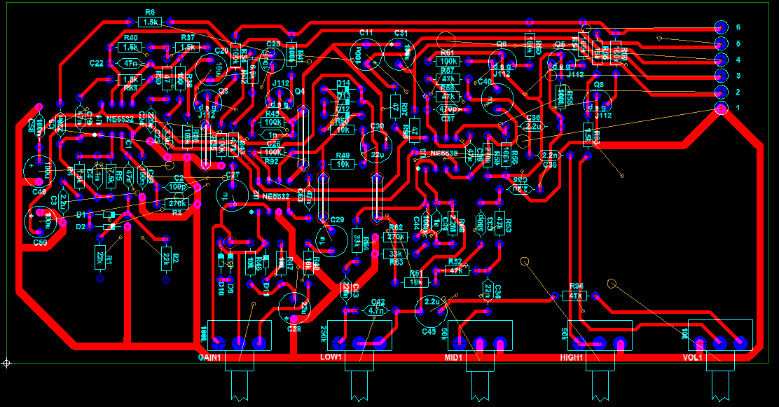

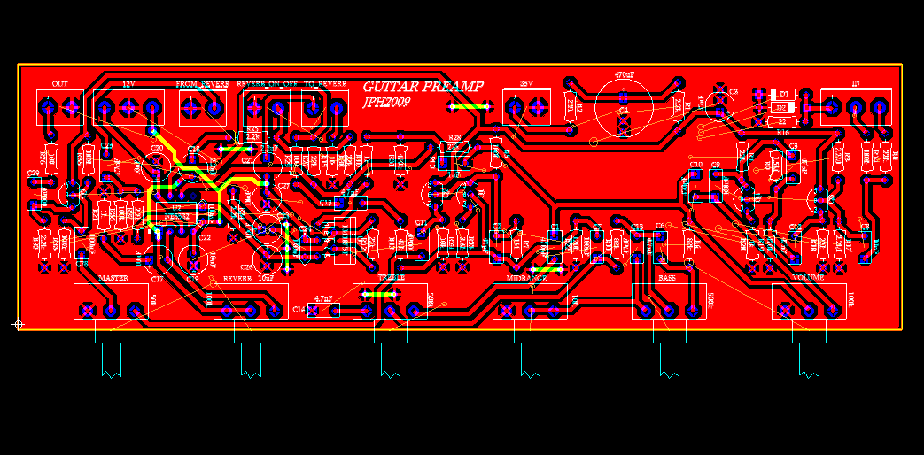

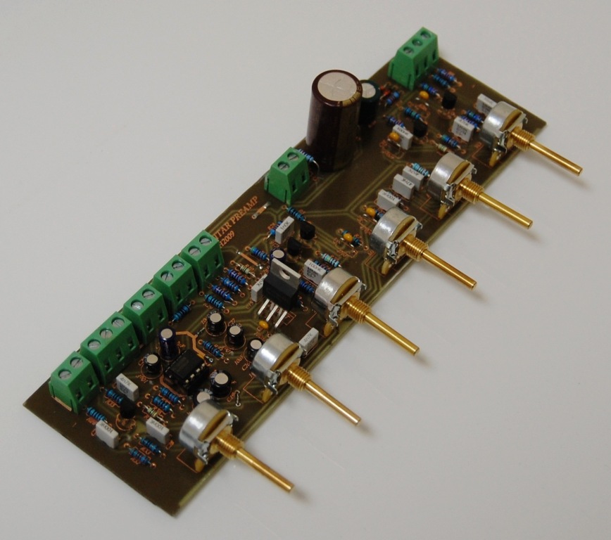

I have made a new board layout. The dimensions are exactly the same as the prototype - I managed to fit everything fairly well. I'll etch it this evening:
New preamp:
Fully assembled and checked over (for more of those deadly solder bridges 😉 ) ready for testing. I'll need to check the output from the LM1875 before I connect to the reverb tank, to be on the safe side.
Hopefully everything is A-OK 🙂
I have changed my mind once again. 😀
The latest preamp is assembled and working but I became sidetracked by a different one. While looking for possible designs to take inspiration from, I found mention of the Ampeg VH140C on the solid state guitar forum that Teemuk is a member of (here).

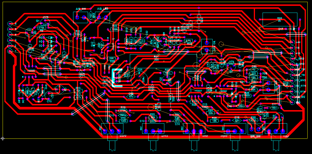

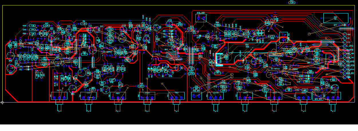

I looked it over and decided to take a shot at reproducing it. The schematics included a board layout and so I did it the hard way - started the board layout based on theirs and created a netlist as I went. Normally, the schematic would be captured and the netlist would come from that BUT I'm "the hard way" man of action so that's how I did it - the hard way.

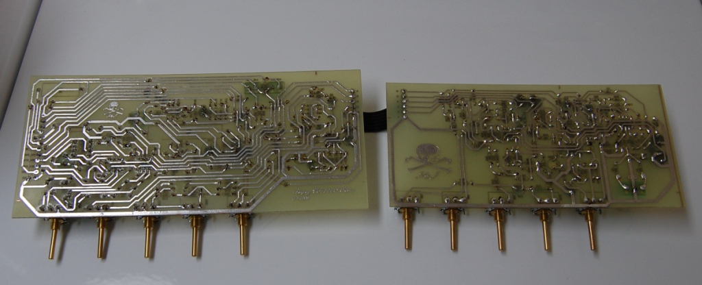

Many hours, spread over many days (and nights) to produce the complete layout. A monster (for me) - board is 10cm x 36cm, too big for me to print and bigger that my biggest piece of PCB stock:
I decided to break it in two pieces, joined by a piece of ribbon cable.
Doable:
Thats the left side, channel "A" pots.
This is the right side, channel "B" pots plus the reverb send/receive circuit:
The line of pads on the right hand side of this are for connection to the chorus board (nearly as complex) which I'll be doing after this if assembled and debugged.

I am astonished of you urge for perfection and working!

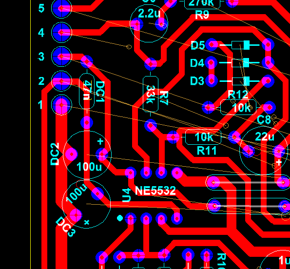

When I divided the board in two, I added extra PS decoupling and bypass:
This layout is nearly identical to the Ampeg layout so I shouldn't have any problems. But if I do, I could easily tack on a few bypass caps where needed.

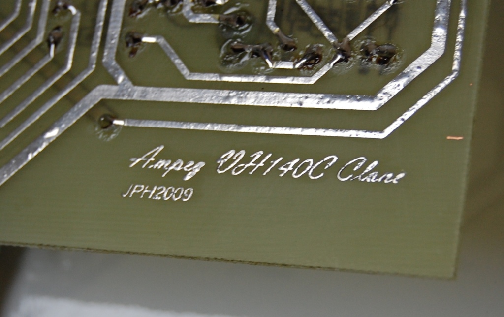

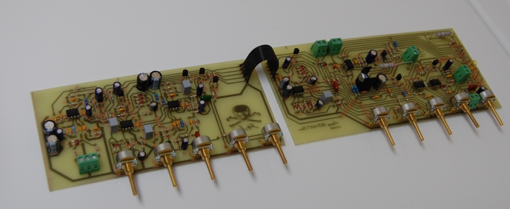

I have the Ampeg preamp clone built and working.
I have some pics to show.
The component sides:
The solder side, boards neatly tinned:

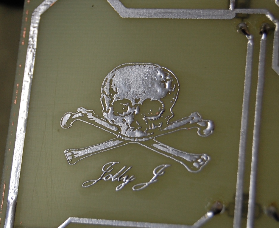

I had some space so I added a trademark:
Some more detail:
Like I mentioned, it seems to work properly, at least from a measurement standpoint. I want to run some music through it to see how it sounds (still don't have a guitar).

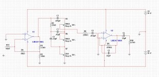

I ran a multisim of my own design tone controls last night, and it sucks. Doing completely the wrong thing. I will try to model the Fender controls this evening to get an idea.
I have started another thread (somewhere hereabouts) talking about simulators, what I do not like in Multisim is the way it models transistors but I have recently found some models dating back to 1996? and it seems better. I have a super fast PC, 4 cores, 3.2GHz, but Multisim is single threaded and trying to simulate over 3000Hz gets painfully slow. The interface is great you are right. I tried LTSpice and was in shock.

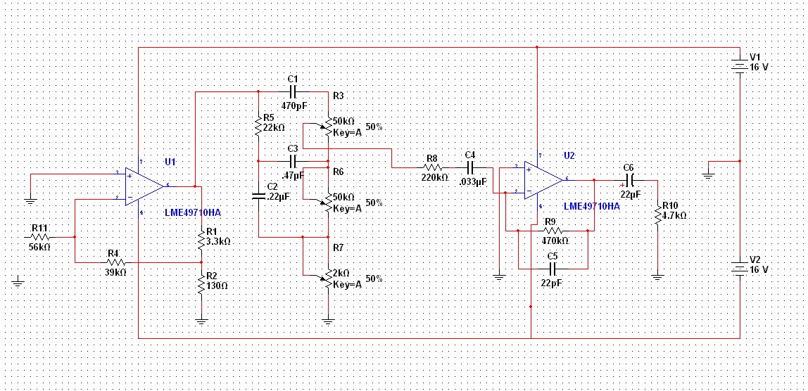

OK I have analysed the Fender tone stack. Did not bother with the "middle" control, only Bass and Treble. Here is a table. Input signal 100mVp. Output givcen in mvp as well.
Code:
Fender tone stack		input 100mvp
	Bass 0	Bass 50	Bass 100
20	100	1084	1500
88	75	1000	1000
165	150	600	600
330	180	300	300
660	220	200	180
1320	400	340	340
2000	556	512	512
4000	953	932	932
	Treble 0	Treble 50	Treble 100
20	1140	1084	1004
88	1120	993	895
165	732	627	542
330	420	315	240
660	262	190	238
1320	202	333	571
2000	190	512	890
4000	190	933	1654
OK it is a bit mis-aligned but easy to read. As I am lookimng at this for first time, trying to decipher some of the magic that makes a guitar amp a guitar amp, a special beast, and not a home steroe system onto which we have plugged in a guitar.
The frequencies in Hz, are on the left. 330 is open E on 6th string. 660 is 12th fret on the E 6th string, 1320 is 24th fret (if your guitar has it). 2000 and 4000 are for harmonics. 88 is open E 1st string. Some people tune their guitars to B but whatever, I did the 20Hz to cover everything.
It seems the "treble" knob starts having an effect at 1320Hz, with a ratio of 2.8:1. At 4000Hz (which is more or less what a reasonable guitar speaker can do), the ratio is 8.7:1.
The "bass" knob starts at 330Hz, with a ratio of 1.8:1. At 20Hz the ratio is 15:1.
It also seesm there is a hard-coded, permanent dumping of the "middle" frequencies between 165-2000Hz
Based on the above we can design a tone control stack to exhibit similar behaviour in some better documented way. I will try to do that in the following days. I also attach the simulation schematic for whoever wants to see what the Fender tone stack froma Princeton Chorus looks like.
