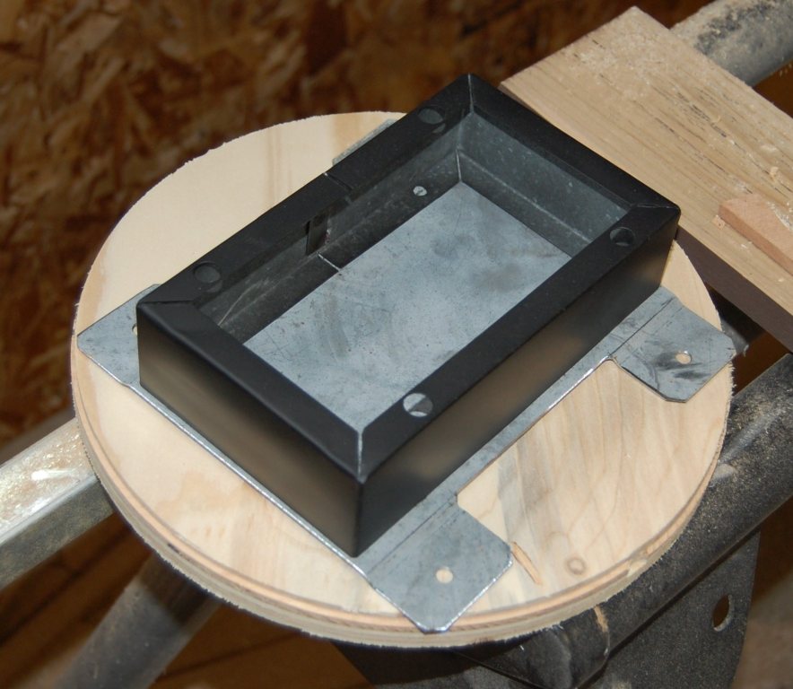

One step at a time. The amp module is finished, just to give it some more paint to pretty it up.

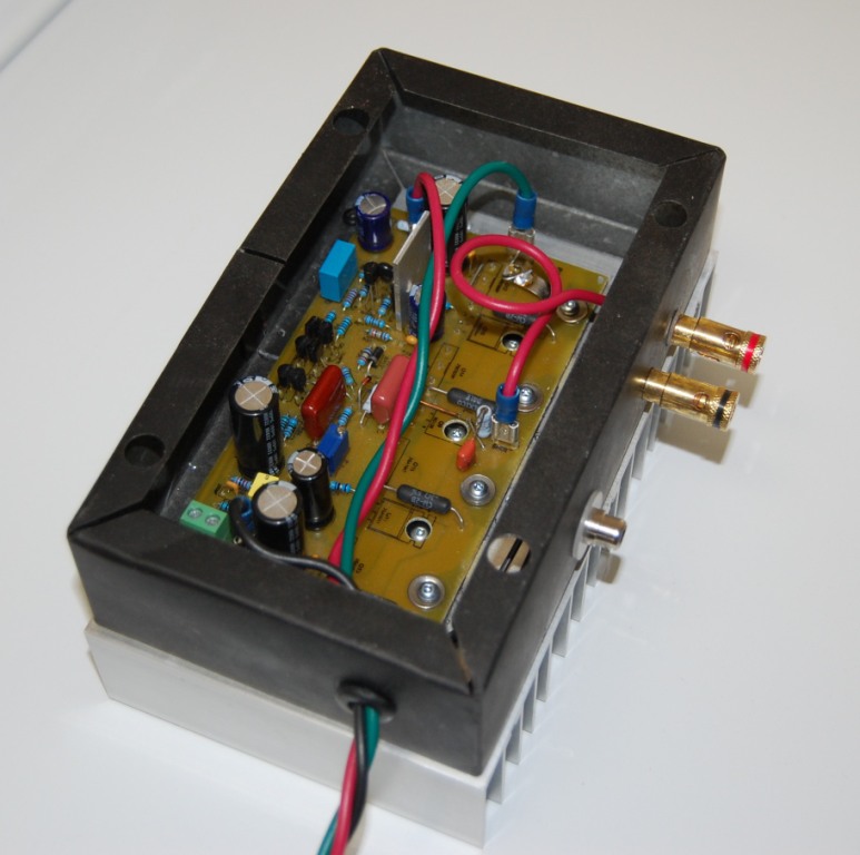

All wired up (except the output inductor, I put that in after this pic) and ready to test. I had to make insulators for the RCA and the positive binding post ( ). Nice, neat vinyl grommet for the power wires.

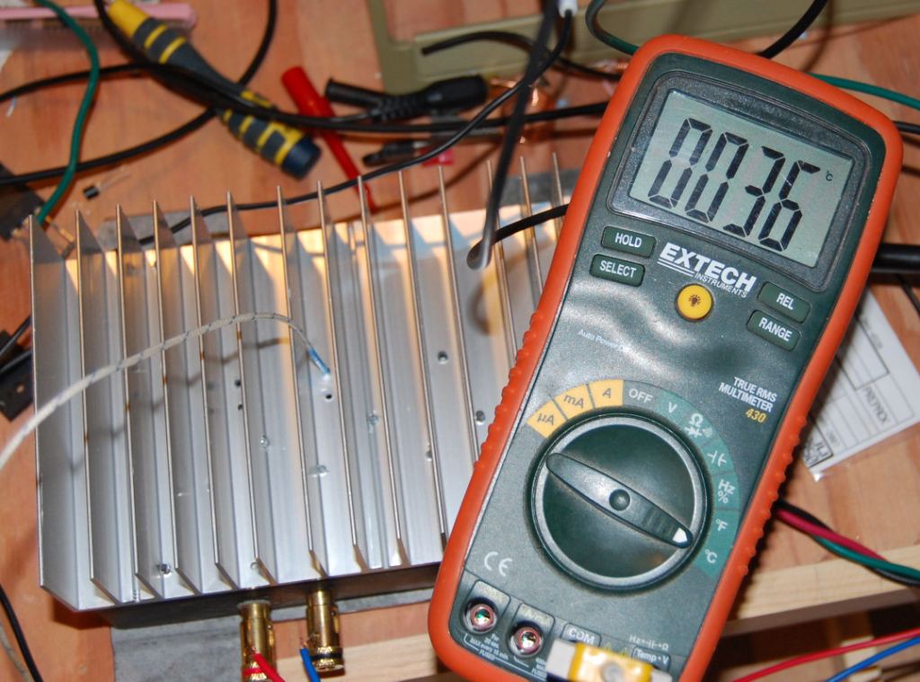

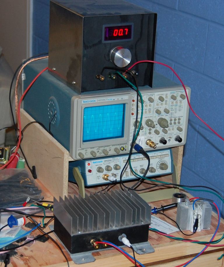

Cooking:
Connected to my lab supply at 30VDC, drawing .7 amps. I leave it like this for a while to see how hot it gets and troubleshoot by fire any potential problems.

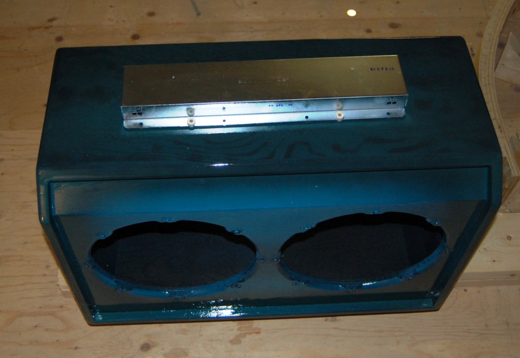

I have captured the schematic for "The Big Muff" and this effect will be on board. So we have reverb, tremolo, big muff and (possibly) tube tone. Should be fun to learn on.
When I got home this evening I had a slip in my mailbox to pick up a package at the post office - I expect that's my reverb tank and LDR.
More fun to come.
PS: Construction details of the box are found here: Groovy Guitar Amp
