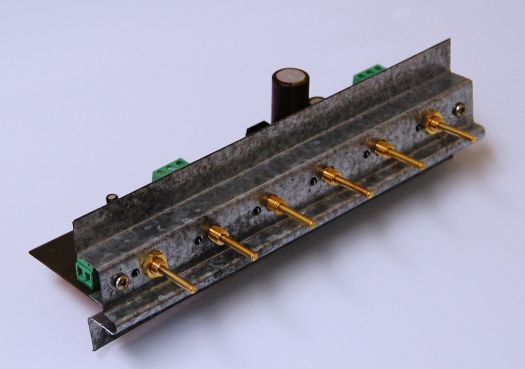

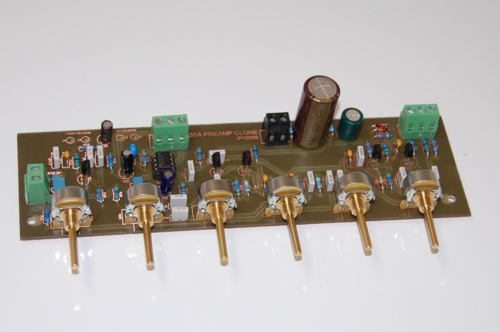

Not sure what pots you are using but should they not be flush with the edge of the PCB or even stick out a bit to allow the facepate to be mounted with ease?
Also I think you need mounting holes at the back, at the front there is already support from the pots.

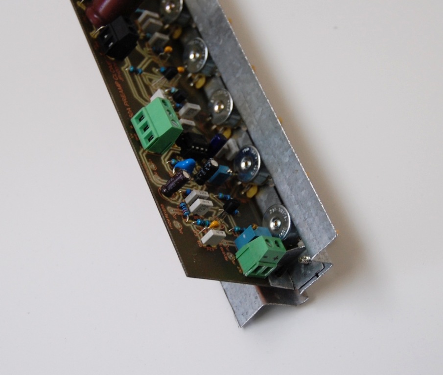

I'm pretty good with metal so I'll make a mounting bracket where the pots are fastened and the board is fully supported. This assembly then gets screwed to the stainless steel faceplate. A picture (when it's done) will show what I mean.

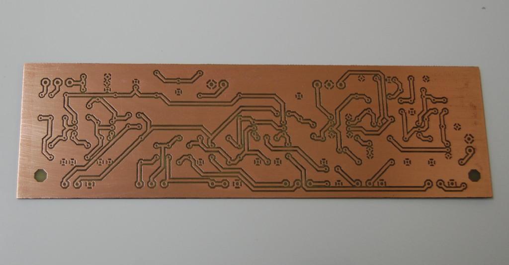

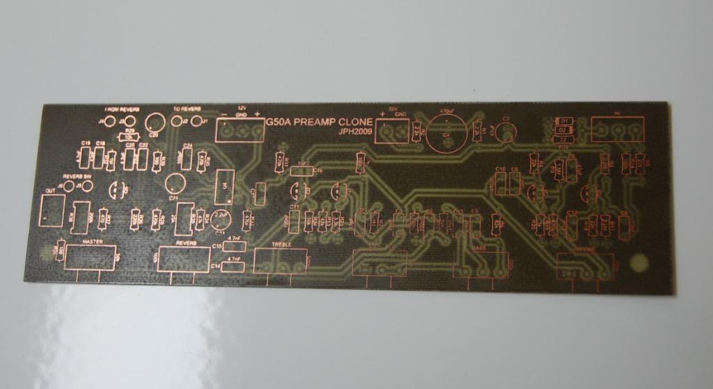

I have made the prototype board for the preamp:

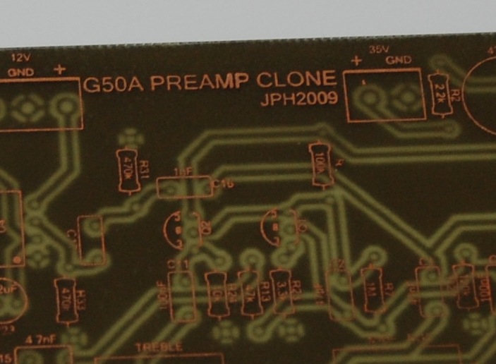

And the copper side:
I'll need to drill it and then I can populate it with the parts I have. I'm waiting on pots and a few cap values.

how is it possible that you already etched the board?

Hi , MJL . Did did you do this "action piece" with your HP printer ? I'm sold !!

Yes. I did have to do it twice though - I didn't clean the board well enough the first time. Check out the rez:
That's copper, fine as a hair. 😀

you use your laser printer and then iron on the PCB? Is this how you do it?
Yes, it is fast and easy with some (ok, a LOT) of practice. I don't bother with perf board anymore, preferring to prototype this way - it allows me to see the things I need to fix for the final version. For example, I will increase the font size on the "silkscreen" to transfer cleaner and shift a few components around to make more space for others. Also, I see that my pads are still a little small.

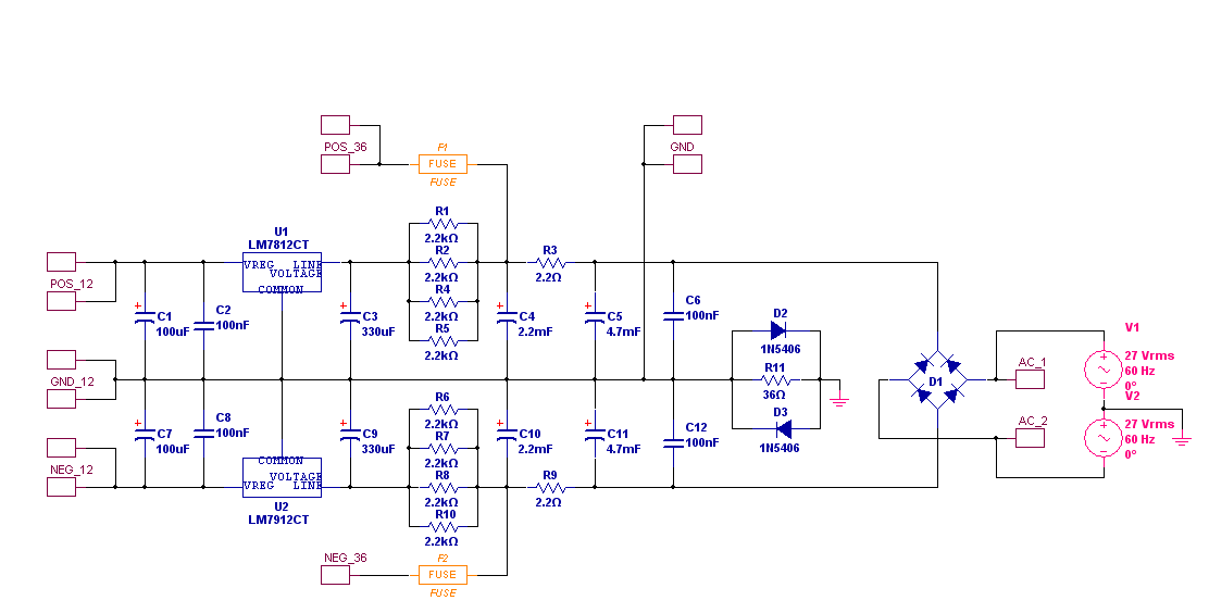

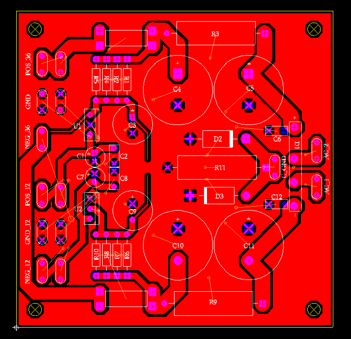

Power supply for the guitar amp:
I have a 27-0-27 transformer, probably in the neighbourhood of 200VA that I'll use for this.
This gives ~35VDC for the power amp and preamp plus +/-12V regulated for the other "accessories".
The amp module will be one of my Patchwork amps that is sitting around, collecting dust. This is an excellent use for it.

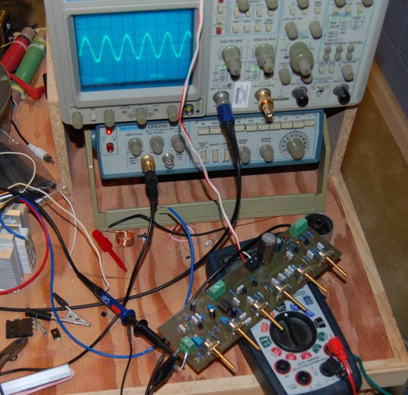

Preamp is done:
And tested:
I had a couple problems - the first was a 47nF cap in place of a 470pF 😱
The second was a good old fashioned solder bridge that I didn't spot the first 10 times looking. 😡
Operates as it should, output is clean and undistorted. The tests are on my 30V lab supply so it's close enough to full power to evaluate it.

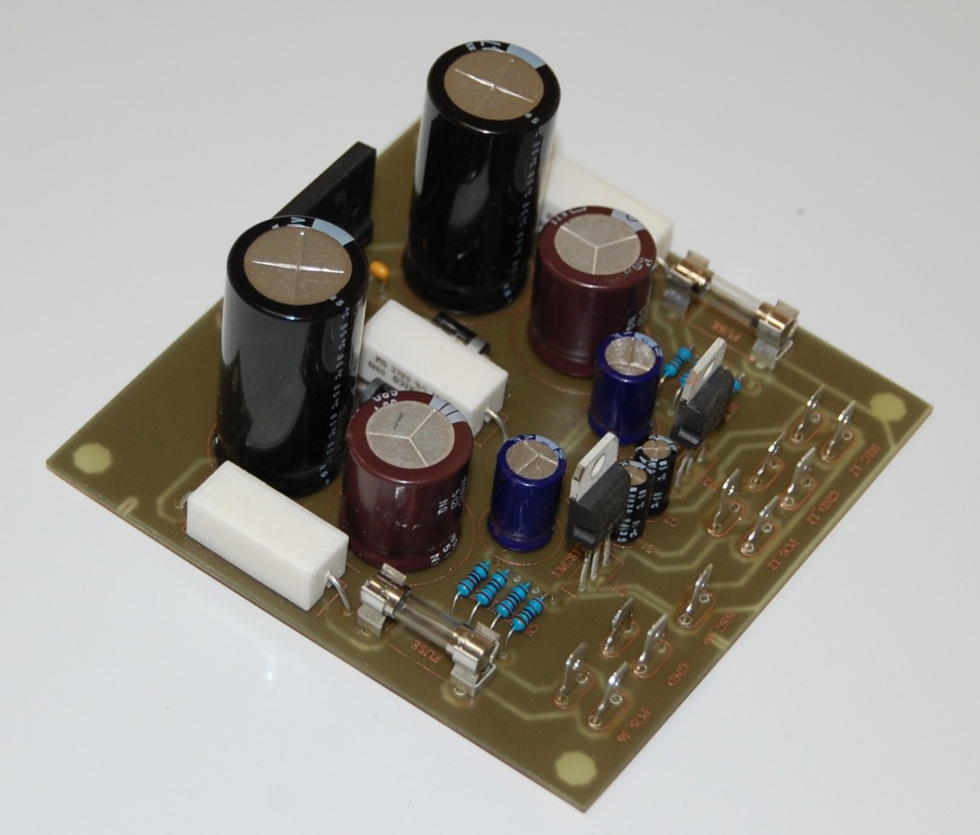

I have the power supply finished:
Works as expected but I did have to substitute 15V regs in place of 12V, I had some (supposedly from ST) that I used but the negative reg (7912) seems to have a different pin out. My board is laid out for the standard >GND<>IN<>OUT< for pins 1,2 and 3 but the one I used (and another that I replaced it with) MUST have a different pin pattern. 😕
No matter now, I've switched both for 15V and all is well.

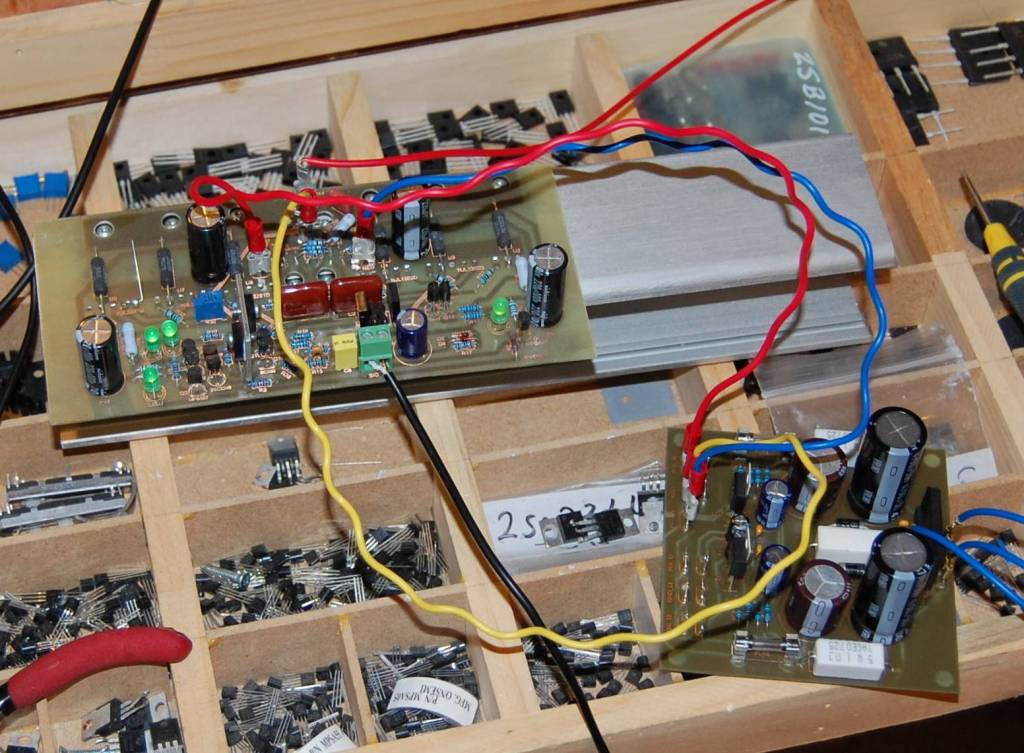

Here's the PS running my Abomination amp:
It's driving an 8 ohm dummy load and I'm seeing 19.2Vrms output just before clipping and the rail voltage is down to +/-32VDC. This translates into ~50 watts into 8 ohms and (further testing will reveal) nearly 100 watts into 4. That should be enough power. 🙂

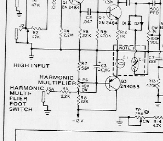

The next piece of business is the "harmonic multiplier" shown here from the G100A schematic:
Any thoughts, opinions on this? I opted to follow the G50A which does not have this feature, thinking I will do an add on board and connect it in the same location in my preamp.
Is this the best approach? Are there better ways of doing this?
