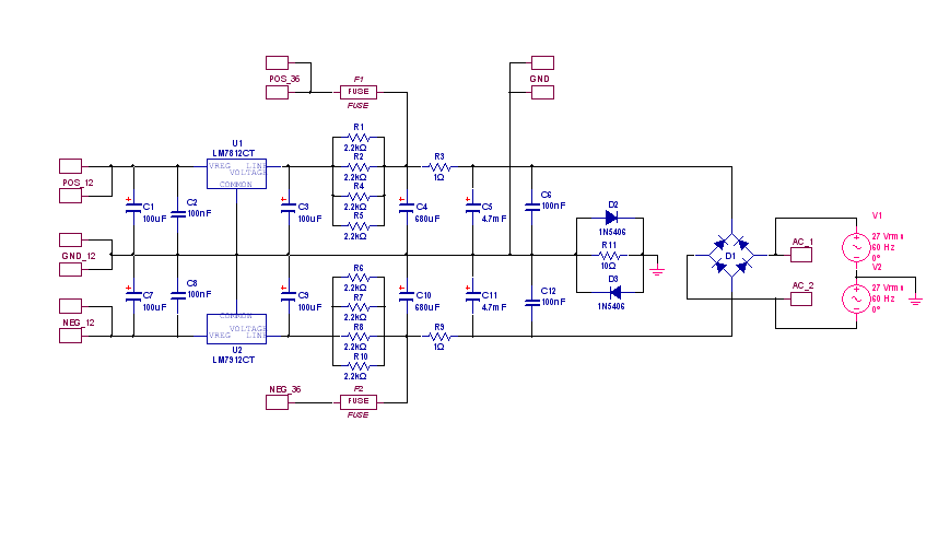

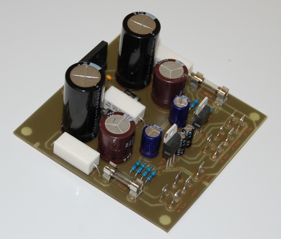

I have the power supply finished:
Works as expected but I did have to substitute 15V regs in place of 12V, I had some (supposedly from ST) that I used but the negative reg (7912) seems to have a different pin out. My board is laid out for the standard >GND<>IN<>OUT< for pins 1,2 and 3 but the one I used (and another that I replaced it with) MUST have a different pin pattern. 😕
No matter now, I've switched both for 15V and all is well.

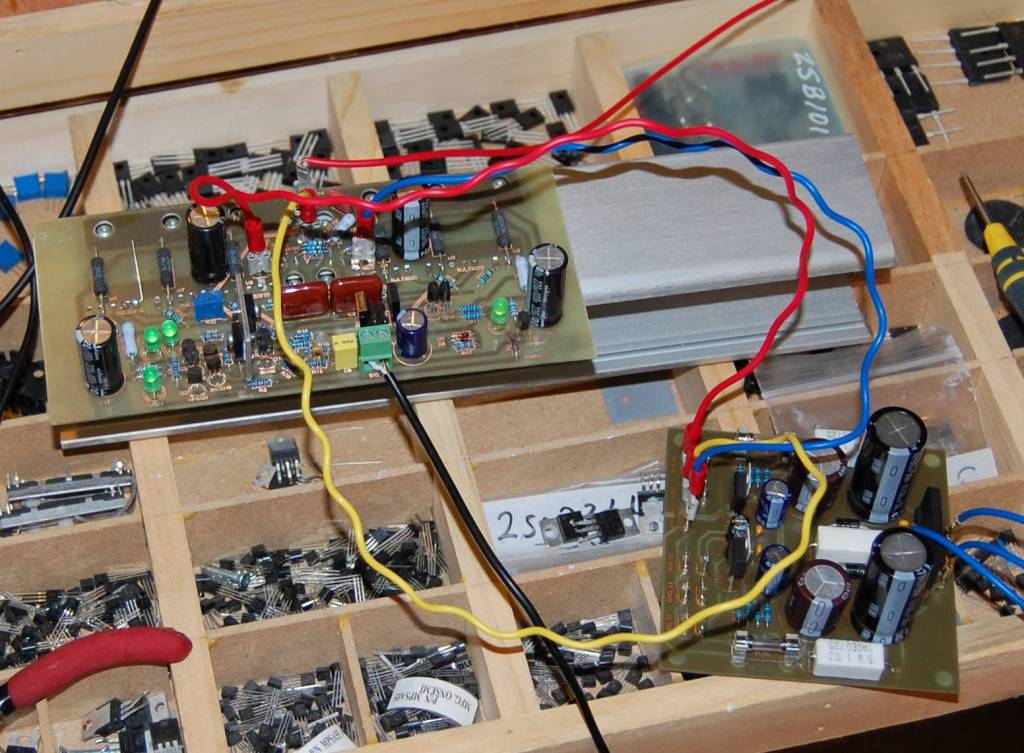

Here's the PS running my Abomination amp:
It's driving an 8 ohm dummy load and I'm seeing 19.2Vrms output just before clipping and the rail voltage is down to +/-32VDC. This translates into ~50 watts into 8 ohms and (further testing will reveal) nearly 100 watts into 4. That should be enough power. 🙂

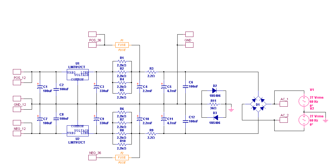

whoops you already built the PSU. Are these 22,000uF capacitors as per schematic? They look awfully small 🙂
Whoops again, 2,200uF they are, my bad 🙂 Hmm is that not a bit low for all those amps (100W/4R) ?
OK I am trying to work this out. After the first filter on your PSU, and with no load, you should have like 44.6V DC. But you have added the 2.2R and you say you have measured 35 VDC. Are you then dropping almost 10 volts on those resistors with no load? How is this possible?
Also, when you start pulling amps, there is ripple out of the first caps. I am not sure how effective the 2.2R / C is, but the ripple voltage entering it would be like 5.32V p2p (at 100W/8R and 100% efficiency 🙂). At that point, no matter what the DC Voltmeter shows, it is not true. There is a base of 38.08 Volts on top of which the 5.32V ripple is added (like a hat) and the DC voltmeter would likely measure some average, ie bluntly, (38.08 + 5.32/2) or maybe (38.08 + 5.32/sqrt(2))/. But I cannot calculate the effect of the 2.2R/C filter.
Would you please mind running some tests to show the ripple in and the ripple out (past the 2.2R) ?

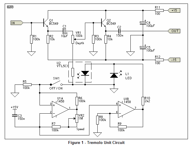

Hi MJL21193,
You might consider to try, and maybe, add this little unit in your guitar amp.
Thanks, where to place it? Between preamp and power amp?
I'll use this, just need to capture in Multisim and do up a board. 🙂
The Patchwork module running, mounted on the heatsink I'll use for this:
This is an older one with clamping diodes to prevent sticking during clipping.
I'll completely enclose the amp (a few vent holes) in a sheet metal case that'll attach to the heatsink.
The final design is below - I changed a few things:
I don't think the cap values are too bad, considering the purpose - a guitar speaker won't be providing much bass, so really no need for a reserve of current.
The AC from the transformer is 27 volts, the DC after the rectifier is ~38V. The resistor was changed to 1 ohm (what I had on hand) and is there for RC but also it's slight inductance. It does make a difference to ripple in the simulation. The amp this will supply has excellent ripple rejection.
I did look at ripple on the regulated supply and it is way, way down.
Hmm I thought I replied and the post is not here, strange. I will retype 😉
In the UK many transformers are 230V but mains is 240V, plus regulation (8.5% in your case) would raise the offload voltage considerably. 38 volts sounds quite low for off-load, my calcs show it as 40.83 volt, assuming you have 110V mains and 110V transformer.
The bit about ripple, on the guitar the top E is 80Hz and on the bass guitar 40Hz. I think there are 5 string bass guitars with an extra B below the E, that would be even lower. I am not sure how the 7 string guitars tune. And then you have harmonics too.
A nice test would be to inject a 40Hz signal and see what happens at full throttle on your dummy load. Is there attenuation compared to a 1KHz signal (for example). Are there 120Hz components in the output?
Oh, and I forgot, what is the nature of those parallel resistors? Why not just one? Increased wattage?
Did you include diode drops from the bridge in your voltage calcs?
The 40Hz signal has no effect on the supply voltage droop - same at 40 as it is at 1k. I may have under rated the transformer, it may be more than 200VA. In any case, there doesn't seem to be a lack of current.
As for 120Hz components, nothing that shows on the scope.
The parallel R's are for power dissipation. I don't have larger value 2 or 3 watt resistors on hand so this does the trick nicely.
Of course between preamp and power amp... where else! It could happened that you don’t need any gain in the last stage (U2), but don’t omit it… wire it as a buffer (short R11 and don’t use R12). Also, don't forget decoupling caps on supply pins of those OPAMP-s! They are not on schematic but I presume, everyone experienced will add them in a practical circuit.Thanks, where to place it? Between preamp and power amp?

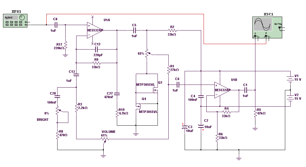

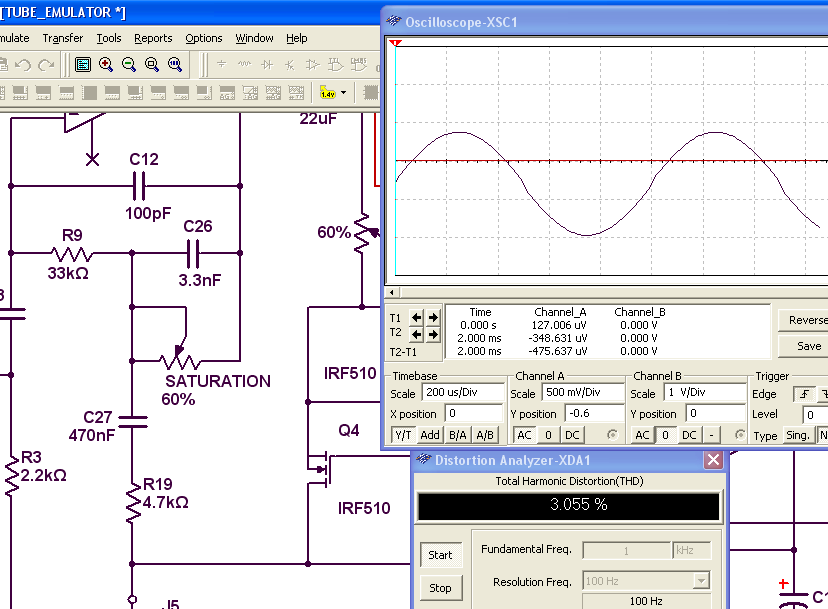

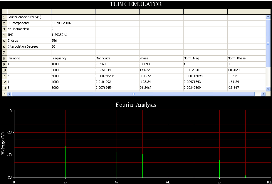

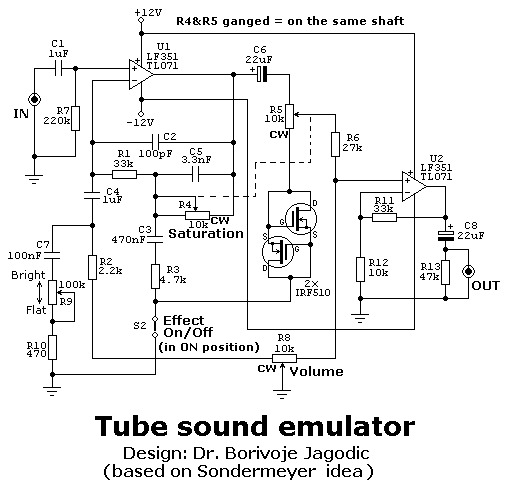

I spent some time fooling around with the tube emulator. I thought about how it could be changed to shift the distortion to even ordered, specifically H2 and H4. I looked at the MOSFETs and thought about adding some bias to see what happens.

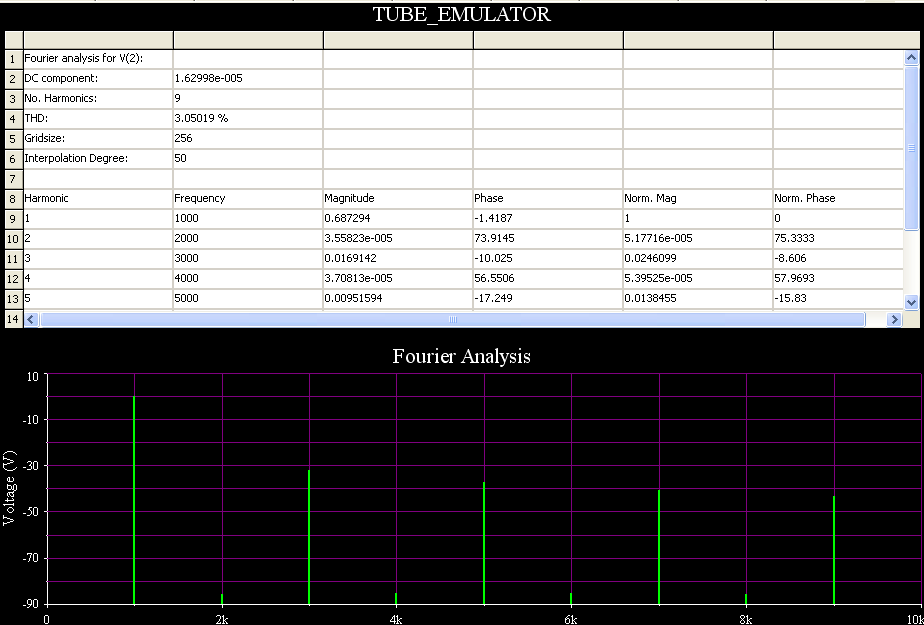

I made a few other changes and the >simulated< results look good. The crossover-like distortion is gone and the distortion spectra looks better:
I tried it through different settings on the pots and always the lower order harmonics are stronger than the higher order.
I wonder how it sounds?
Another thing I had wanted to comment on, but never had time, is on the pre-amp schematic there seems to be a strange economy on buffers. For example Q1/Q2 and the "master" pot are designed to be a buffer-amp-buffer-pot-buffer stage which would necessitate the use of at least 2 more transistors, but they have made do with 2, and are presenting a very high output impedance to the rest of the world. Q2 can easily be overloaded and the pot action will be "extreme" unless your next stage is very high input impedance compared to the pot which also needs to be quite high to avoid loading Q2. With a 10:1 rule, the pot ought to be 100K and the next stage 1M, which I doubt is the case. Plus 1M stage means picking up noise.
OK I quite like that software you are using what is it? Is it accurate ? And how did you bend and cut metal, what tools did you use?
You are quite right, another EF on the output to lower the impedance would be a worthwhile improvement. I'll add it to the final version. 🙂

It's Multisim 10 and it seems to be reasonably accurate. THD numbers are very accurate (using good device models) but the harmonic spectrum can't be 100% counted on - it'll give a hint of what's going on, tell if you are going in the right direction.
I use a mini grinder with a very thin abrasive blade for cutting (shears can distort the metal) and just simple things for bending - pliers, vise, fingers, etc.
It's more about how you do it as opposed to what you use.
Thanks,

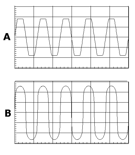

For some stupid reason, opamps will not clip in Multisim - increase the input voltage and output just goes up, regardless of supply voltage! 🙁
I wanted to see if it achieved "soft clipping" but for the limitation above.
