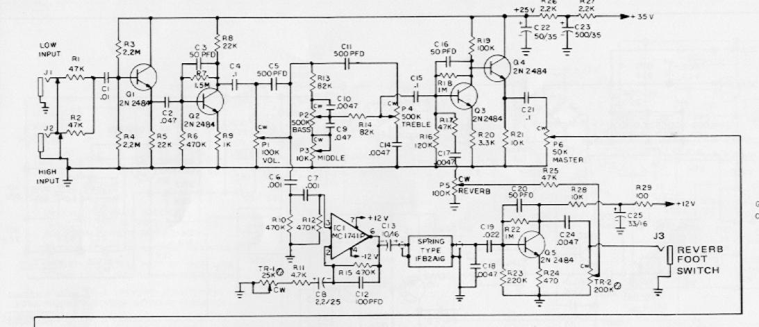

Is an interesting idea, most commercial amplifiers possess a footswitch to turn reverb, on or off, but with some modifications it is possible to operate the reverb volume pot, on the front panel of the amplifier, through a pedal, like the old wha-wha pedals.
Regards
Regards
I don't play any instrument, but, I wonder if a foot peddle that is switch (at the top of travel) and rheostat (for max reverberation at bottom) is usable while playing?
Happy new year Andrew!
What you are describing is like a wah pedal. I'm not sure if it's desirable to vary the reverb effect like that. The original uses a front panel switch to turn the reverb on or this is overridden by plugging in a footpedal switch to the back panel jack. The front panel pots control the amount of reverb for each channel. This is basically how I will build it too.

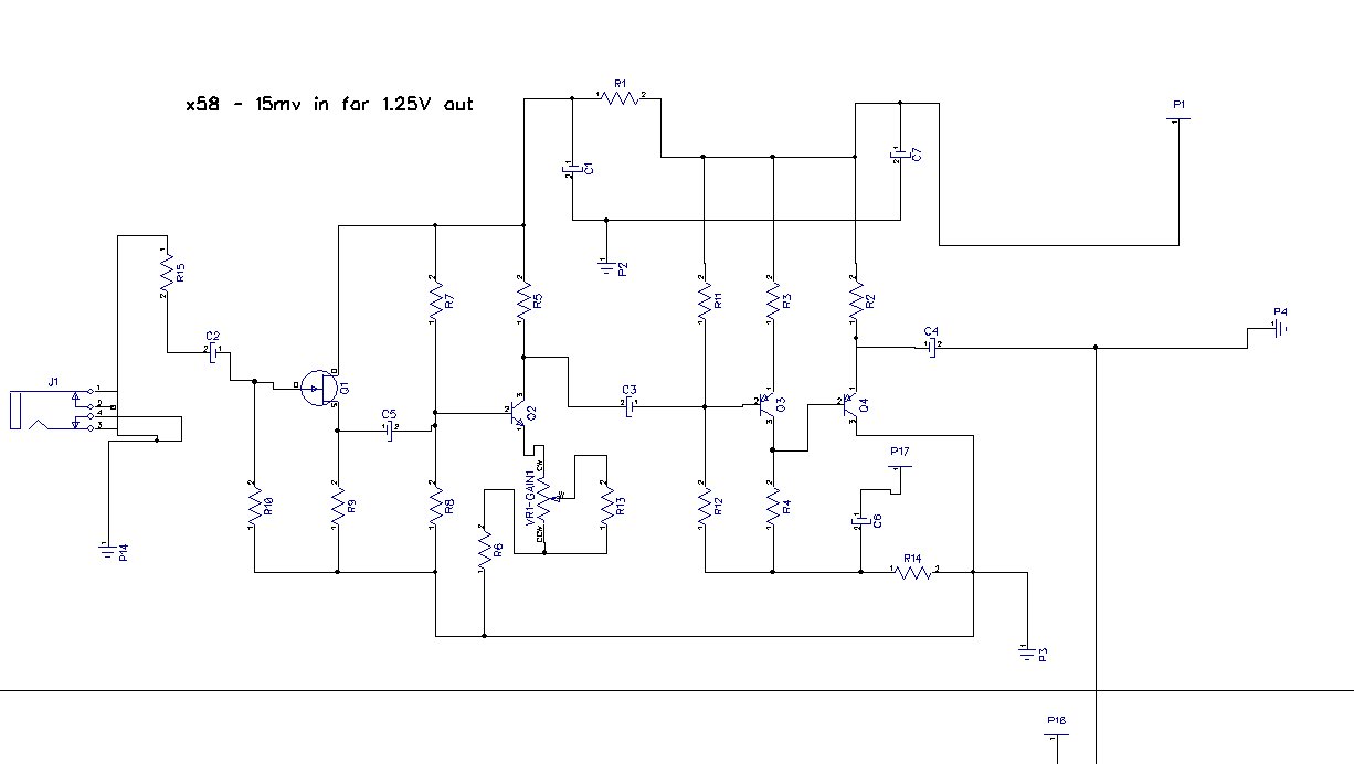

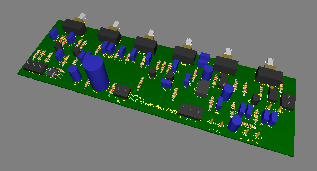

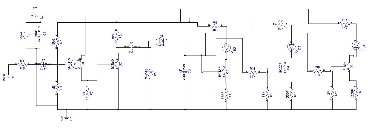

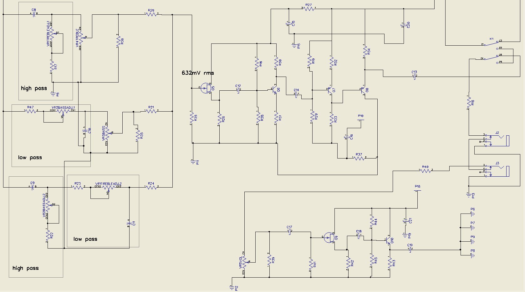

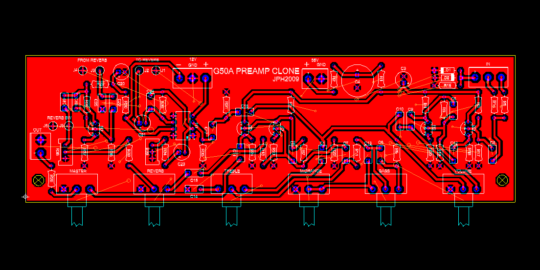

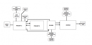

Here is a chart of the overall build:
The line in / line out jacks can be used for an external effects pedal. The original has one 3 conductor jack for a 2 switch footswitch to control A/B channel selection and reverb on/off, but I have separated these, at least at the board level. They can be 2 individual 2 conductor jacks or 1 three conductor jack.
It's tricky to keep track of all of this but I have a better grip on it now. As I break up the original circuit into blocks, I gain a better understanding of how they work.
I was picking at the chorus section yesterday but I feel that it is hopelessly complex. This was the Gordian knot in my first attempt and I think I will replace the entire circuit with a less complex one that is supposed to have the same performance.
