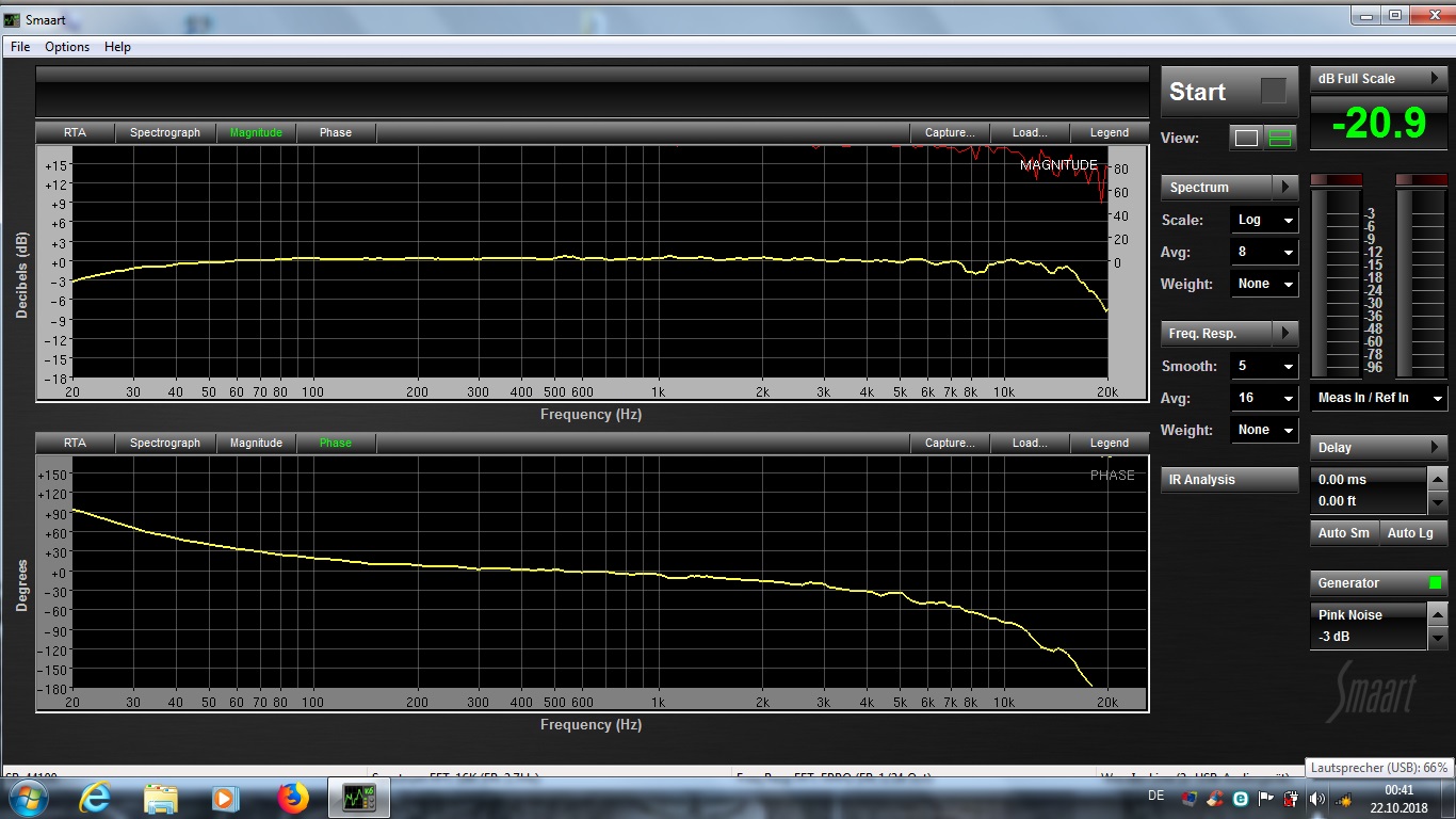

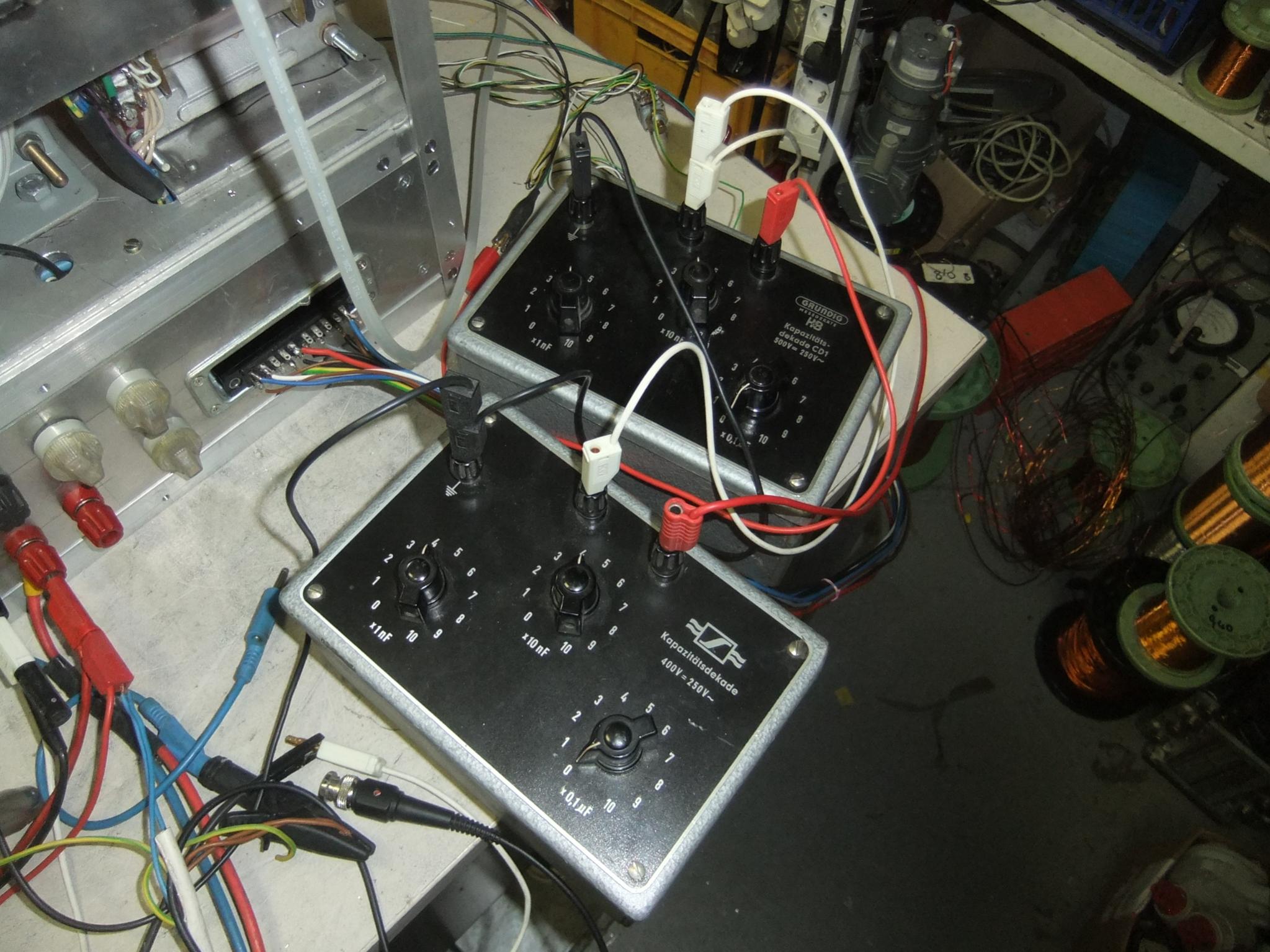

After all ist repaired I made the test with the nfb. The test setup with a Computer audio mesurement program show the frequency / phase diagram. Whith the help of it I tweak the nfb to the optimum.
The data changed al little from that what I show her before. The maximum otput is 1600W at 7% THD. At 1500 ist it 5% THD. and 2,5% at 700W.
But the more important thing than a low THD ist the phase shift.
The 3db points are at 20Hz and 15kHz.
It seems I can finally put the panels on and put it in a rack with its power unit. The audible test without dummy load shoud come up next. But not at my place. I own 6 JBL Control 12sr and 2 JBL 4870 homebrew with original JBL Components.
The right pic show the bode-diagram and the left one the setup for tweaking the nfb.
