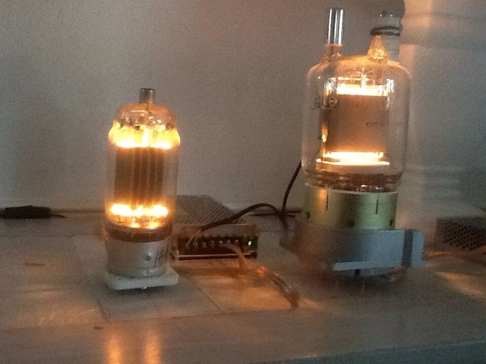

I use for heater 12v 30A smps with NTC for slow start. No humm and cheap.

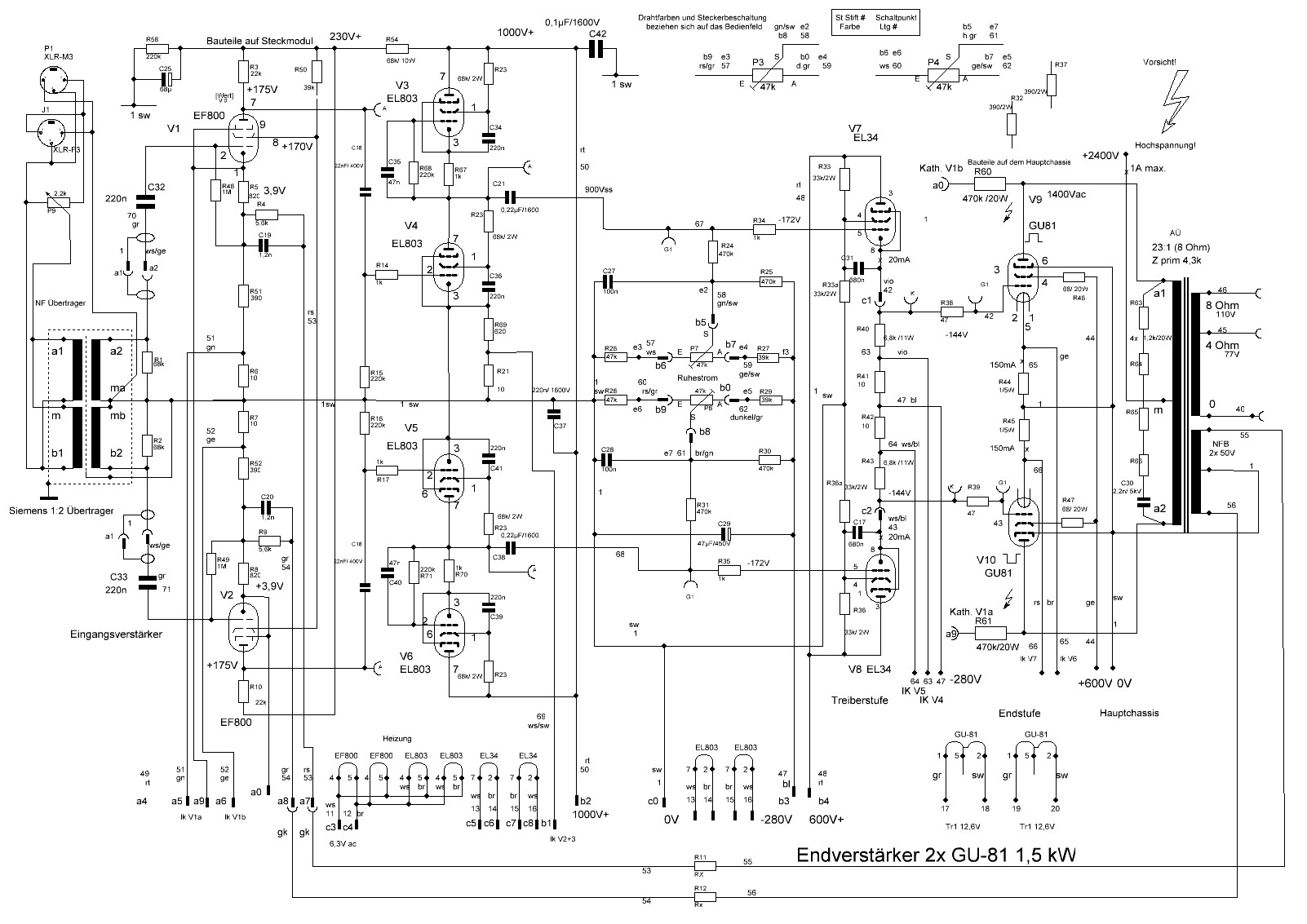

Schematic of my 1500W GU81 power amp
Hi Folks,
here are the drawing of my 1500W amp with 2x GU81 in the final.
The Power supply is not shown. It need several heater voltages due to Vf/k .
Input/Voltage amp 1000V+ (E80F / 2x EL803=
Driver 600V+ (EL34)
-Vg1 280V-
Vg2 600V+ (from HT power unit)
Output plate 2700V+ (2x GU81)
A makeshift power supply run on single phase, 4,2kW /5,1kVA which is abt.25A. It is real difficult to get this load from single phase sockets. 16A is the maximum from a "Schuko" socket" But common CEE sockets bring all 3 phases , thats 11,5 kVA. I use a 400V to 230V transformer at the moment to get the 25A at 230V. The trafo is a 6kVA "control transformer" for industrial switchgear, bought on the local scrapyard by the kilogramm. What a heavy beast.
The final power unit run both channels from 3 phase 230/400V supply , thats only 15A /phase.
You may find some mistakes in the drawing, but in the real amp is working.😀
Edit: the heaters of the finals run with ac, no hum. The S/N is abt. 75dB (25mV hum&noise at the speaker terminals with no input signal.

Hi Funker,
Great project, reminds me of the RF gear I used to build and operate years ago, using 4 KV @ 1 Amp.
Do you have any pictures of this beast?

errrr....25 mV hum is not quite what I would consider 'no hum'. Suspect slightly less efficient speakers. Hopefully not Bose 901...LOL

I had 2 mV of hum with my KT150 PP setup; it’s now down to an inaudible 0.35 mV by elevating my DC heaters.
My 2mV were clearly audible, so 25 mV will be quite audible too. But when you actually play with 1500 Watt I guess you will have a lot of distance between the speakers and the listener. I doubt the listeners will then notice the hum.

Yes 25mV are audible noise if you standing right in the front of the speaker. But You really will not stand in close range to the speakers if the amp is playing Rock with the level is cranked to 11. The amp sounds amazing with a distance of 50m from the speakers. "Wacken open air" in my backyard.😀

I mean 75dB S/N is not bad for such amp. The input sensitivy is 500mV with level control at full blast

Hi, there is no need for fire the heaters of the GU81 with dc. There are only a need of a grounded center tapped heater winding on the power trafo. The hum is cancelled out due to the against ground balanced winding.
Each tube need its own heater winding.

I have had no difficulty getting quiet amps with hum-pots and individual windings too. Up to 10V for 813's...no reason to expect that 12V will be any different. If you are running a CFB output Iron, suggest common-mode chokes to go between the filament TX and the filament.

I use SMPS with NTC for startup delay for heater FU13 and GU81. Cheaper then transformers and also no.humm. Just buy them 2:times the needed current.
