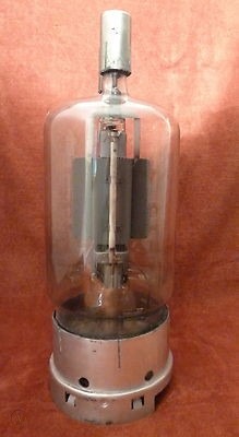

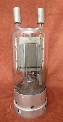

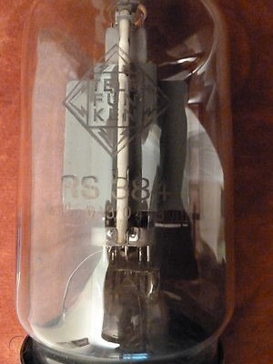

Thanks. 🙂Because the P-300-1 is an improved GU81 with another base.

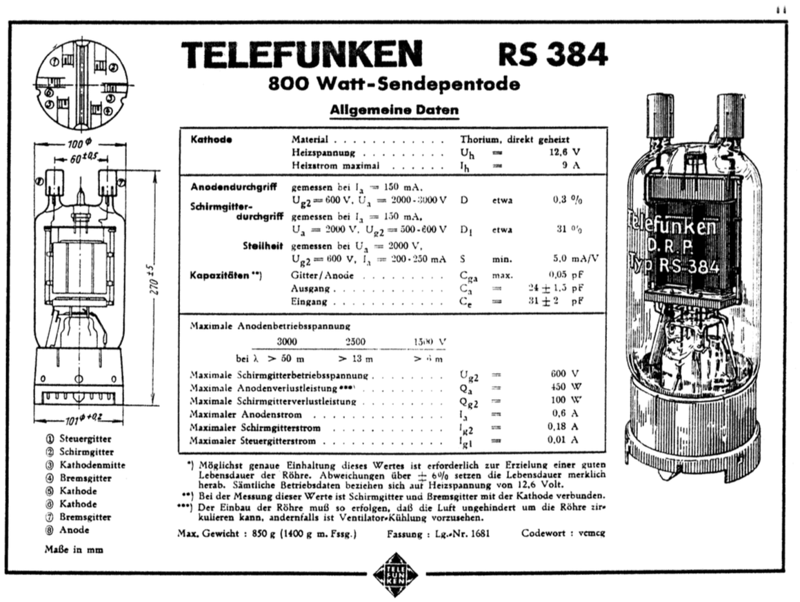

The GU-81M is actually copy of Telefunken RS384 tube. Even has the same socket... I think before IIWW?

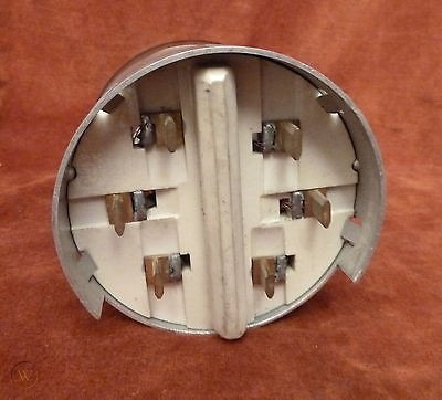

Fortunatley I have multiply pairs of original GU-81M sockets. And original black bakelite "bunny" ears caps. 4 pieces for SE stereo.Sockets for GU81 a very rare to get. If you have relations to a good machine shop , make your own.
It would be nice to choose all the employed tube in the amp to be with caps?
3B28 have, GU-81M, 814, just find the input tube with anode cap and apropriate gain and Ri to drive the driver tube. 🙂

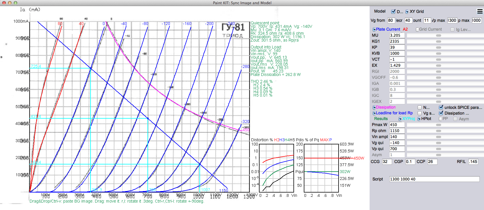

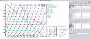

Here are Anode curves for GU-81M in triode mode, measured.
And a spice model parameter datas 🙂
It can go to 45W power with only 2.5% THD which is amasing
BUT the working current point is 450mA... 🙁
with peeks up to the 720mA !!!
I didnt calculate but this could be as 0.8mm wire for current density of 2.55.

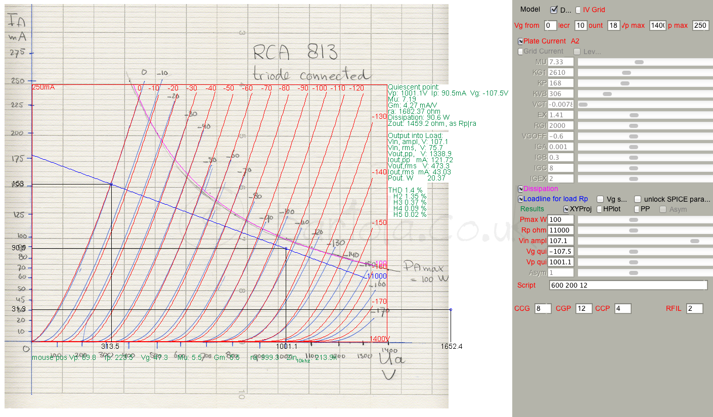

This is the app. 20W 813 settings
It is clear that the huge difference in Ri internal resistance of the tubes.
Zout of the 813 is 1460 ohms
Zout of GU-81M is 302 ohms
This 1460 ohms need a rougly 80 and more Hy for 30Hz say
It is complicated and still on the edge OT...
But for these say 300ohms generator impedance the 15-18Hy is good to 10Hz
With wider wire needed for higher currents, the transformer will have VERY low wire DC resistance.
Secondary much more LOW this is the crucial for good damping factor of the amplifier.

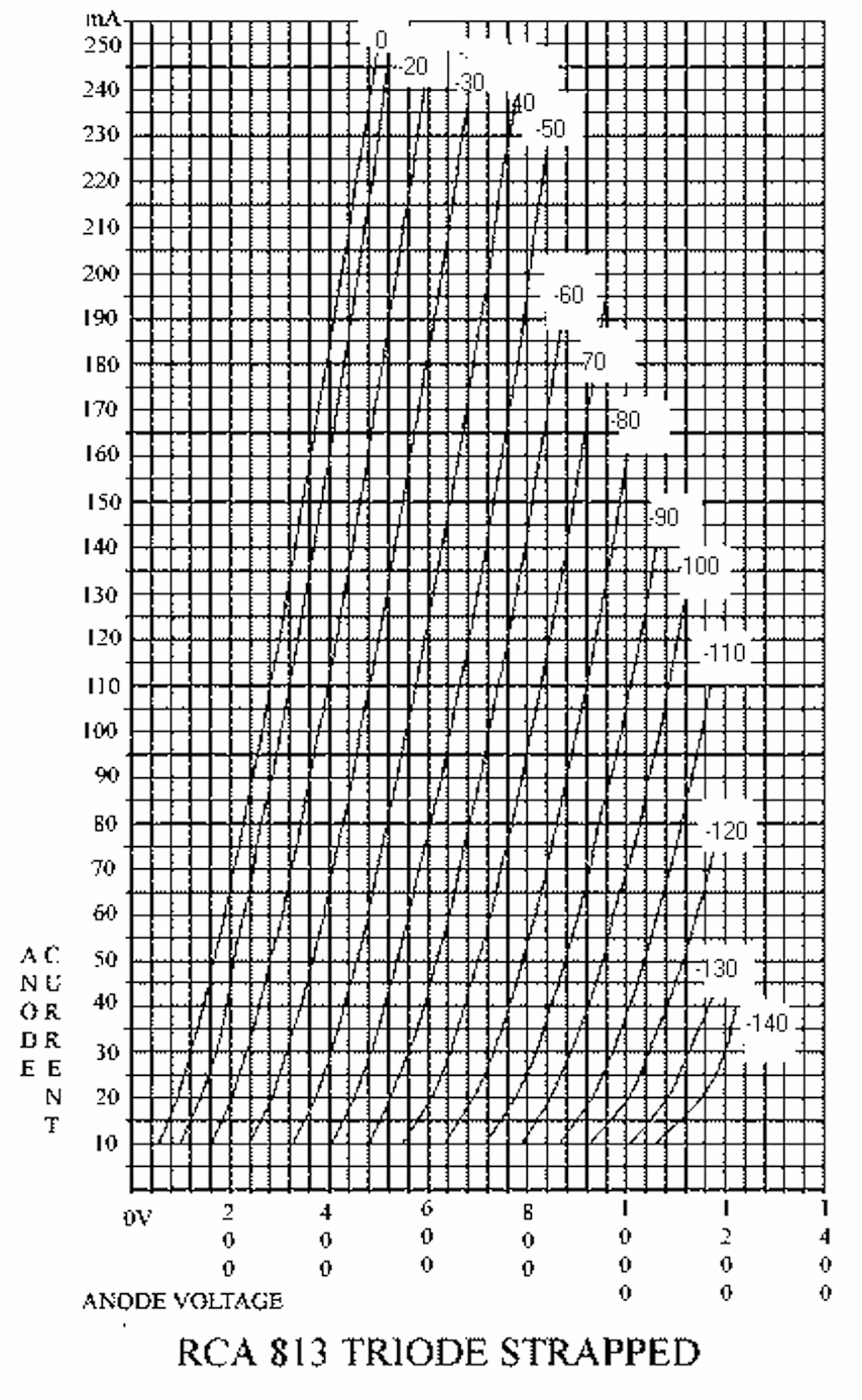

on the other hand, the measured anode chrs by Frens Mazenier showing the lower Ri of the 813
at 100mA, -80V(g), 825V(a) = 510 ohms?
Should be compared with 813 in tride mode by RCA

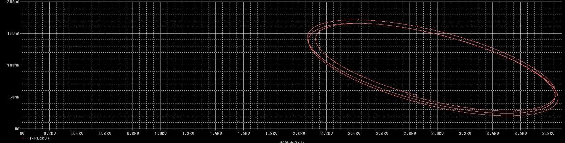

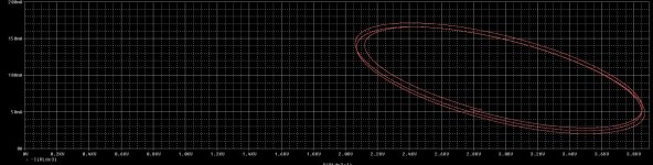

The presented load vs primary L is the reason for that ellipse. Driving with lower impedance is useful too, but Primary L v load applied in || to delivers low freq performance. Like running 8 Ohms on 16R tap, primary load is half, primary L is same, and LF performance improves. measure it... 😉 the results match the math.@banat

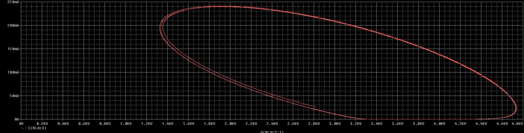

Douglas
No, The elipse is product of reactive load. With only resistive load the line is "always" flat...The presented load vs primary L is the reason for that ellipse. Driving with lower impedance is useful too, but Primary L v load applied in || to delivers low freq performance. Like running 8 Ohms on 16R tap, primary load is half, primary L is same, and LF performance improves. measure it... 😉 the results match the math.
Douglas
The Generator resistnce/impedance is aprox Ri II Rload. That Rload is NOT 8ohm BUT load the anode transformed with N of transformation...
For instance if the Ri=3800 ohms, and Anode Rload=8000ohm Req-gen=2720 ohm. These 2720ohms with some L(Hy) have to form frequency dependent network
To compare with say 300B with Ri=800ohm aprox. And Rload=3600ohms Req-gen=655ohm, and gor good BW at bass You have to invest circa 40-50Hy...
It is Huge difference
You can check the ellipse "fatness" in simulations with Xaxis=Anode voltage (Ua-Uk) and Yaxix=-Io current @ Anode after reactive load.
Elipse will occur in the HF part of the BW but factors are Capacitances and lose inductance...
The minimum inductance of primary is one that elipse is not deformed and not touching the X axes. In the choosen F and with choosen input Vp-p
Also that is maximum power that is the true to sign... The same for HF side.
NOT the calculated power with static load line...
That is for the efficiency is not the relevant value WITHOUT simulating output stage with close values of reactive components.
(and on that should be added magnatization issues and core issues which is not easy to simulate with relevance...)

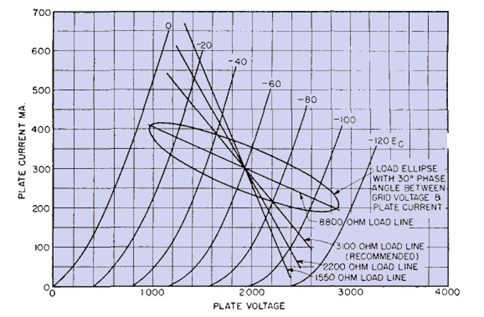

The Ellipse is tilted at the magnitude of the load line. Resistive is straight, and gets to 'flat' as resistance becomes infinite.
So then, how is it that pentodes, with plate Z much higher than applied load work? Take for example the Citation II or W6m. a-a load of ~3,300 Ohms. When in high power output, their Class AB leaves the load seen by the conducting side at a quarter of this...800 Ohms-ish. Yet plate Z is large, even with the U-L connection...
Now consulting the data sheet of a 5k a-a output transformer, some benefit is seen from low source impedance. It is not the primary driver of the low frequency performance. The large( compared to gapped SE ) primary L is doing the heavy lifting here. As far as the tube sees it, Reflected load is in || with the Primary L. Shrink primary L and LF response suffers.

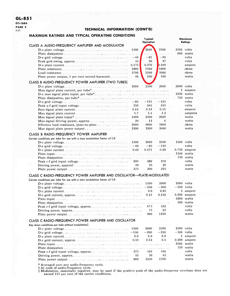

I just find old graph that illustrate reactive load line. BIG 851 triode 🙂
Look how it is linear 🙂
851 RCA and GL-851 General electric
great tube but big, real high voltage, expensive and unobtainable including special socket and cap... 🙁
Yes that GL851 power triode is excellent choice for some simple two stage 100W SET power amp , but IMHO you can also look for European Philips range of HQ RF power glass triodes such :

distortion for max power (again static calc) of 45W is say very low
With PSpice parameters. Composite version of DHT.
I can note very high input signal for max power of about 280Vp-p.
So it is close to imposibile to make only 2 stage amplifier. 3 stage amp is more lightly to be the minimum version...
Bit the Ri=410 ohm, and Req-gen=302 ohm for Rload=1150ohm.
IMHO there is no point to push tube deeper into the Io. To reach out for little bit more linear region.
these Io=0.431A is already very high... And maybe it will be on the edge for rectifier power supply.
Later I will post some dynamic simulations. To take a loo and have an idea about Lprim, working elopse, FFT etc...
Here is a output stage, static settings, static load line and other datas for 45W output with GU-81M.
