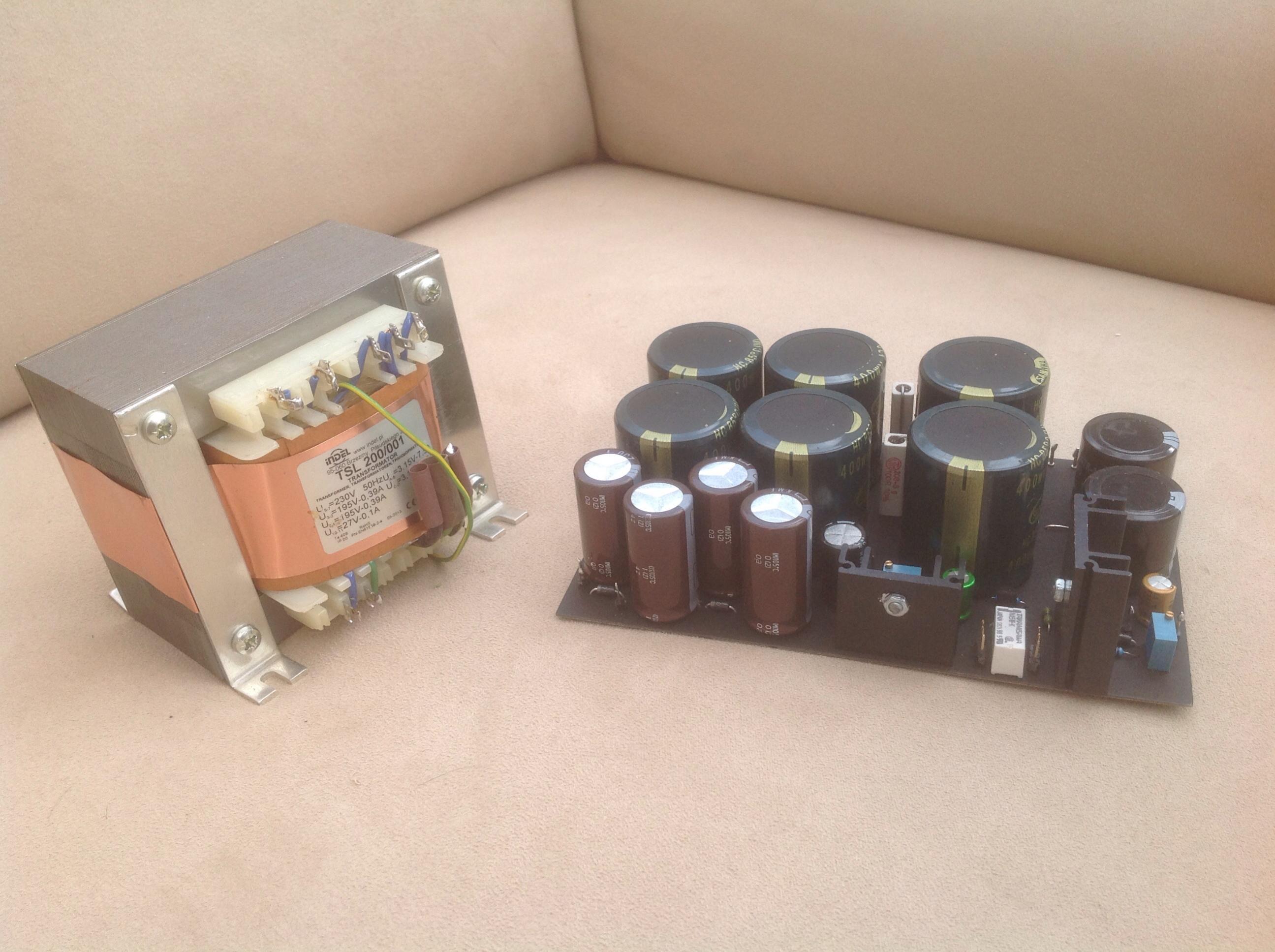

Very nice. Classical but nice. The Power supply is familiar. Similar to the one I have, slightly different configuration, but same topology. So you suggest to go for a dual symmetrical voltage feed for a simple Cathode Follower pair ?
Hmmmm ..... I think I like it.
The more so that I have a few additional power transformer tappings which I could use for this ...
Ziggy
Yes , I think that DC coupled CF triode drivers bipolar supplied is very good solution from many reasons , one reason is that you can easy drive OPS in A2 /Ab2 class of operation without to raise significantly THD factor , you can even consider another types of tubes for drivers as 6V6 , GU50 .....
And I think that your expectation for only 100W of output power in A class region is to modest , my rough calculation says that will be around of 250W .

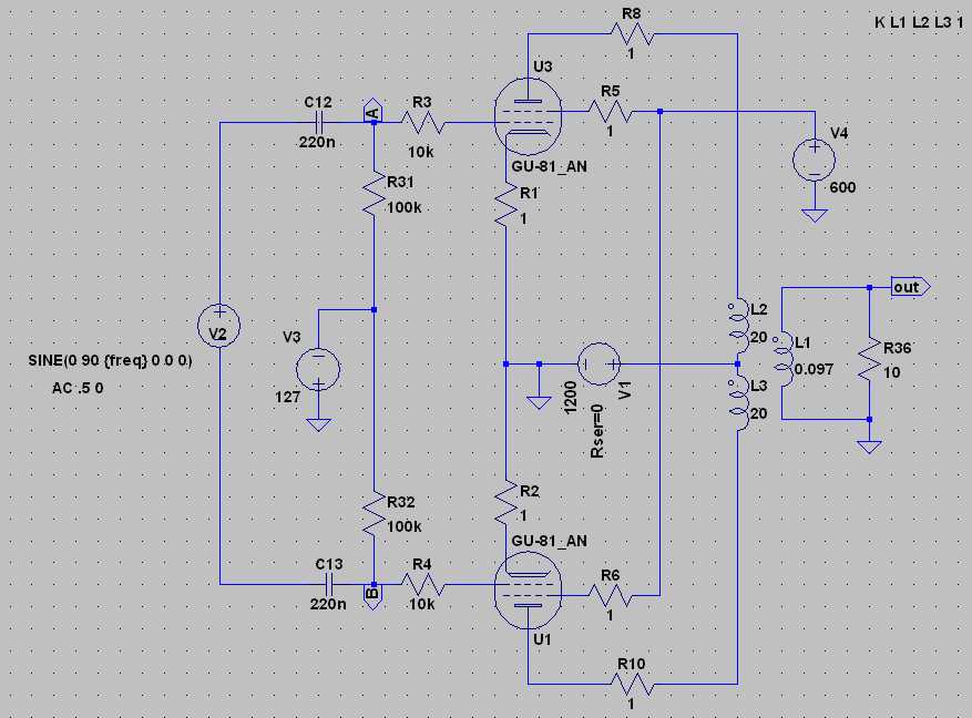

I made some quick LTSpice simulations with push pull circuit.
The operating point was: Ia = 238 mA, Ig2 = 65 mA, Ug1 = -127 V, Ua = 1.2 kV, Ug2 = 600 V. OPT series resistance was 200 ohms anode to anode.
I varied the OPT impedance between 5k to 8k2. The performance in general and linearity seems not to be sensitive for load impedances I used.
Some sort of max. output power is about 350 W and THD then is from 3.5 % to 4.5 %. Below 200 W THD is about 1% to 1.4 %.
The screen stoppers should be as small as possible (<100 ohms). These have strong effect to available output power.
I don't see any reason for cathode follower drivers. G1 voltage stays allways far from grid current area.

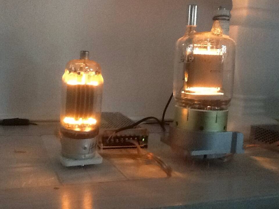

Speaking of output tube filaments, which require 12,6V @ 10,5 A, what would you consider as the preferred option:How about the filaments ?
a). A toroidal transformer with 12V output and sufficient current capability,
c). A plain vanilla SMPS, of type MeanWell SP-150-12
d). As c). but with additional CLC, where C=150000uF/16V || 1uF foil || 47nF and L is a few bifilar turns CMC choke on a ferrite core

Are you asking me ?
I am asking Koifarm how he plans to do this.
I do not have too much practical experience with direct heated tubes.
I have built one 811A and a 813 SE prototype with AC-filaments.
I got > 65 dB S/hum, so propably I would try the same principle.

The reason why I ask is that recently I had a heads-on argument with a guy who made it on SMPS supplies, with output filtering. Indeed, no hum ... nothing. Seems to be an unorthodox, but "reasonable" way to go, or at least to try it out.
See post 63 for the schematic.
I use cheap chinese SMPS for the heaters in several direct heating amps. No hum or noise at all. at the moment i use a fu13(813) amp to.
I run the smps with NTC resistor to slow down the startup current.
I use cheap chinese SMPS for the heaters..
Can you suggest any supplier ?
Do you have one SMPS divided for both GU81's ?
