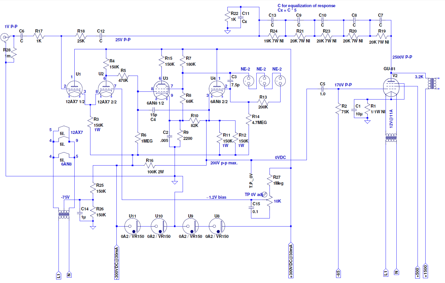

Hi giorgos,
I was only (half) kidding before ;)
However, I have to say I must agree with Bandersnatch about the SE vs. PP choice. It's insane to build a SE amp using this tube, EVEN at low output power. The requirement causing the problem in the OPT is not power but it is the primary current. High DC current -> large air gap in core -> low primary inductance -> bad bandwidth ...
I would recommend PP but of course this brings it to 4 tubes for a stereo amp... Maybe that's too much overkill :(
Perhaps, given the low power level, parafeed-SE with a resistive anode load is a possibility?
Kenneth
Without reading all that is written here I still would like to suggest to study the possibility to make the SE version with hi-mu triode connection.
This is g1 + g2 connected together.
Then the standing current is essentially lower and the gain relatively high (>100).
But ofcourse this requires A2 operation, i.e. driving power.
I have used much smaller GU50 this way and the results were very promising.
The power output was 15 W with 800 V supply voltage and 45 mA idle current.
The OPT was 10 k.
perhaps ??????? can we do that way???
I would suggest a solution for OPT: take Hammond 1650R PP trans, make air gap, so you have SE with Imax = 380mA, and RL = 5k. Bat this is compromise solution
resistive anode load need to 1800 V Ua, and R 5k 400W

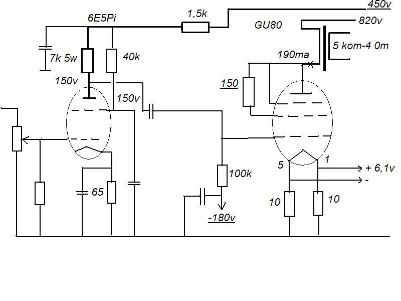

GU81
Hi Fishbowl! Inspiring projects you do :)!
Would love to learn more about your GU81 experience.
How does it sound, esp. on bass?
How much power do you get? Do you use feedback?
The grid current you mention: when does it start to appear
and how heavy it is at 0V bias?
I'm thinking of a dedicated bass amp (200Hz max)
around it. Looking at the curves (if they are reliable??)
I've figured out 1500V/300mA
-85V loaded with 3.2k should give up to 190W.
For the driver I thought about triode-connected 6E5P, DC coupled, but no idea on how much power the grid would like to see at 0V???
THanks!!!
phixphi

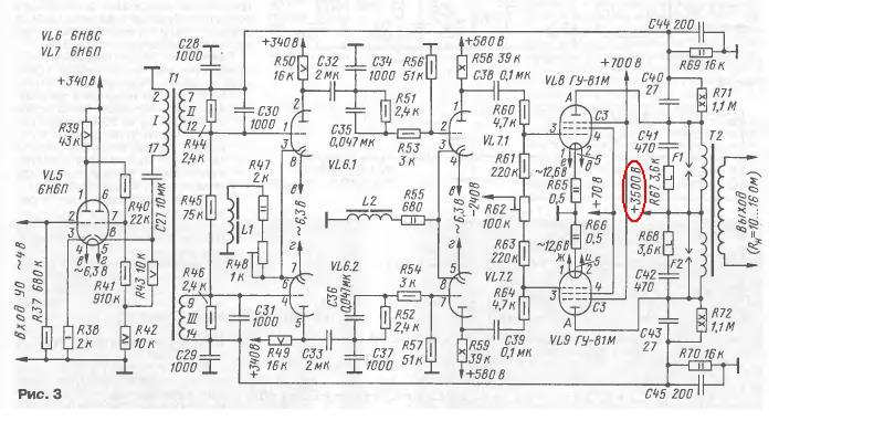

Hey Guys, I have a working monoblock, push-pull, pure class A, based on a pair of two GU-81M (actually, GU-80 - very similar) tubes.
If anybody still interested, drop me a line.
Some preliminary photos / flims - can be found on my facebook page, as well as on my blog (hiend-audio.com)
Or on my Facebook:
https://www.facebook.com/zygmunt.jerzynski/photos_all
Ziggy.
