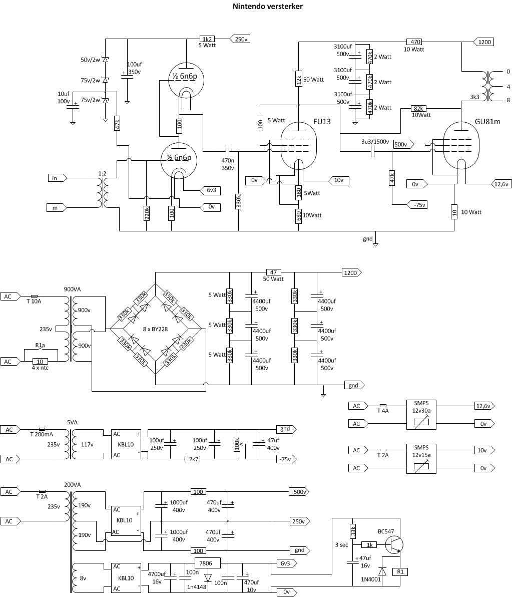

-Yes that was my thought to , to make Hi quality sounding (Ab) class not (aB) class PP pentode connected OPS , where A class region of PP- OPS operation will be maximum extended before OPS enter in B class region of operation .
-Found that best compromise between many factors for those Russian RF power pentodes and used for A class of operation is when B+ G2 x 2 = B+Anode , for example , GU13(813)- B+G2 =0,75KV x 2=1,5KVB+A , GK71- B+G2=0,4KV x 2 = 0,8KV B+A , GU81M -B+G2=0,6KV x 2 =1,2KV B+A , .... and of course always with G3 tied to ground line .
-Further I will strongly suggest to you to go with DC coupled CF driver stages , bipolar supplied , and I think that standard EL84(2x) tube triode connected can do the nice job , in this context check schematic from that old Philips EL6471 - 1KW amp , If I remember correctly there two EL34 drives two tetrode QB3,5/750 DC coupled .
- If you need I can draw you quick concept schematic .

If you could drop me a draft drawing of your concept - I would be very much obliged. (Yes, Please!).

Very nice. Classical but nice. The Power supply is familiar. Similar to the one I have, slightly different configuration, but same topology. So you suggest to go for a dual symmetrical voltage feed for a simple Cathode Follower pair ?Here is the quick concept draw , BTW this concept also mean GNFB free Ab class PP amp to .
Hmmmm ..... I think I like it.
The more so that I have a few additional power transformer tappings which I could use for this ...
My OP Transformer is 6600 ohms (from anode to anode) .. into 8 / 4 ohms.How much power is expected ? What is the impedance of the OPT ?
Initially, I was hoping for some 100 Watts in pure class A (with a "classical" pentode topology, i.e. not naughty topology, which was the earlier version of my schematic that I posted). That would be the amount of power achieveable from the "A" characteristic - as derived straight from the pdf file and the anode characteristics graph.
But now .. now it is a slightly different story. Franky, with this "naughty" configuration that I am using lately - I do not know "what" to expect. With the S3 UL approach, the amplification factor changed significantly and the "new" characteristics are utterly unknown to me, apart from a few point to point measurements I made.
I am hoping that with the "new topology" and with the same 6600 ohm OPT I will get a similar 100 W of class A output, albeit with a much higher input signal sensitivity.
Whatever it will be - it will be more than I will ever need. For home use, at least.
