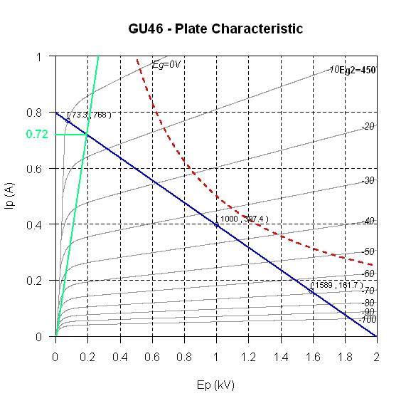

On that load line, for what ever its g2 voltage is( 5 or 600V IIRC ), it should be reduced so the g1=0V line happens at that current delivery. I don't quite see this GU46 running U-L. Local FB pentode will deliver the required output impedance...which is a fine quantity to reduce...
cheers,
Douglas
In which way you want to apply that Local FB pentode ?
Eg2 was 600V in the Ep-Ip chart (post 21). Below is the Ep-Ip characteristic with Eg2=450V. The operating conditions are Ea0=1000V, Eg1=-34V, and Ra-a=5k. The Spice model isn't that accurate, so please ignore the saturation region, instead use the diode line shown in green to get the estimates for Ia_max and Ea_min, in this case, they are 720mA and 200V respectively, so Po is still around 280W as calculated before.On that load line, for what ever its g2 voltage is( 5 or 600V IIRC ), it should be reduced so the g1=0V line happens at that current delivery. I don't quite see this GU46 running U-L. Local FB pentode will deliver the required output impedance...which is a fine quantity to reduce...
cheers,
Douglas

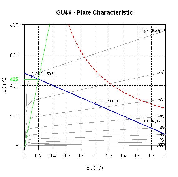

On a more serious note, below is the Ep-Ip characteristic with an even lower Eg2 of 300V. The operating conditions are: Ep0=1000V, Eg1=-20V, Ra-a=10k, with a Po of "just" 170W.
If you bump the load 2x, you notice it can swing a lot higher delta towards cut off than towards saturation. If you must run a 10k a-a, might as well bump B+ to 1k5V... Then the 300mA idle current will net higher anode dissipation.
A good 10k a-a is difficult around 60W...not much chance of success going bigger.
cheers,
Douglas
