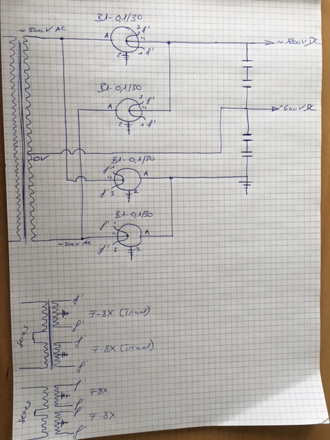

Question about the power supply drawn by Banat (see post 6), I thought about using rectifier tubes, as mentioned before.
Could the diodes be replaced by high voltage vacuum rectifier tubes like the russian B1-0.1/30 (V1-0.1/30)? These are half wave rectifier tubes, this means 4 tubes would be required, when replacing each diode pair by a tube, or like drawn in the navy NEETS Docs
Navy Electricity and Electronics Training Series (NEETS), Module 6 - RF Cafe
Yes... 4 tubes means 20A at 5V... But we already reduced consumption by going SE 😉
They should be able to deliver the A at around 450-500VAC, they are said to be good for 400mA at 30kv.
It could be done by using the 2 serially connected Triad F3x Transformers, one supplying the plus rail and one the minus rail or using two separate Hammond 76VA filament Transformers for each rail with a 0.1R/20W resistor to reduce voltage from 6 to 5V.
just like this
otherwise you get hum
not easy to find 5V CT 10A
triad F-8X only 6A so you need four of this one
one each tube

The B-1-0.1/30 has a heater center tap for the drain of the rectified power, I think.
Claudio, the triad F-8X transformers a a good and valuable option to Hammonds 6V Versions.
I attached a small schematic for a PSU with B1-0.1/30 tubes, but forgot to draw bleeder resistors. C is around 50uF per tube.

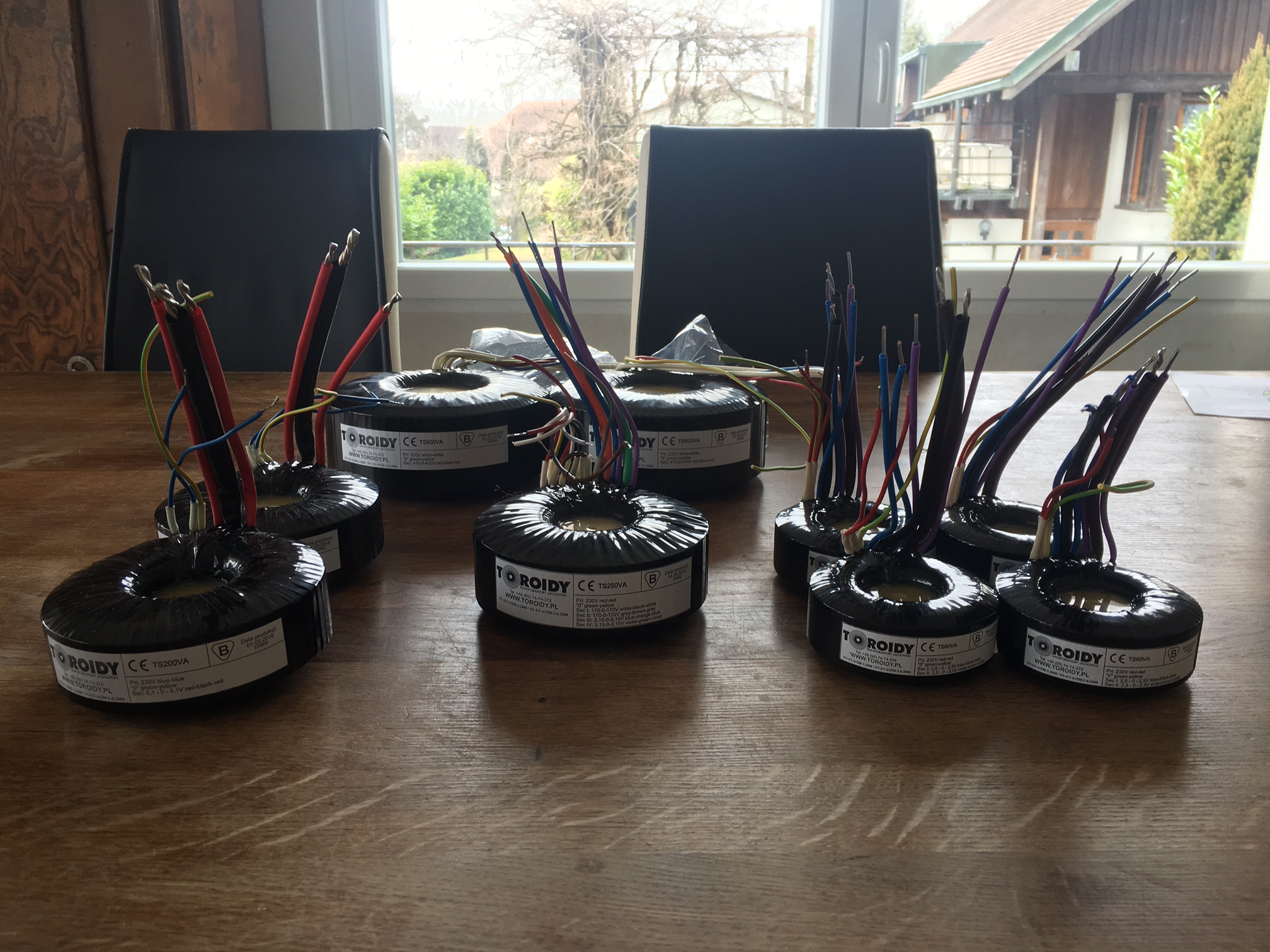

Tomasz from toroidy.pl is going to custom build the toroid power transformers
2 trannies 470-0-470V 800mA for the B+ supply and grid2 of the GU-46 and the voltage amp tubes
1 tranny 2x 170-0-170V 0.3A, 2x 3.15-0-3.15V 3A for the negativ bias and voltage amp tube filaments
2 trannies 5.1-0-5.1V 20A for the DC supply of the GU-46 filament
4 trannies 2x 2.5-0-2.5V 6A for the rectifier filaments
electrodump.nl supplies 2 8H 500/750mA 6.5kV chokes for the anode supply of the GU-46
The 4 10H 500mA 1000V chokes will be from Hammond (193Q), unbeatable for custom winders
This will already be about 70kg of Iron... Some additional kg will come from the large NOS 930uF/450V Nippon Chemicon caps, and the smaller 470uF/450V caps, the cirquit itself and the chassis (which will be made out of Industrial Aluminium profiles like in my last project

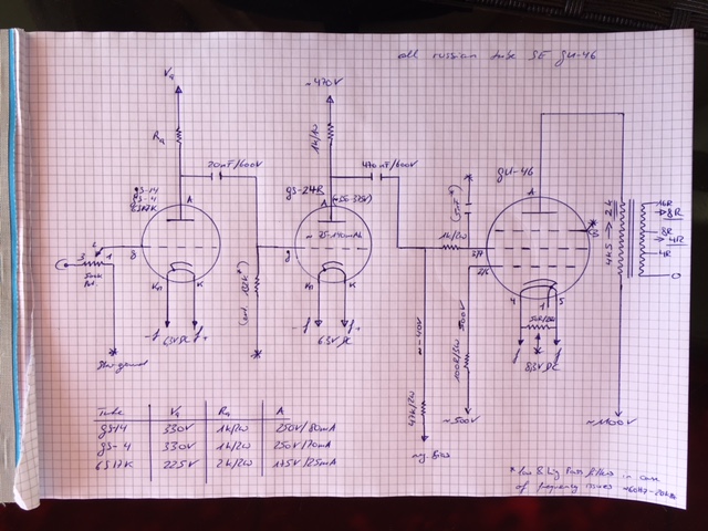

The project is currently in hold due to cost reasons, but I worked out a schematic using russian UHF triodes (GS-14, GS-4 or 6S17K as first step, GS-24B as second step) for amplification followed by a GU-46 in SE.
I found someone to build the OPT as 4.5k primary, 4, 8 and 16R secondary, so 2k primary is feasable by using the 8R as 4R.
Suggestions for the attached schematic?
Greetings
- I think that you have reversed G1/G2 on GU46 power pentode ,
-both input and driver GS triodes obligatory need grid stopper resistor soldered close as possible to tubes grids ,
- I guess that that both GS tubes is self(auto) biased ?
btw , IMHO ideally(THD& musically wise) your SEP power amp need to be two stage based , not as is shown three stage based, with just one input and in the same time driver tube , but honestly I have no answer which tube will be the best choice for that purpose.?
Regards
Hi banat
You're completely right, grid 1 and 2 are reversed.
The triodes are filament biased.
I thought about using a two stage amplification section because the small GS tubes do not deliver enough swing to drive the GU-46. All of these triodes seem to be very linear in the voltages proposed.
I will have to test the best set up probably.
Thanks a lot

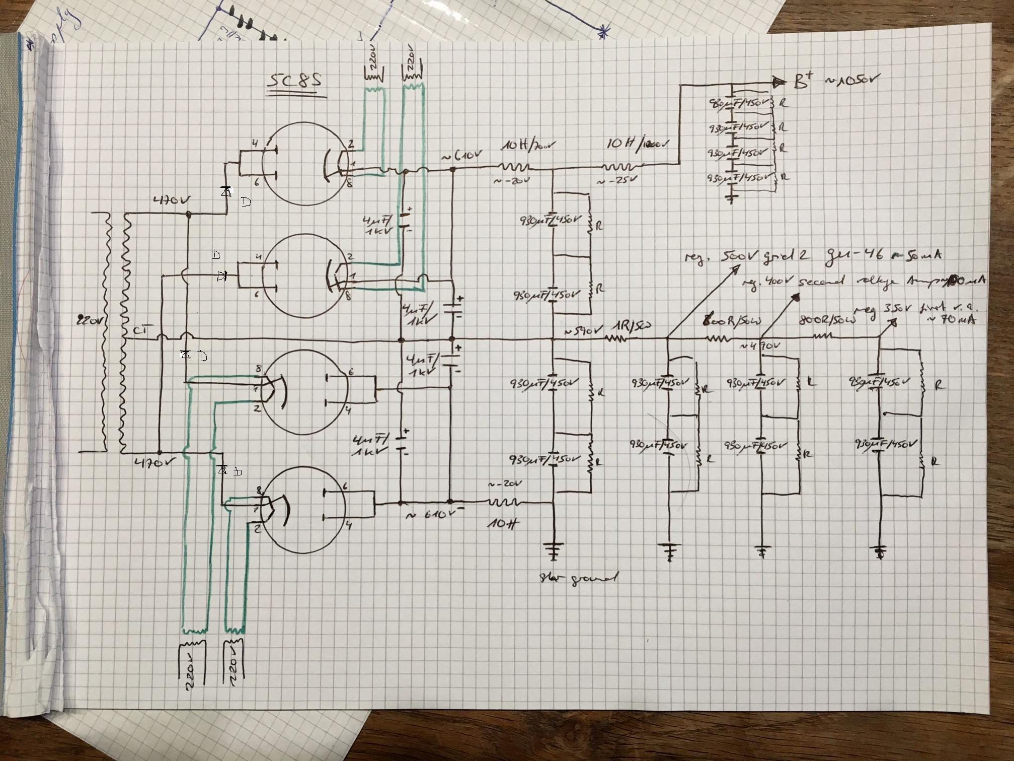

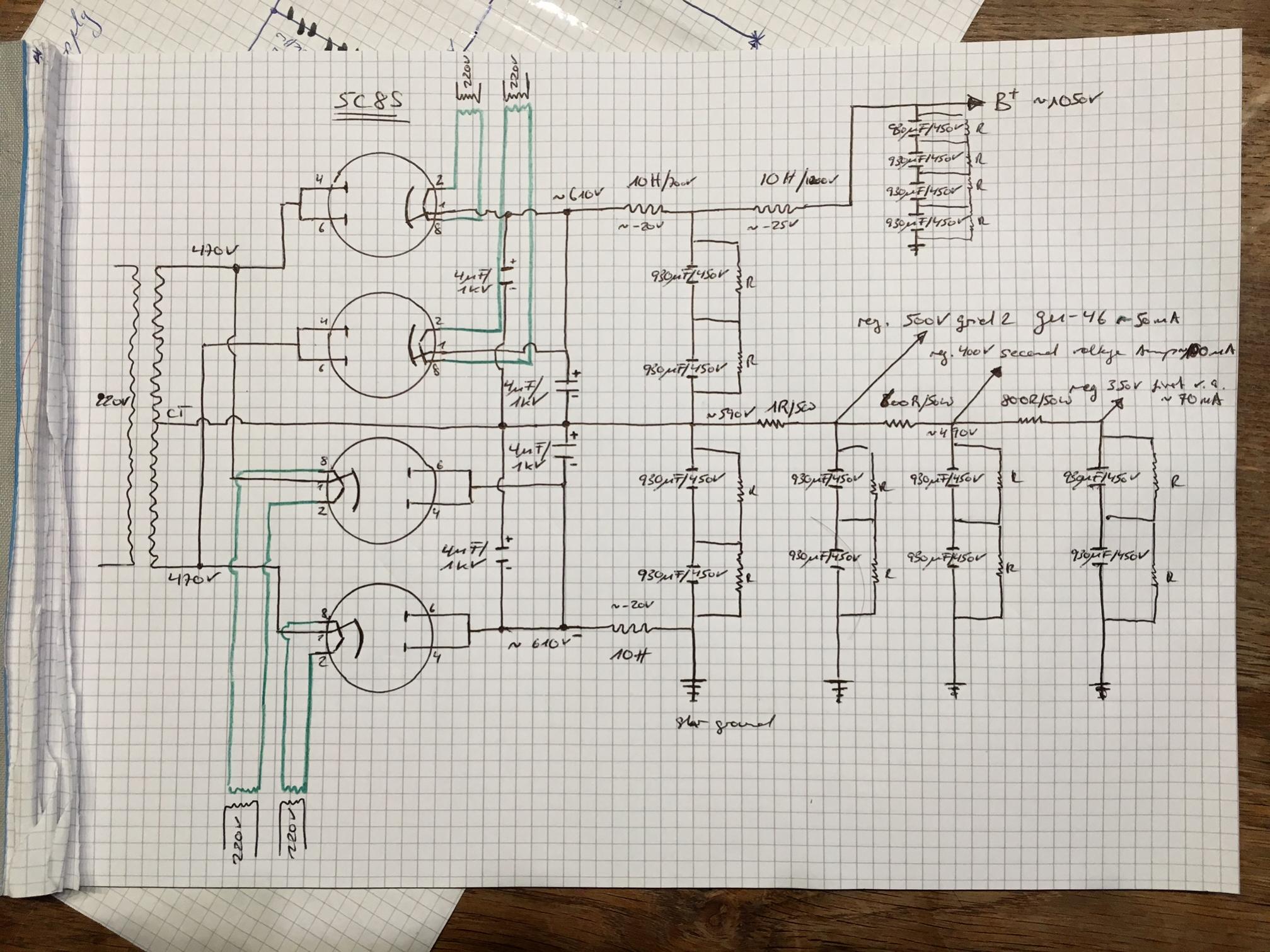

PSU question
Dear all
I am currently working in the PSU of the GU-46 SE amplifier.
I decided to use 5C8S rectifier tubes, two in parallel per phase of the power transformer.
These Kenotrons have a rediculously small capacitor requirement, just 4uF for the first cap before the choke.
Now my question, is the following PSU setup correct (it is an adaption of Banats drawing). The point I am not sure of is the first caps connected to the paralleled Kenotrons, followed by the choke and a second set of larger caps and then one side to ground to lift the voltage in the CT.
A critical review would be appreciated.
Thanks a lot
Hi Thomas
-Your basic PSU design is OK , but I suggest you to add one 1N5408 diode series connected with each 5C8S rectifier tube , those SS diodes will act as protection,
-make sure that by 5C8S tube pin 1&2 is K+(f) , pin 8 is only (f) , and pins 4&6 is anodes .
Best Regards
Dear all,
attached you will find the schematics for the PSU's and for the single ended GU-46 amplifier (with a try for a variable NFB).
I am aware that my 3stage approach might lead to difficulties due to distorition etc. Nevertheless I want to try if it works, otherwise I will have to go back and take another round. I plan to bias the voltage amplifier triodes with resistors (heater bias level); but I am not sure if I calculated them correctly (R= heater voltage / heater current), i havent found anything helpful on the net about that.
And for the GU-46 filament, I would like to measure the Amperes of the tube; therefore I plan tu use a 1R resistor to ground; does that work (calculated this resistor would need to be 0.5R)?
Critical Reviews and Inputs would be very appricated.
