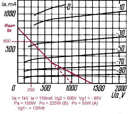

Would it be possible to use the following set up to drive the GUs
1st stage:
6SQ7 (B 350V, Ra 138k, Rc 2k7, Cc 30uF) or 6SJ7 (B 450V, Ra 122k, Rc 2k3, C g2 220nF, Cc 100uF) latter would have lower impedance
2nd stage
6SN7 LTP (B 450V, Ra approx 32k per side, Rc tot 26.5k (made of Rc 1.5k and R rest 15k), R grid 1 and grid 2 to Rc end 1M each, Cc 100nF)
3rd stage
El 84 or EL34 pentode mode or cathode/grid 2 coupled to GU as in the Philips cirquit
Stages connected with coupling caps, eventually using grid stoppers 1k
There are many interesting Feedbacks... This doesnt make it easier.
150W would be fine, but it should come clear and clean. Probably not realistic...
Thomas
Going GU46 in triode mode to me automatically means DC coupled driver stage , going in pentode mode it can be AC coupled also , what important to consider is next , if we have reasonable efficient amp with PP-OPS working in pentode A1/AB1 class mode and is GNFB free, with 1,2 KV-Uba ,Ubg2- 0,6KV and g1/g1` is biased around -65 V than front end/driver stage must deliver around 130Vpp undistorted drive AF signal for full excitation of OPS , good praxis is to design front end/driver stage which can deliver at least twice of that value , that mean around 260Vpp , I think of one topology which can do that is one 6J5 triode on the same input further DC coupled to two EL84 connected as differential pair (phase inverter/driver) working in pentode mode .

EL34 with an 10k, resistive plate load, connected up to a 15% 'screen tap', with 50 mA of idle current per tube. A means of delivering a g2 voltage with a 100 mA, g1=0V plate curve will match to this loading. It will be able to do +/- 200V standing on its head, with one hand tied behind its back since it will be looking at the 1kV of B+ that is feeding the finals. Take EL84's as an LTP input stage to drive the EL43's. Try triodes, and if the gain is too high, swap in EL86's whose triode gain is half that of the EL84. If you do pentodes, just cut the driver plate loads.
There is NO need for AB class...or for requiring nuttier insulation that a higher B+ would need. A 500 mA, 1kV supply is no laughing matter, and it will need to be pretty smooth. Rectify with some || 6CJ3's.

Just want to re-visit the issue of the driver, please refer to post #21, Eg1 only needs to swing +-40V (-30V to -110V), which is really not much, so why all the talk about using cathode followers and EL84's? It's not a particularly difficult load to drive, is it?
On that load line, for what ever its g2 voltage is( 5 or 600V IIRC ), it should be reduced so the g1=0V line happens at that current delivery. I don't quite see this GU46 running U-L. Local FB pentode will deliver the required output impedance...which is a fine quantity to reduce...🙂
