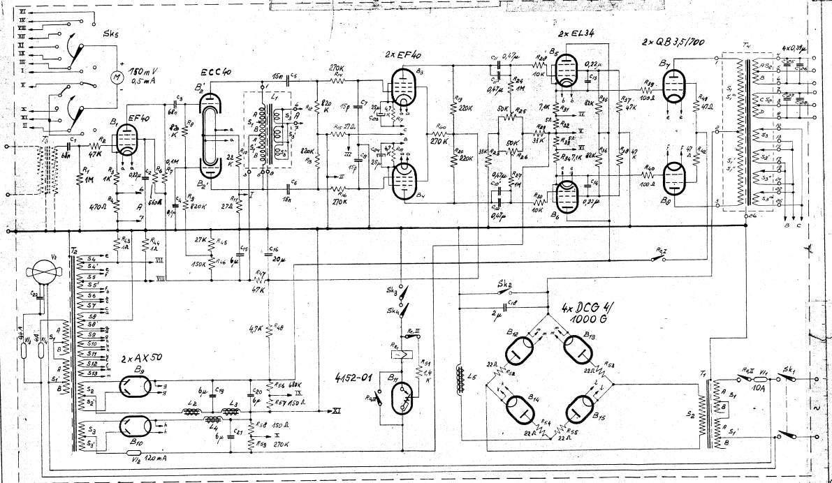

There is no need to re-invent the wheel, you can use the PS design from the Philips EL6470/6471, substitute a power transformer with lower voltage, and scale the components (HV rating) accordingly.
No, not seriously. Sorry. Remember the EL6471's three-phase PSU! Of course I know that it could be rewired for common (one phase) AC supply, but there's still this tiny 4 µF filter capacitor left, which may suit for 300 Hz ripple with it's notches never getting close to 0 V, but will fail filtering a two-way 100 Hz ripple sufficiently.

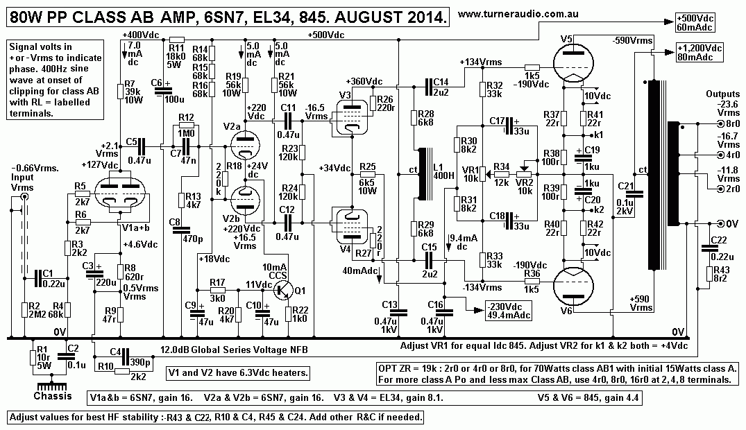

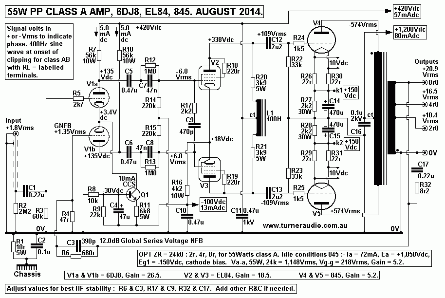

Thanks! That's about ten times the price of GU-50's. As we can easily extract about the same power form three pairs of these with a modest 800 V plate supply, they offer the better bang for the money, I'd say. We'd need a more elaborate driver section, though, as they must be operated in class AB2 to get 120 watts per pair and need a larger grid voltage swing.

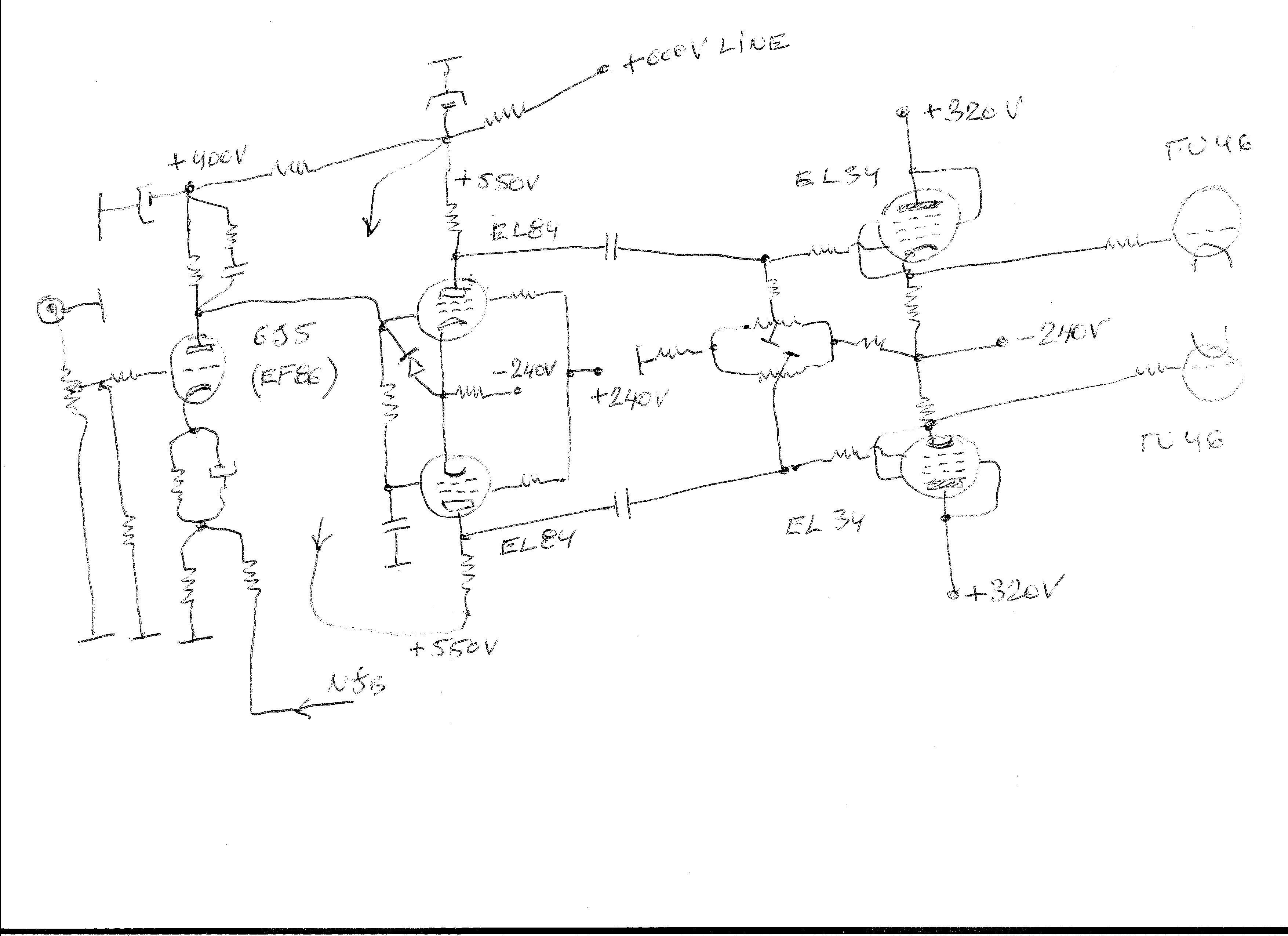

If balanced AF input is not necessary same as balanced GNFB as is by Philips amps but only SE AF input maybe something like this configuration of input/driver stage can also work and sound well to ?

Oh my...I think we can do without grid current, as ~300W is easy in Class A1. We also do not need any gNFB...why wreck things, and include an already marginal bandwidth output TX in the FB loop. I'd rather load all 6 chambers and play Russian Roulette.

Well that configuration with EL34 DC coupled to g1 grids of GU46 do not automatically mean constant grids currents flow and constant A2 class of operation , that effect will appear on full excitation of OPS , but is good solution to avoid blocking distortion caused from coupling caps and g1 resistors network ,and to get instant overload recovery in case if grids currents starts to flow ,
that my proposed schematic also do not means tons of applied GNFB , maybe just 5-10db max.
Regards
With EL34's in circuit, I'd just use 'em as voltage amps. Full pentode rigging...and they won't be so worried about possible high plate voltage. Use the g2 voltage to tune them to their loads...🙂 On top of that I'd still do away with the gNFB, local as in Schade resistor, or direct from U-L tap E-Linear is useful for several reasons.
Split C-T grid chokes and coupling caps that are not small will take care of the finals.
