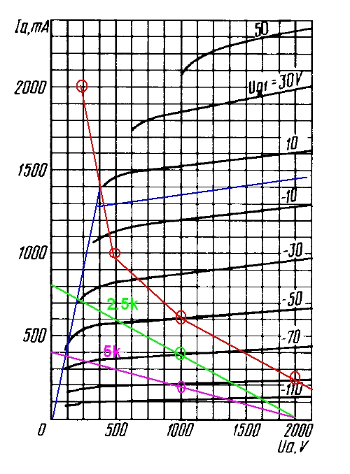

@Thomas - If you do not need such high power, then the output tube selection seems somewhat odd... Using Douglas' suggested 10kp-p, with 200mA bias, the output power is 108W, while with 5kp-p and a hotter bias of 400mA, the output power is 181W, both are before OPT loss, which probably will be around 5~10%. These are the lowest output you can get, since both are running in Class A only. The load lines are as follow:

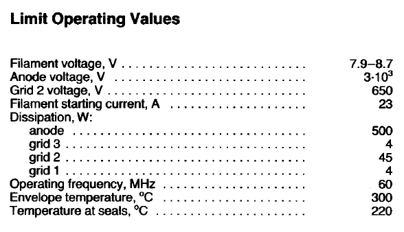

Pa_max is 500W per the datasheet:
The 5k a-a, when run with its g1=0V line adjusted by lowering g2 so that it takes up the space where the -30V line is looks like a reasonable place to start. 800 mA at 1kV is not going to be light. Put the power supply on a self-powered, wheeled vehicle...🙂
cheers,
Douglas

A misunderstanding. Lowering the g2 voltage will lower the g1=0V line to the space occupied by the g1=30V plate current line. It is not g2 being -30V, it is adjusting g2 volts downward so that g1=0V has the same plate current as the g1=-30 does at 500V on g2.
5k a-a, with a 400 mA idle point will be fine, and at 80% of maximum, should keep the anode hot enough to do its duty as getter.
cheers,
Douglas

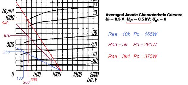

Made Ia-Va cuves from the little info i found.So only an aproximation.
Mona

You are right, I used the wrong formula for the above calaculations, so please ignore them! Looking up RDH4, the correct formula is:
Po = 0.5 x Ia_max x Ebb, so for the 5kp-p load, Po is about 280W!
I have to ask what are your numbers? I use your formula and get 360W...which is pretty close to the way I calculated it and got 350W...🙂
I make Ia_max at .72A btw.
