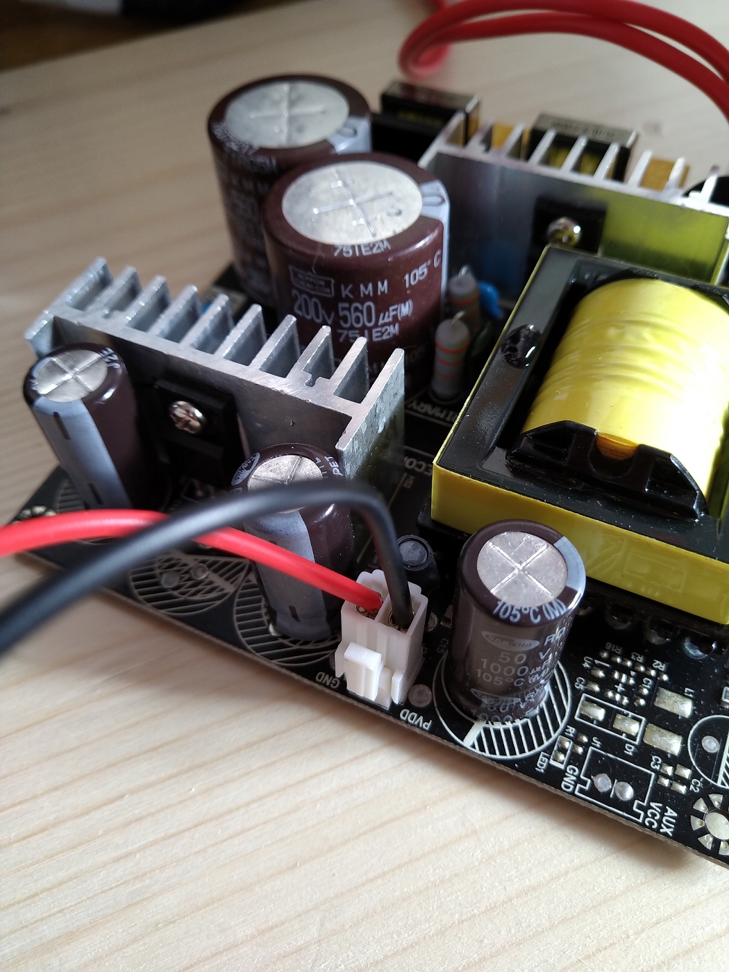

A bit of warning here. Check the correct polarity when connecting the SMPS to the amp board with the supplied cable. I didn't... My cable was reversed in color (I know it should be RED + , BLACK -/ground). Hope I didn't manage fry anything. No magic smoke... Yet 🙂
After that I have tested the boards with the DSP and Bluetooth module for a brief moment. There is a lack of bass (no lower end whatsoever), hope is just the profile of the Bluetooth settings that broadcasts as a BT headset... Or some settings in the DSP not seeing the BASS pot level and not the reversed power wires from earlier on.
The part that I don't know how to address is that the sound is full of noise. Guess the ribbon wires from the DSP to the amp board are catching a lot of Bluetooth processing action. The sounds get a bit cleaner when I have powered the DSP using an external 5V battery pack and not the 12V source from the ampboard. Is it a lack of grounding or just bad non-shielded cables?! Isn't the output from the DSP to amp balanced?!
Oh, there is a fair amount of coil whine too, guess is from the SMPS. Will that pass in time?! 😀
Other then that, all looks good. Nice soundstage, even on my cheap-old Technics SB-EX3 speakers.
Any tips or HOW to's are welcome

Bulibasha — the lack of bass is because the DSP is set up as crossover out of the box. You’ll need to hook up the USB cable and use Sigmastudio to load a new program. This caught me by surprise too.

@kday, thanks for the info... I have managed to connect the DSP to the PC but this thing is fairly complicated, for the moment 🙂)
@3eaudio, is there a way you can help us with a "clean" DSP file, no filters, just bass, treble and volume for bluetooth module and analog in? That until we get the hang of this Sigma studio DSP stuff.
@audio mo, don't get me wrong, it is good already but will hack it until is gr8! 🙂

Managed to sort the noisy 12v amp supply for the DSP, thanks to @FogAudio earlier post, made me curious about testing the pins in the SE -> Diff configuration at the input and BAM! it works, no more noise from the BT module! So now working in balaced (XLR-like) config. Clean sound! Nice sound! 😀
Managed to config the dsp to output to DAC0, DAC1 the full sound but no bass and treble adjustments yet, only volume works.

Try "link compile download" button for your edited scheme, and have a look at the right bottom notifier which should say "active: downloaded" when things go right(temporarily flashed the scheme to device). To get to that point you have to install USBi drivers and do stuff, according to how-to on manual @3e-website(where you got the project files from, i guess thats what youve been missing.). If that's all ready and set u have to write project to EPROM when youre done via sigmastudio/hardware config, right-click on the ADAU1701board to apply permanently.
