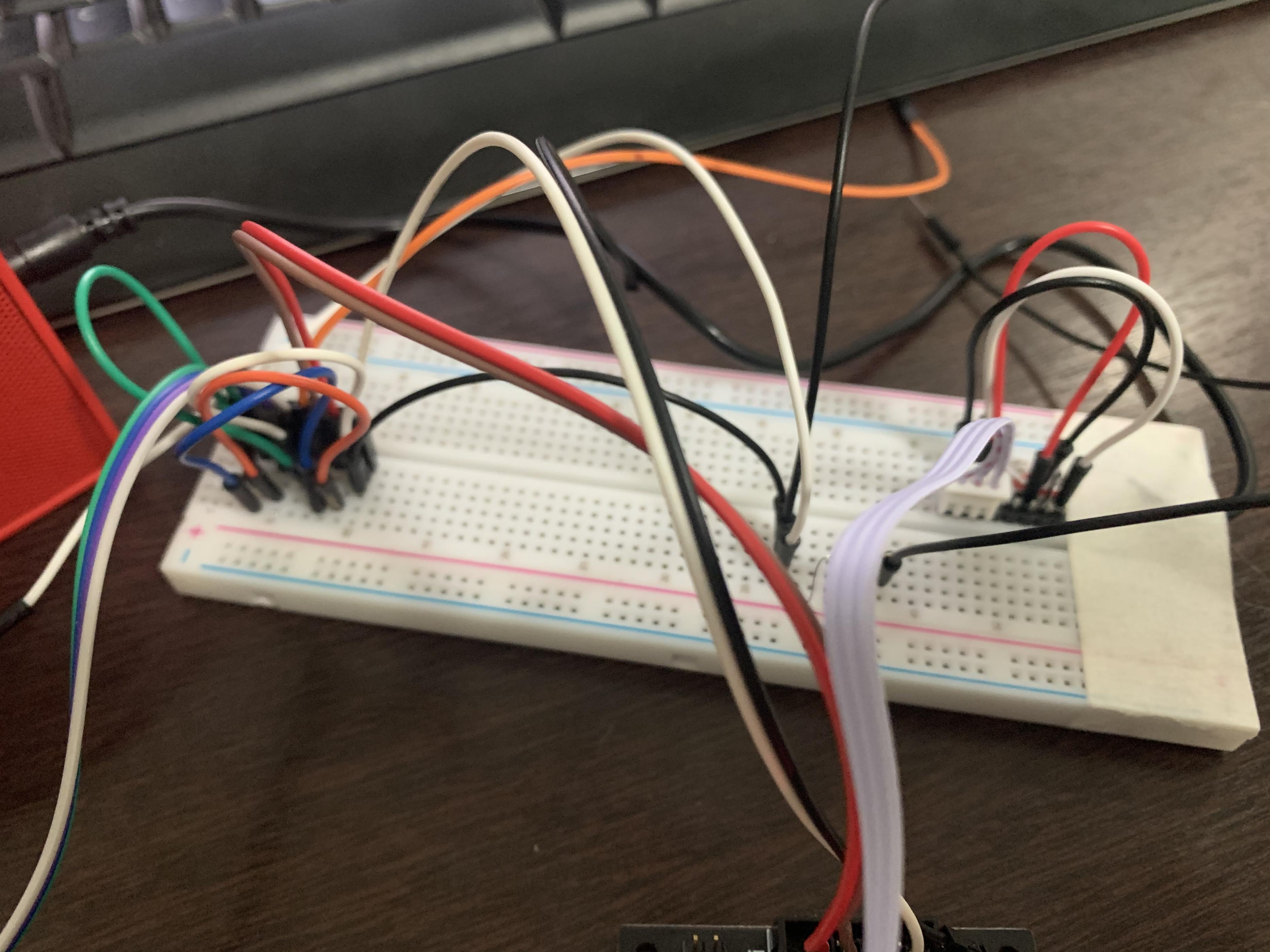

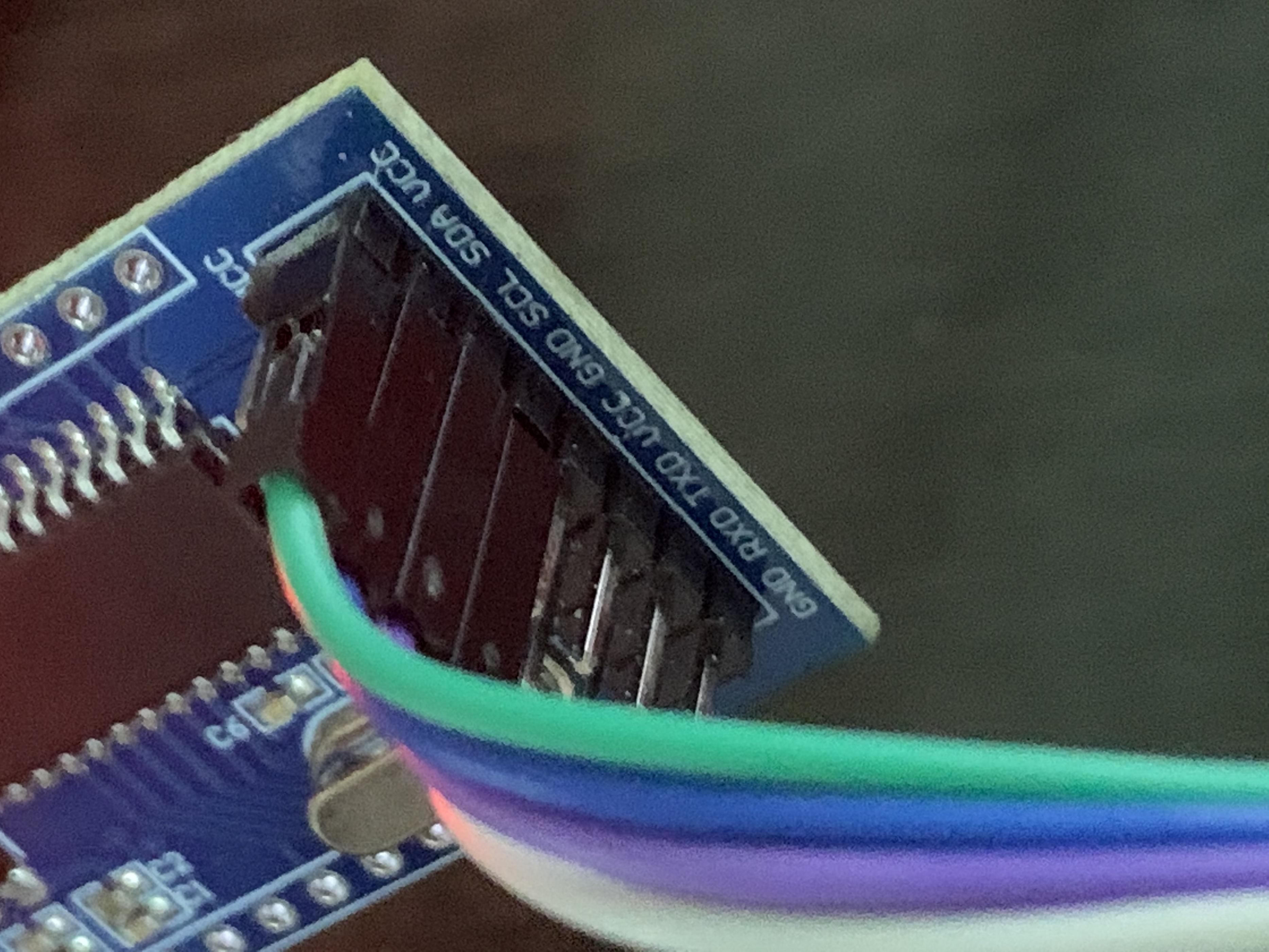

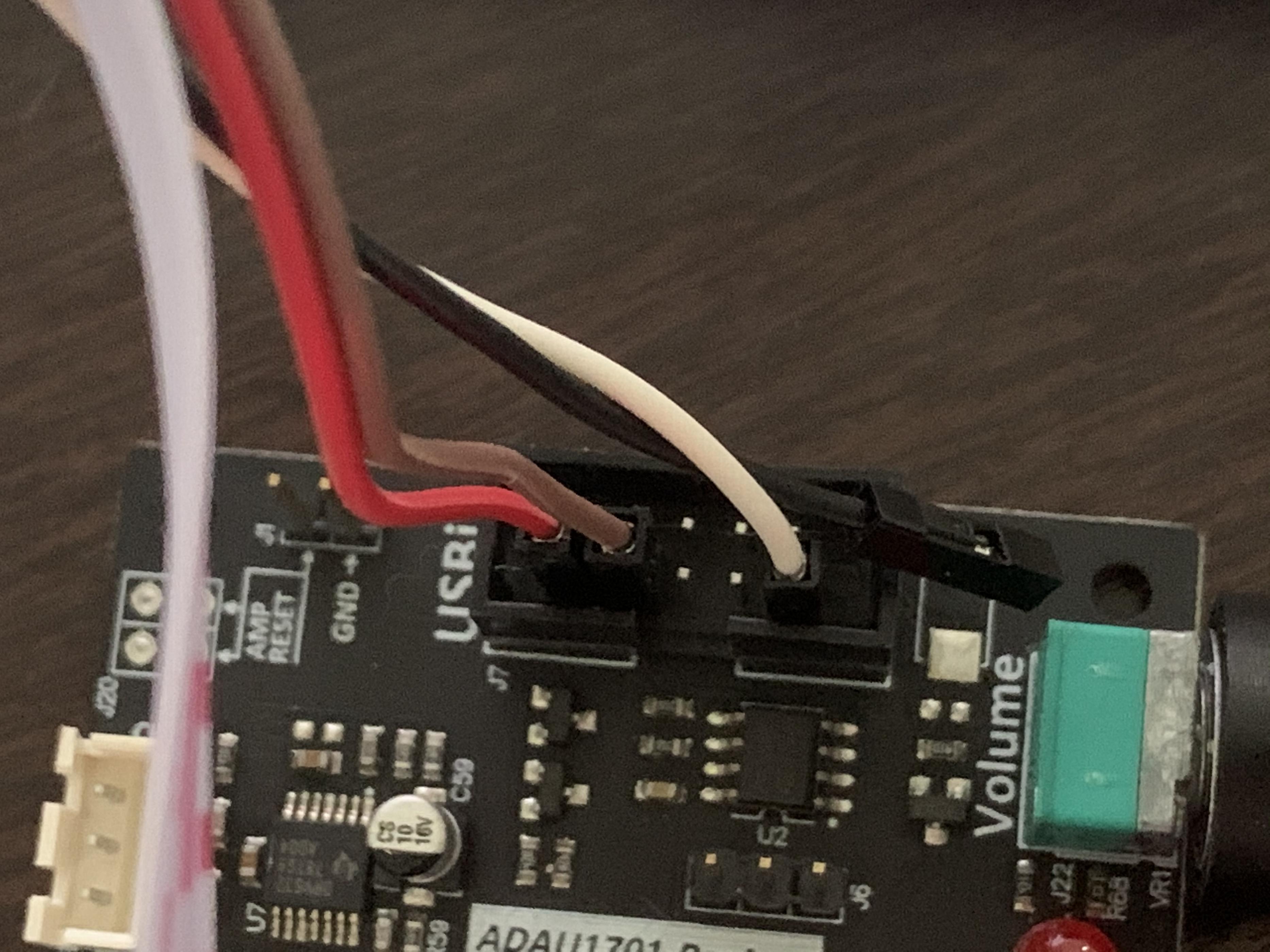

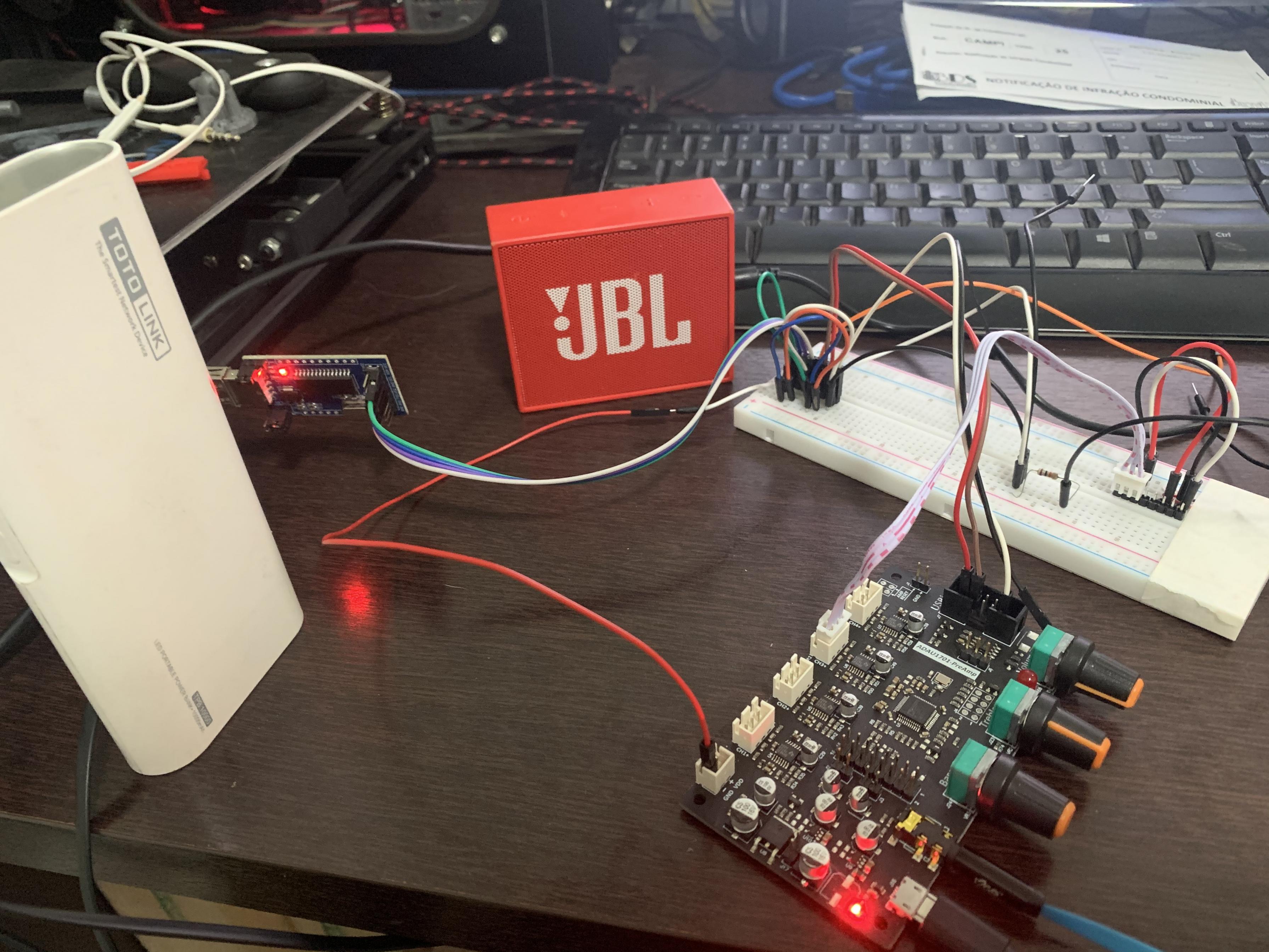

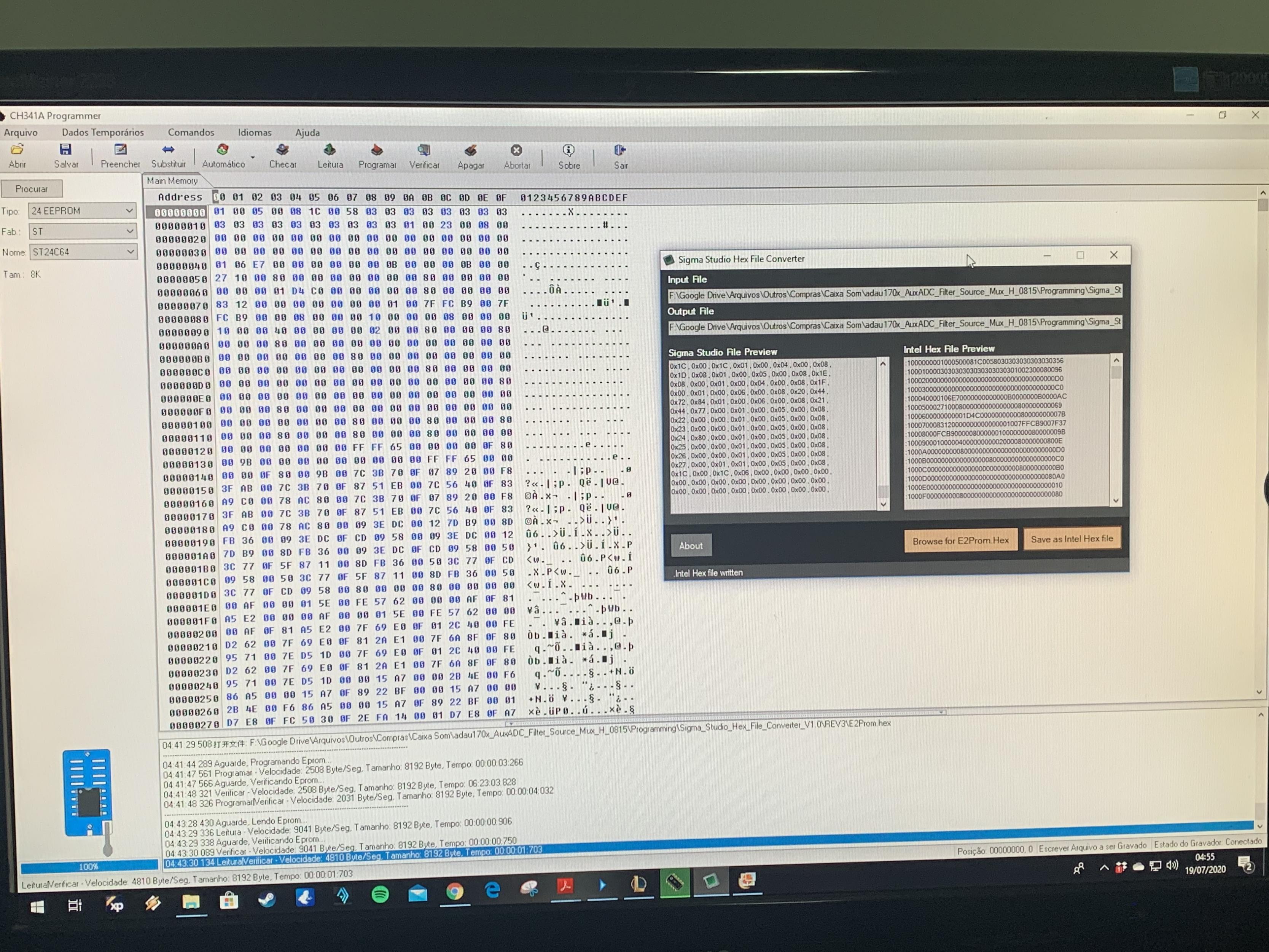

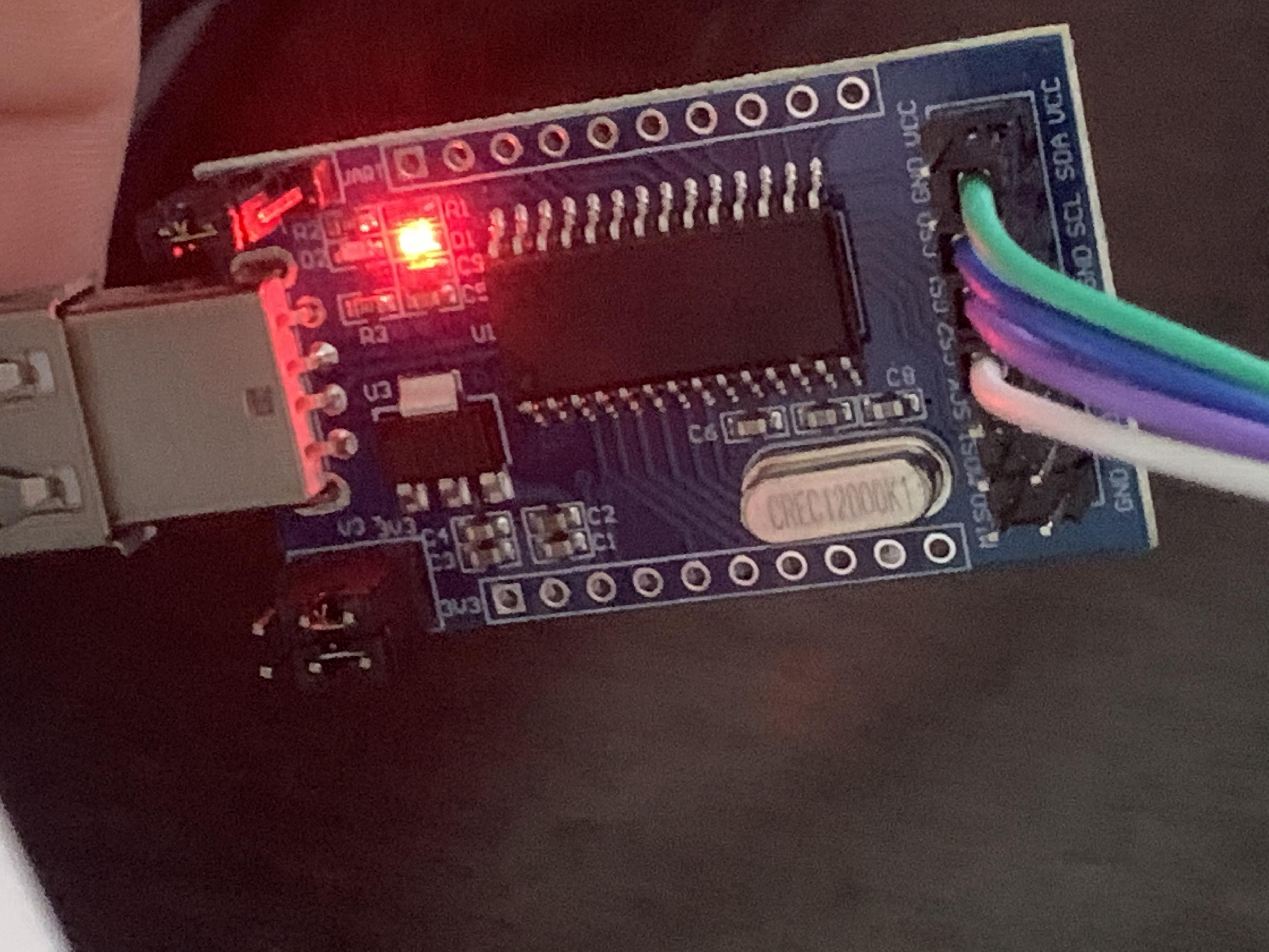

Hi, I think I found a way using a CH341A. I was desesperate to find a way so I learn about cy7C68013A and FreeUSBi but I didn`t had a cy7C68013A board and wasn`t patient to wait it come. So I tried to use my CH431A to program E2Prom in-circuit and got it!!
Actually I was afraid that I must use the instruction from AD to put my ADAU1701 in seflboot and was figuring out some way to do that and for first try I really did it, but after that I notice it wasn`t necessary, so let me explain what I did now:
Hardware:
EDSP-1701-24 (ADAU1701 board from E3Audio)
interface/burner board based on CH431A (less than 2 USD i think)
some wires and an USB cable
Process:
1- CH341A board with I2C comunication mode on from jumper and 3.3V set in the board:
2- proper install CH341A driver after plug it on my computer (Windows 10 64bits);
3- follow also the step 3 in FREEUSBi installation guide from E3Audio (don`t know if it is really necessary but I did http://www.3e-audio.com/wp-content/uploads/2018/12/FreeUSBi-Driver-Install-Guide_Rev1.1.pdf )
4- pull out jumper J3 and J2 from EDSP board
5- connect SDA, SLA and GND from CH341 board to USBi port (don`t need to connect VCC);
6- I also equalized GND from port J19 to my Breadboard (again, don`t know if that is necessary but I did)
7- Turn EDSP Board on;
8- on SigmaStudio, do all process to generate .hex file ("link compile download", "export system files" and "write lastest compilation to EProm"
9- find your project folder and find a folder that contains E2Prom.hex file (it`s "your_project_name"_IC_1 ou ***_IC_2 (depends on how you named ADAU and E2Prom in Sigmastudio;
10- Use software "Sigma Studio Hex File Converter" to convert E2Prom.hex file on a Intel file necessary to burn E2Prom;
11- Install a EProm burner, I used this (New_Oficial_ch341a_v134)
12- when software opens, be sure you selected proper Eprom you have (my case was 24C64 from ST) and if you are luck, you will be able to read and write from Eprom;
13- open file you converted into Intel hex file before here and proced with burning method (just press record...);
I did it with my EDSP on, even playing music but I strongly recommend due it with minimal interaction with EDSP ok, unplug any sound devices, amps, sources you can, let just CH341A and EDSP as much as possible.
This is how I got to program E2Prom in-circuit. Now I will test minimazing all those step, just plug minimum necessary cable, burn and play.
It`s a simple way to program your ADAU ok in this EDSP board, I can`t tell you if it will work on another one but once you can enter at I2C bus it may work fine. I still looking for FreeUSBi board because it let things more easiely and plug-and-play but now you can try something fast and cheap.
hope I have helped. If want more details I forgot please, let me know and I can help you!

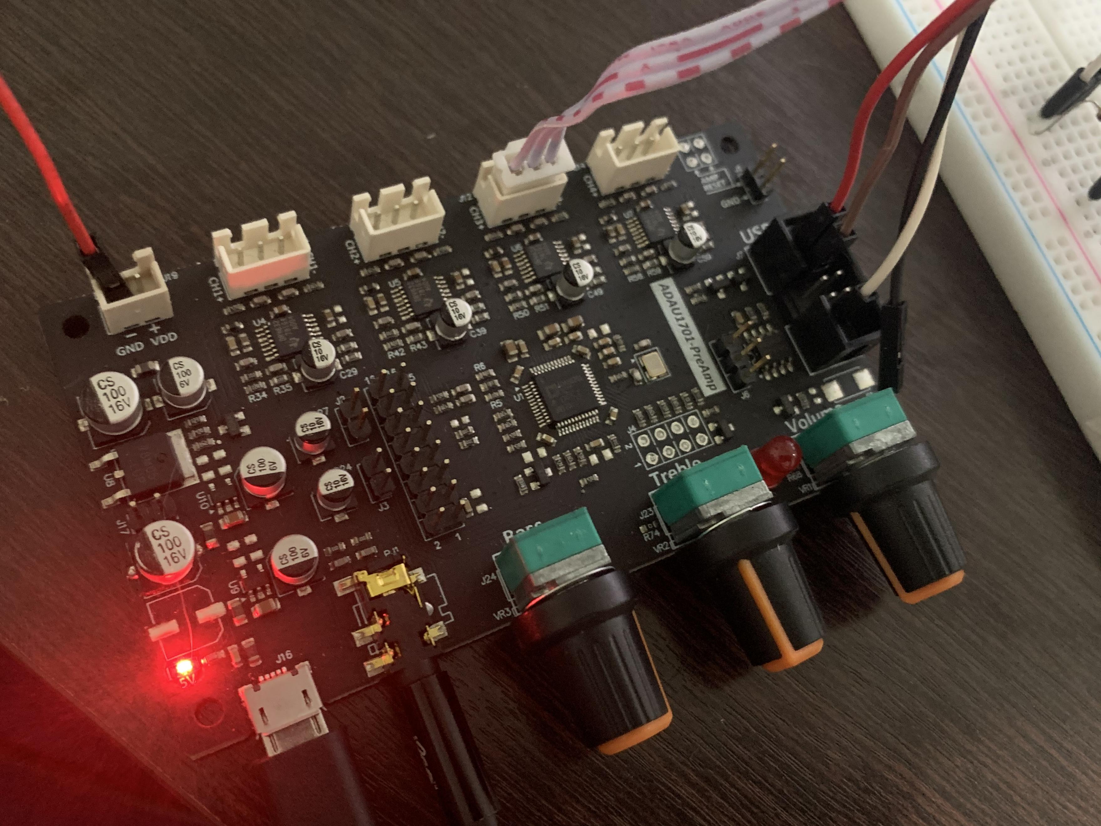

That LED from E3Audio board looks specific connected to some GPIO pin and controlled by SigmaDSP software. It is auto-mute block from E3Audio compilation. It`s ON when board detect some audio and OFF when nothing is comming from any input source. I didn`t removed it from my project because it works fine.
