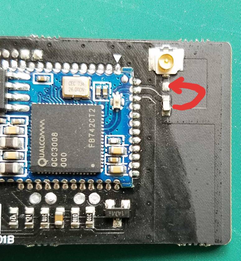

The only issue I’m having is with Bluetooth range it’s dismal at best I tried a couple of different antennas with IPEX end but still no joy anyone else is having the same problem how can I boost the Bluetooth reception?
when you use that extenal antenna,you need swap(need solder skill) the cap default used for on board antenna.Download the driver and sigma code from 3e-audio website, load sigma studio, load the code file, go into into second schematic tab, crossover then.....if you are using a proper stereo speaker with built in crossover and protection just remove the low pass filter compile download and then write to DP’s memory you should be laughing afterwards

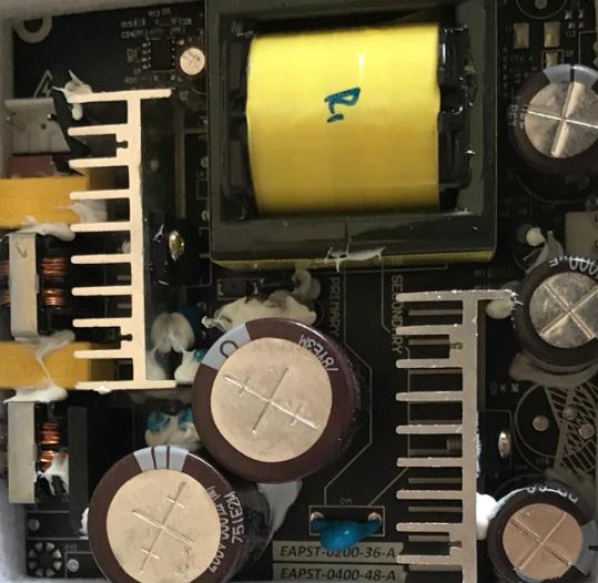

I found that if I turn the amp on, then right away turn it off and back on, the whine is gone. What would cause this? @3eaudio?I assembled my amp and power supply and I'm getting a whine from the large transformer in the power supply as well as left channel of the amp (the channel closer to the transformer). Any suggestions on how to resolve this?
Well you sent me a different bluetooth board compared to the one in the picture despite my order which clearly said 3008.
One I received was the 6415 which has built in IPEX for external antenna.
Are you trying to say that the IPEX is not connected?
sorry for mixed this,
the 64215 one is different with 3008
but you still can solder an external antenna for better receiving sensitivity
Thanks,
Nate
it may be something like in standby mode cause this,
you can try to glued the components like this

Can you explain in more detail why you think this is happening? Are you suggesting I glue the components down myself? I'm not sure what glue to even use. Could this be a manufacturing defect?it may be something like in standby mode cause this,

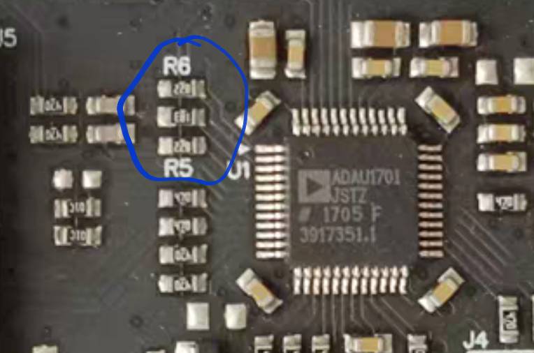

In the manual for the ADAU1701 (EDSP-1701-24-A) you write "Single-end input voltage Full-Scale - 1.1- 1.2 Vrms" and as note "Full-scale input voltage can meet 2Vrms by changing input resistor: 8.2kohm-> 18kohm "
Is that correct ? if so, which resistor needs to be replaced, where exactly is it on the board? can you please take a picture?

for DIY stuff,we did not implement that but only for OEM customer.Can you explain in more detail why you think this is happening? Are you suggesting I glue the components down myself? I'm not sure what glue to even use. Could this be a manufacturing defect?

then you need try yourself,sorry for this.
by change R5,R6 to get different input level.In the manual for the ADAU1701 (EDSP-1701-24-A) you write "Single-end input voltage Full-Scale - 1.1- 1.2 Vrms" and as note "Full-scale input voltage can meet 2Vrms by changing input resistor: 8.2kohm-> 18kohm "
