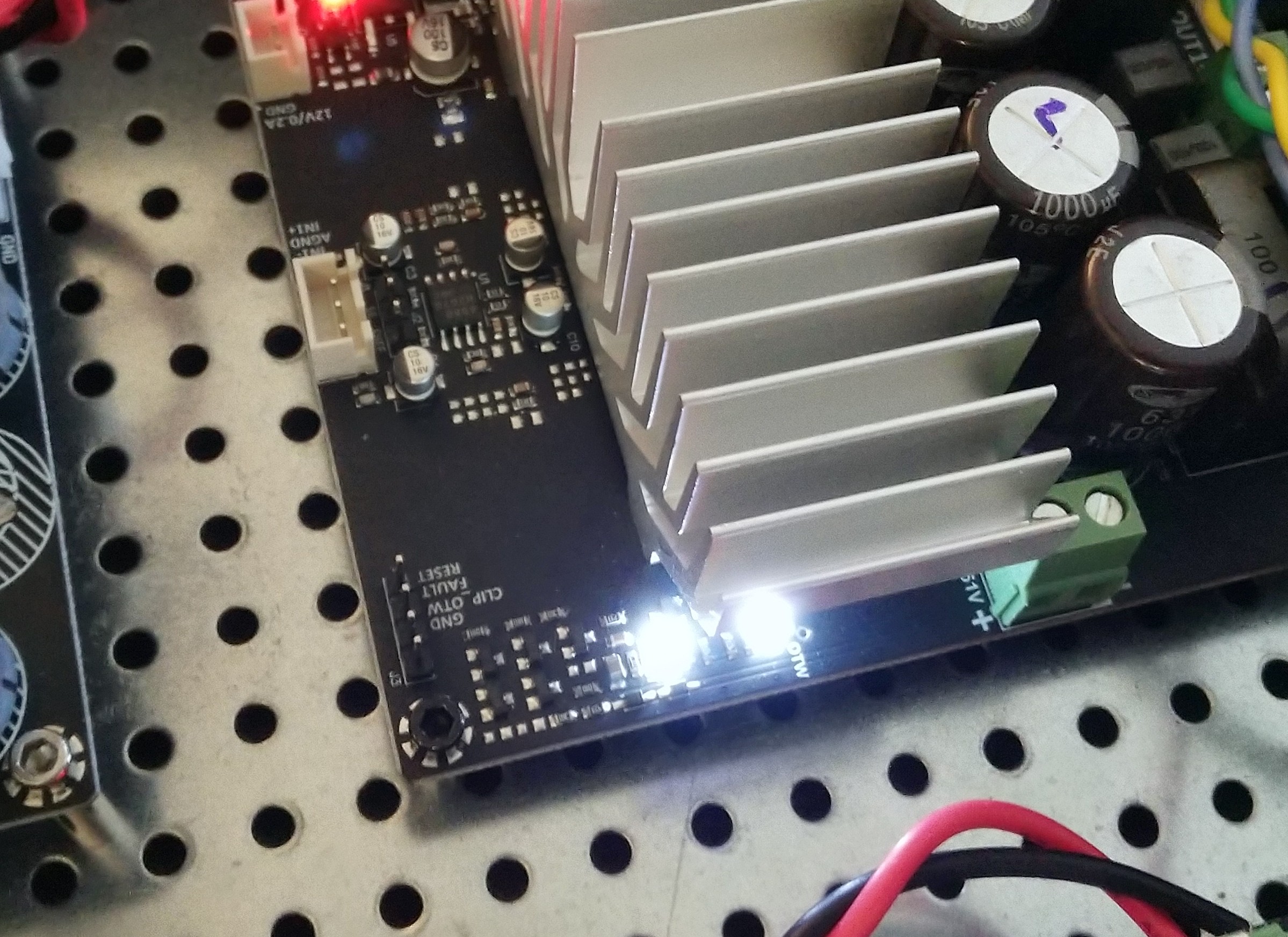

In attempting to set up external LEDs to monitor the pins for fault and clip I have somehow triggered my amp to be in some fault mode. The FAULT and CLIP OTW white LEDs are showing some sort of fault. Have I fried this amp board or is there a way to reset that? Hope someone out there can help!
For reference this is the EAUMT-0480-1-A | TPA3255 480W 1channel board.
