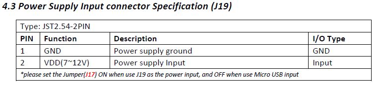

Can any one advise how to power the EDSP-1701-24-A board, I'm a bit confused (not an electrical/ electronics engineer)
I have this PSSMPS600RS 48V 230V Power supply
It has 12Volt Auxiliary output can I hook up EDSP directly to it?

The dsp board is 7 to 12VDC so the aux power output on your SMPS would be suitable assuming it can provide enough current. I do not know the current demands on the DSP board, but having ordered one I am interested to know
The SMPS can provide up to 1A max (0.5 nominal)

the current consumption below 200mA
see the power connection for power this board,the simple way is just use Micro USB

Thanks for quick response, what the other end of the USB connects to? assuming its USB type A. Most USB chargers are 5v with 1 amp will that work?
3eaudio
yes,a typical phone USB charger cable can do this work.
