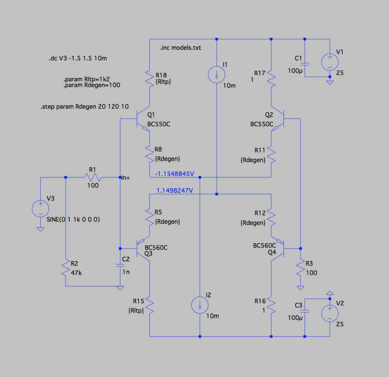

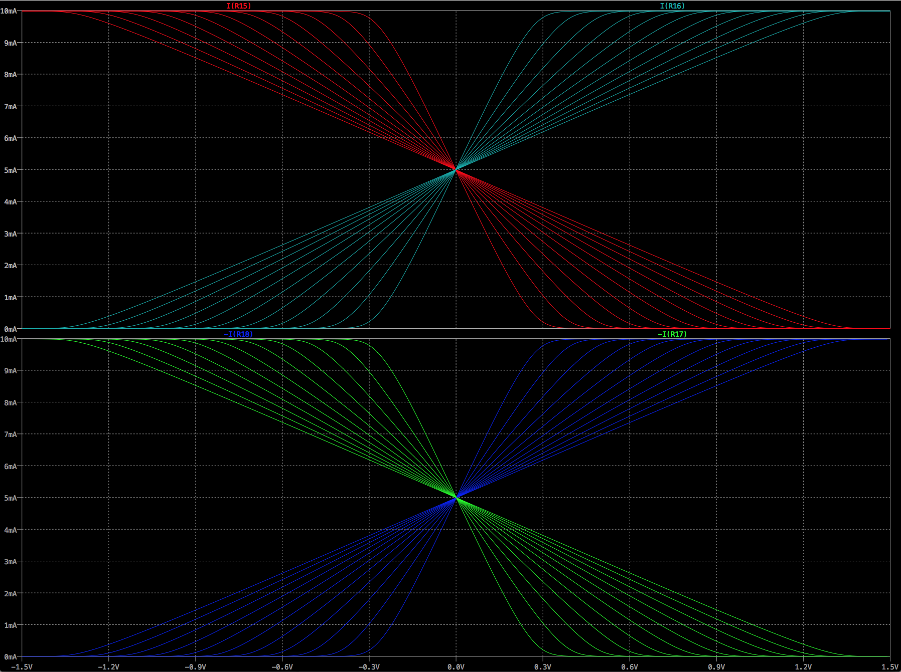

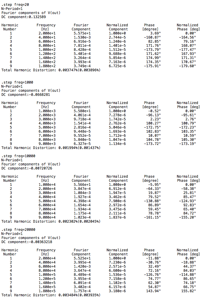

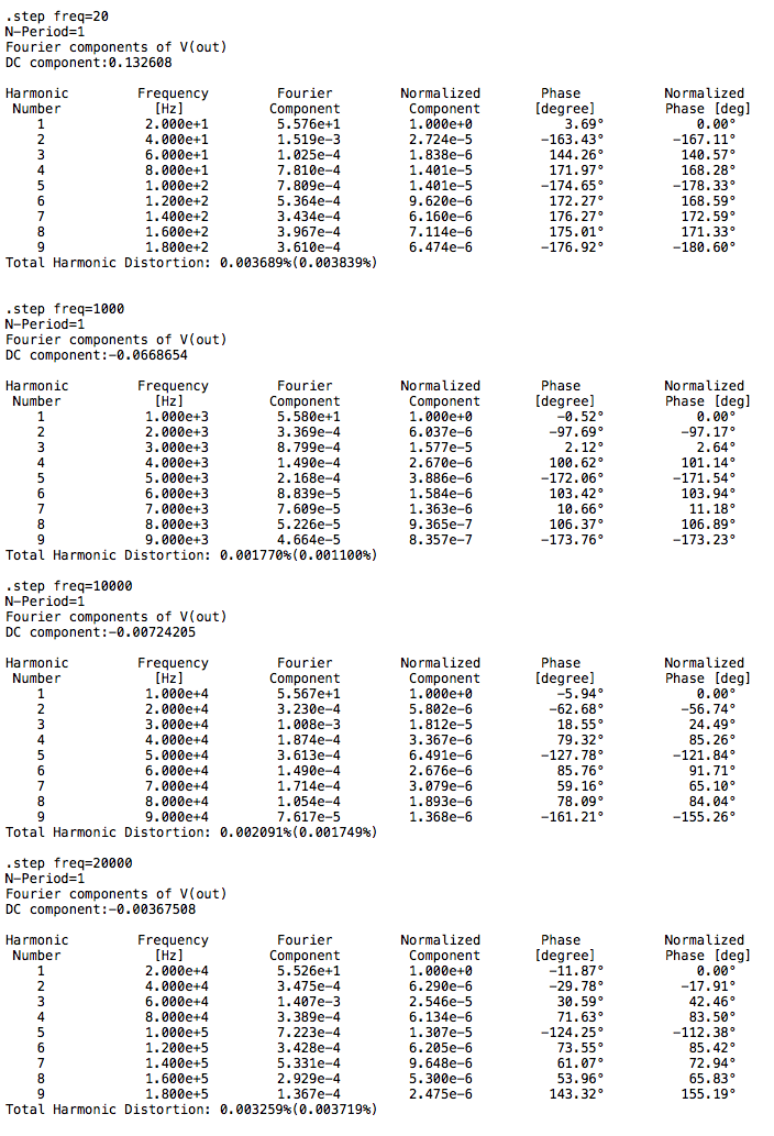

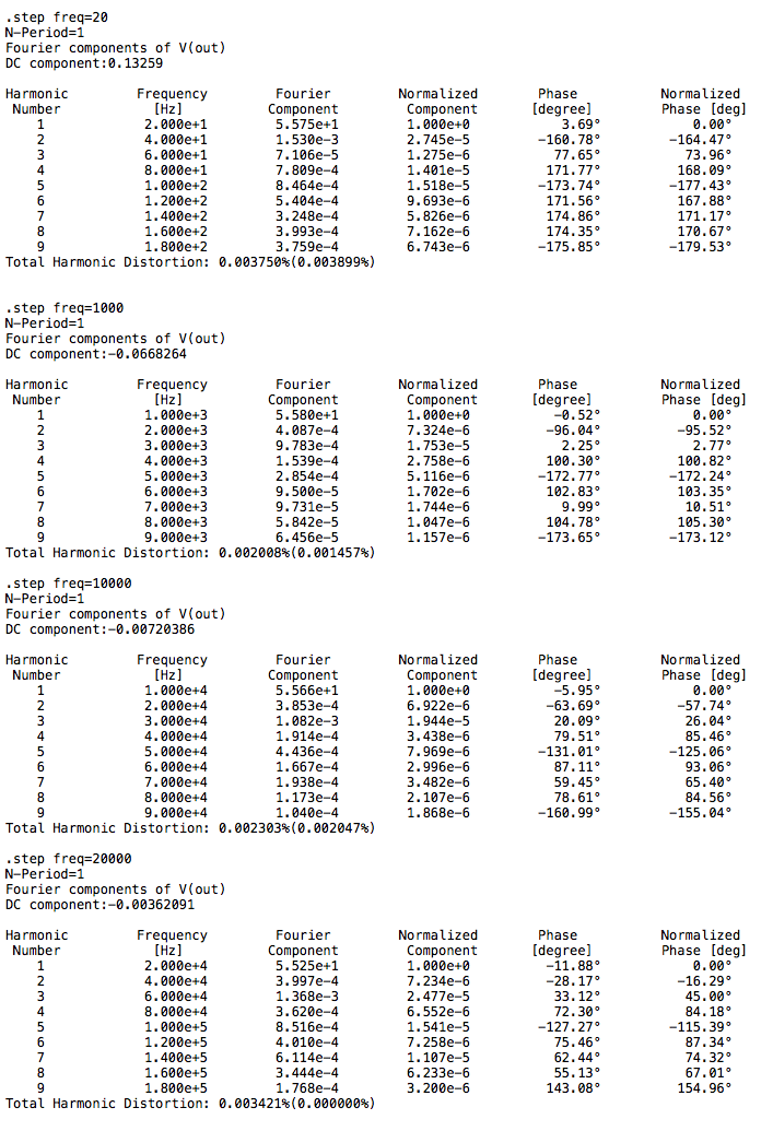

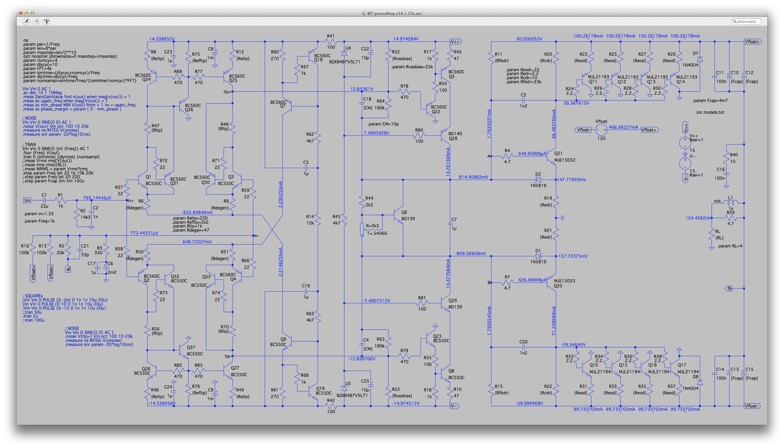

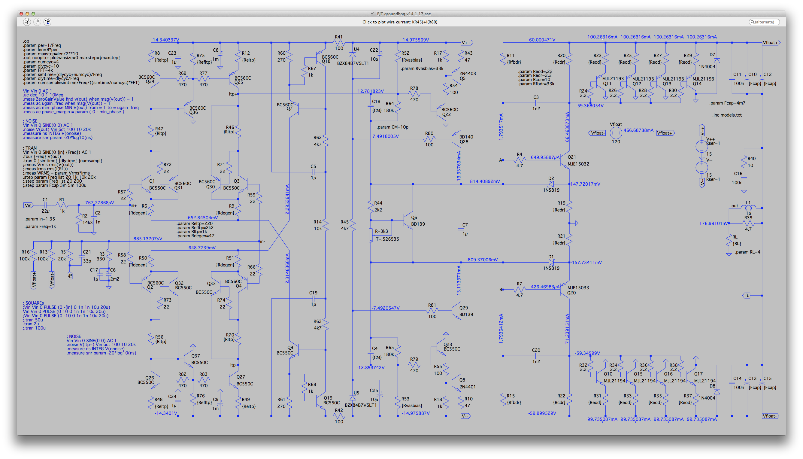

Here it is. A simple sim on a simplified dual ltp stage, with degen res varied, to see what their effect is.
I think the plot visual shows a lot.
I varied the degen res from 20 to 120ohms in 10ohms increments.
We can see the linear usable range widening a lot with increasing degen res values, however what we don't see there is the reduction of the gain that goes in the opposite direction.
Of course it's a compromise, and one important thing to keep in mind is that as Dr Leach pointed out, if we get out of the ltp's linear range, TIM can occur.
So by having sufficient degen value, we increase the linear range and we can make sure we don't get out of it, so as to prevent TIM.
There is however no point in going too far with high degen values, especially since the gain reduces as we increase those values.
The slew rate is also affected by this, so even more to keep in mind to compromise...

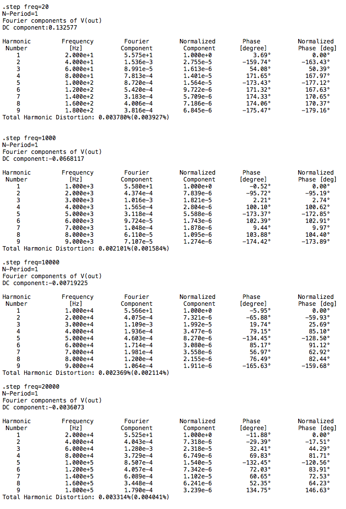

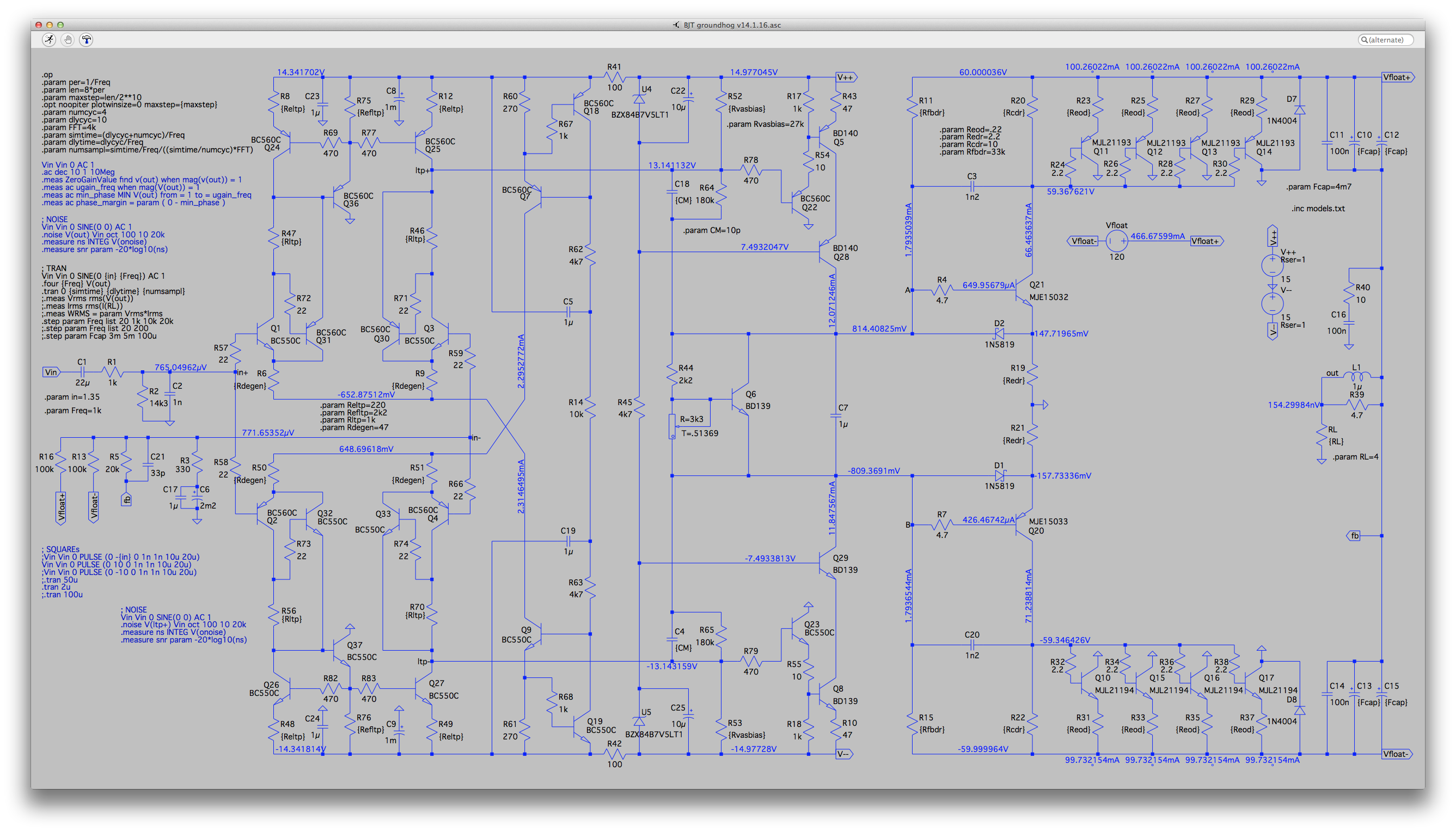

Dropping the 2k2 to 1k hardly has any impact. If any, perhaps a very tiny bit at the higher end, but so small, it's not worth mentioning.

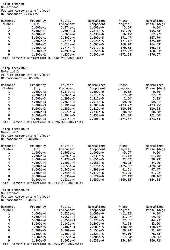

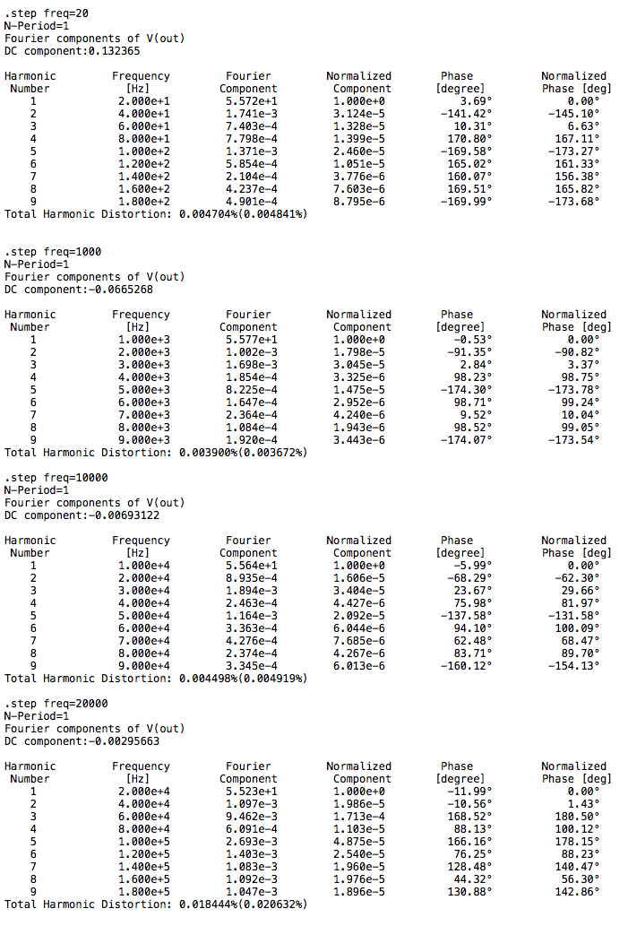

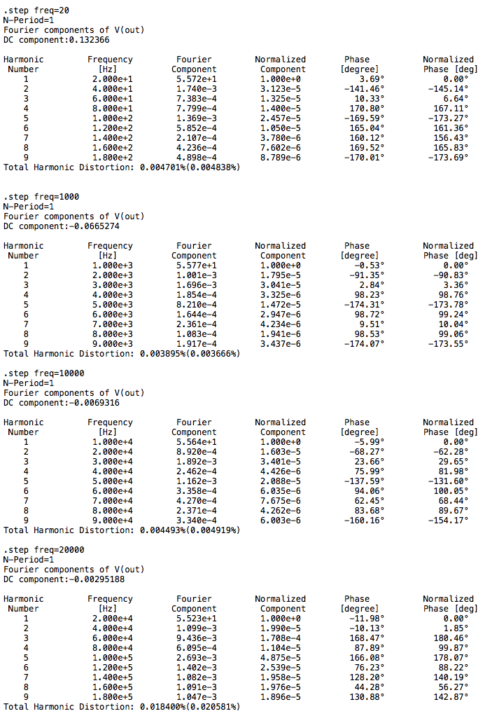

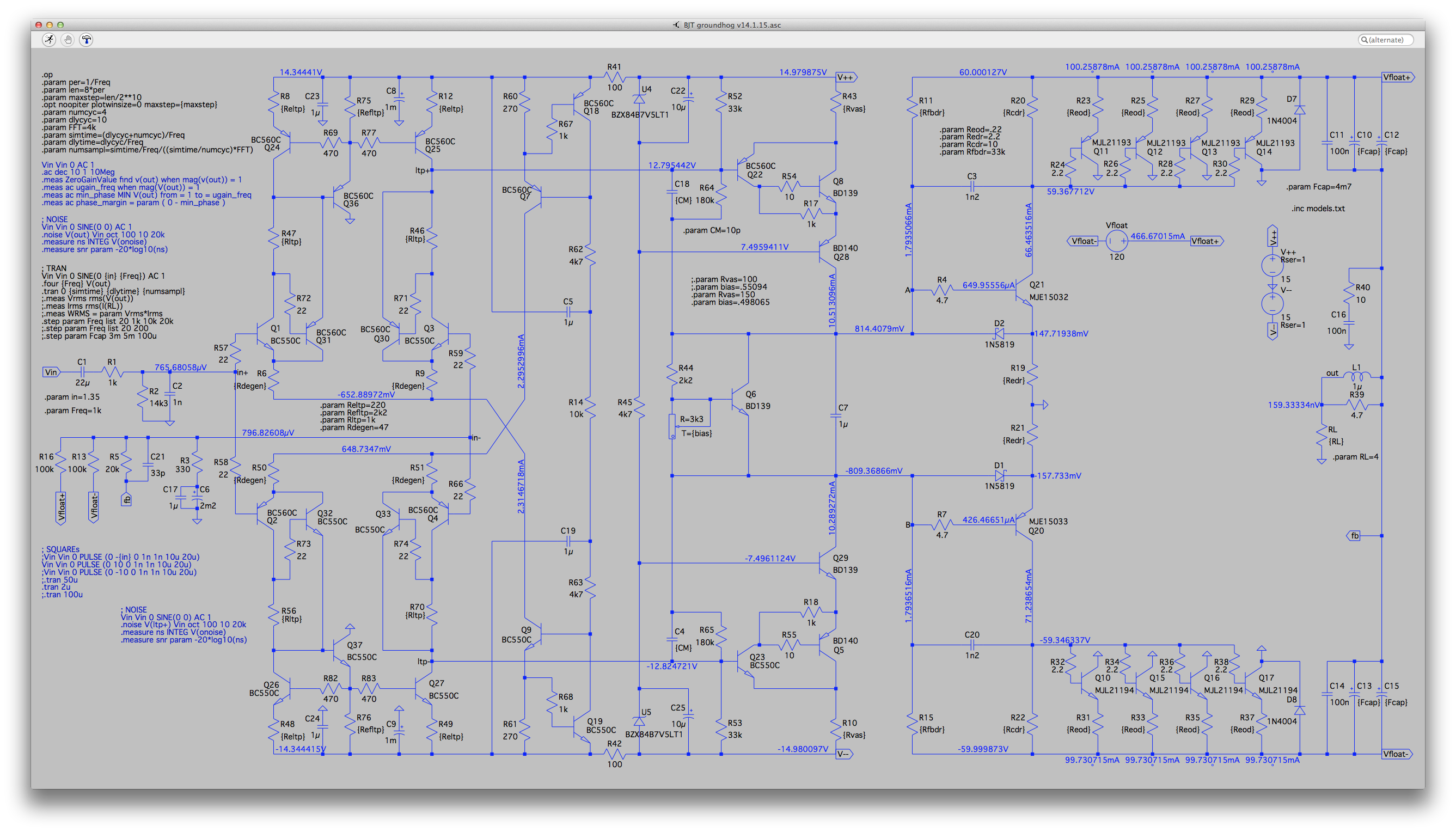

Switching from the 2N440x to the BC5x0 does bring a little more improvement, although not huge.
The vas bias is higher with the BC than with the 2N. (I kept the vas load res at 47, for better comparison)

Dropping from 2k2 to 1k very slightly improves things in both cases (2Ns and BCs), so 1k seems a tiny bit better.
I still haven't touched the vas load 47ohms res, so vas bias is still high.
I will now try reducing that vas bias, and since using 1k and the BCs are better, I'll use this as the starting point, and then I think if the dissipation drops enough in the vas, then perhaps we can also switch from the BD to the BC there as well, which should increase the gain in that beta enhanced vas.
This should be good and lower thd some more.

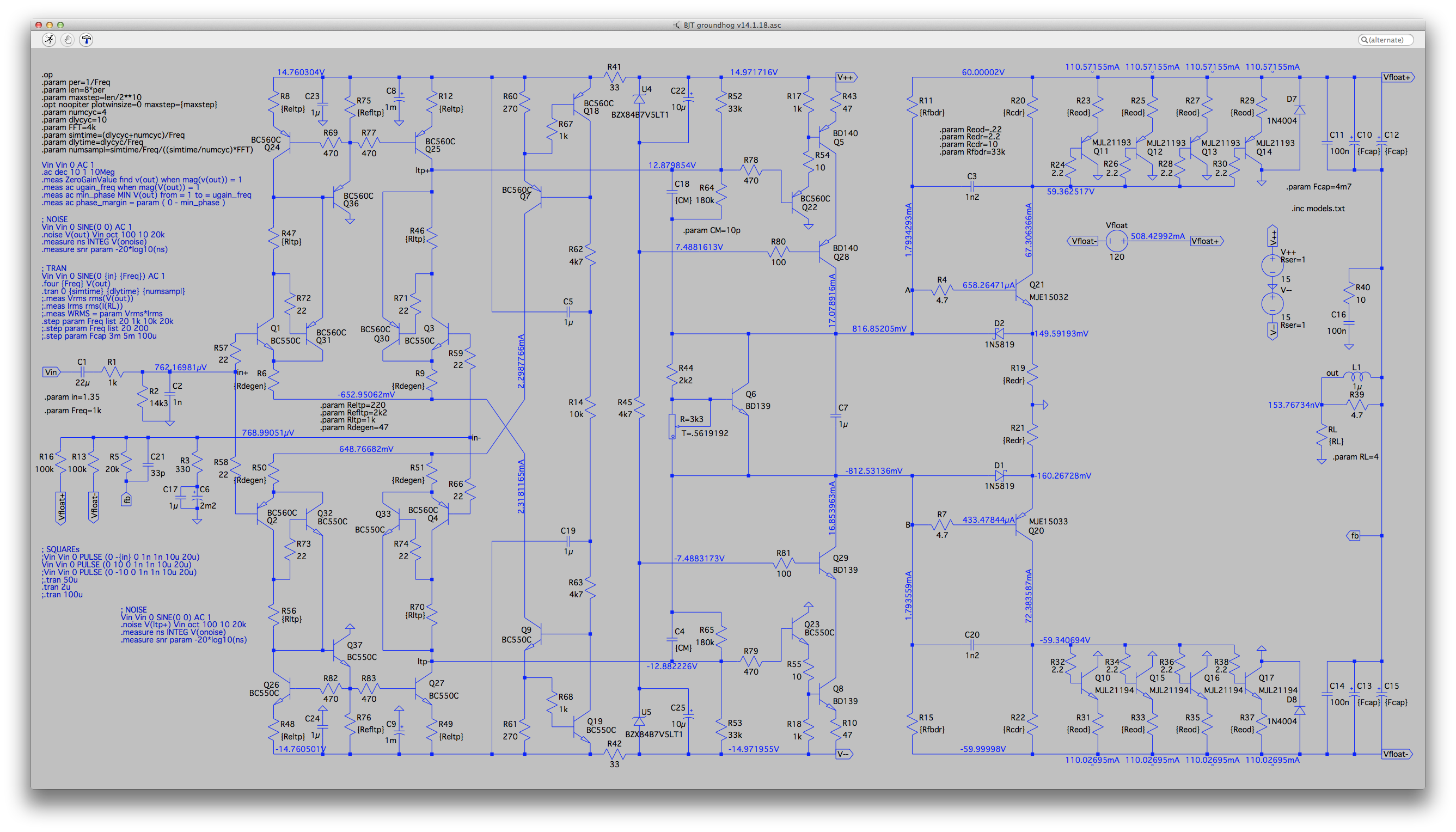

I didn't expect this much different in thd when lowering the vas bias.
I only dropped it to about 15mA (half the previous) using 100ohms on the vas load.
Will try 10mA now.
One thing looks useful here though, as the dissipation went down to a bit less than 115mW in the cascode (vas BD), and less than 80mW in the vas BD, so I think it could be done to use a BC instead of the BD there. Leaving the cascode BD as is.
This beta enhancement could help.
With the vas bias down to 10mA, that is obviously a good thing to do.

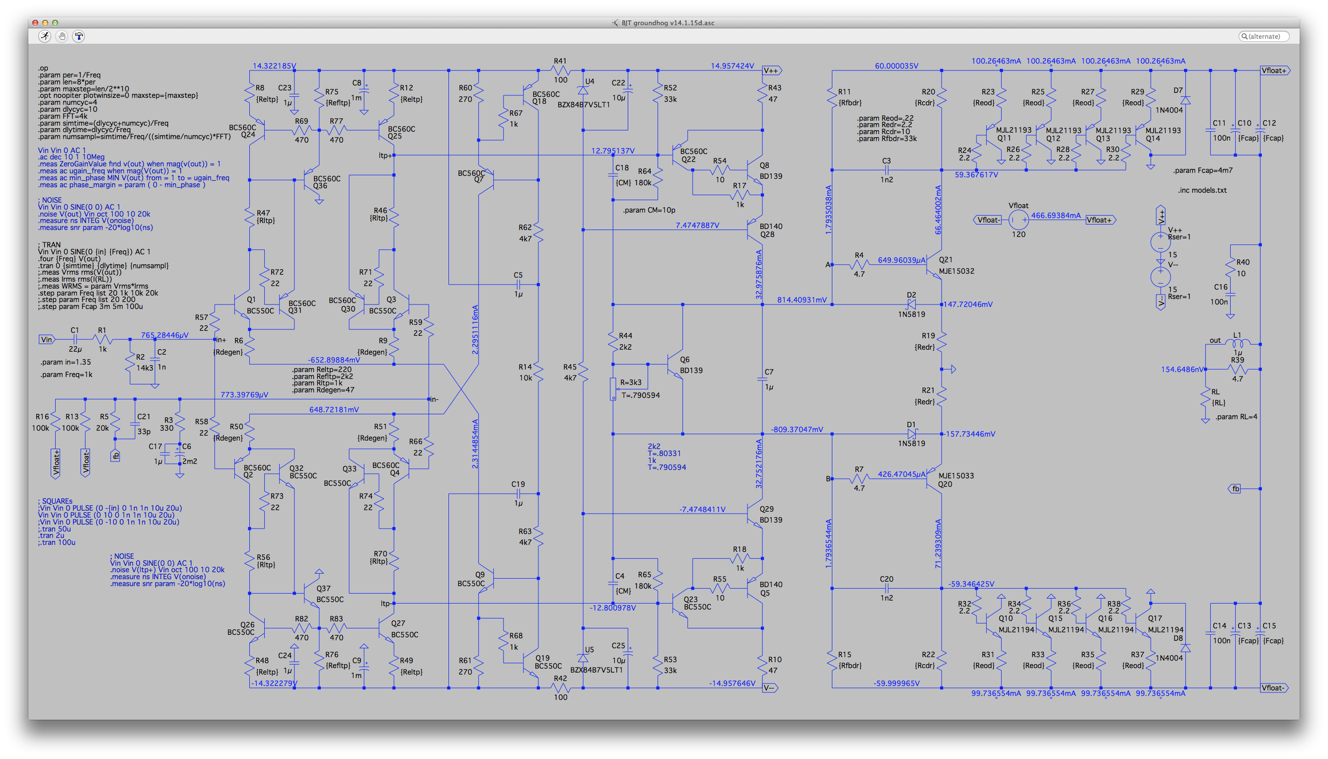

Dropping the vas bias down to about 10mA continues to increase thd, significantly.
I wonder if this is a trade off that's worth it. Unless switching to the BC instead of the BD would increase gain enough to compensate.
The dissipation in the vas cascode drops to a bit less than 77mW and about 52mW in the other BD, which now quite easily could be swapped with a BC.
I think it's worth taking a look at this.

Well, tough choice.
Going from BDs to BCs saves a tiny bit of pcb real estate, and the BCs are slightly cheaper than the BDs, but the thd is much higher this way and the swap from BDs to BCs in the vas doesn't compensate for all.
Doesn't seem worth doing so far.
The "richer" vas bias gave us much less thd.

... A simple sim on a simplified dual ltp stage, with degen res varied, to see what their effect is. I think the plot visual shows a lot.
...one important thing to keep in mind is that as Dr Leach pointed out, if we get out of the ltp's linear range, TIM can occur.
Great post. This is very illuminating and the curves are great for conveying the findings.
I'm loving the lower distortion we got by reducing the LTP emitter resistors. One component change cut it in half. I'm rather in favor of keeping a low value and high gain, provided we avoid "TIM". The LTP and input filter must be considered together for this to happen.
Why mention this? I believe we should limit the input signal bandwidth in the passive input filter, to avoid instability. This is basic control systems theory and precedes the whole TIM debate by many years. I used a 3X larger than typical input filter for this reason.

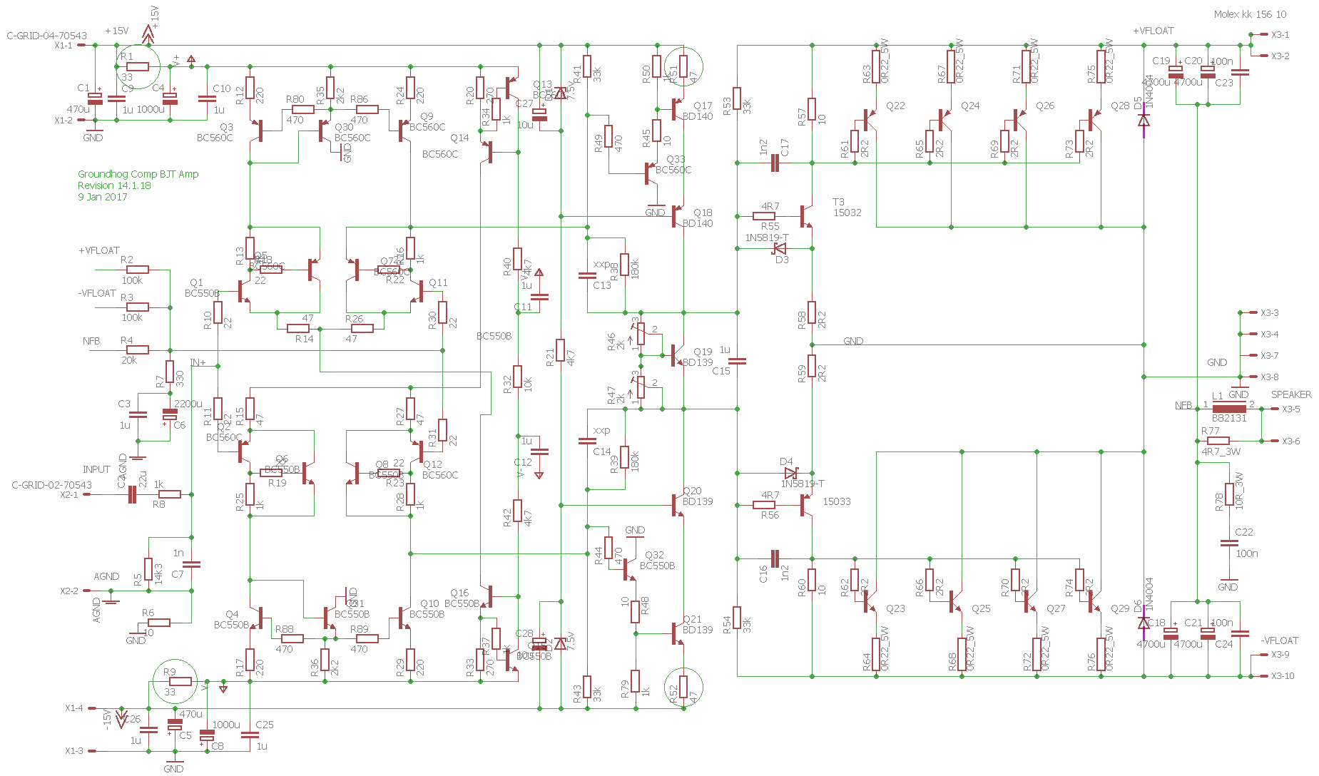

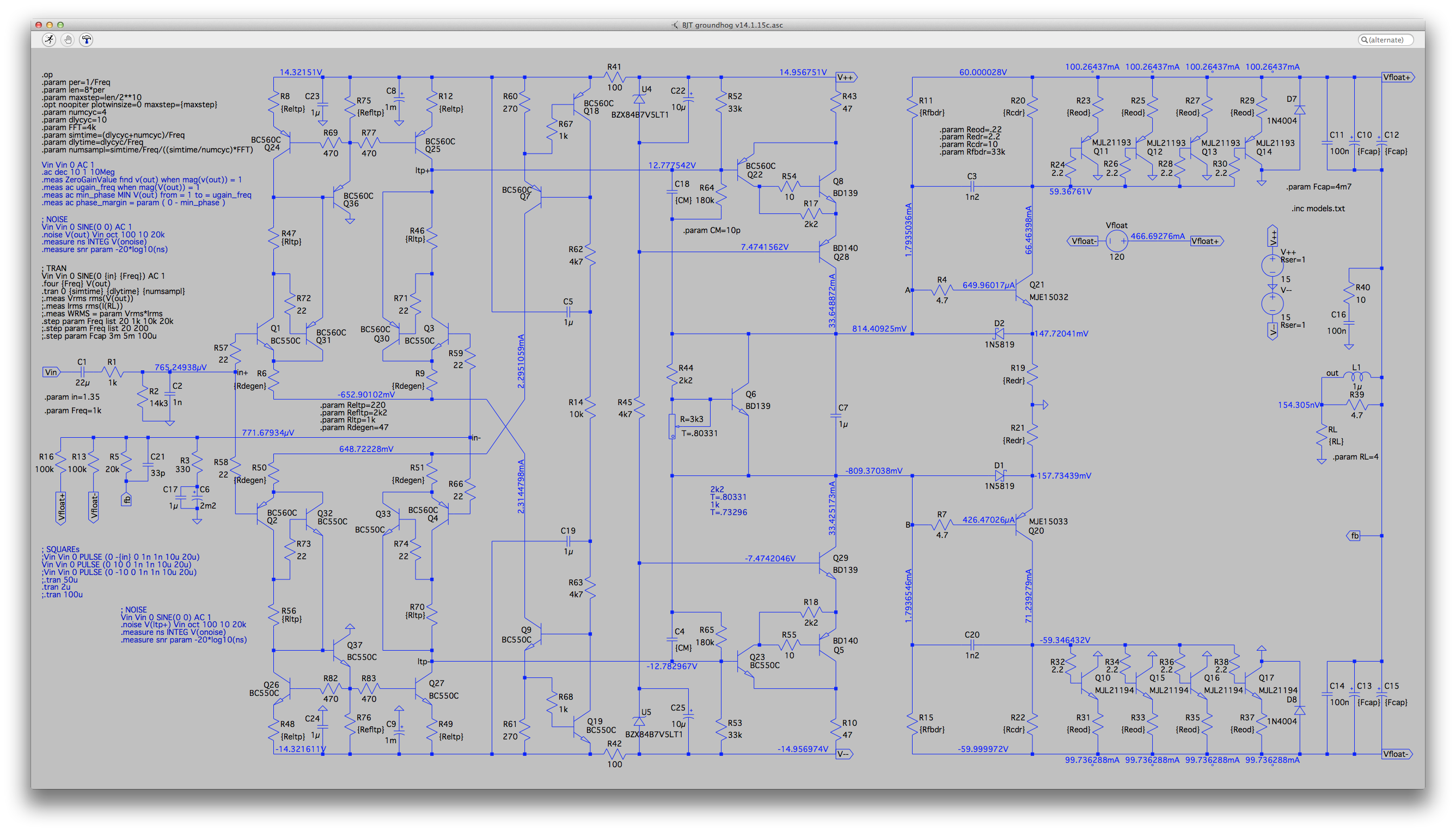

Let me recap my thinking on the VAS. Essentially, I took Self's reasoning to heart.
Self concluded that in the VAS, LF distortion arises mainly from Early Effect, while HF distortion from high Ccb. This guided my suggested changes to the VAS.
1. Lower Ccb: As a first step I suggested using lower Ccb transistors for the input of the Sziklai pair VAS. As expected, there was a slight benefit of lower HF distortion, all other things being equal. We did not address Early Effect yet.
2. Early Effect: The next step was the circuit I called Darlington VAS, which has a goal of eliminating Early effect on the input transistor, for reduced LF distortion. The input transistor of the Darlington pair has its collector fixed to ground to accomplish this. We are cascoding the second transistor for similar effect, though I suspect the first transistor dominates.
To minimize changes, I suggest keeping the BDs at first.
For whatever reason the circuit seems to like a bias of ~2.2v at the input transistor. I assumed about 1v drop on the emitter resistor plus 2 Vbe, or a total of roughly 2.2v.
Unfortunately increasing the VAS emitter resistor lowers open loop gain and raises distortion. You see this right away in your simulations. This will mask the beneficial effects of eliminating Early effect. If possible we need to keep the emitter resistor value low, hopefully 47R for comparison purposes (not the 100R I show, that was before your sim result). If we end up with 20ma of VAS current, so be it.
Anyway, that was my reasoning. The changes were directly aimed at particular causes of distortion. Hopefully if we keep the VAS emitter resistor low, the gain will be about the same and won't mask the effect of the two important changes.

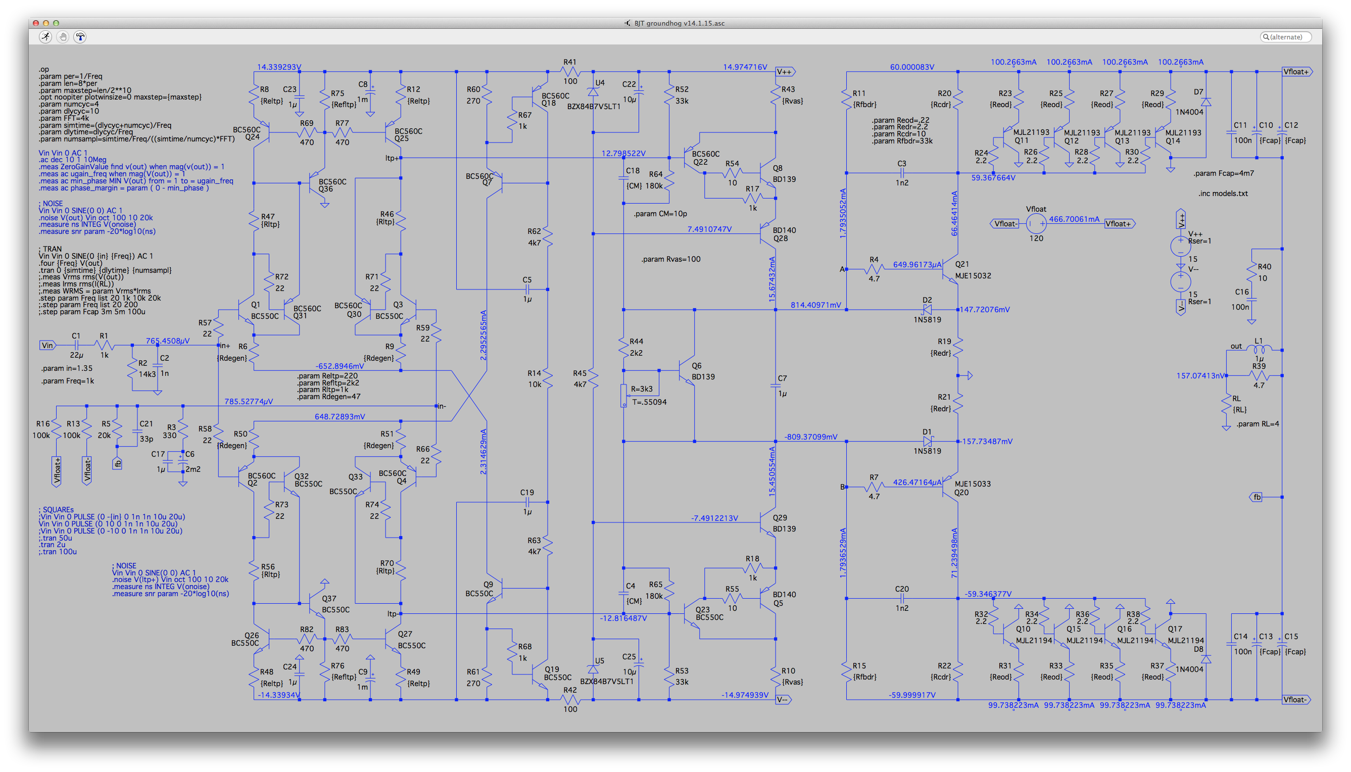

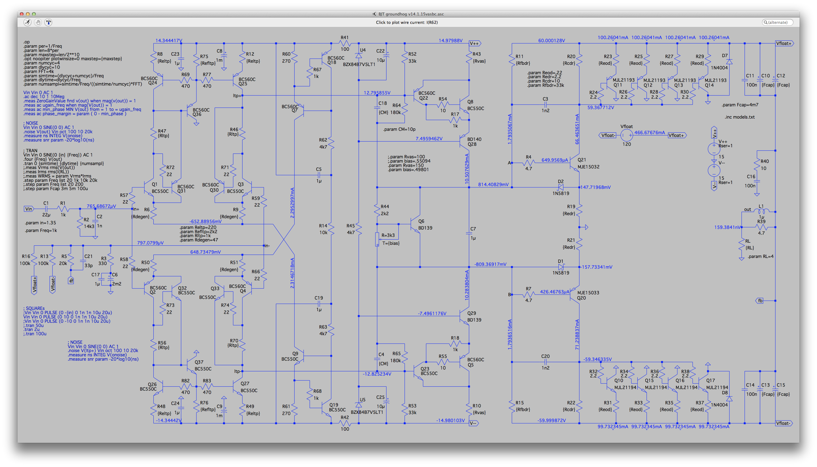

Alright, then here we are with that option you posted and using 47 instead of 100 on the vas.
Instead of adding a pot (100k), I just made that 33k variable and I ended up with 27k for about 12mA vas bias. A real circuit would not be using 2 more such pots, and it would never be possible to match their setting anyway, so I just used a normalized value. 27k worked, 22k was much too low, down in the 7mA range.
Sounds quite reasonable.

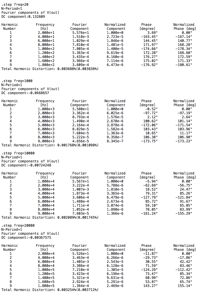

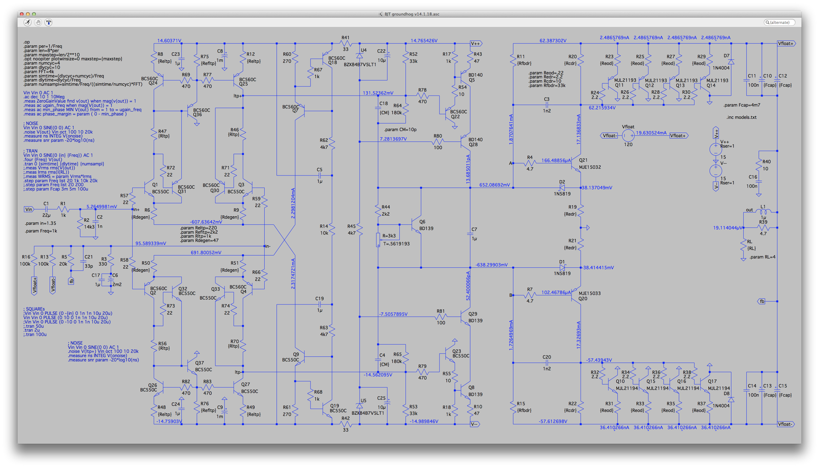

With this much lower vas bias, we have similar thd result as earlier working versions. Not too bad, and now we'll see what that lower ccb device brings.

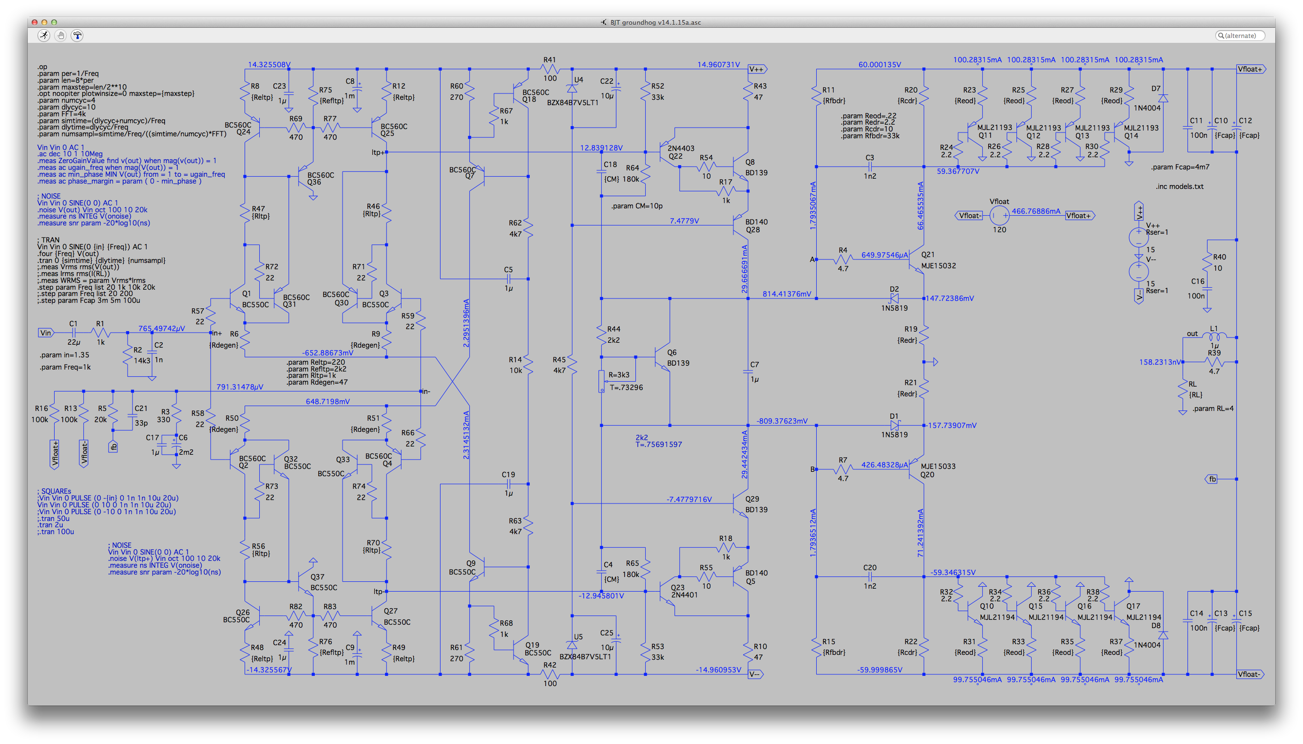

With this second option, the vas bias goes to a bit over 13mA with the 33k resistors.
Having all the other values allows a good comparison, and although we have a little bit of thd improvement, more so in the middle, but not at the upper end, where it's a little worse.
Not what I was expecting.

I was curious to see the difference between the 2Ns and the BCs for the vas, so I just ran it.
Keeping the 33k for a vas bias that went up a little to closer to 15mA.
Take a look at the rail balance! wow! just 32uV out of balance!
Anyway, the BC does a tiny bit better than the 2N, and I rechecked on the dissipation, which is around 90mW, so perhaps they would run a little warm over time.
Good to compare. And the dissipation isn't much lower with the 2Ns.

Trying to figure out what the datasheet mean when it comes to capacitance.
Some datasheet don't even mention anything about this. For example the datasheets that I have for the BD139/40 don't mention any capacitance, from any manufacturer.
And then some mention different values but not using the same terms or symbols to express them.
I was curious to see the difference between the 2Ns and the BCs for the vas...

This last incarnation has an issue with the bias.
Something is going on that causes a very abrupt drop of the bias, to very small amount, with a tiny variation of the bias adjustment.
Check those 2 screenshots, the difference of the cursor position at the bias spreader is tiny, and yet causes the bias to drop to nearly nothing.
So I couldn't adjust the bias to normal level.
I probably could adjust it, by going much further in decimals, but if this happens in a real build, the bias would be virtually impossible to adjust.
We need to step back to a known working configuration. As near as I can see, the two recent changes were changing the power filter R from 100R to 33R, and changing the VAS emitter resistor from 100R to 47R.
I would suggest undoing the first, revert to power filter R of 100R. Verify operation.
If that is not working, revert to VAS emitter resistor of 100R.
