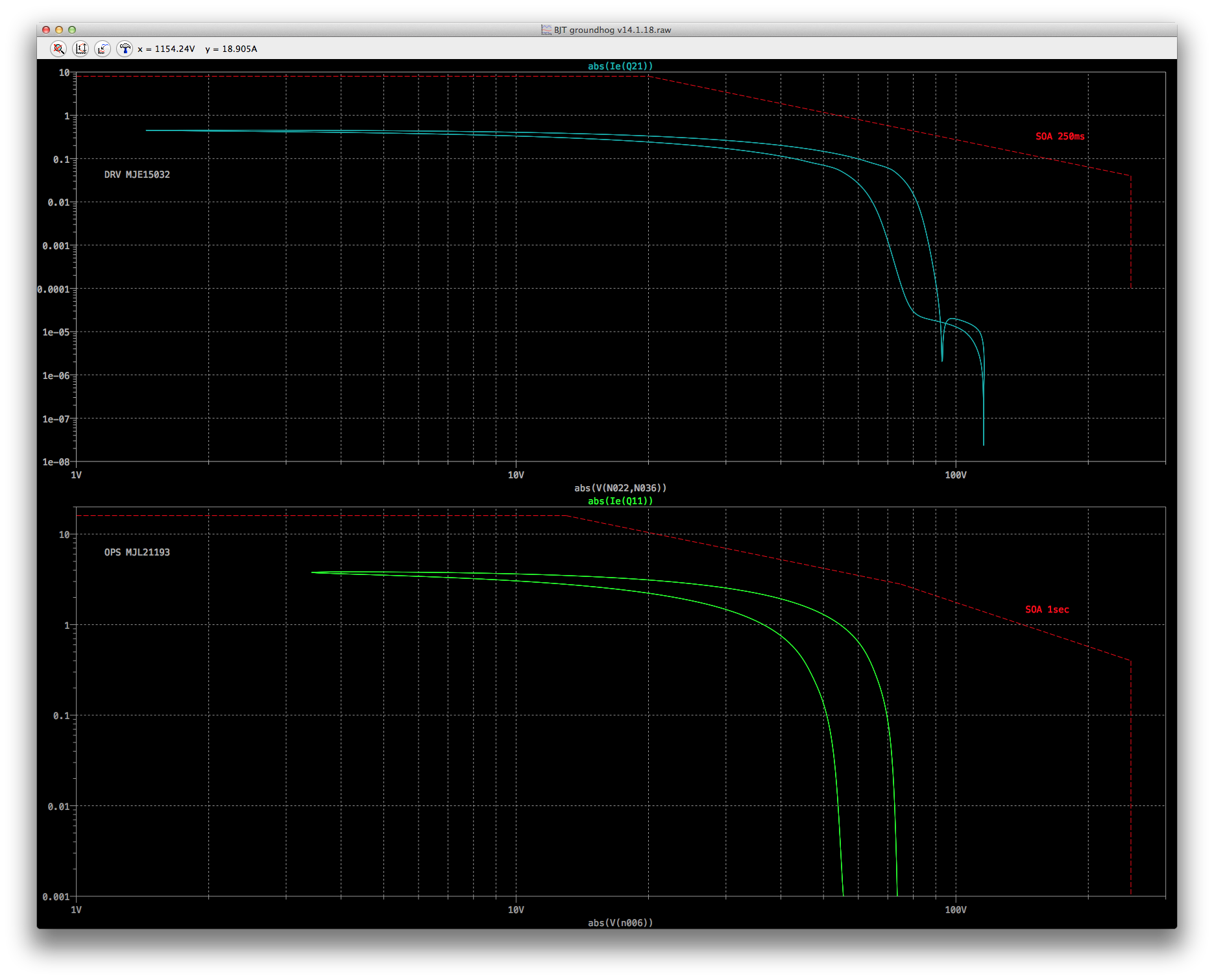

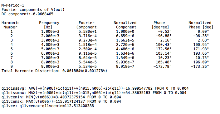

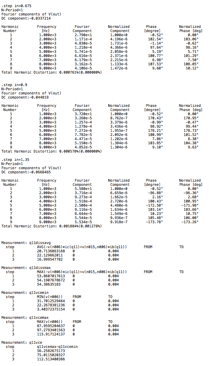

On our latest working version, I looked at what we have for dissipation in the outputs and how much vce swing we have.
Since they all are seeing the same thing, I only looked at Q11.
One thing I've been wondering is why we haven't been able to get closer to full swing near the rails, for maximum output power. I suspect the clipping isn't happening there on the output but probably on the vas first.
The clipping looked fairly well behaved though, when we didn't have oscillations.
Anyway, looking at Q11, we don't get below about 3.4V on its emitter, and the max vcesat for the mjl21193 is listed at 1.4V for Ic 8A, which we're not reaching (less than half that), so obviously we're not saturating the outputs, and thus they're not the ones doing the clipping.
Because of this, we can see the vce swing is only about 112V and the devices are exposed to only about 115V of max vce.
For power dissipation, we reach a peak power near 55W, so we're very well within limits, and the average dissipation about 17W (per device).
That was at 1khz on the resistive 4ohms load and full nominal output power a tiny bit before clipping starts.
If I remember right, this isn't the maximum power dissipation, which happens at 2/3rd the output power (Am I correct on this? Or is this at half power?).
17W times 8 devices, 136W of average power to dissipate on the main heatsink, not including the small amount from the drivers.
So as long as we use a heatsink that has less than 1 degreeC/W of thermal resistance, this should work out well.

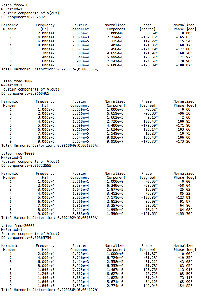

To look at dissipation a little closer, I made that sim run steps at 1/2, 2/3 and full power.
We can see at the same time how the thd evolves at different power levels.
As I thought, the max dissipation is at 2/3 power, and 1/2 power dissipates more than at full power.
The difference isn't really huge but significant enough to take into account.
But that's a little more than 22W per output device total average dissipation.

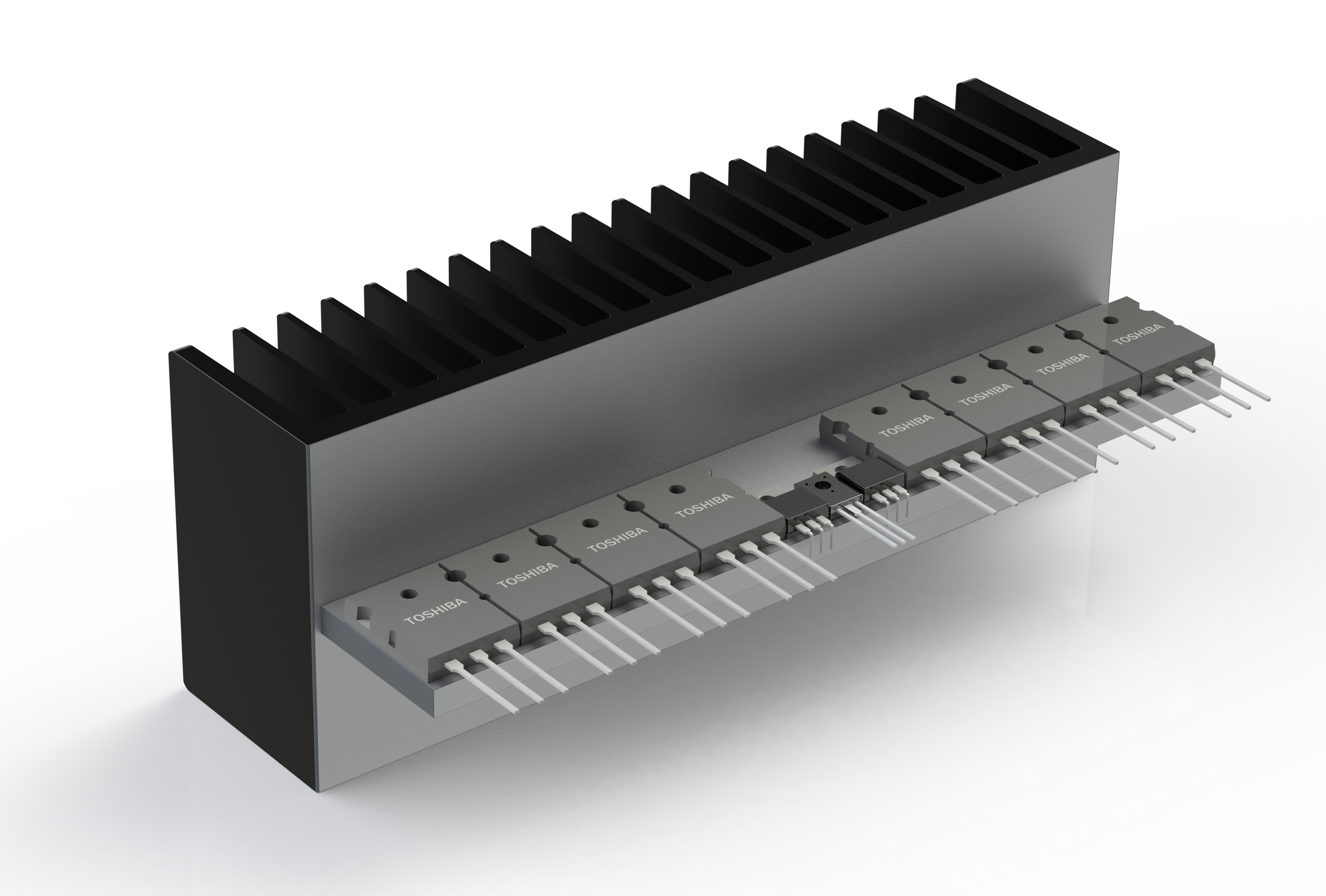

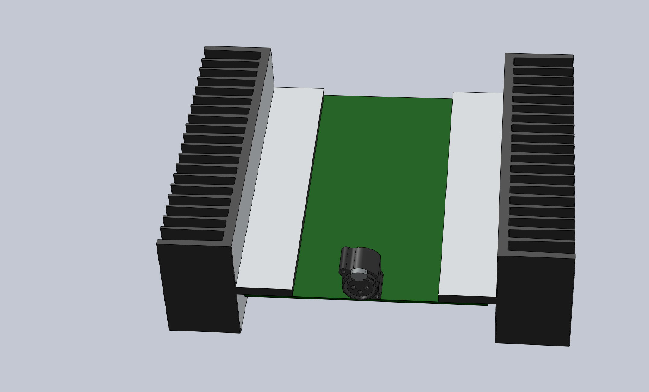

I'm sharing a visual I just made up.
I was wondering how everything would fit on the heatsink if using that model from conrad that I posted about earlier.
The size isn't very large and I wondered if all the devices would fit if everything was on one side of the pcb.
With 8 TO-264, 2 TO-220 and 1 TO-126, that's a fair amount to squeeze in that small space.
And although it would be tight, it would fit.
Of course that's just one possibility among many, but I thought I'd share my idea.
I looked at some small tunnels, a lot more compact, but perhaps too compact and I'm not sure how the devices would be bolted on them..

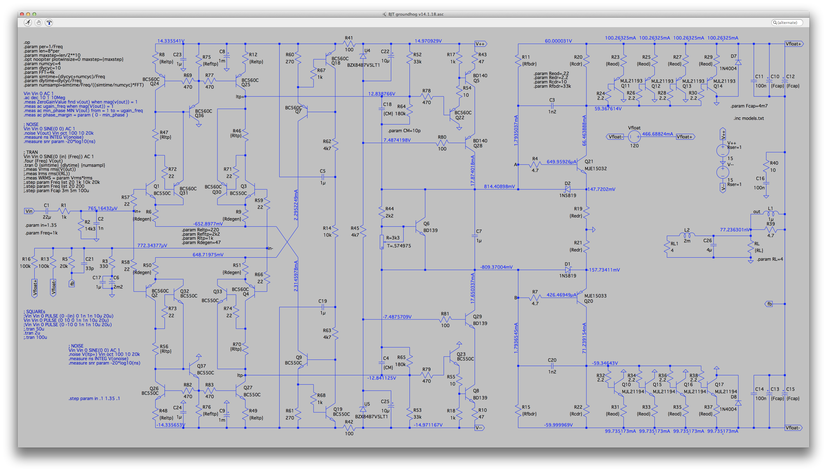

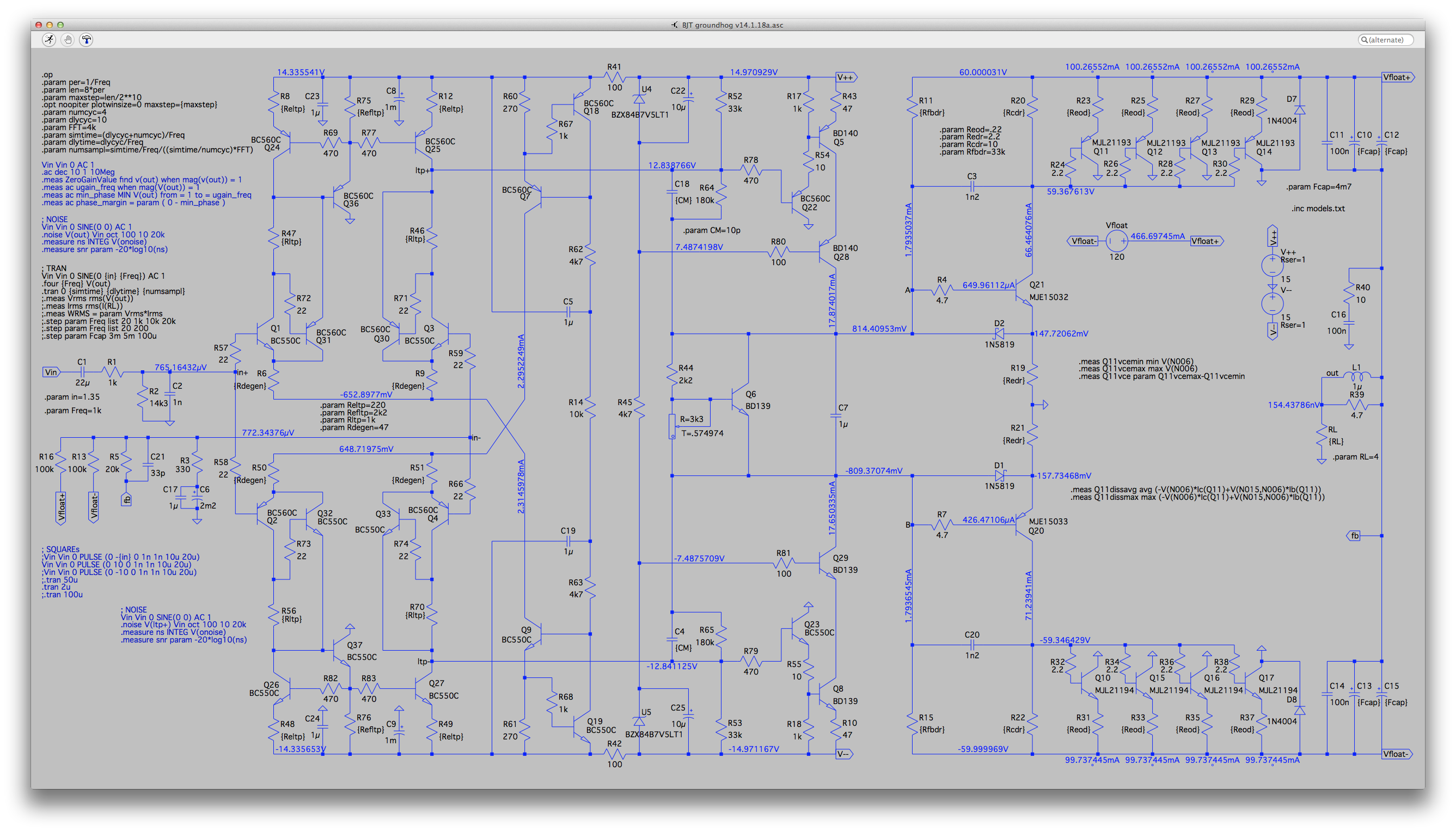

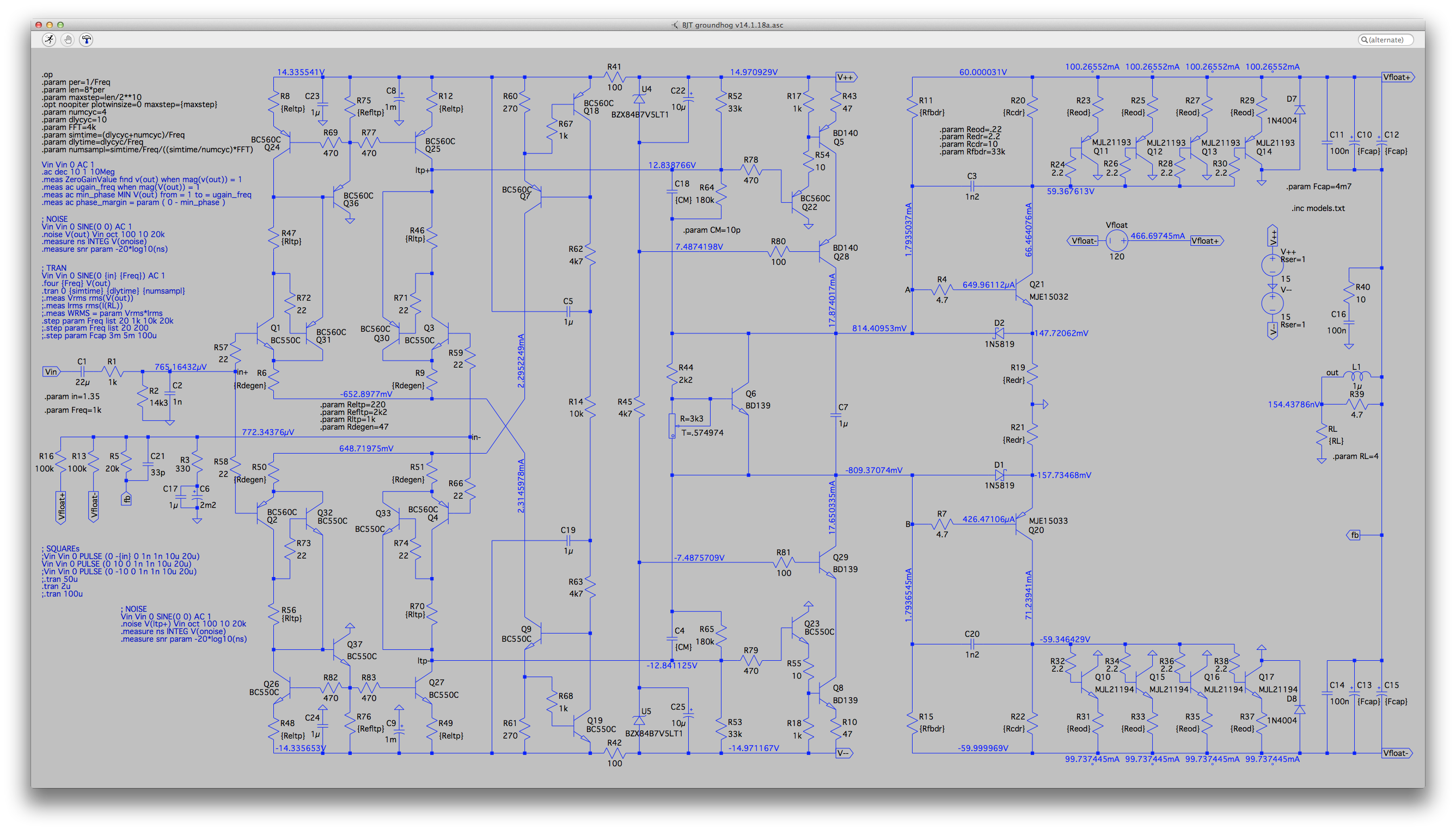

how about a refresh on the .asc so people can stay in sync, avoid hand mod/rentry errors?
Sure. I hope I gathered all of the pieces so it can run right out of the box.
Hi spookyd, the cause for me to suggest these devices to you was the not really ample space on your 200 mm wide heatsink. I know them, because in 2015 Elektor used them in their Q-Watt amplifier design - only one pair of them for 200 watts output power @ 4 ohms! Correct, these Semelabs maybe hard to find, e.g. in Germany, as RS Components *afaik* do not sell to private users anymore and the other suppliers from the Octoparts lists are not active here. OTOH, the SOA ratings of these MJL21193/94 aren't too bad, too, with 3.5 amps@50 volts Vce. Hence, three pairs of them would be sufficient, I think. Best regards!
Well, that heatsink idea is just one possibility among many. I wasn't suggesting it has to be that one specifically. I just thought it would be a good one that's all.
And besides, I did take a closer look at those MJL devices and there exist a "flavor" in a TO-247 case instead of the TO-264, which is slightly narrower.
So eventually if space was to be an issue, the TO-264 version could be easily swapped to the TO-247 one, since the devices are electrically virtually identical, with the case being just about the only difference.
Still, that cad drawing proved it actually does fit, although tightly, it does work out fine.
The only devices that require an insulator on the heatsink are the drivers and the bias spreader sensor, so it's rather simple and efficient, and that insulator would be quite small and common to all 3 of those devices, which are grouped to make this easy.

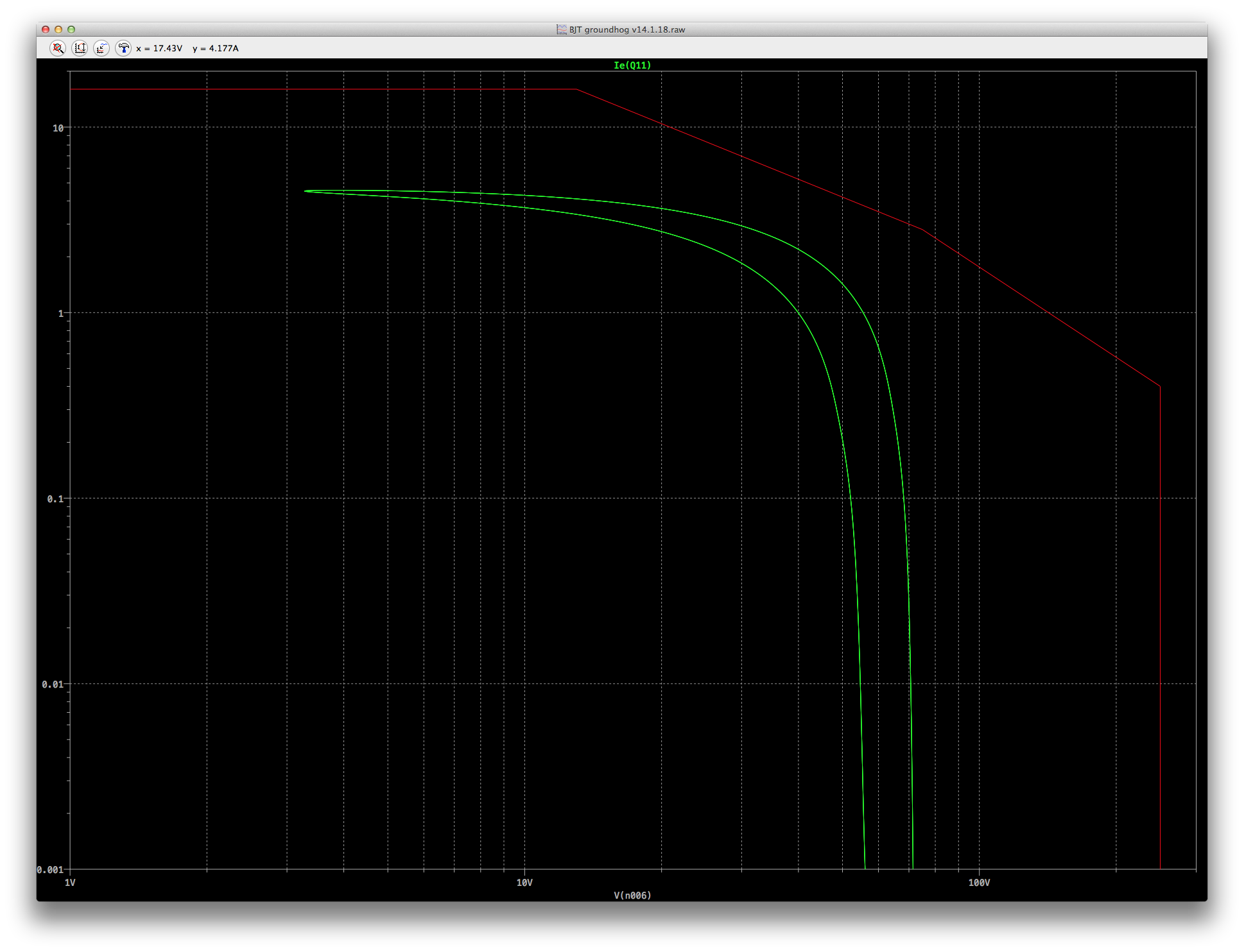

Possibly, and when we take a closer look at our soa situation, we may even find we're over-built a little, but better be on the safe side and make it more robust.

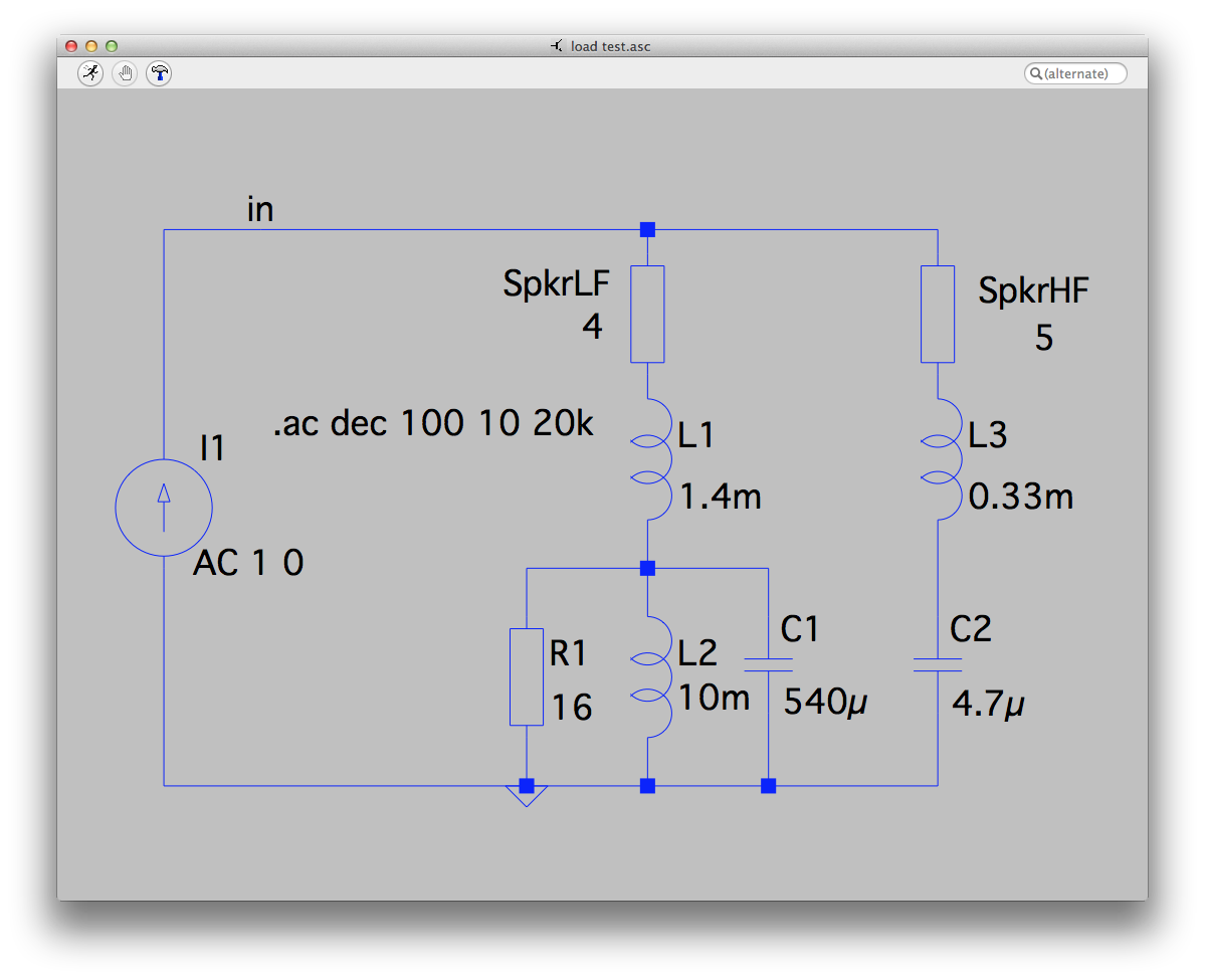

In the simulations I use a 4ohms resistive load but not because we're aiming for such a nominal load, but rather to be in a worst case condition for any possible 8ohms load, with whatever reactive component it may have.
Instead of complicating the sims with complex loads that simulate some multi-way passive xover speakers, I just drop the load to 4ohms, which would never happen with any normal 8ohms speakers.
That way we cover any worst case scenario and keep it simple.
As long as the amp handles 4ohms resistive properly, it should be able to handle whatever 8ohms complex load we throw at it.
So when we look at dissipation, we're being super conservative, as a worst possible scenario. The reality is highly likely to be much less demanding, and actually the thd readings we have would also be better in reality.

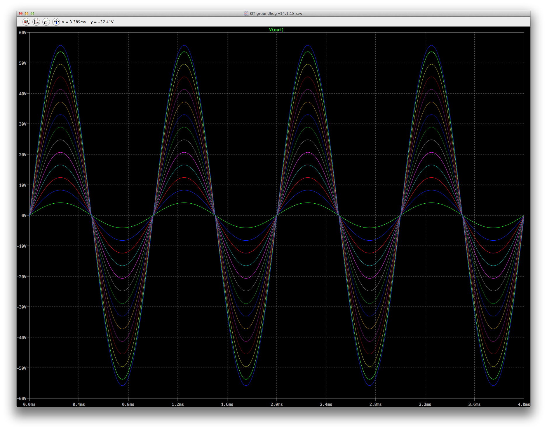

I ran a sim at 1khz and stepping through values of input levels to see how the thd evolves.
I'm a little surprised at the lowest input levels to find that thd increases this much.
We have a plenty generous bias current, and I would expect low levels of xover distortion, but perhaps this increase is coming from some other mechanism, perhaps the capacitors, input or filters.
I ran it with 100mV increment, and this gives 14 data points, which is a little too much to post as a screenshot, so I just posted the log file, with extension txt to make it easier to read as is.
The thd is a little higher than expected at the lowest levels, then diminishes nicely, and slowly and gradually increases with the higher levels, up to clipping, where it starts increasing much more, as expected.
I've been working on getting plots to check for SOA and I was considering using out friend astx's perl script to make things easier. He wrote his script to automate making plot files to make it easier. His thread about this is here:
http://www.diyaudio.com/forums/solid-state/294790-using-ltspice-check-soa-violations.html
I made some adaptations to make it work for me on mac, but it didn't and I don't know yet why that is.
So I just went ahead with the hard way, manually!
I slapped on a makeshift weird load to see what happens, with a coil in series with a resistor and also a cap, all that just added in parallel with the existing 4ohms resistive load.
I know this isn't the best fake load to approximate a speaker, but I can do that later. I just wanted to make it work and see how it looks.
I only targeted Q11, which is only one of the outputs, but they should be identical and perhaps a little different at the negative side, yet similar enough.
The SOA curve comes from the datasheet that I have and it only has the 1sec curve. Maybe there are other datasheets with more curves, we can see about that later.
Anyway, if this is correct, even with that weird fake load, and only plotted within the 1sec soa curve, it looks well within the area.
Now I need to figure out why the perl script isn't working.
Here, added the driver and annotations.
Better?

I tried coming up with some loads more similar to real ones. More complex.
I looked at an impedance curve over the audio range for a load made like 2 speakers, with xovers, for something that would be an 8ohms load.
The impedance curve looks pretty wild and the load doesn't drop below about 4ohms and change, but the reactive part really causes some phase shifting.
The interactions of those 2 fake speakers provide a very tough load I think.
I tried this out on our latest, and I'll post this next.
Is this load too hard?
