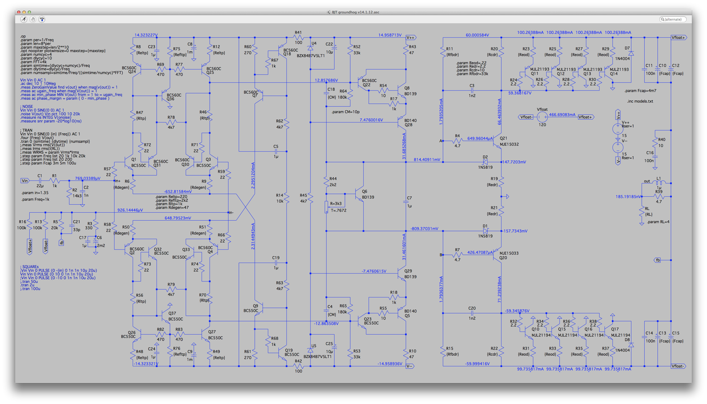

Easily done, we'll look at that, and since it's set up to step through 4 frequencies, we get all that every time for easy comparison.
Is the VAS the next area?
Sure, why not? But this vas has seen many incarnations already, so we've been able to compare quite a bit, but there is likely more to do there.
We have one other thing we can explore, the cascoding of the drivers as suggested earlier.

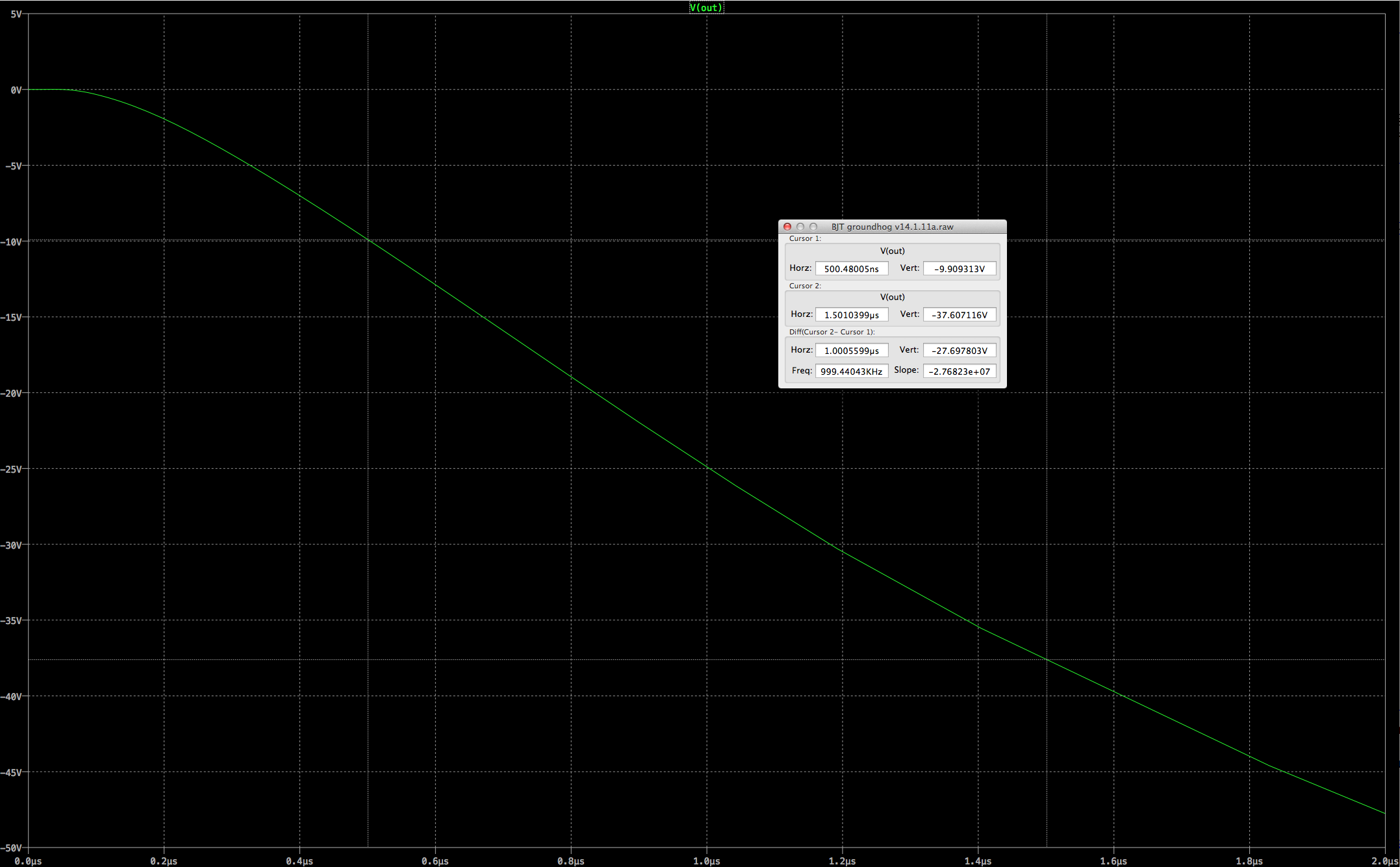

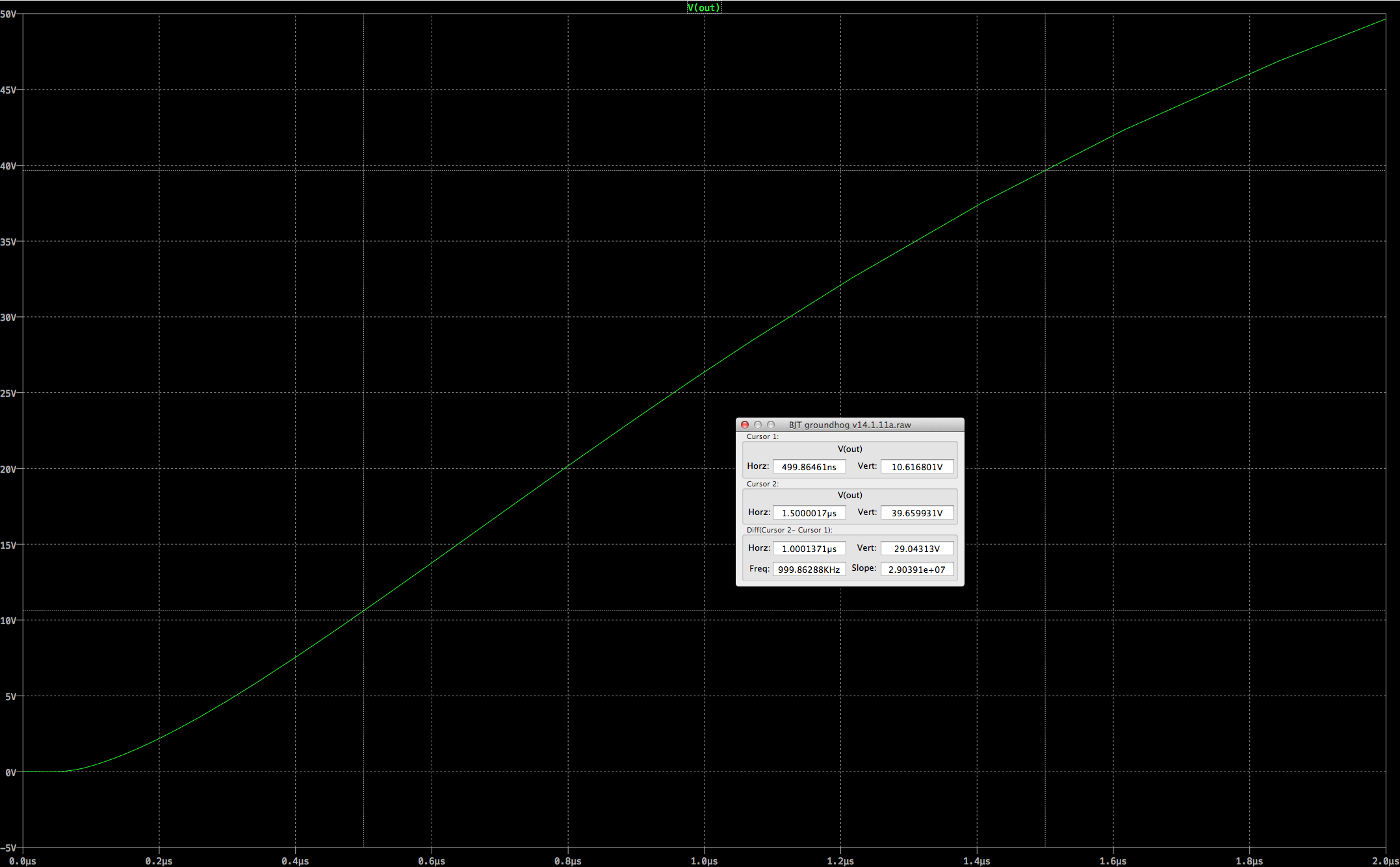

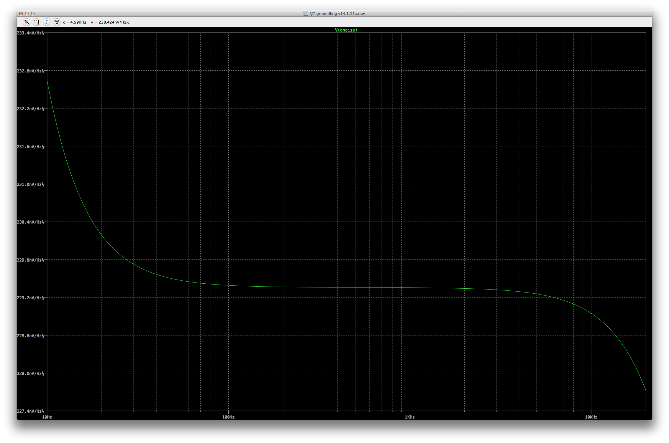

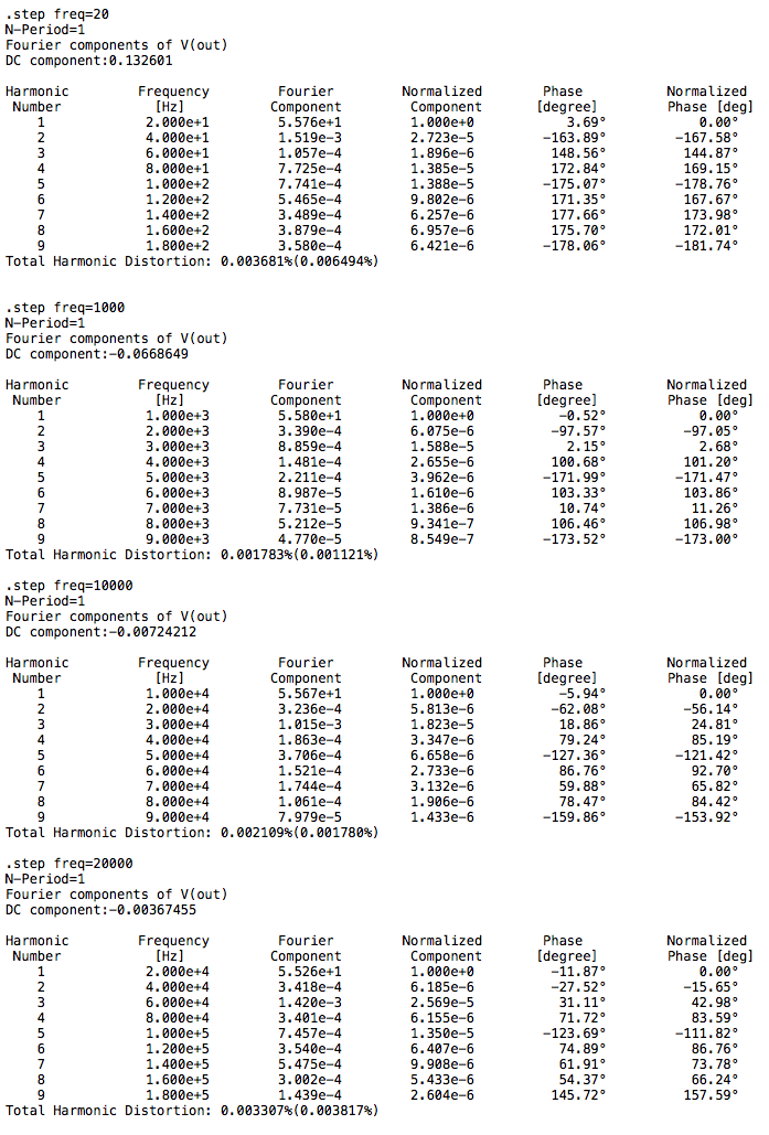

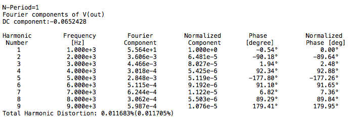

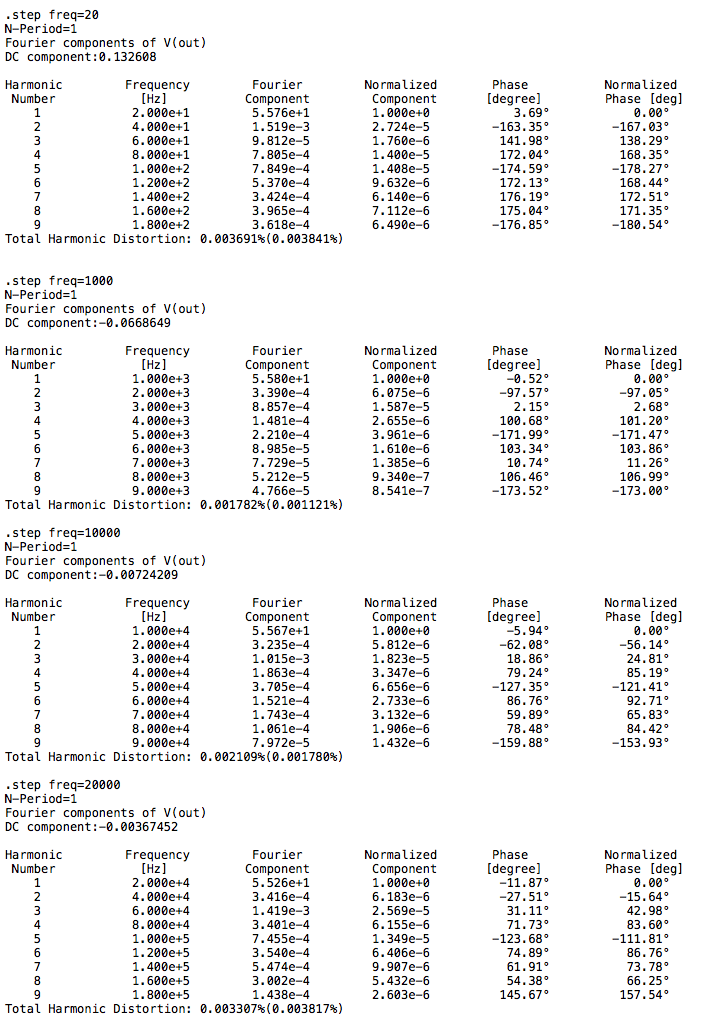

This amp is turning out pretty nice already, if we go with the latest that had the best results, we're in the neighborhood of around 40ppm of thd, or less, which ain't bad, for a capacitor coupled amp...
Not bad at all with 1k/47.
We're at less than 40ppm thd across the board, and the highest is at 20hz, which can be improved a little by tweaking the big cap value and probably a bit the input filter cap as well.

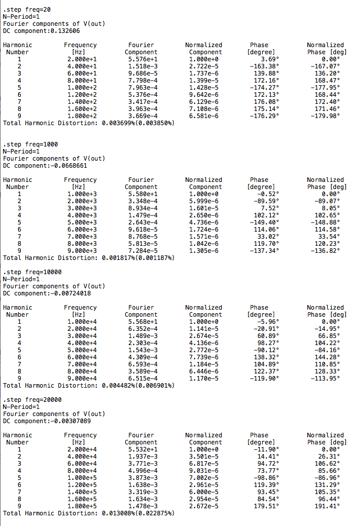

I kept the clamp diodes disconnected, but just to see their impact, I'll run this again with them reconnected.
And then we'll take a look at noise and slew rate.

Using the clamp diodes definitely brings in disturbance, especially at the higher frequencies, and the simulation take much longer to run. Not so good, and they don't seem to be needed anyway.

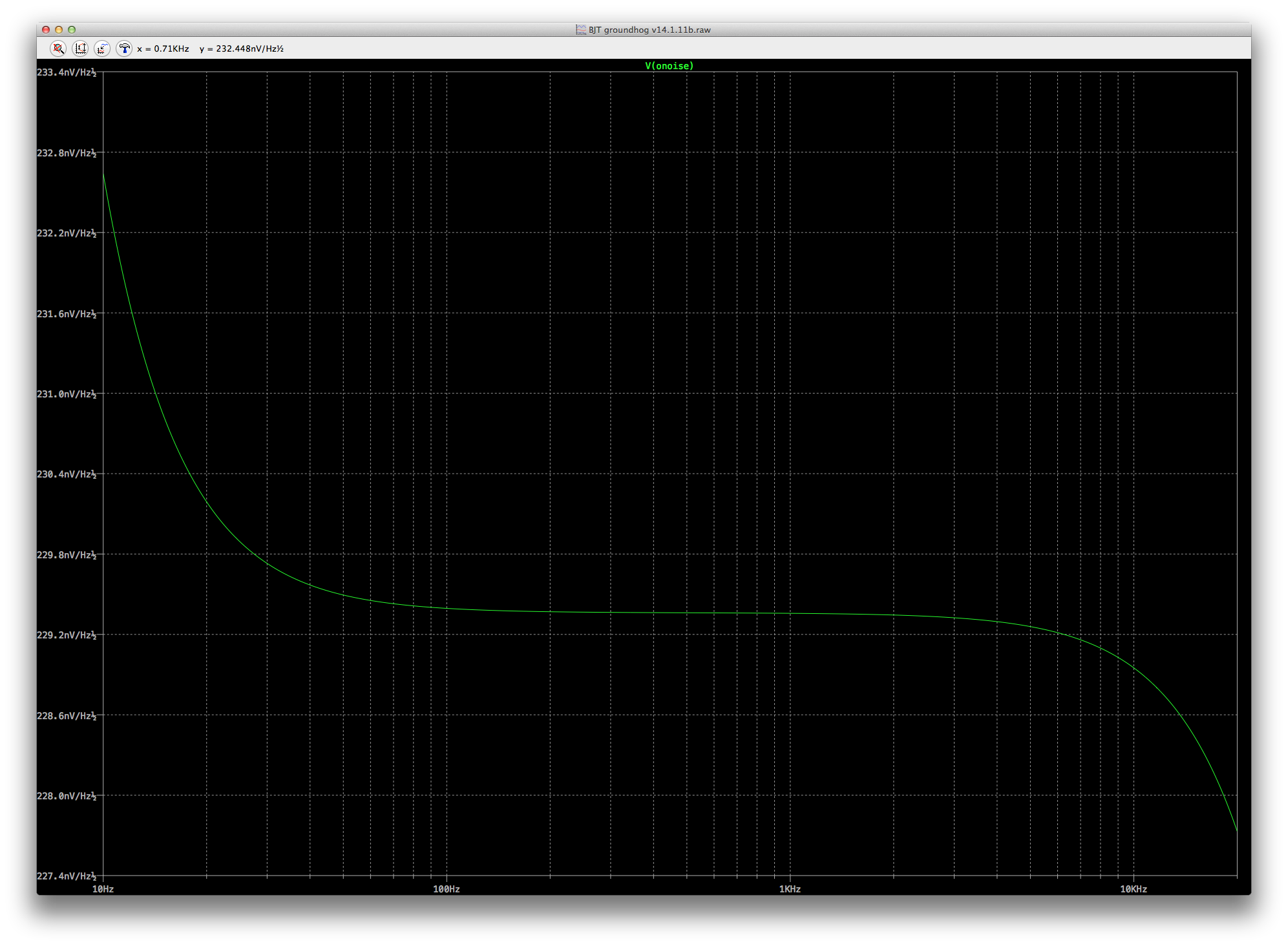

Here's something that may be of interest.
Just to see how much noise contribution was coming from the current sources, I used ltspice ordinary current source and disconnected our discrete ones.
And conclusion: our current sources don't seem to be contributing any noise at all.
Now that's unlikely to be the same for the mirrors, but at least we know there is nothing we can do to the sources for better noise performance.
And as far as thd is concerned, using those more perfect sources only brought thd down by barely 0.2ppm, which is nearly nothing, so they are real good as they are now.

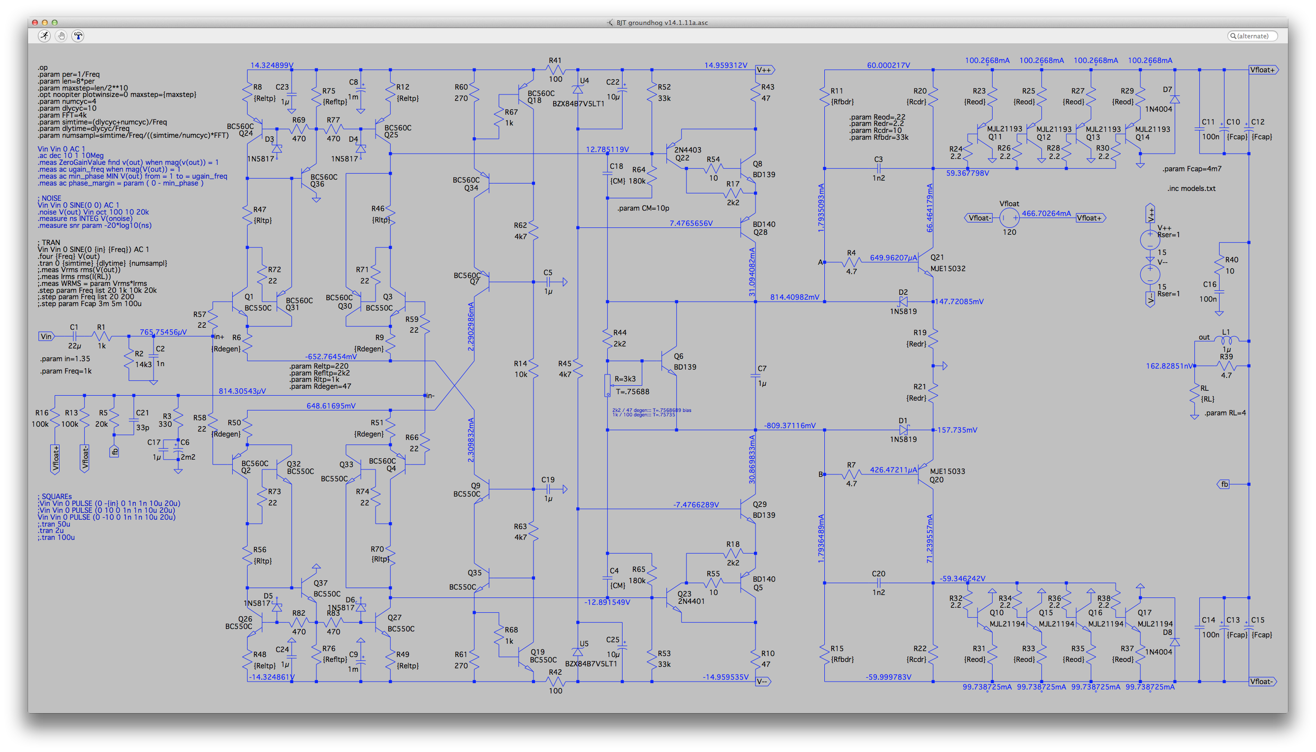

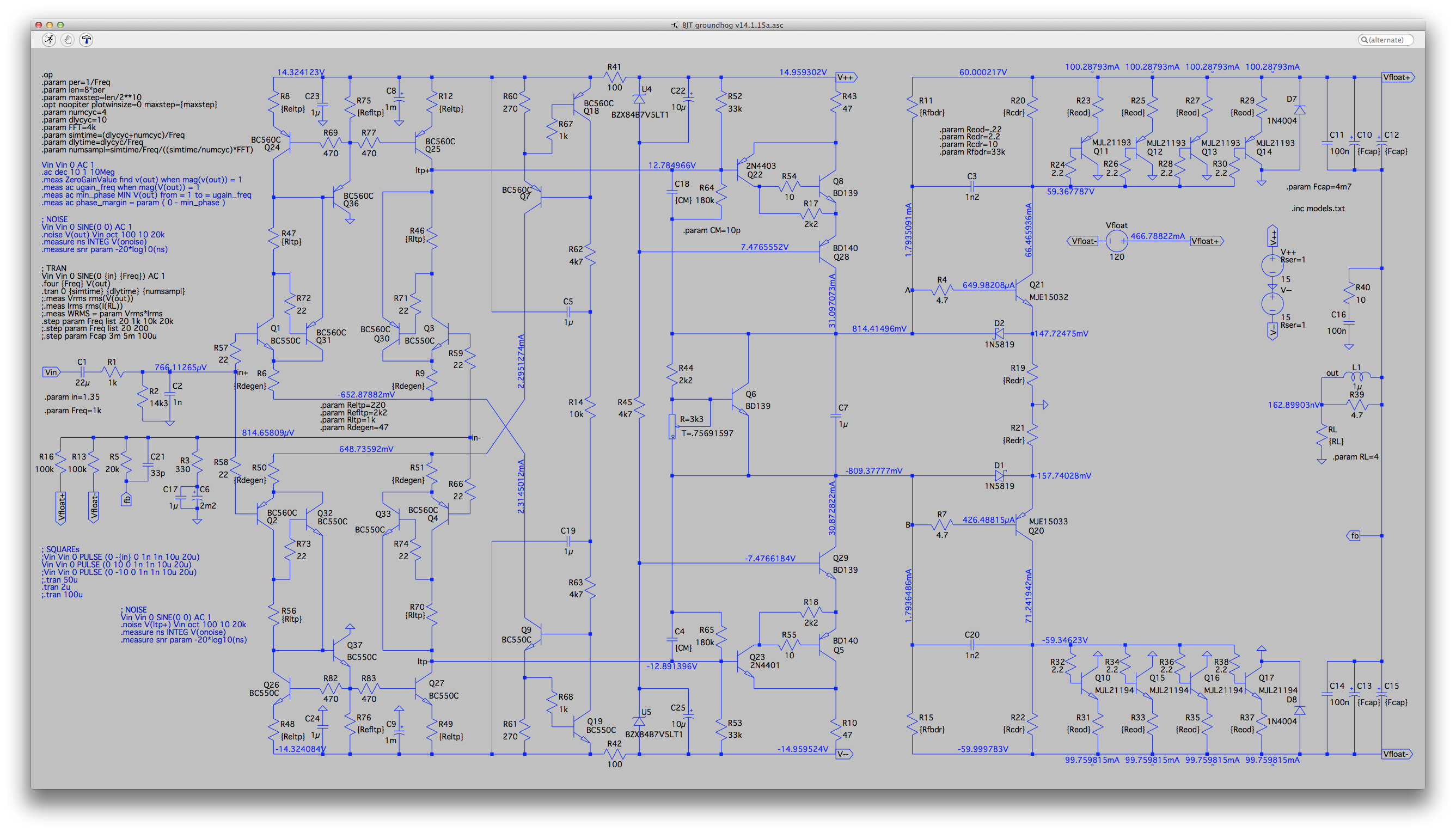

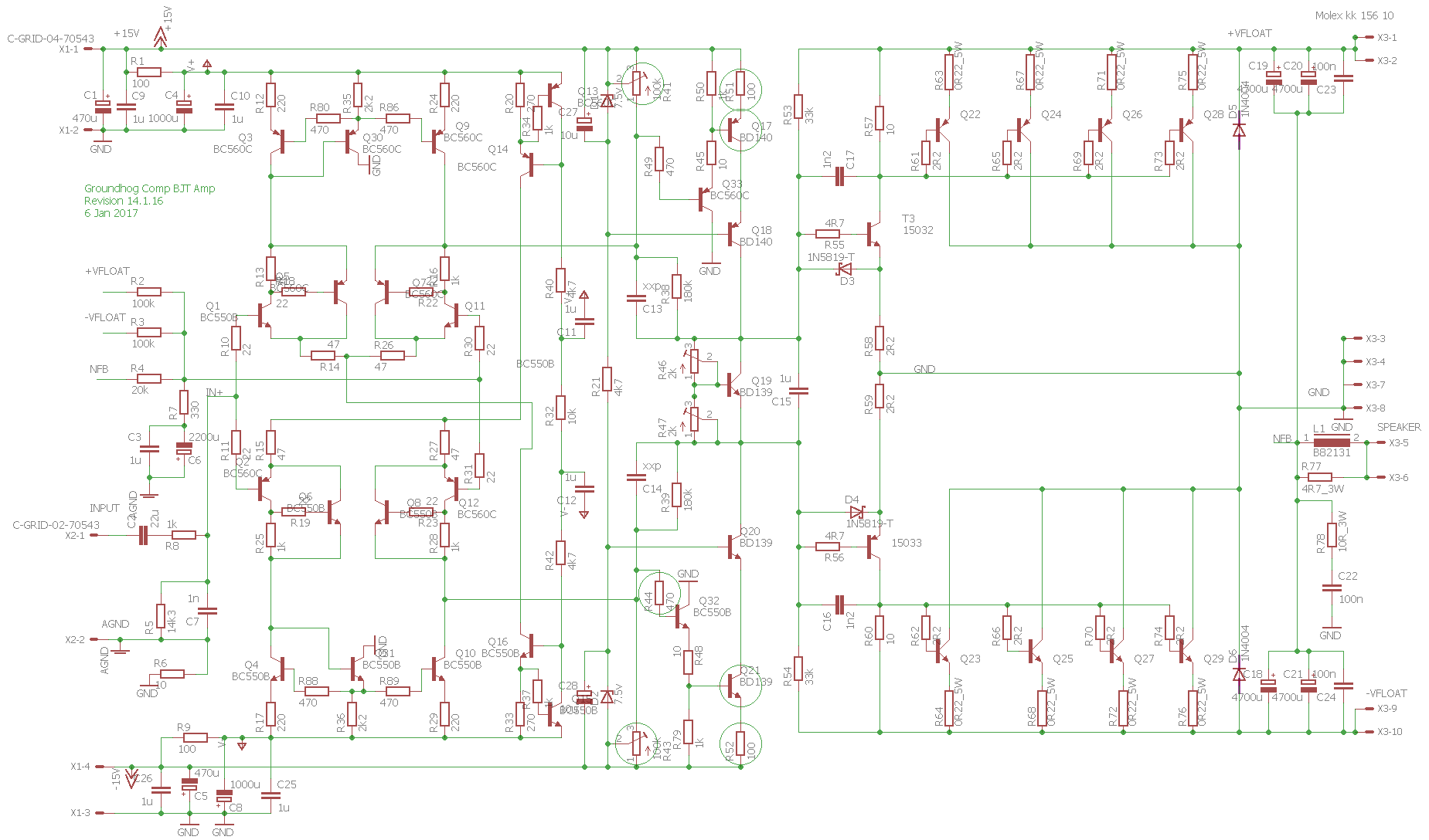

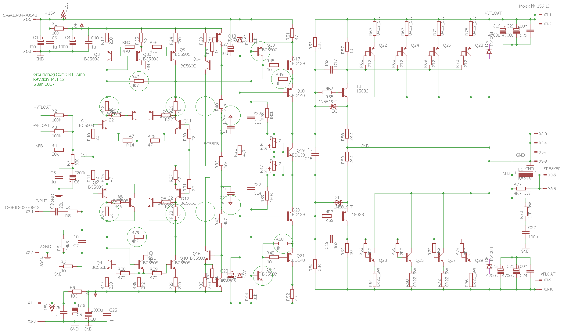

So, I am adopting 1k/47 as standard. I deleted the cascode on the current source. I deleted the Schottky's. The fact that the Schottky's had any effect, albeit negative, implies that the current mirrors do indeed saturate, not so good, but we will defer looking at that.
I added a load resistor across the LTP, which is suggested for stabilizing the VAS operating point by providing a defined load for the LTP/mirror. I'm not convinced, but let's try it.
I changed the VAS input transistor to BC5X0, for reduced Ccb. I prefer the 2n4401 here, but Self claims that there is marked improvement using lower capacitance parts. Once again, try it and we'll know. I also changed its collector load based on what we just learned, hope nothing unexpected arises.
I toyed with changing the BD parts, but later. We need the dissipation capability, at present currents. We have to supply the MJE1503x driver bases with significant current, and these commonplace parts suit that. If we can reduce the standing current and drive requirements, I may try something like 2n440Xs here, for better HF behavior. Later.

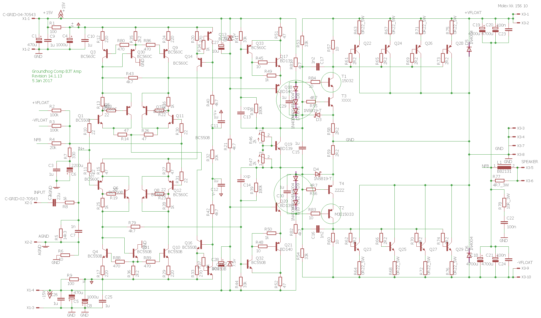

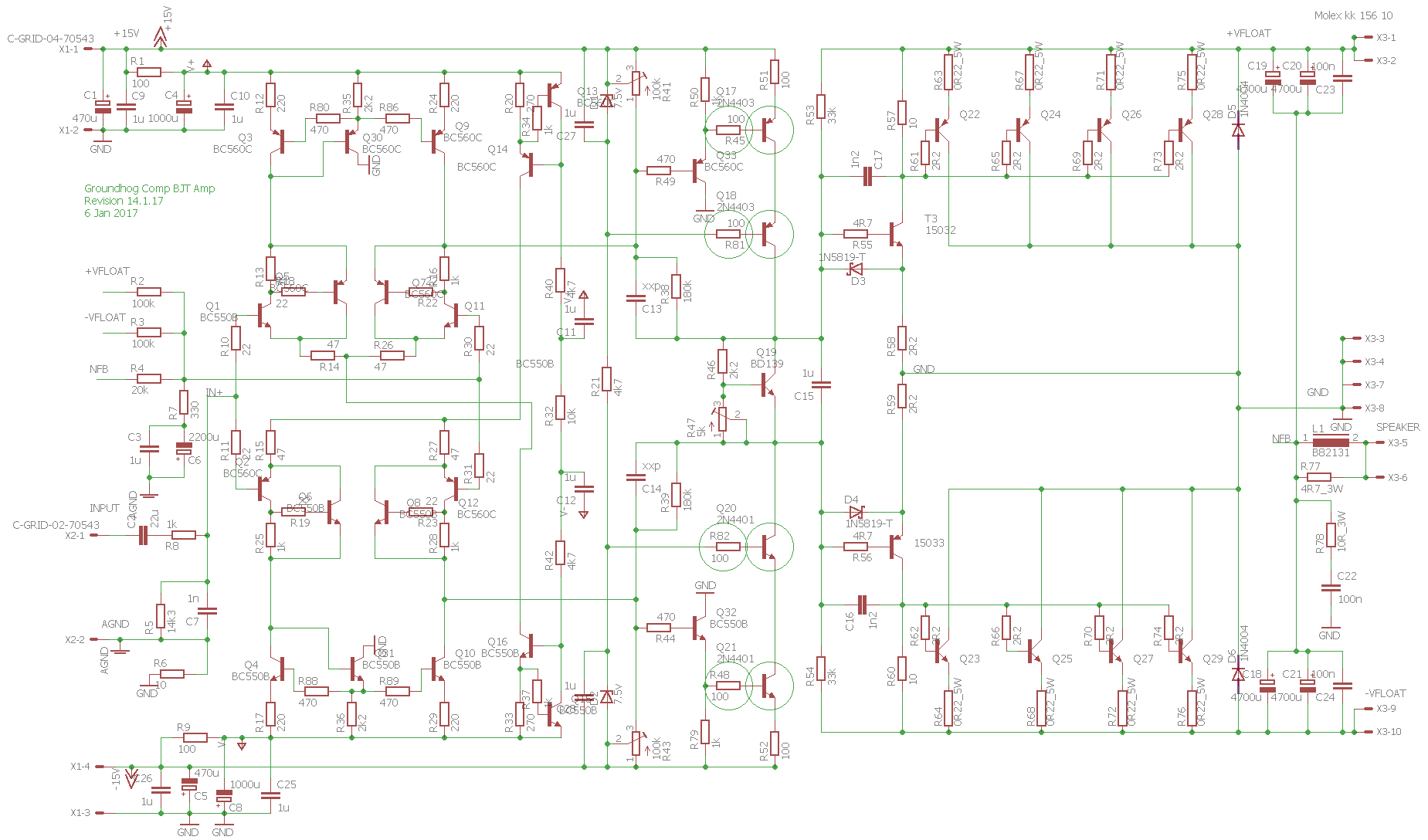

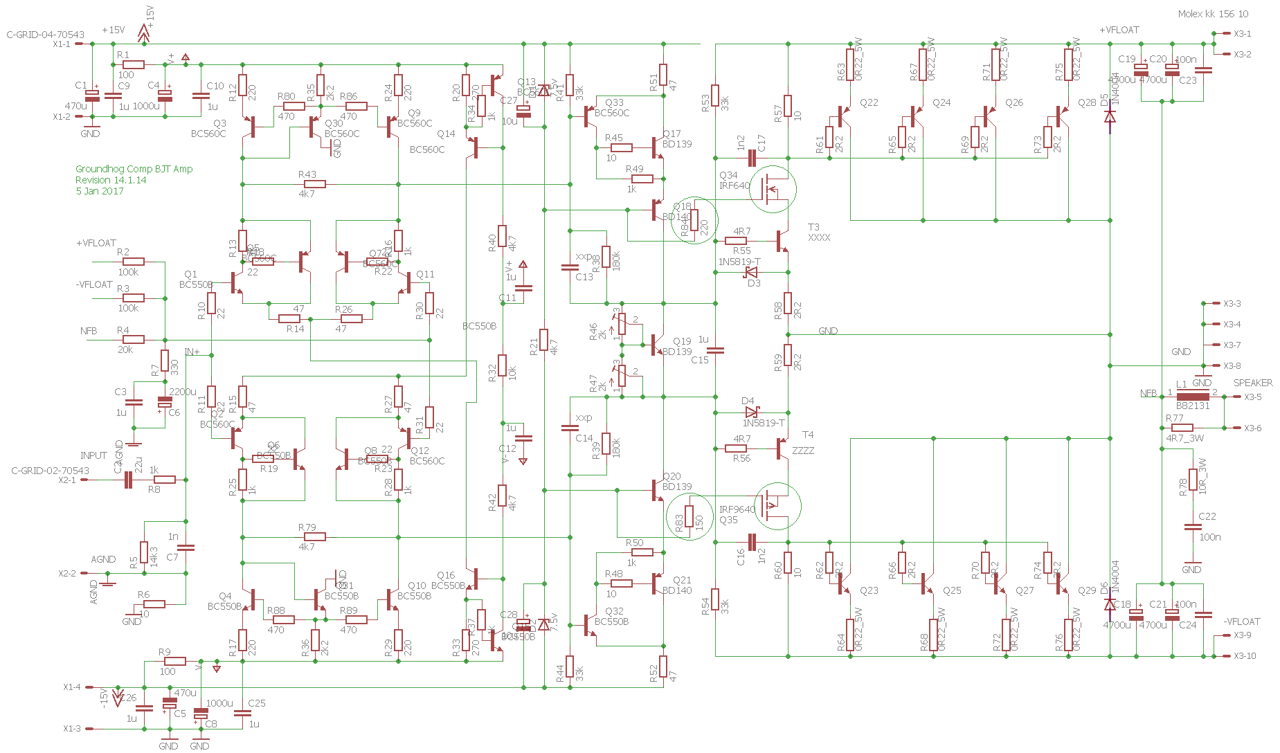

This idea of cascoding the driver is interesting. It's not without issues. Here are two attempts.
I'm hoping someone will suggest a good candidate for the BJT drivers. Can use MJE1503X as standins for now.
In the mosfet version, the 640 is massive overkill but I found it in my eagle library, so here it is. Any 200v part with modest (6A) current capability suits if you have it in your library. Even 240s would stand in. I think the cascode topology is what matters, not the exact part.
Wouldn't the saturation cause non linearities? I assume if something was wrong there, that any induced non linearity would be reflected in worsening thd.
Before running this new sim with all the changes, I started deleting the cascode only and ran it. And indeed the cascode doesn't bring anything there. It's certainly not hurting anything, but without it the noise and thd are the same, so no need to keep the extra complexity there.
This however doesn't seem to bring anything good and causes a thd rise (and not a small one).
It was taking a longer time than usual to find the operating point, and then running the stepped transient sim with 4 frequencies was taking so long that I just ran it at 1khz.
That's possible, and the higher gain may be of help there, but first before we see if there are benefits from that, we should address the issue I mentioned above. I don't really think those different parts are the cause of the thd rise. I suspect more that extra load between the ltp legs (maybe).
Only a harder to reach operating point and much higher thd. Maybe a little tweaking might fix this.
Having them cascoded helps with dissipation, with the load sharing.
By curiosity to check where we stand on this dissipation as it is now, I checked it on each BD part, the vas BD dissipates about 165mW, while its cascode mate dissipates about 228mW. Well within their capabillities, but they should be heatsinked.
Perhaps we could take a look at those MJE340/50 as well.

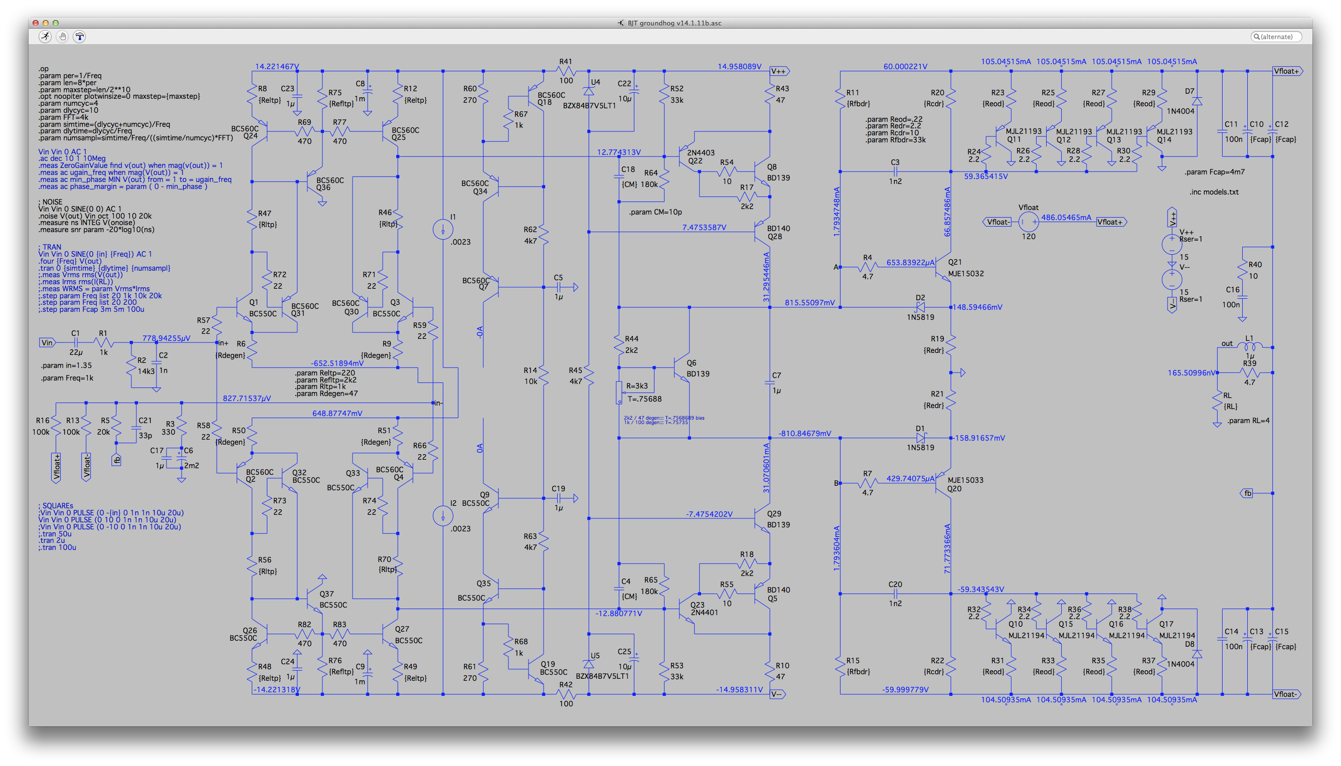

It seems premature to try this out with the previous changes that aren't quite up to par for now.
Perhaps it might be better to try this out on the previous implementation that was known to work well and was performing nicely.
I'm not sure I have good models for the irf640 type parts. That will have to be tested. I don't usually do much with fets in audio, and I'm not certain about the models quality.

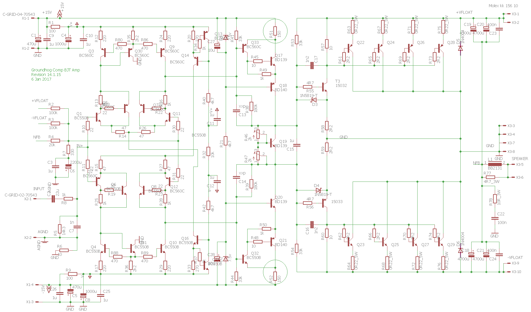

VAS Current: I mentioned that we might be able to reduce distortion in the VAS by reducing current. At present, this is 30ma standing current, but the drivers consume less than 1ma at idle. Reducing this gives us more options for choosing lower capacitance parts.
So, let's try reducing VAS current. This reduces gain at the VAS too, so what is the net effect?
Sure, we've had that current much lower several times before. Recently we had it down around 17-18mA, and that was fine as well.
We can probably do fine with perhaps in the 15mA range, to keep it beefy enough so the needs of the drivers remains little in comparison.
Cutting that current in half would be good enough for lower dissipation.
Ok, to make comparisons meaningful, I'm starting from a previous known working config and I will independently change those parts. Then We'll see how a reduction of the vas bias affects things as well.
One thing to keep in mind with the cascode (on the vas), is that it can be taking the brunt of the voltage swing and dissipation, while the vas transistor being shielded somewhat by its cascode companion could be a high gain low cob and lower vce part. We should easily be able to use the BC550x or whatever, instead of the BD parts, especially if we do reduce the vas bias, the dissipation there should be well within the capabilities of a non heatsinked TO92 part or similar. The bulk of the dissipation can happen in the cascode.
I'm posting the config with the 2N440x and the BD parts, with the 2k2 and 47ohms vas load, to use as the reference with the next configs with each part changed. This should make the comparison easier.
None of this stuff should affect the noise figures, so there is no point in cluttering the results with that.
And by the way, a lot of the noise in the ltp stages is a function of the tail current, as well as the values of the resistors that set the gain (feedback, input filter...)
We've tweaked this already and it's a tough compromise, as this affects also the input impedance and a few other things. But the lower those resistor values, the lower the noise figure. And of course, the lower the tail current, the lower the noise.
So many compromises.
I will also post something interesting shortly. I just ran a simple sim on a dual ltp similar to what we're using, just to see what the effect of the degeneration resistors is on the ltp, and see how much linear range we can expect with different degen res values. This result speaks volumes.
