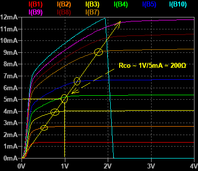

@ Keantoken, few more notes.
VAR is set to 100 for both transistors, almost certainly a (bad) default.
VAR will inevitably be much lower than VAF -
for the 5200 VAF is 400 so VAR=100 may not be too bad
but for the 1943 VAF is only 80 so VAR=100 is surely off, maybe 20.
Usually not important for audio circuits but may as well be as realistic as possible.
I notice there is no QCO parameter in your quasi-saturation updates, this probably is important for accuracy.
Especially for simulations of stability, that I like to check quite carefully.
I see RCO is around 5 times RC, this seems physically plausible, you noticed any rule-of-thumb here?
Best wishes
David
As you stated those parameters are probably not important, hence why I didn't make more work for myself without having data.
Qco could be improved, sure. But with what data? Have you found a rule of thumb? Maybe if OStripper could probe the base current with a combination sine+square wave at the edge of clipping?
The upper quasi-saturation corner always falls on the yellow line shown in the picture, regardless of Beta, Gamma, Rc and the other parameters. So Rco is one of the parameters you can set early on.
What ... Sine/ square combo (define) , like what I have shown ?.

Say a small 200KHz square wave riding on a 10KHz sine wave. The square wave only needs to be large enough to get a clear trace of the base charging current. The current can be probed by using the scope in differential mode and probing across the base stopper. It should be a schematic with a close simulation, then I can adjust the parameters to get the same result.
I think quasi can be close to as good if not sometimes better than complimentary. It would be a good way to use N-only MOSFETs. But it does not eliminate the crossover distortion.
Also another problem is some of them have positive tempco up to high currents, so thermal runaway could occur.
If a parameter is less important then I don't take this as a reason not to fix it.
Rather it means I am satisfied to use a reasonable estimate, it's very little work and still far better than a bad default.
For an important parameter I would prefer measured data or else have less confidence in the simulation.
It should be approximately proportional to CJC (QCO is in coulombs CJC is a capacitance in farads).
If there's about a volt across the junction then the numerical value will be about the same.
I have seen some data that is consistent with that, you have any data on this?
Yes, my conclusion also.

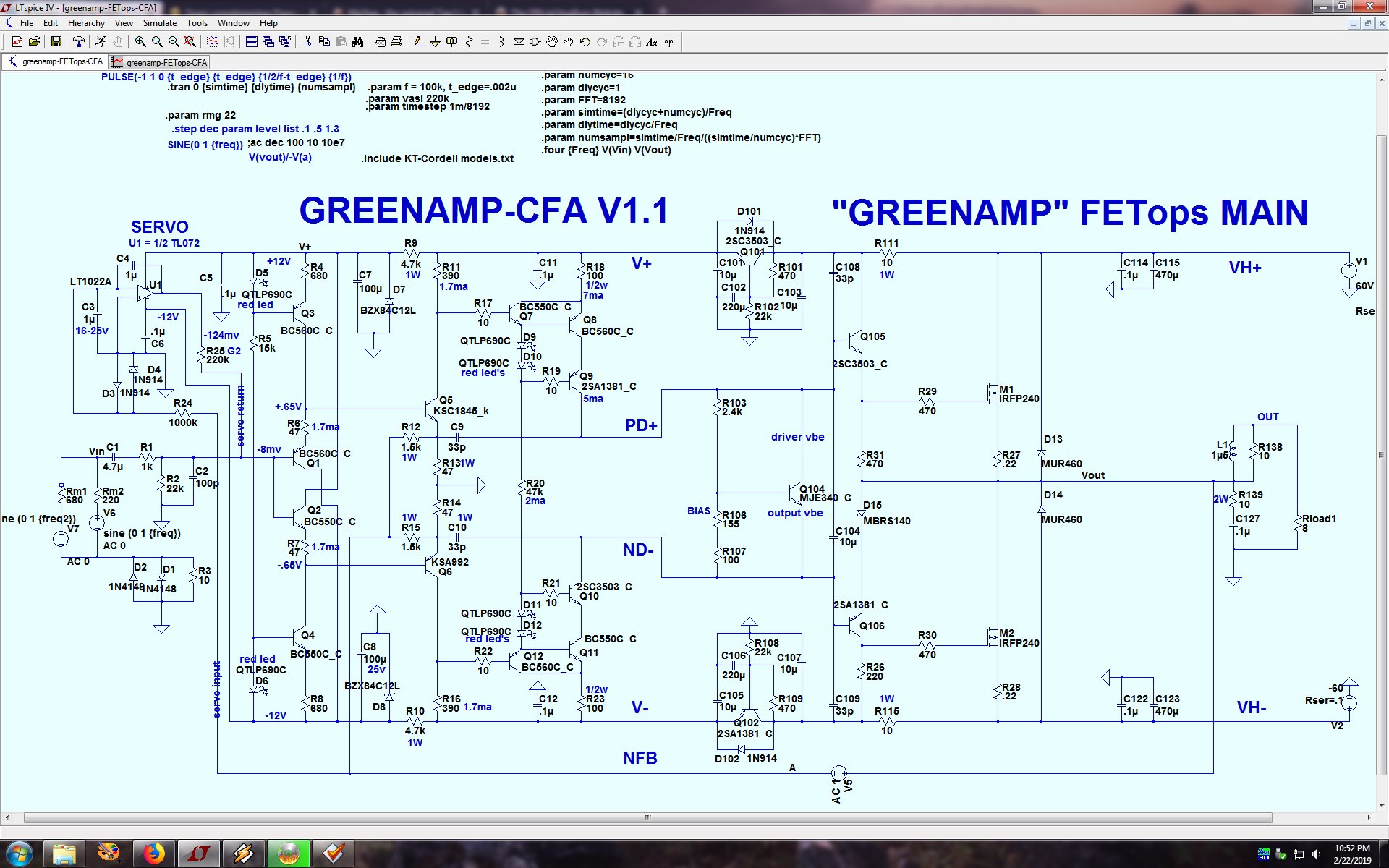

Actually , I already have a quasicomp on the LT spice "burner". First amp
I made 10 years ago. Quasi-complementary Power Amps @ AmpsLab
Be a good learner to wrap a output stage error correction circuit around a few SiC's.
(Below 1).
Don't worry , I will get this stage to only add a few PPM to the golden CFA.
Looking at error correction "super TIS" article now. Lots of good stuff out in the wild.

I notice you renamed the 5200/1943 models. The -O is the Hfe grade, so it is part of the model number.
I don't keep any models in LT's "BJT" bin. Everything is manual , I copy/paste
model #'s right out of the text files ... except standard diode and op-amp models.
.include is my way.
For my fancy Infineon schottkey's or VDMOS models , I just include Dadod's
.txt or my infineon text.
