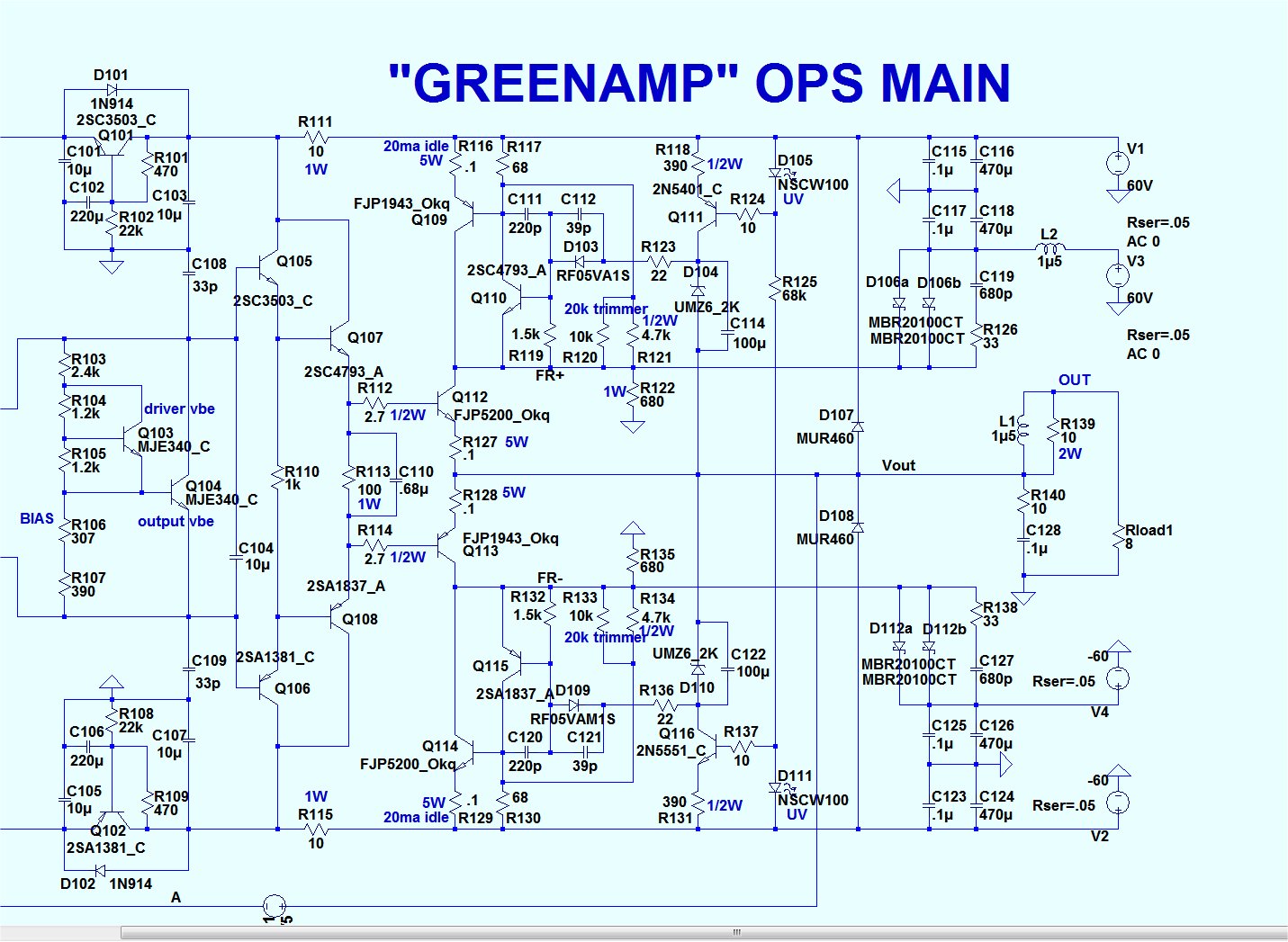

OPS is final ...
Unless Mr. Zan "can raise the Bar" ...

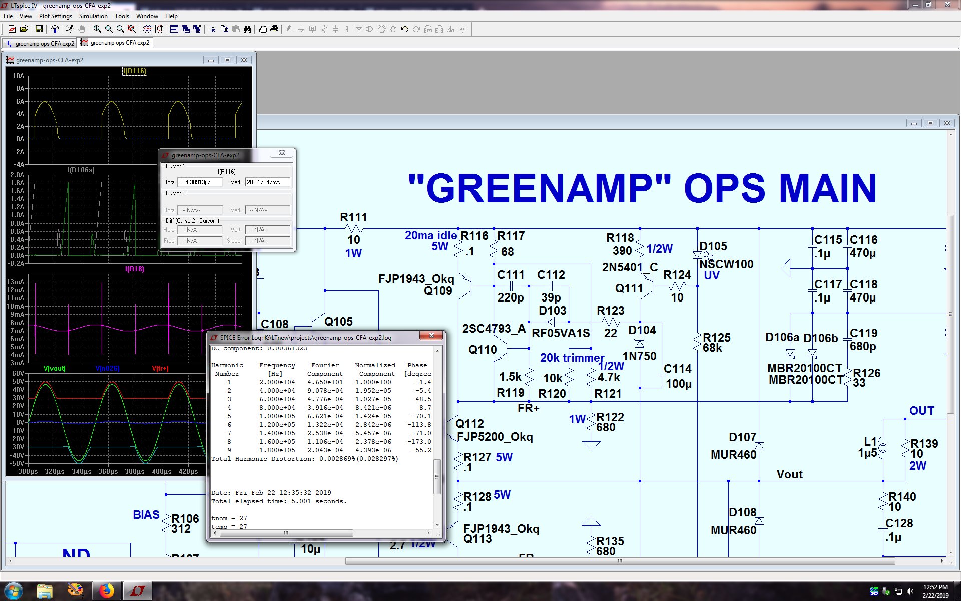

I went "original" -
Final .ASC , too.
I can't bit$h about 30ppm , even with the Schottkey switching.
Also is the Diode / Class H "handoff" in the second attachment.
REAL class H !!
Time for sprint layout (and component shopping).

The pic you attached has the lower V supply same as the upper 60 V.
Ok in the ASC.

where are the multiple supplies or envelope tracking bucks with required coil.
the schematic looks like an odd 60v dual rail setup. this being the case, no power loss is eliminated by linear regulation of the 60v supplies to 30v supplies.
V3, V4 are most likely 30 V 😉
I just upped the inner rails to 60V without changing the schema. Set it back
to class H before I submitted it.
I "wrapped" this project around the known slewmaster OPS. So one can compare
the max 15ppm of the EF3 with the 30ppm of the class H.

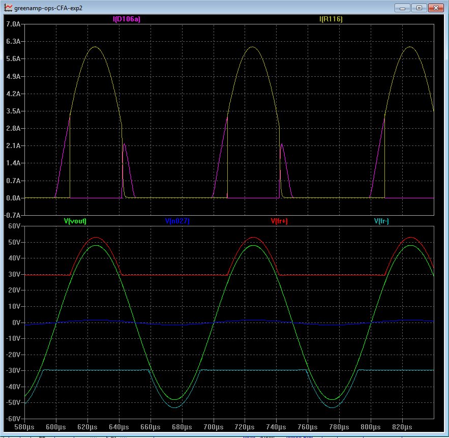

The trackers now don't switch at 20Khz (Below 1-top plot)
The schottkey's switchoff (D106) corresponds to the "glitch" at the VAS (R18).
The CFA is so sensitive it shows the diodes (and AB crossover). It also
corrects it to <30ppm 20khz .
I am hoping that the selection of this will help :
https://www.mouser.com/datasheet/2/196/Infineon-IDM10G120C5-DS-v02_00-EN-1226682.pdf
"NO forward or reverse recovery" SiC Schottky. It is that reverse recovery spike that is affecting my pursuit of near perfect performance.

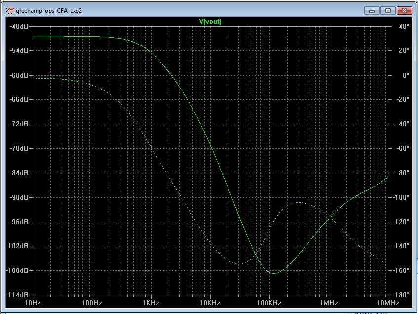

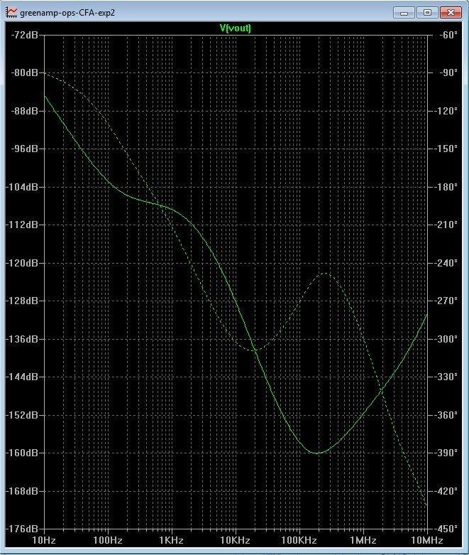

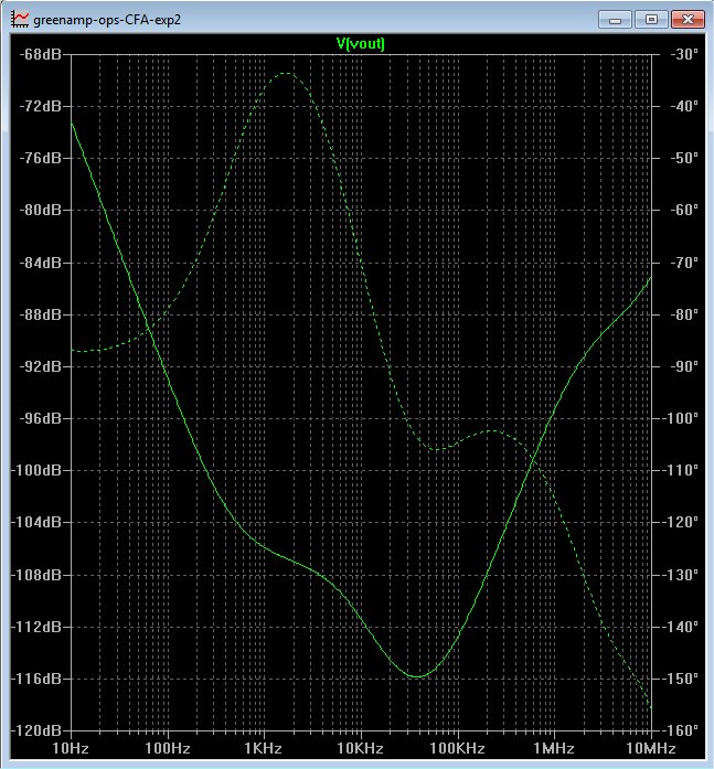

How about a low current full voltage separate ips power supply
Why , voltage loss through the cap multipliers ?
Or ,the multipliers themselves ? Even with this CFA, PSRR is -100db
Think about this ... between the multipliers and the class H , we lose 8 volts
output swing. Clipping starts at the IPS VAS. This is good , the output stage
never saturates.
And , with this amp .. neither does the VAS/IPS.
If you did have a separate IPS supply , the VAS would not clip first.
But , you still have the Class H trackers to limit the swing of the output stage.
It is best to leave it as it is - make dual mono analog 30V supplies , with a big
Connex 600W SMPS for the 60V rail (use for both channels).
30V supplies can be small 2-300VA ,not many amps up to 50v p-p .
In class H , the trackers act as series regulators. The output stage is
fully regulated in this instance .
Edit - ripple on the outer rails is almost at (PSRR) nonexistence.
