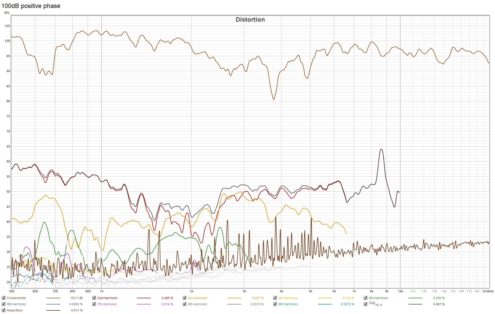

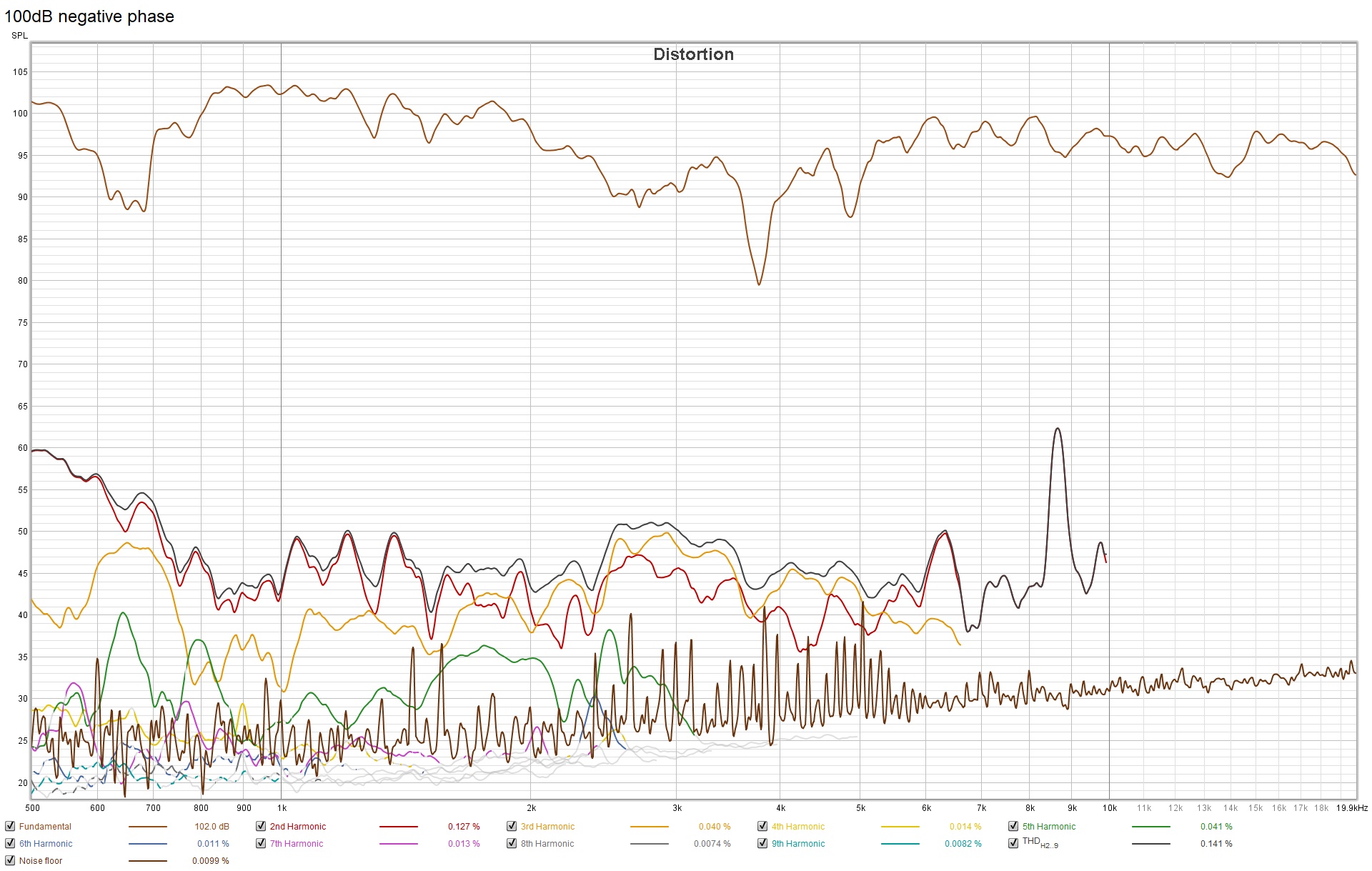

Another mechanism may be at play. If the amplifier's distortion is low order and approximately the magnitude of the speaker's it can reduce distortion reaching the listener. It's measurable and potentially significant.
The REW plots below used a pentode SET with ~0.35 THD @ 1 watt, predominantly 2nd order with the 3rd about 0.03%. 4th is about 100db below fundamental. The speaker is an ancient tweaked PSB Alpha Mite used for bench testing. The measurements were quick and dirty at a distance of under 1 foot, the speaker on a paint can and the mic resting on a bench vice.
Distortion reduction is clear on either side of the 3kHz crossover point when speaker phase is reversed. REW gives THD2-9 figures of 0.487% and 0.141%. I would expect one polarity adds distortion as well. For completion this needs to be followed up with equivalent plots using a standard low distortion amplifier. This SET also permits 'tuning' the level of the 2nd harmonic with minor bias/B+ changes, suggesting more effective cancellation is possible. I would also anticipate more broadband cancellation from a crossover-less full range driver.
SET feed-forward?
