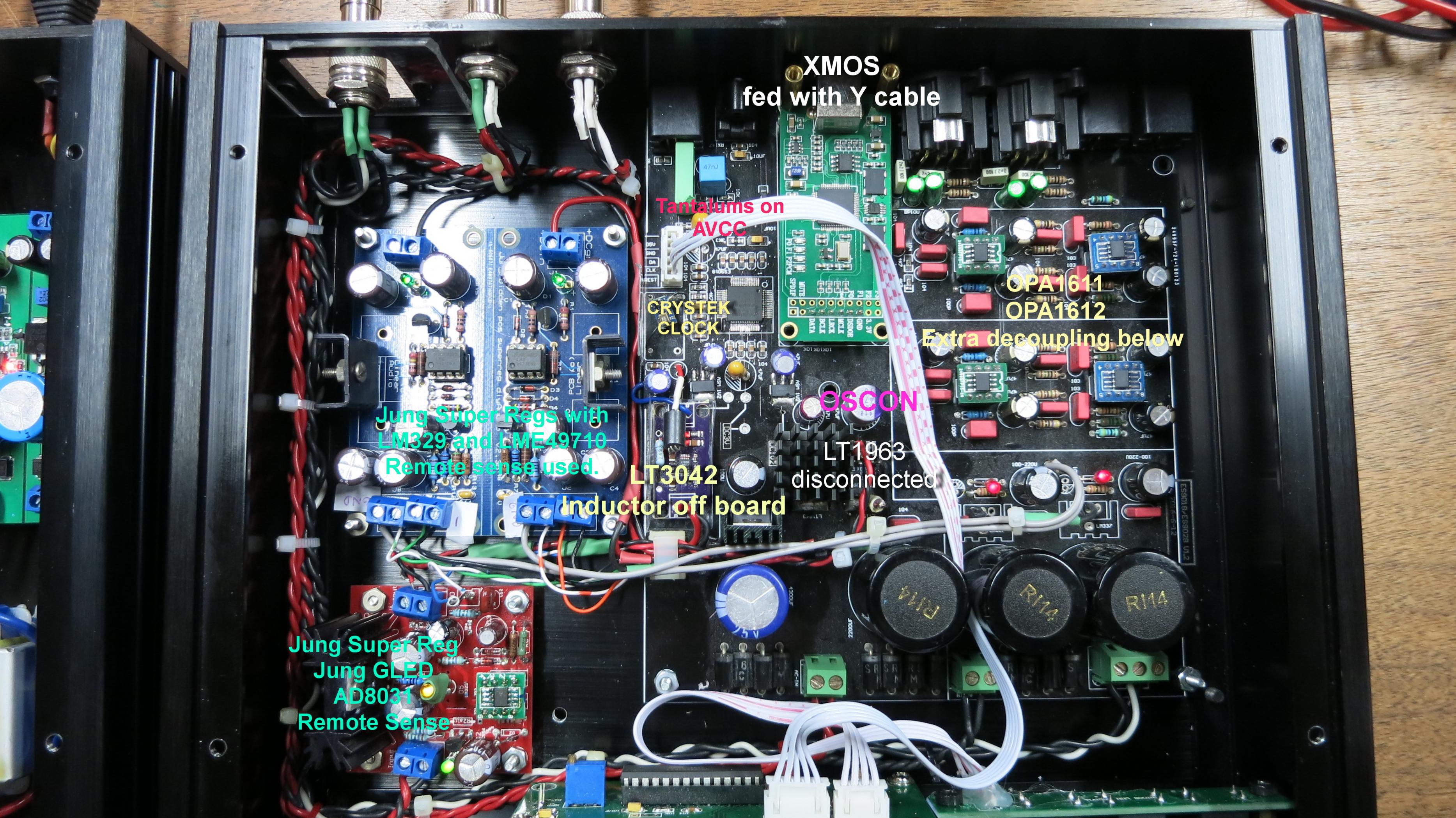

Then one December evening, I had noticed how " reasonable" a DAC board could be. Heck I did not know the difference between an ESS9038Q2m and an ESS9038Pro. But that DAC board for only $39 sure looked attactive. All I needed was a dual 15V power supply and I had an extra one in the parts bin which actually was small. So I decided I would "try" that. ...and I could empty my parts bin. Seemed like a plan.
Then the Dac board was a popular one on diyaudio and I learned of the mods that could be done. Oh Oh.....like a junkie getting another fix.
So after frying that $39 DAC, I elected to go bigger or go home. Then I started playing with all sorts of LDOs, clockc, new op amps. Now my "spare parts bin is bigger than ever. I have so many things that are new now. More chips amps, DAC, preamps, head amps, 3xTPA 3116D2, TPA 3251 etc etc. all because that DAC board for $39 got me going. DIY audio adds up when curiosity comes calling.
So did I enjoy it, yeah, but it really adds up. Don't do it for "saving" money. It's a drug.

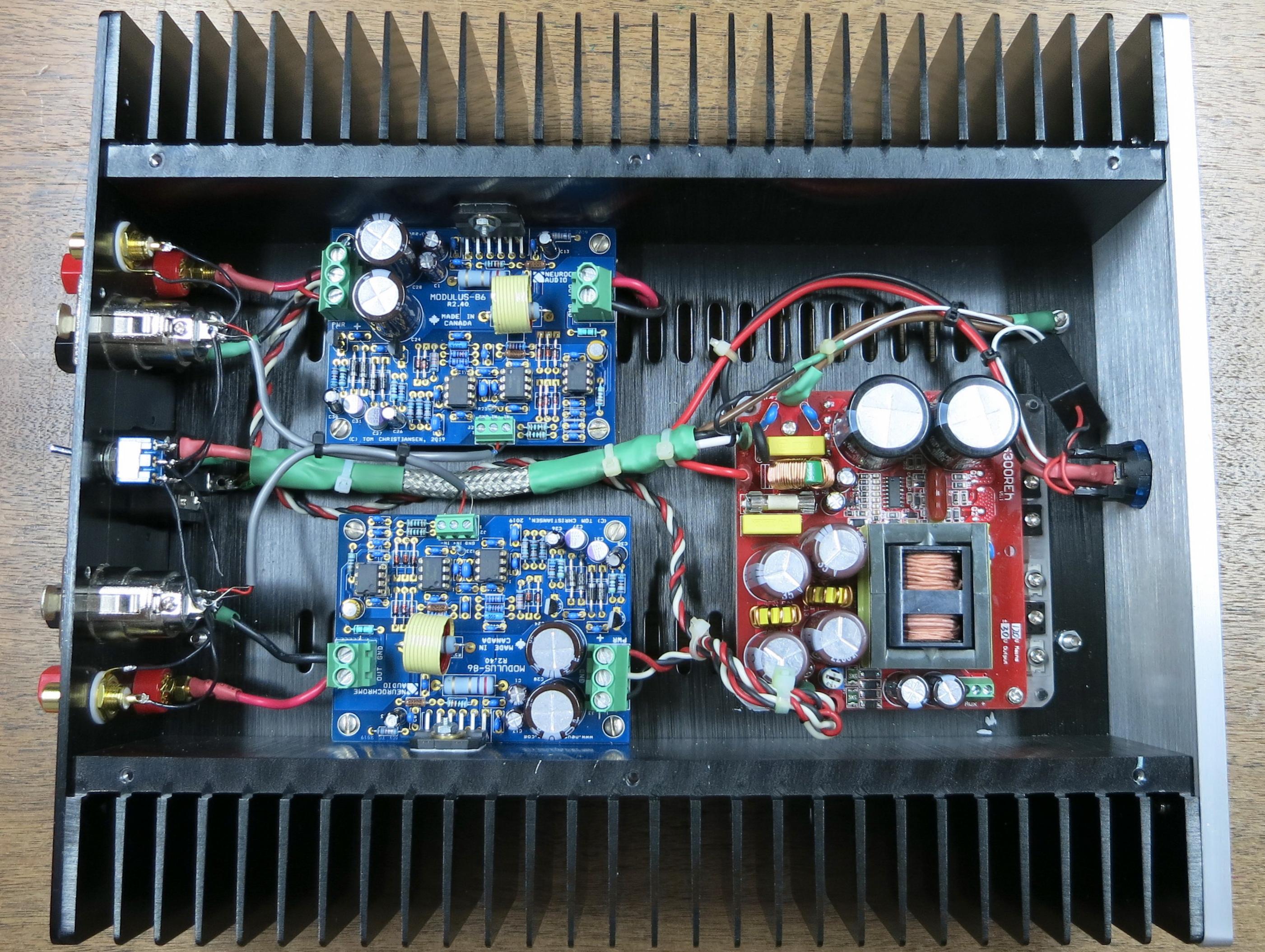

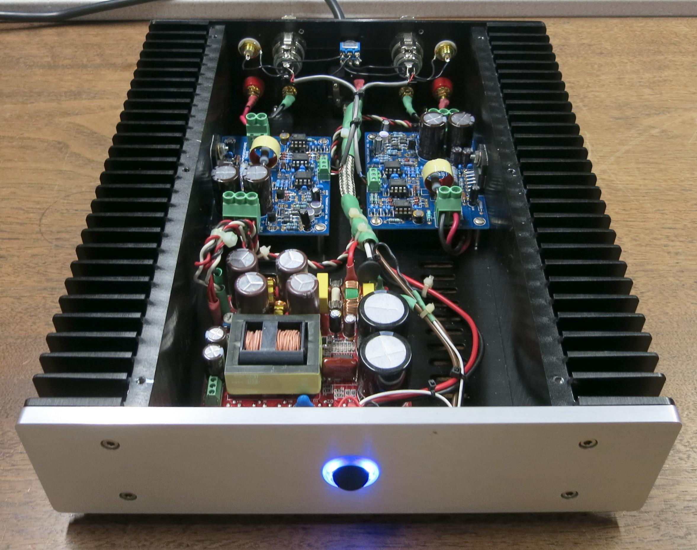

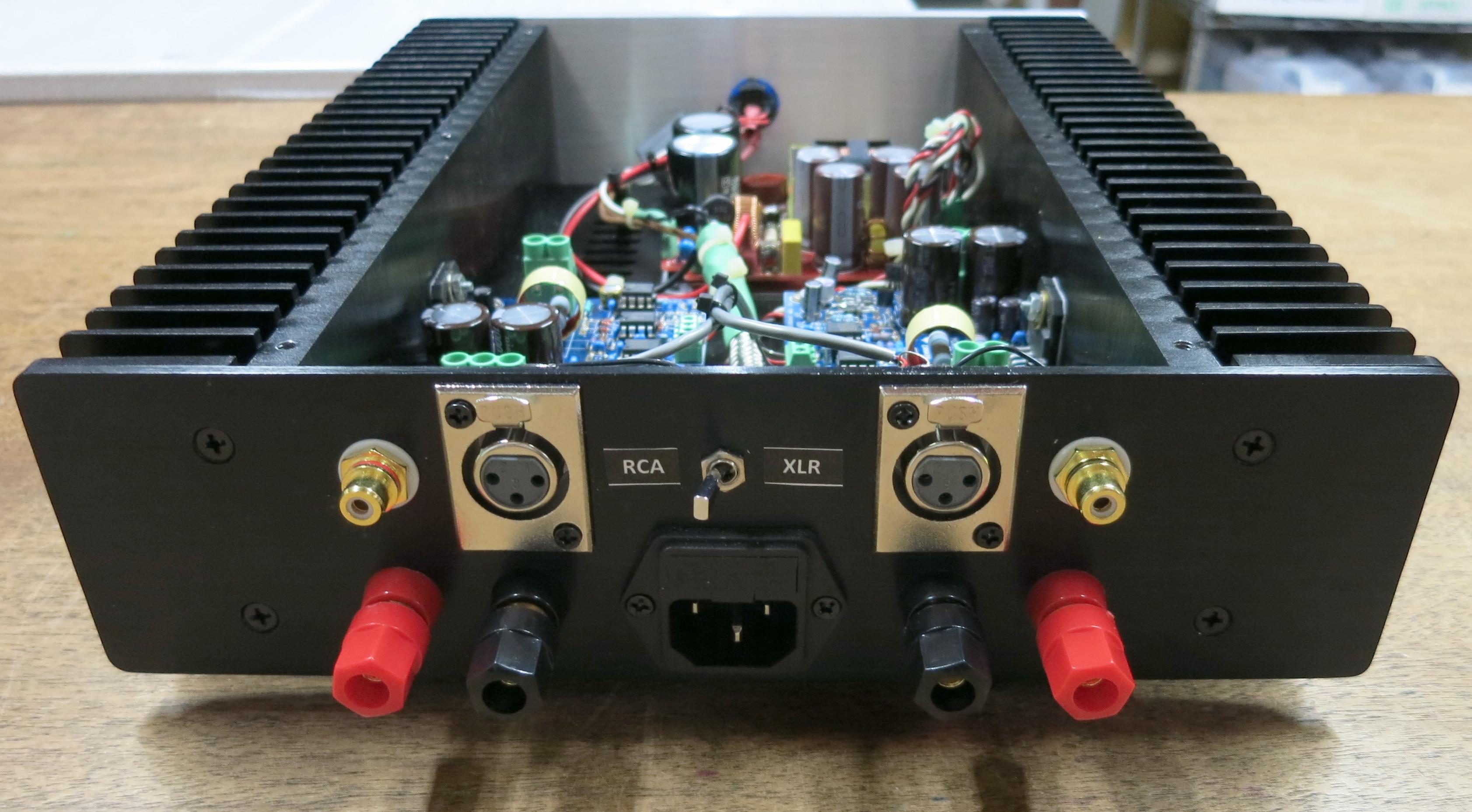

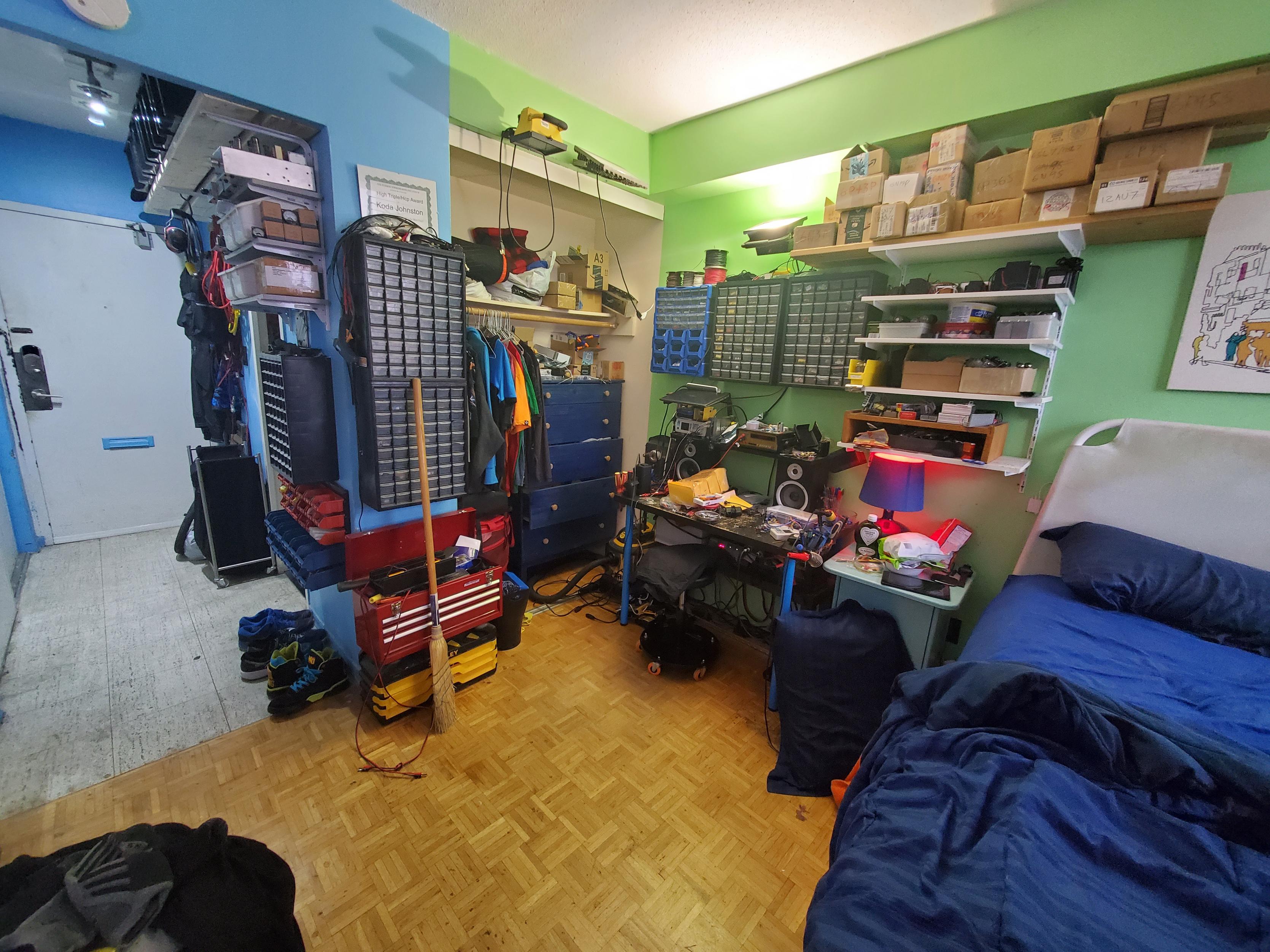

Got enough light in there? I spot another 1000Watt or something workling on the left side.
Don't laugh, as you get older those things become invaluable. I'm down that hole right now. Soldering can be a bit challenging nowadays especially with the SMD stuff.
I got one of those things you wear on your head like a welder's visor that has the light and the magnifying glass. I find I put that on first thing no matter what I am doing. At 67 just starting to see a tremor in the hands that may spell the beginning of the end for smt work.
Impressive build. How do they sound?
Well, this is what I have to say. The Modulus 86 completely shocked me as I was NOT expecting it to be that good. It is now immediately in my main system now.
The punch, clarity and detail but NOT sterile and clinical or bright. Totally noisefree. It's only running on 28 Volt rails but it sounds much more powerful than that. It does not compress as it is turned up. So it never sounds "loud" and there is no indication the limit is approaching...it is easy to overdrive because it always sound effortless until the limit is reached. That's the downside of a low power but powerful sounding amp. Good thing I no longer listen loud. It replaces a 100lb beast of a power amp.

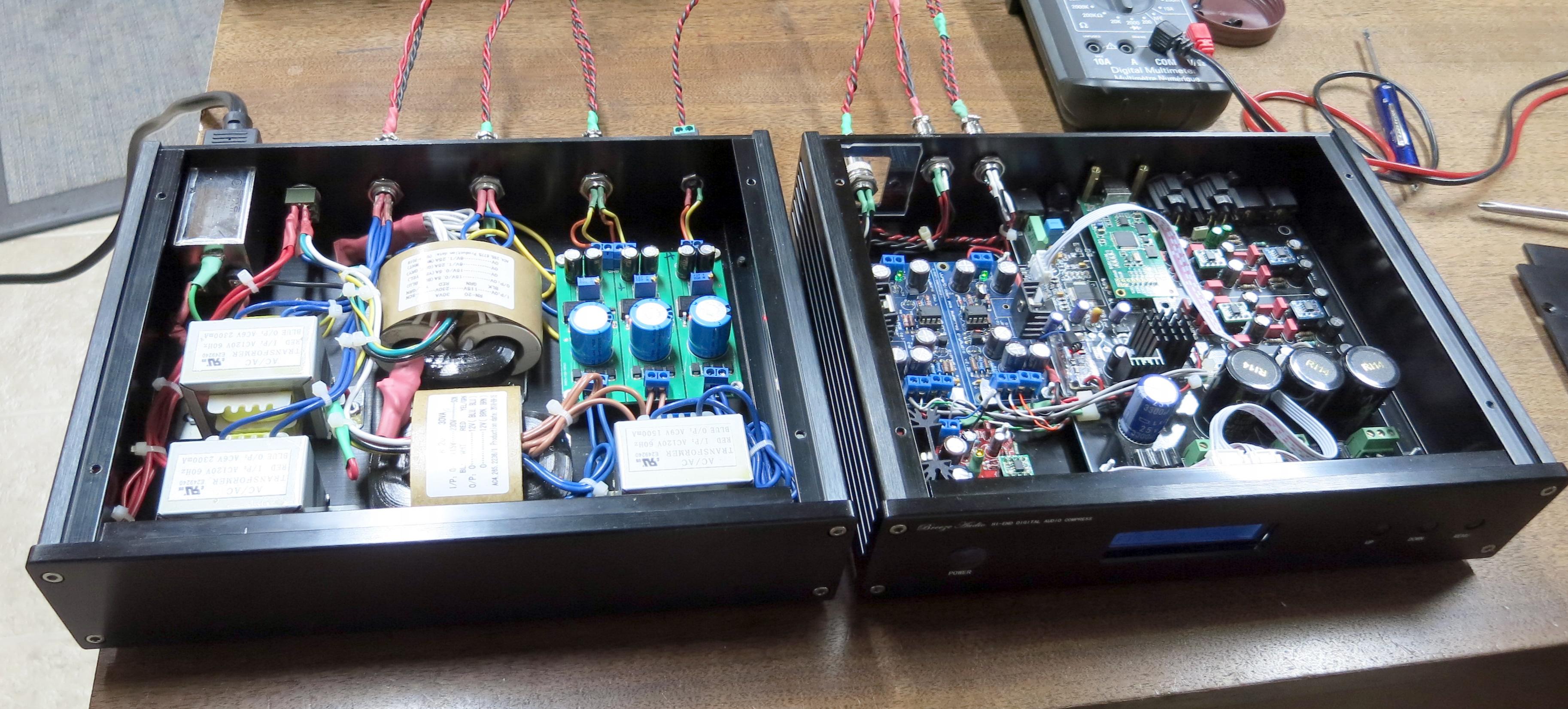

It is being driven by me LME49600 and LME49710 hybrid head amp as a preamp. The modded DAC, ESS9028Pro has been transformed. I was about to keep a Topping D90 but there was always that roughness and lack of body and dimensionality in female vocals. This forced me to finish up my mods of the 9028pro. In the end, I returned the D90 with MQA and kept/finshed my generic Ebay ESS9028PRO.
Again, when I consider the total money invested in the modded DAC, it probably approached the cost of the Topping D90. It was a learning experience.
So in conclusion, my system has dramatically improved since 4 years ago. The DAC is about the same size since the current stack with an external power supply case replaces an Assemblage DAC2 stack with a jitterbug.
