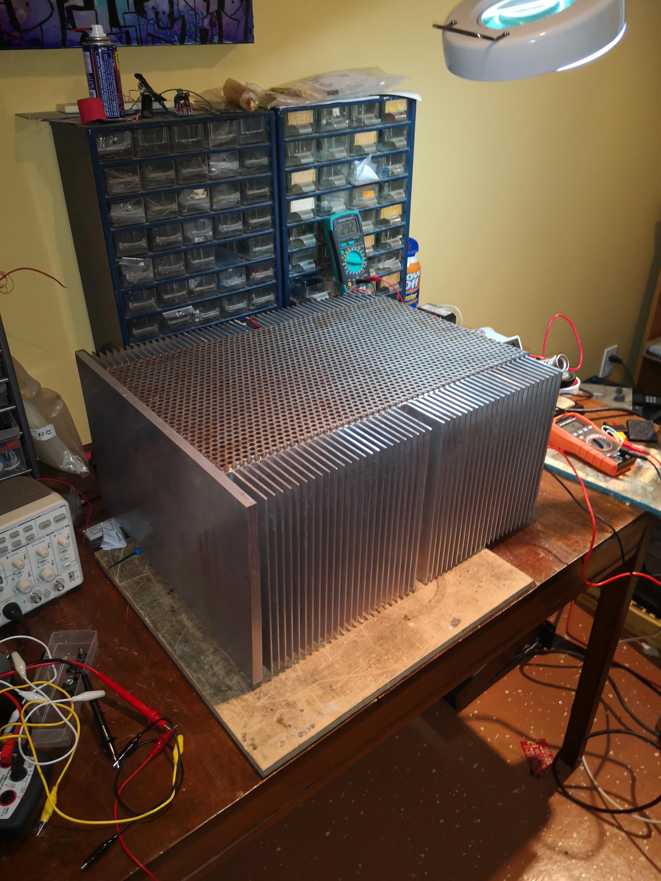

It's just an ex kitchen table.

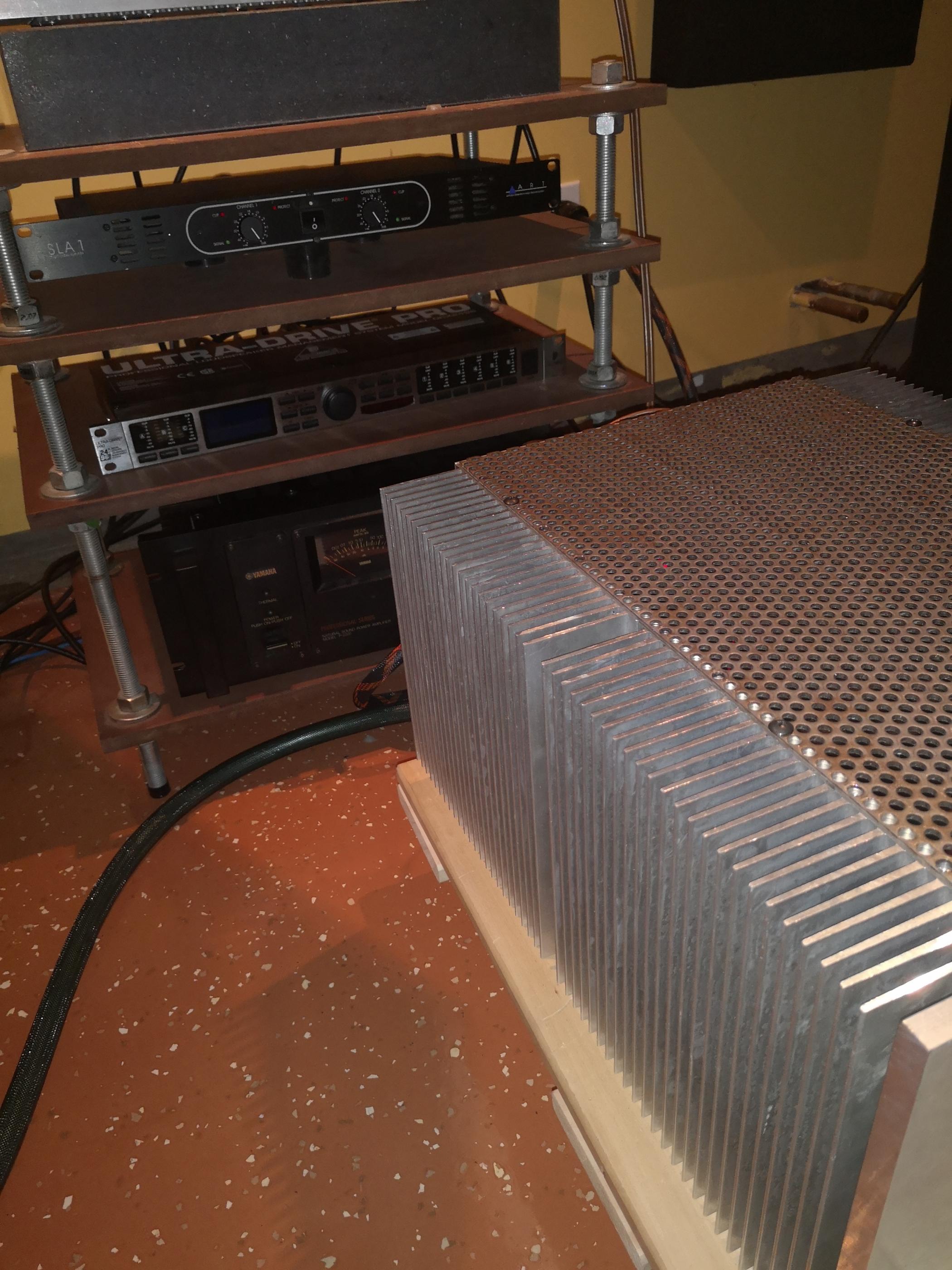

Here's the shot of the amp where it now lives.... on it's moving dolly. The amp behind it is a Yamaha P2200 Class AB from the 70's. The heatsinks are 20"x10" each side, the overall width is about 17". It was supposed to fit between the uprights of a 19" rack. Very cramped inside.

Nice work BigE. That is one serious amp! Does it come with its own substation?
The transformer is stupid oversized. It is a plitron toroid with 5 sets of 60-0-60 secondaries. putting out 2.4 KVA. Wired as 240 volt primary, it only does 30-0-30, 1.2KVA.
4 sets of secondaries are used out of the 5, two sets of secondaries per channel, giving 480 VA per channel. (I've been told that's an underrated value, and to expect 600 VA/channel due to the transformer running at 1/2 voltage. )
The transformer weights 20.1 Kg. A small auxilliary transformer is in the box to power the capacitor bank slow charge relays. It has 88000 uF of storage per channel, mounted vertically on the back of the face plate. It has two sets of rectifiers, also on the face plate, so it's fully dual mono up to the primaries.
Biased to around 80 watts peak Class A into 8 ohms. It has 4 pairs of secondaries, so it can be used on 4 ohm speakers. Into 4 ohms, it's 40 watts class A, or 20 WPC class A RMS. That's 1KG of transformer per 4 ohm class A watt.

An oversized transformer usually is a good thing for sound and an oversized Plitron is even better. No doubt it delivers with authority.The transformer is stupid oversized. It is a plitron toroid with 5 sets of 60-0-60 secondaries. putting out 2.4 KVA. Wired as 240 volt primary, it only does 30-0-30, 1.2KVA.
I was curious about the test equipment I saw the corner of.
-Chris
That's a low end rigol. Also hsve a qa400.
And a Klein home Depot meter
Authority is a good description.
