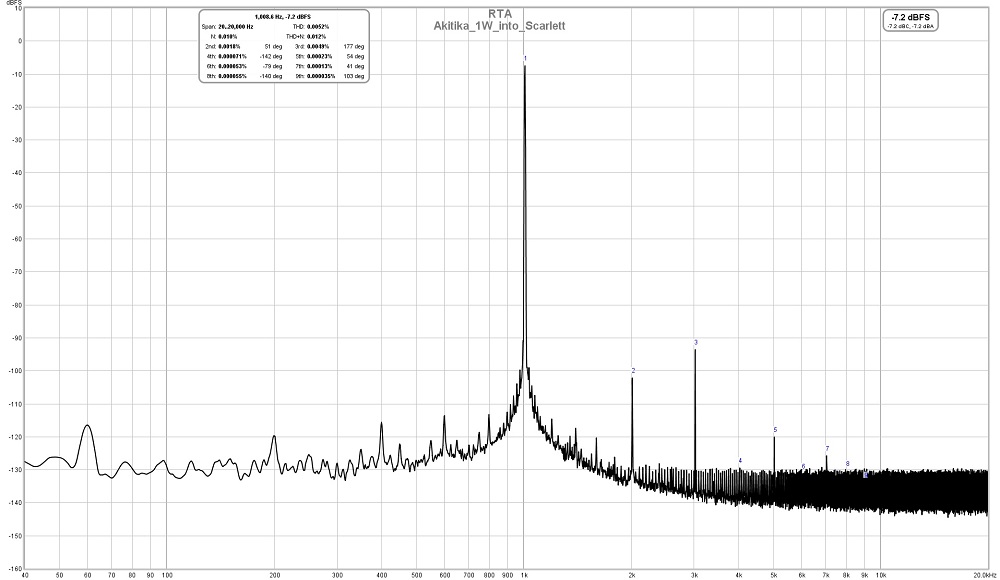

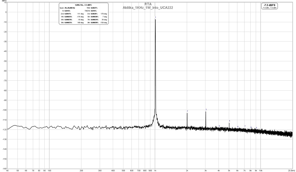

If you want a cheap sound card that performs pretty well, I have used the Behringer UCA222 ($24 on Amazon) and with a good quality 1KHz source, I get a noise floor about -110dB below the fundamental. The Focusrite Scarlett can do better than -120dB.

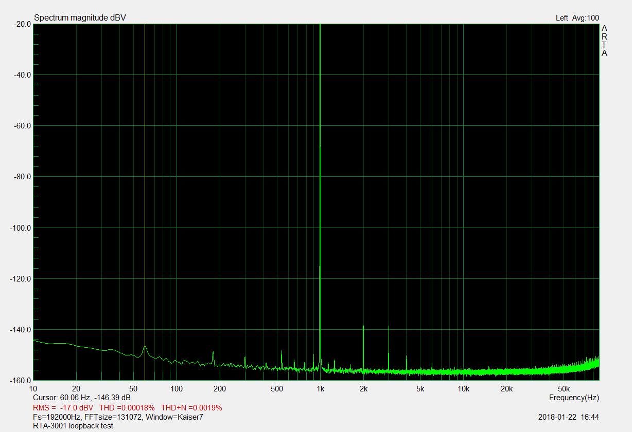

Better than nothing for sure. However it is too easy to blow the inputs of a sound card up. Most handle 5 V maximum at around 10 K before damage. Plus, they aren't differential like purpose built audio analyzers.
The best way to do this without the real thing is to use a distortion meter as a front end and plug your sound card into the monitor out. One channel at a time.

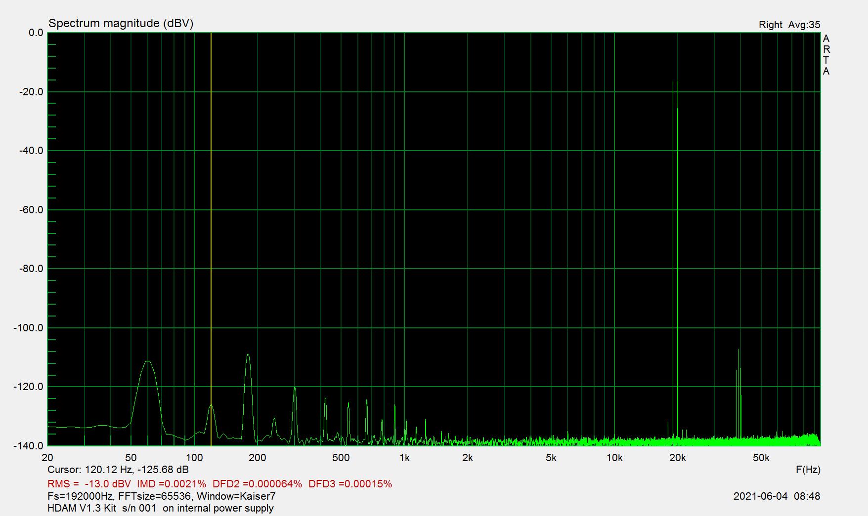

This is an example - random. The last thing I built, an "HDAM" preamp kit off Ebay. Its performance is pretty good (really good actually, and it sounds great!). The source signal is part of the instrument. Here is a loop back test.
So using a really good distortion analyzer like Rick's Amber, and a good sound card ($100 +) will get you closer to this. I know an analyzer is expensive, and that is why I am offering to test anyone's equipment here if you want to make the trip to my place at any point.
