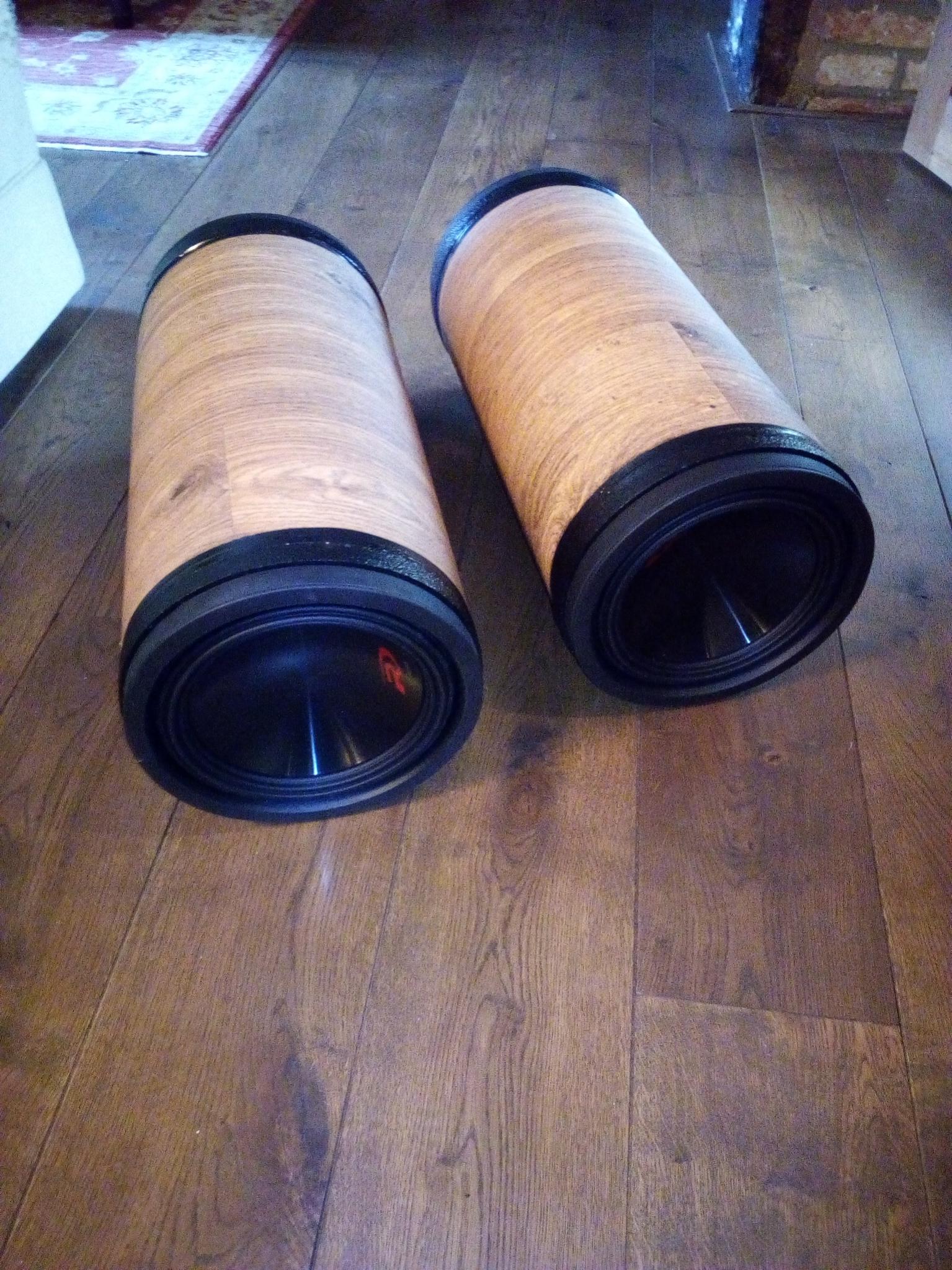

I have actually finished the sub's now. I have each sub in a separated enclosure (25mm MDF partition) and have wired each to 4 ohms. My plan is as you first suggested to have each of the four channels driving a sub. So separate enclosures and amps.

About how much does each completed sub enclosure weigh? And how do you find time to do all of this in the span of a week???

Each sub weighs in just about 30kg. The 5mm threaded rods (PITA to fit!), damping products and 25mm MDF, along with the thick pipe adds up.
Of course the weight doesn't really matter anyway, as the mechanical force cancelling configuration means the enclosures don't have to be really heavy!
I have managed to get so much done, because I have had the week off - putting in 12-14 hours a day on this build......I am feeling a little broken!

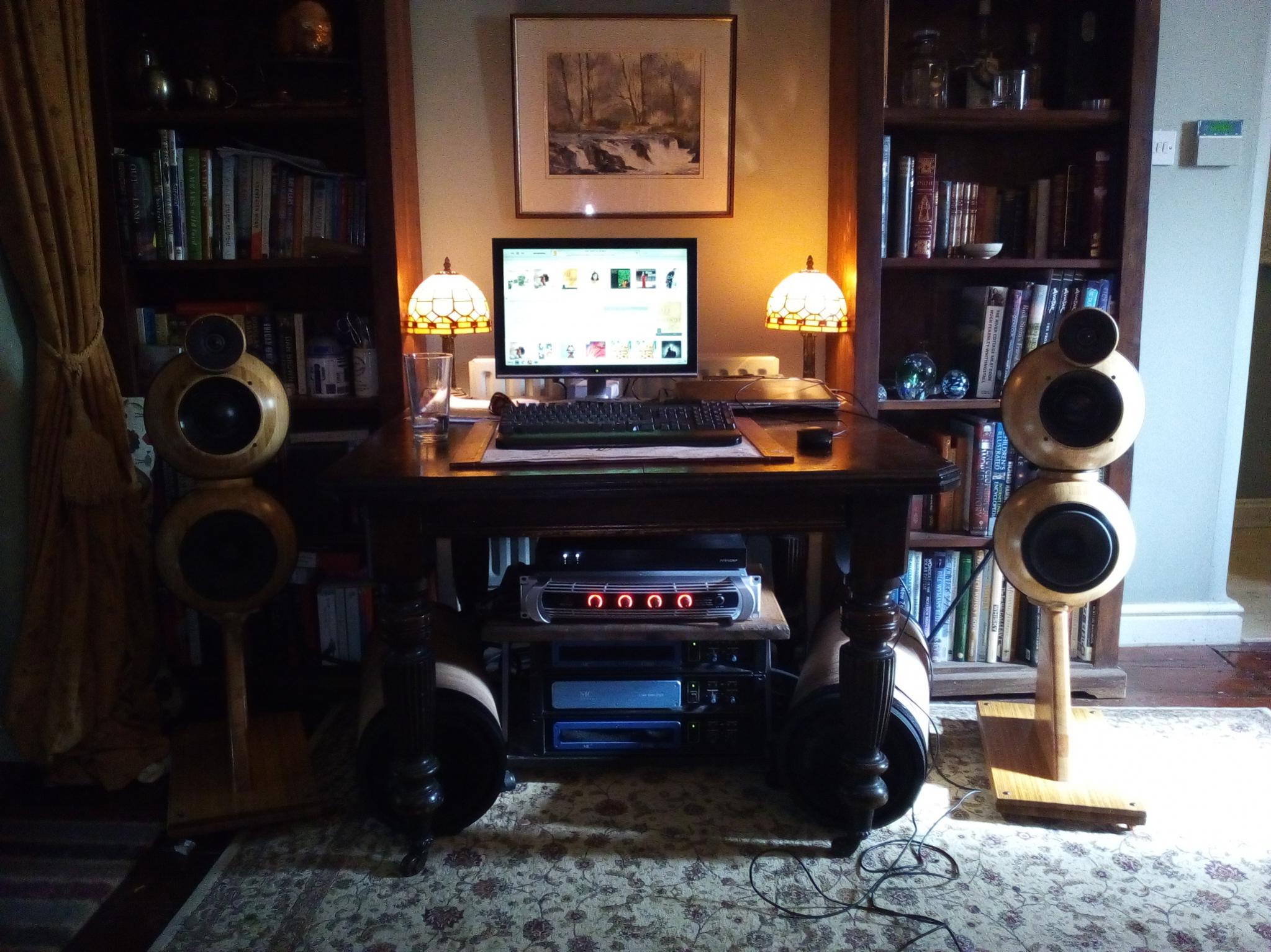

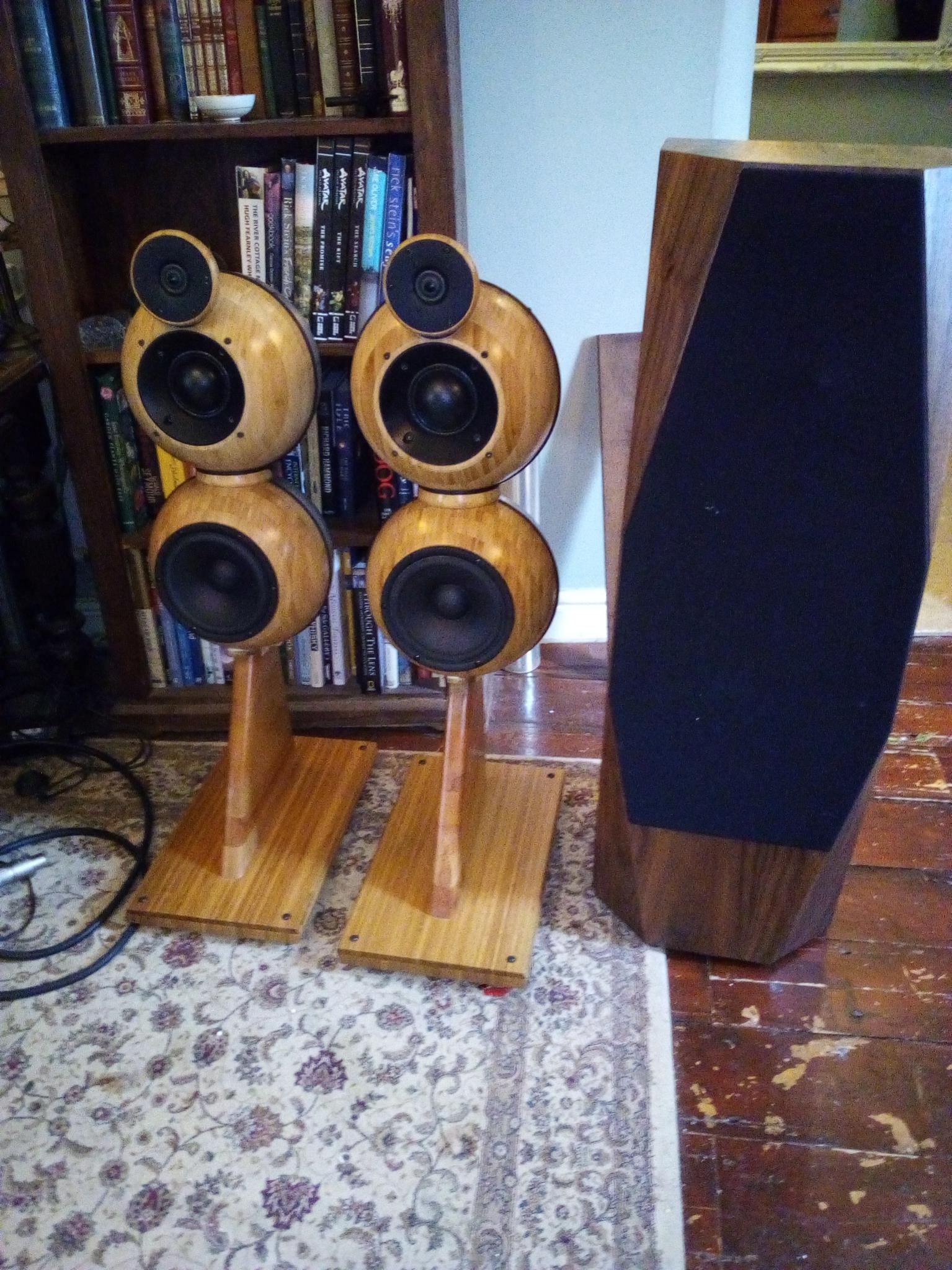

Well. Very roughly dialled in with some basic eq and LR4 crossovers... So pleased. Turned up to crazy levels, enclosures are vibration free (probably helped using spheres and that all freq below 80 hz are dealt with by subs).
The subs are scary. Really scary. It is bizarre to see and feel the SWRs moving in and out by an inch and then put a hand on the tube and feel nothing. Weird. Their output is also insane, the ceiling started vibrating when listening to the intro to 'money for nothing'.
Can't wait to start getting proper measurements to dial them in really well.
Imaging so far is easily as good as the synergies. This anti-diffraction malarkey clearly has merit. Overall, so far overjoyed. 😀😀😀

Do the subs just sit on the floor? Somehow I was expecting to see bamboo risers and sorbothane 🙂

Currently they are just on rubber feet. I was planning exactly what you suggested, but there is no vibration off them at all, so no need for sorbothane! I may also ultimately have them standing upright in the corners of the music room when it is finally done, so I haven't yet decided on their arrangement.

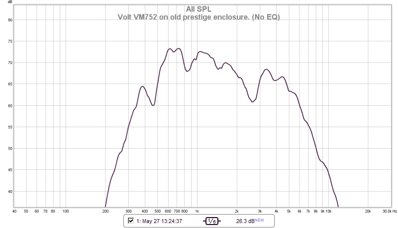

OK, so finally got some decent measurements done...

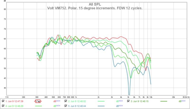

I am shocked by the effect placing both the tweeter and particularly the Volt VM752 into minimally diffracting spherical enclosures has had upon the polar responses.
The Volt particularly was always a nightmare to manage, with a fairly uneven frequency response and a really nasty dip around 2500hz, which you could EQ on axis, but would of course then have an off axis issue.
Check out these polars - particularly the volt dome, the polar response has been transformed!

Was the tensioning of the force cancelling rods critical? Apart from ensuring that all the tensions is the same, how do you dial in the tension?The subs are scary. Really scary. It is bizarre to see and feel the SWRs moving in and out by an inch and then put a hand on the tube and feel nothing.
Not very scientifically. I just used the same torque setting on my electric drill! Nice and tight. 😱
