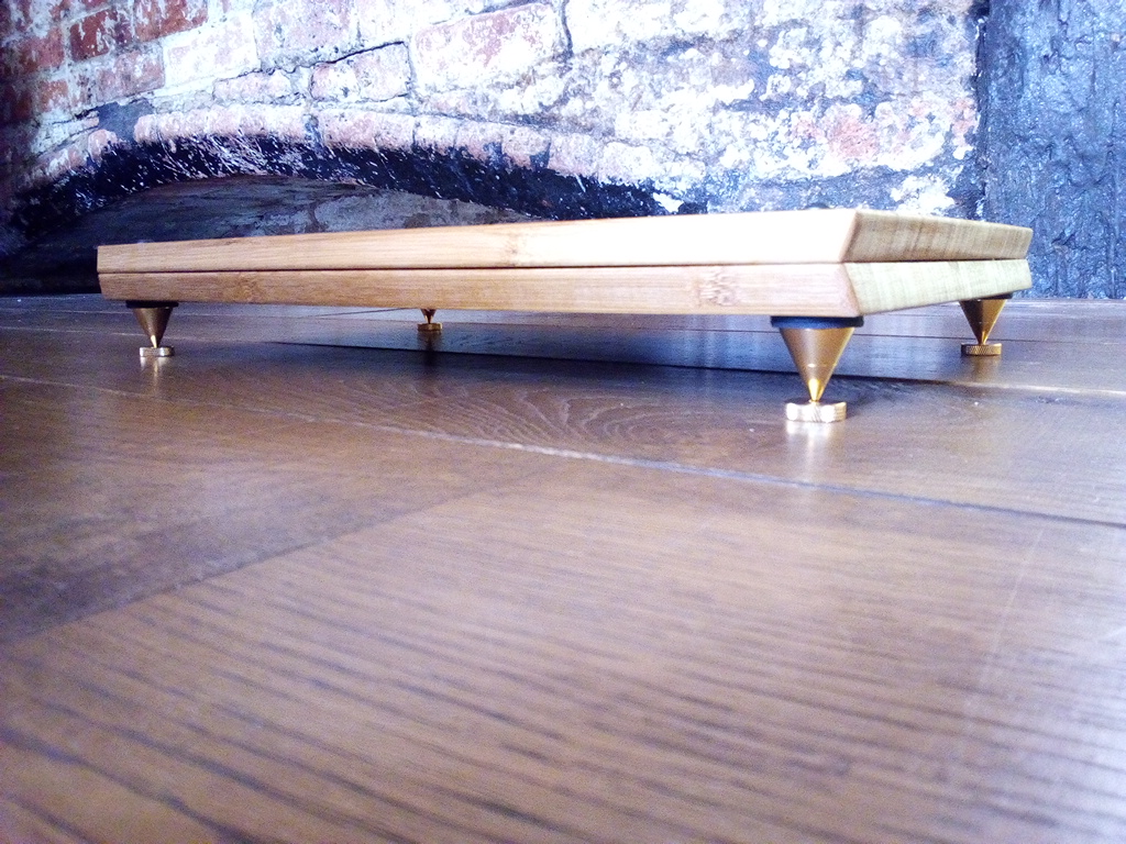

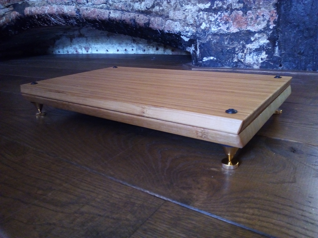

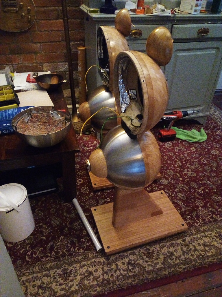

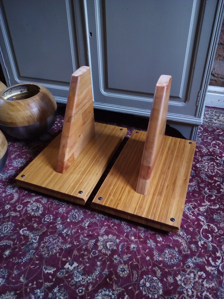

Further progress. Bases sanded back, treated to a few coats of finishing oil. Cones and buttons bolted on with sorbothane washers.

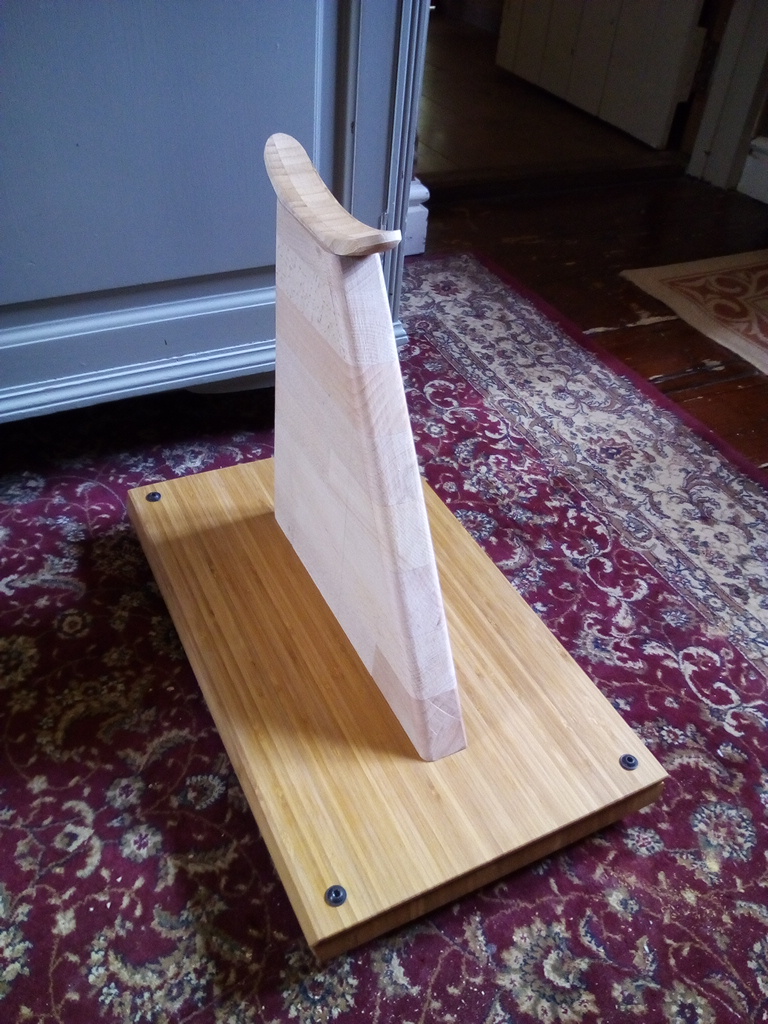

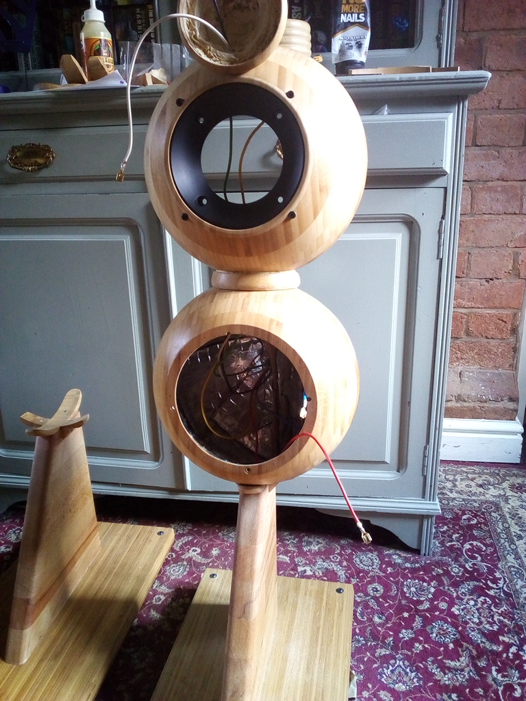

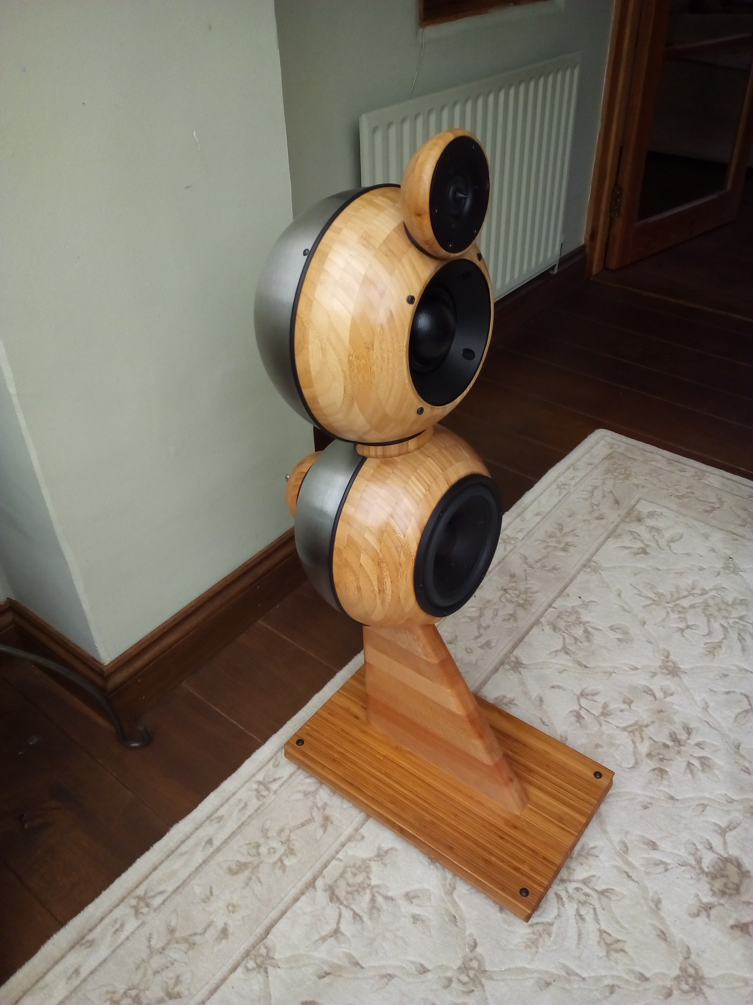

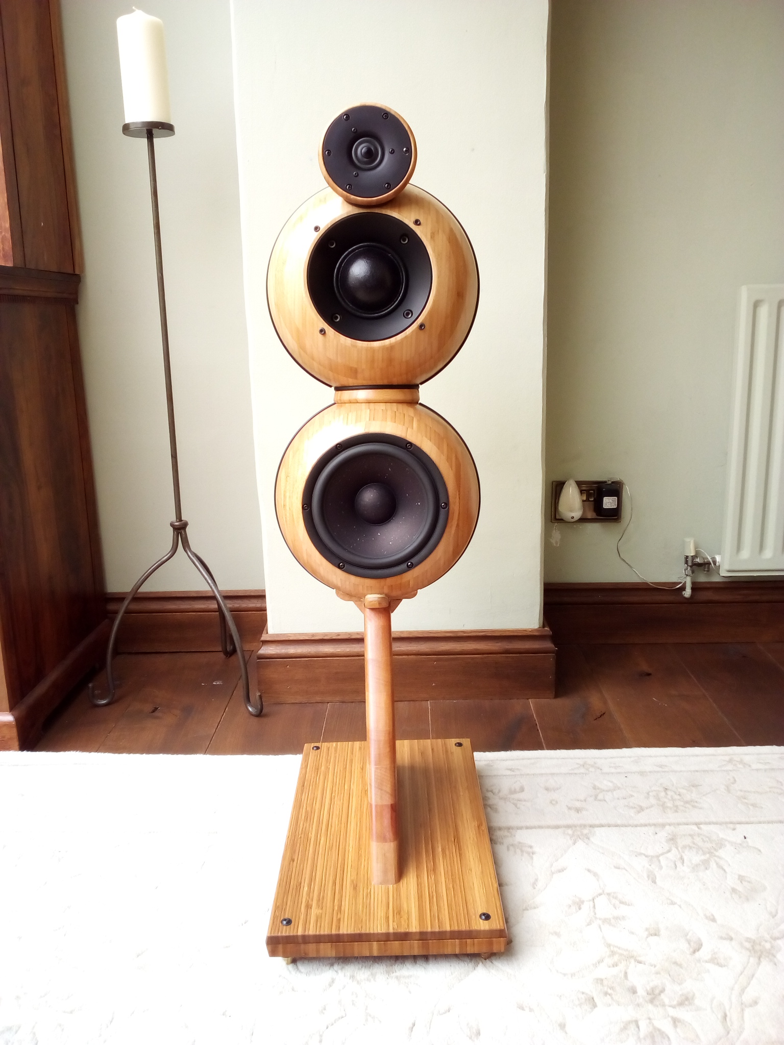

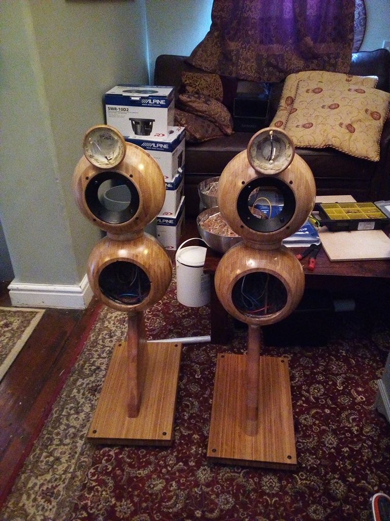

Stands built up. Tweeter housings fitted and filled with two part epoxy to reduce resonances.
Trial fit on stands.....

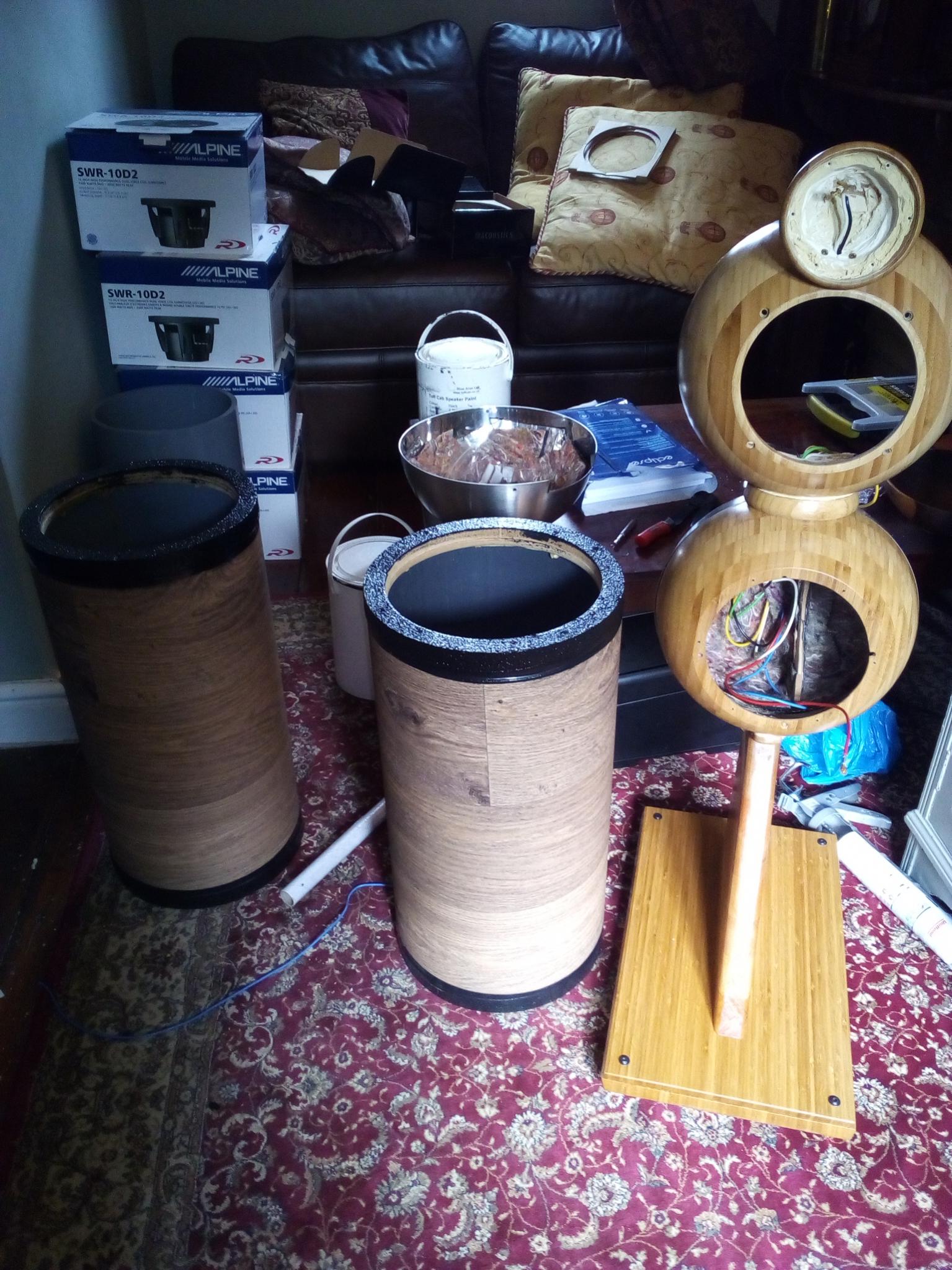

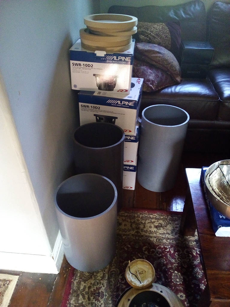

Pipe finally arrived! Soon subs will start being built too.....

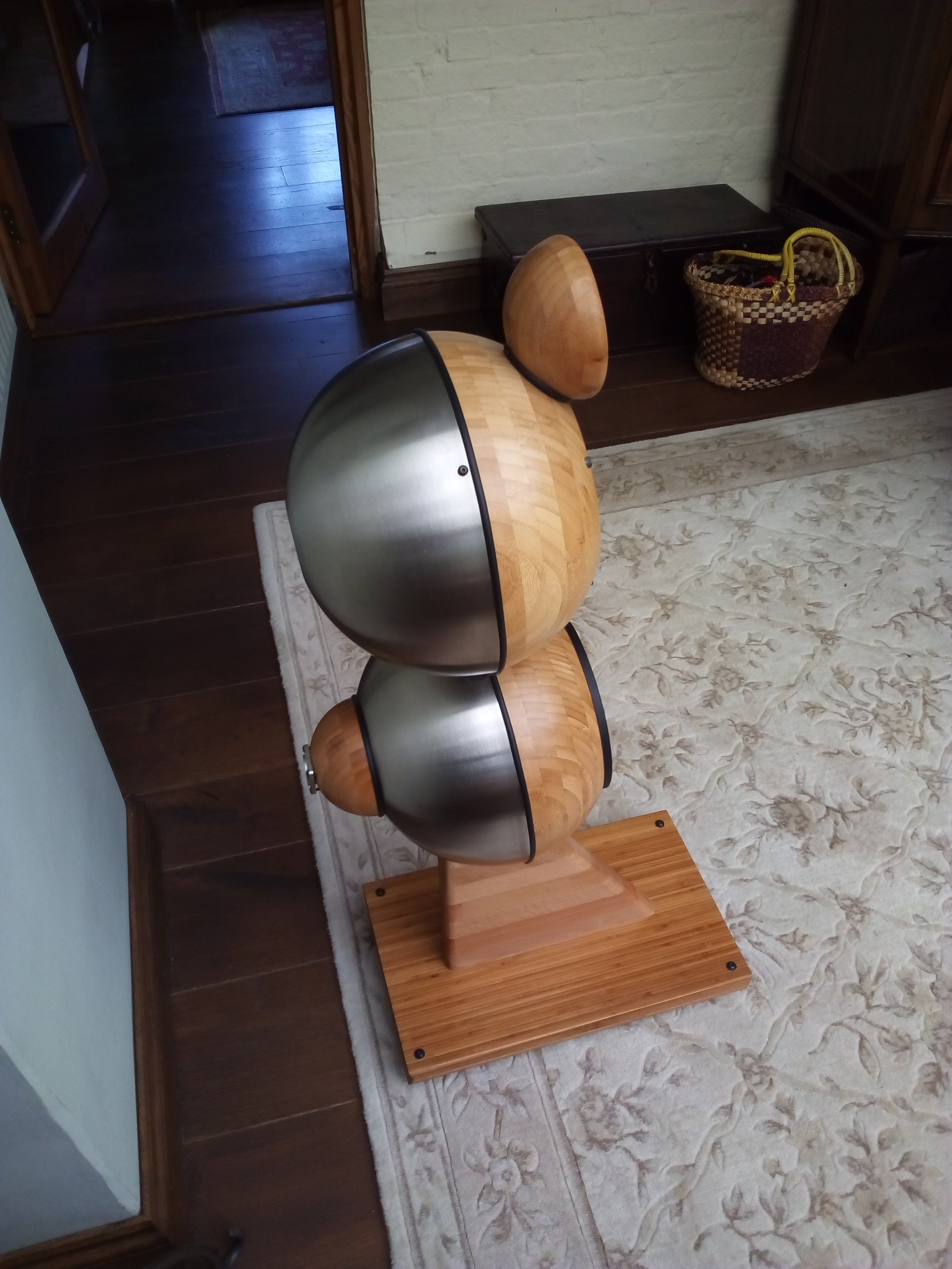

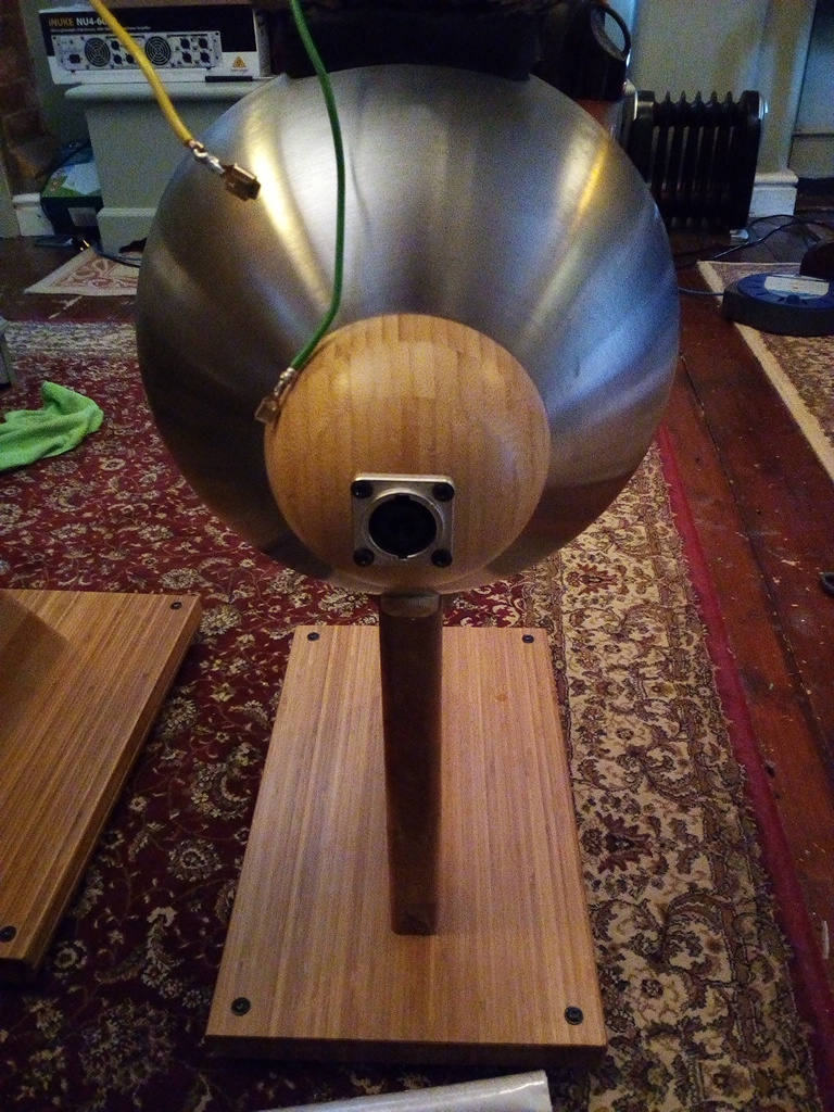

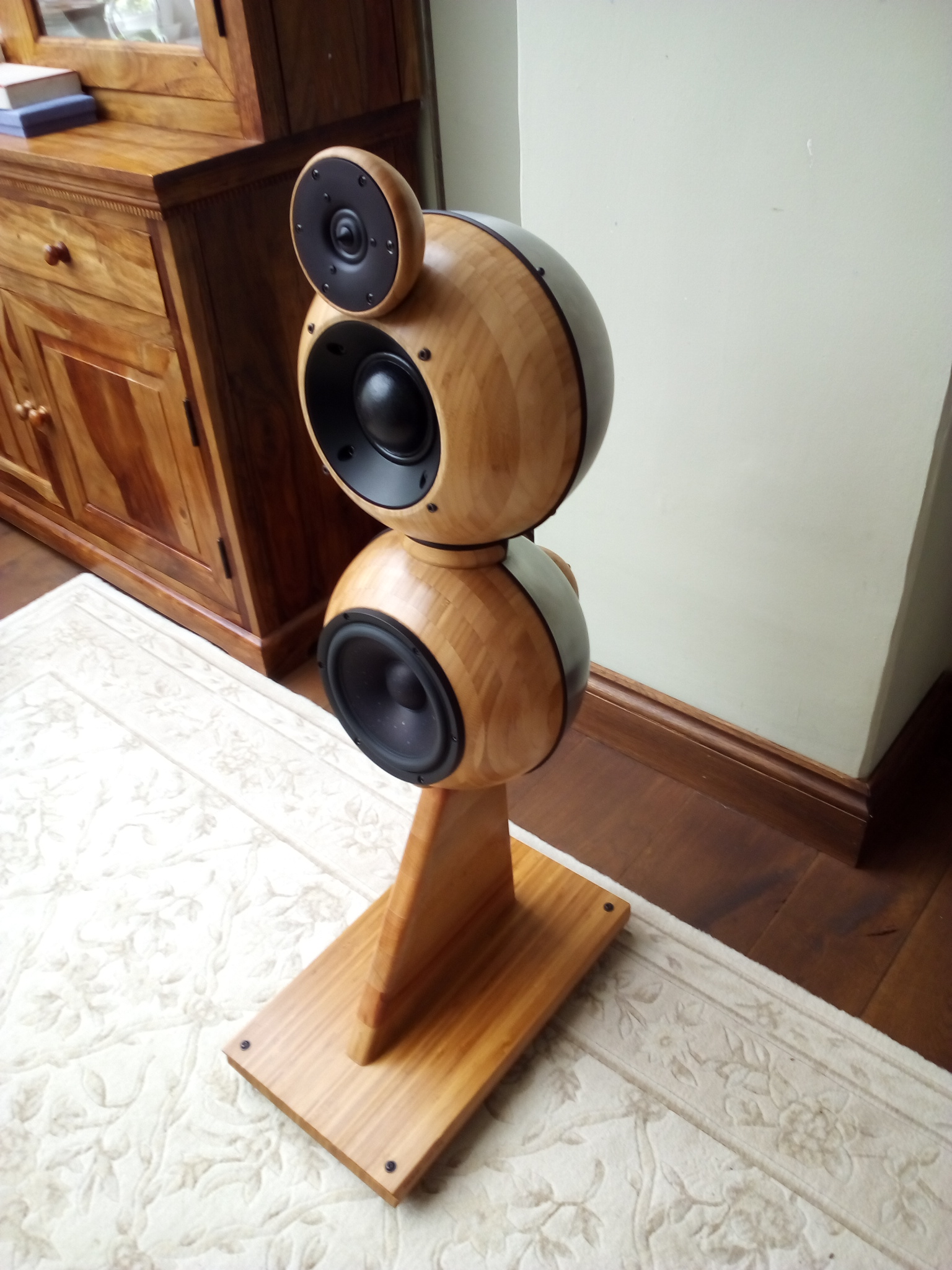

Further progress. A bit gloss perhaps so I may knock it back to a satin finish with some fine wire wool.
Using speakons for connection to keep it neat.

awesome!
Looking good 🙂
Cheers guys - this has been the most complex and difficult speaker build I have ever done. At many points I kept wishing it was BB ply box!
fantastic build. Cant wait to see some measurements and your listening impression.
Would a ring of black felt around the tweeter face plate edge help with any distractions?
Thanks!fantastic build. Cant wait to see some measurements and your listening impression.
I have already measured the tweeter in situ and the 1/2 inch round over and hemisphere actually measures better than it did on the previous baffle on and off axis. Probably partly because the ring radiator has a fairly narrow dispersion anyway. But I was surprised how good it was. See a few posts back for wesayso's experience of rounded tweeter enclosures.
I've used black felt on baffles in the past and have some in a drawer, so if needed I can add it later - good idea! Will wait for final measurements.
Subwoofer tubes are getting close too. They are fairly imposing, but should fill in from 80hz down nicely! 😀
