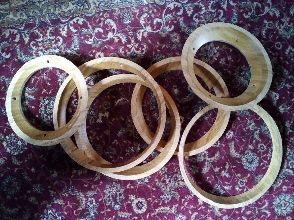

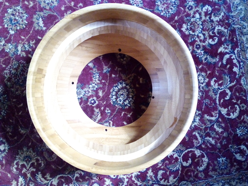

Bracing. Not so easy with spheres. Of course they are already very strong, but I am a belt and braces man so I wanted to brace them well.
So I bought four extra bamboo bowls, cut them into rings and hey presto perfect bracing!
I am gluing them in under pressure with the grain running in the opposite direction to maximise strength and rigidity.

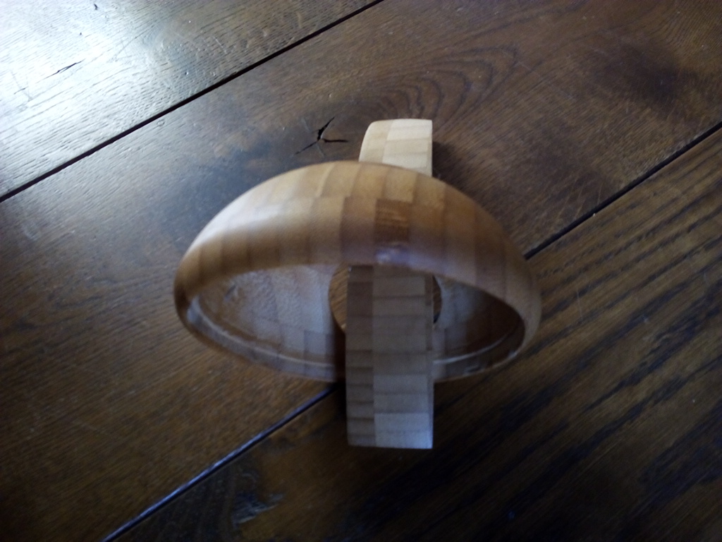

Thanks for the suggestion. I thought about it, but think it will make the whole speaker quite a bit bulkier and I am keen to keep it as close to the two spheres as possible.
With this in mind what do people think looks better? The ring connector or the x shape connector?

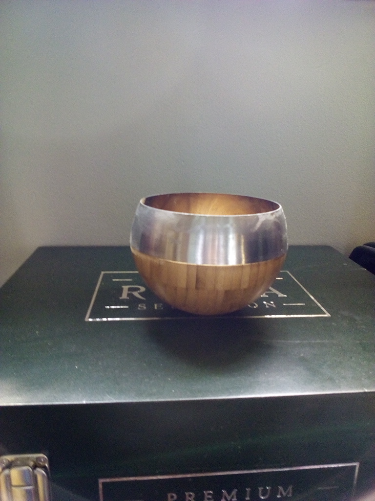

Your enclosure to control the diffraction effects on the tweeter is about the worst possible choice. It effectively will be seen by the tweeter as a cylinder with tweeter mounted in the circular face. This was demonstrated in the fundamental results of Harry Olson, Figs 2c, 18 ofThe Scanspeak 7000 tweeter is then mounted into a small bamboo bowl to allow a decent round-over and attempt to minimise diffraction.
http://www.aes.org/aeshc/pdf/how.the.aes.began/olson_direct-radiator-loudspeaker-enclosures.pdf
The round-over radius needs to be much larger at higher frequencies. Actually the original Wilmslow design shows a good understanding of effective diffraction control at treble frequencies, as it approximates one of the best shapes of the Olson studies (Fig 17).
The shape of the enclosure becomes relatively unimportant for diffraction at low frequencies, so there is no real advantage for a sphere at bass frequencies. On the other hand the sphere does have an advantage for force cancelling opposed drivers at sub-woofer frequencies. This requires a rigid sphere though, as B&W use.
Another issue is that the mid and bass enclosures will also cause diffraction effects to the treble. The whole enclosure has to be designed to control the diffraction effects which are more pronounced at higher frequencies.
Thanks for your observations Bon. I am of course well aware of them. I was also concerned about having the tweeter centrally mounted in what is essentially a circular baffle, therefore I routed a 1/2 inch roundover into it.
Intended crossover is 3500hz so this may be enough, if not, I have another enclosure made up from a larger bowl with an even greater radius. Measurements will be done before settling on one.
The mid-dome enclosure will obviously go up to 3500hz so the spherical shape is very useful. You are correct -they will interact like all enclosures and baffle shapes do, but in my experience the spherical enclosure has the least audible affect I find sharp edges 'give themselves away'.
The bass enclosure does not need to be spherical for diffraction reasons (wavelengths are too long) but also in my personal experience, you cannot achieve the complete inertness of a sphere with a flat sided box type enclosure. There are no corners, no edges and only a single surface so vibrational modes are not propagated/encouraged. This is the main reason (besides aesthetic) to make it spherical too.
So spheres it is for all three separate enclosures for different reasons. I have made many speakers over the years and even my very heavily braced birch plywood, cld baffled, ones have not been as completely devoid of vibration as my spherical ones.
So I think reasonable arguments to have a go with spheres being mindful that measurements will be the final judge, but the nice thing is that I still have the original enclosures so if it all goes wrong, I can simply revert back!

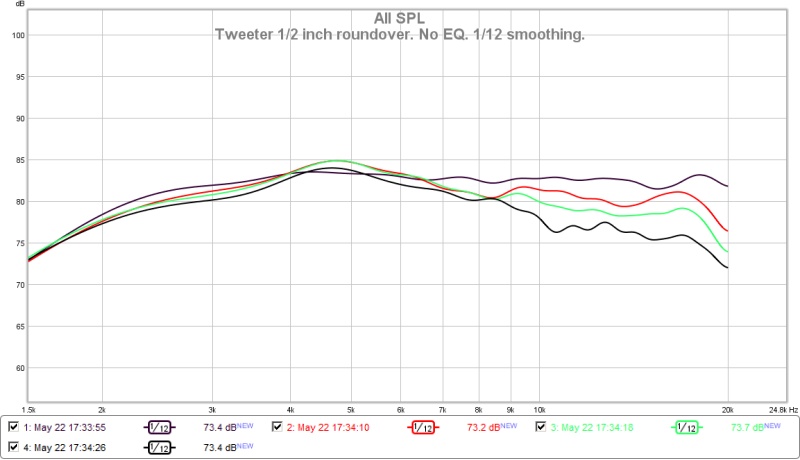

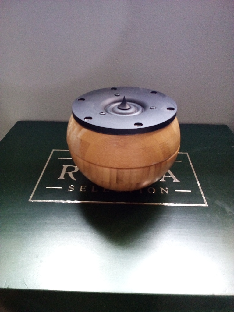

Bon's comments got me thinking before I make a second tweeter enclosure like the first, and given I have three different prototypes at present, I should take some measurements.
Initial measurements of the tweeter in the above enclosure with a 1/2 inch round-over transitioning into a larger radius hemisphere are better than I hoped, and I think I will be able to get away without having to use one of the larger, less 'aesthetically pleasing' bowls.
However these measurements are taken with the tweeter enclosure supported on cushions, so isn't completely accurate as it needs to be measured whilst mounted on the mid-dome sphere of course.
I am still hopeful that they will remain fairly good though. I will mock them up on the mid-dome spheres with some double sided tape when I get a moment.

Some of the various tweeter enclosure prototypes more in the garage!
The metal one was a nightmare to cut so I decided it was a no go. The other one would behave more like a cylinder with the sharp edge of the tweeter faceplate being exposed - I believe this is more the kind of situation Bon was referring to - a sharp defracting edge at a consistent distance from the point source.
Of course diffraction is an interesting thing - it has to happen - edge treatments, enclosure shape and baffle geometry only determine how the diffraction transition occurs - which is why a sphere smooths it out to look like a baffle step transition (at long enough wavelengths all enclosures approximate a sphere!), whilst a sharp edge puts the diffraction ripple into a concentrated region and is therefore of higher amplitude.

The ring is much cleaner.With this in mind what do people think looks better? The ring connector or the x shape connector?
Are those tweeter measurements in 15-degree steps?
Probably more like 10 degrees - but very 'Ish'!
It is a quick and dirty measurement after getting myself worried that the diffraction would be as hideous as a cylinder. Fortunately it is actually better than on the Prestige cabinet.
Interestingly it appears to beam less as well - but this really needs to be confirmed with properly controlled measurements. I guess it makes sense as I have almost removed the baffle entirely.
It will be interesting to see if sitting the 'pod' on the larger sphere will wreak the measurements....I think not, but we will see.

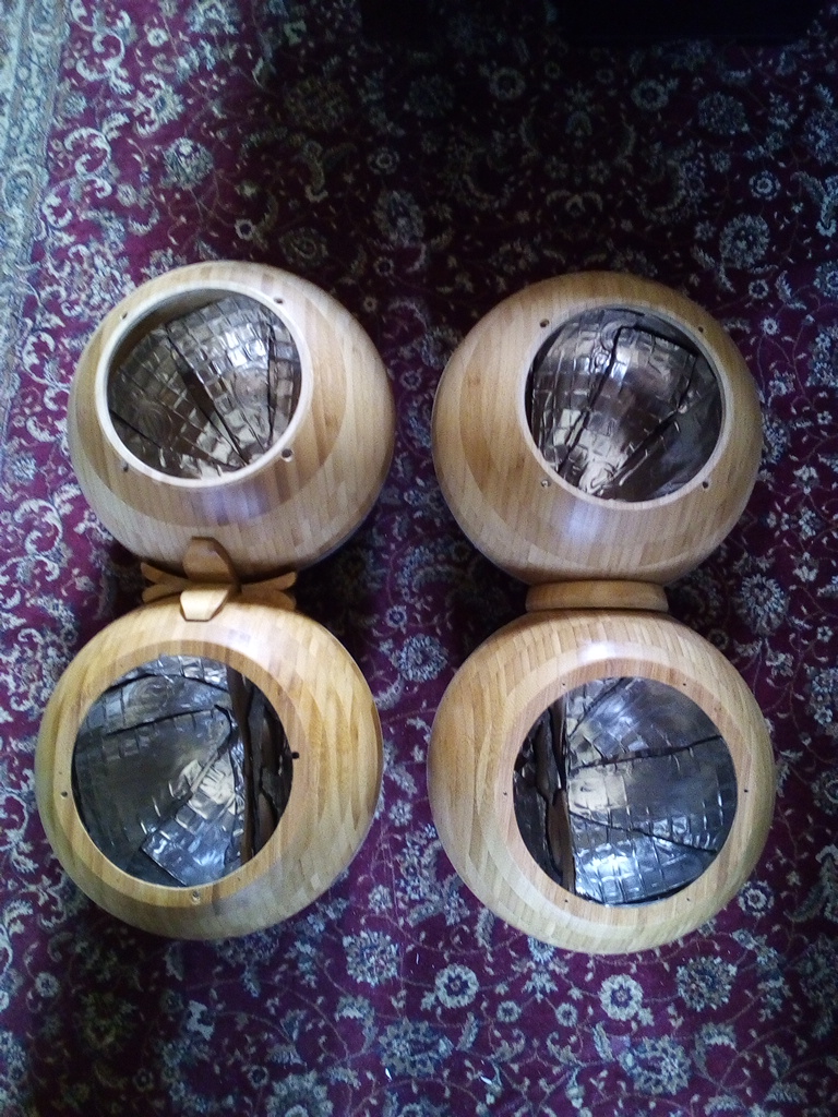

Here's a mock up with the drivers sat in their spheres.
They are looking great!

I have no experience of the IKEA bamboo bowls but a word of caution. I once considered using block jointed end-grain cutting board material for a turntable plinth. I even bought the large cutting boards which sat on a shelf in my workshop for at least a year. When I finally pulled them down to use, I found the glue joints had parted and even the end-grain split in numerous places. They ended up in the bin. You might investigate the durability of the jointed bamboo due to drying out. I know from experience that the strand woven bamboo floorboard material is very durable but hard on cutting blades, but I suspect that the IKEA spheres are quite different, principally because they are food grade products and cannot risk using toxic glues or resins. It would be a shame if your bamboo bowls started to come apart down the track, especially since they will be subject to constant vibration. I hope you don't consider I'm being negative for it's own sake. Just pointing out some pitfalls (you might have already spotted).😀
