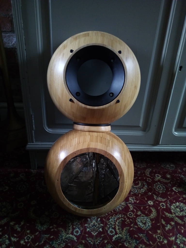

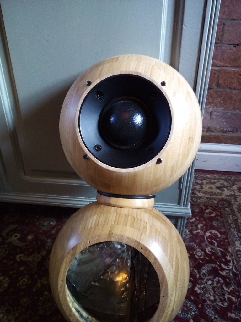

The bowls are very stable - as you note they are designed for food and IKEA have been making that model for years. I built some full range driver kitchen speakers using two of them per sphere about 7 years ago and they still look great - and this was with no reinforcements or bracing rings.
Your point about vibrations is true and something I did consider, and this is why I am using PVC pipe rather than them for the subwoofers.
I have massively reinforced the fronts of these spheres using both bracing rings and structural epoxy, mainly because the vm752 dome weighs 9kg! So they need to take some serious weight.

Well I hope so! I am still concerned there will be a lot of weight through the lower sphere with the volt dome above, and it will mainly be in the front half so I am worried about the join between the two.....

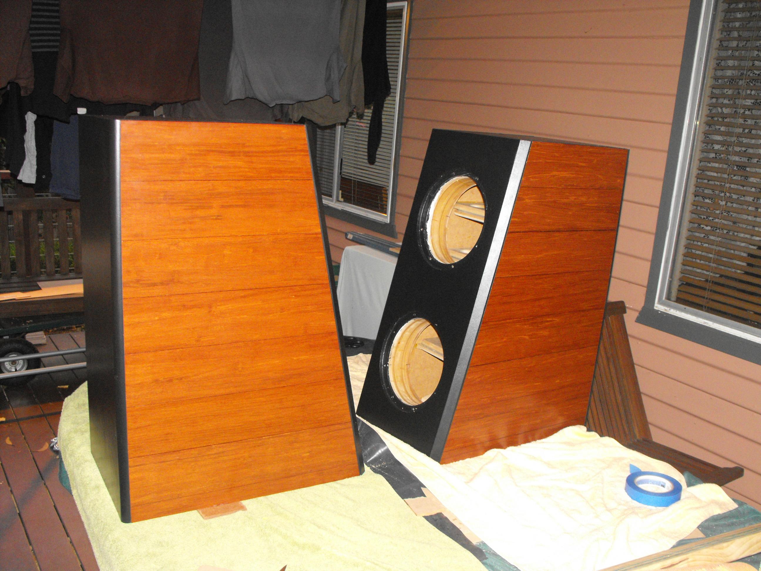

I have used strand woven bamboo as a cladding for mdf speaker carcasses.![]()
Wow Bon! beautiful speakers!

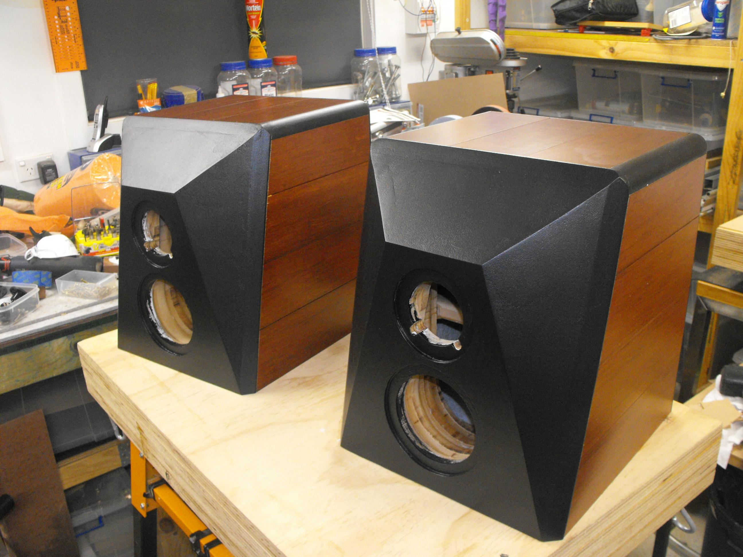

I see you have gone to great lengths to reduce cabinet vibrations too - that has to be the thickest baffle I have ever seen!
Just looking at those pictures though, I would be a little worried about cavity resonances - the incredibly thick baffle looks to result in a 4" 'tube' before opening out into the main cavity - did you route back the 'tunnel' before installing the mid driver?
I am always quite paranoid about cavity resonances in my baffle cut outs as I once had a problem with a very thick baffle that I couldn't pin down until I chamfered back the mid-driver cut out.
Hi, I'm using an Inuke 3000 bridged for my 8ohm sub but I thought the 6000 was actually 2 bridged 3000's and had no provision for bridging? You should get around 2x 1200 watts out of it at 8 ohms. 2x 2000 at 4 ohms.
Hi the NU4-6000 is a slightly different beasty to the NU6000 I believe.
You are correct that the NU-6000 is 2 bridged 3000's and thus is not designed to handle 2 ohms but the NU4-6000 is a 4-channel amp, essentially 2 x NU-3000 in a single case.Hi, I'm using an Inuke 3000 bridged for my 8ohm sub but I thought the 6000 was actually 2 bridged 3000's and had no provision for bridging? You should get around 2x 1200 watts out of it at 8 ohms. 2x 2000 at 4 ohms.
Each channel is the same as in the NU-3000 and can handle down to 2 ohms. Moreover the channels can be bridged in pairs for higher 2 channel power but only down to 4 ohms. As Bushmeister suggests, running the 4 channels unbridged to each of the 4 woofers, maintains a superior damping factor and control of the woofers. In this mode the NU4-6000 can deliver 300 wrms into each of the 8 ohms or 600 wrms into each of 4 ohms. That is 2.4 kW rms total. I have confirmed these figures into my dummy loads but they got very hot, so it was only briefly tested at this level. The fans speed up with hard drive.
I try to live up to my signature line. The total wall thickness is 45mm approx.
I roundover the inner cut-out with the largest roundover router bit I own. No problems so far with uneven frequency response. I don't wish to hijack your interesting thread, so I won't comment further on my build here.Just looking at those pictures though, I would be a little worried about cavity resonances - the incredibly thick baffle looks to result in a 4" 'tube' before opening out into the main cavity - did you route back the 'tunnel' before installing the mid driver?

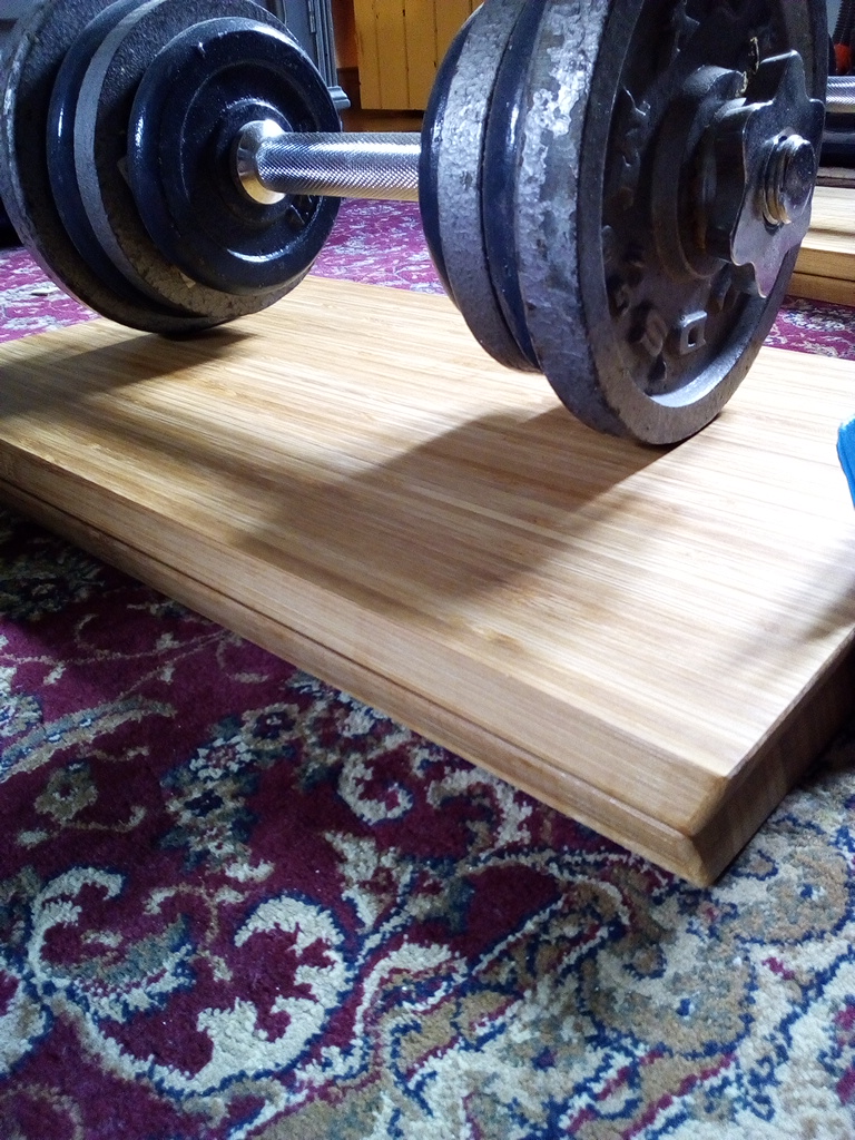

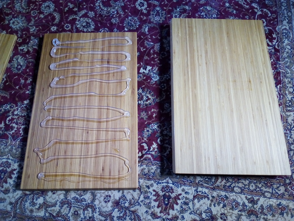

Right. Having come up with a joint between the spheres I am happy with, it is time to think about stands...
To this end 4 bamboo matching IKEA chopping boards. Mounted in mirror image (providing interesting bevelled edges) to give a 4cm thick fairly heavy base. Flexible adhesive between them also provides an element of cld, for what it is worth.

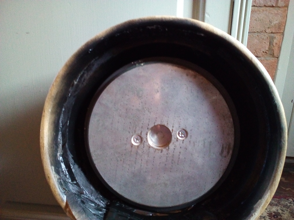

I found some pics of the rear baffle relief of the mid-cut out.that has to be the thickest baffle I have ever seen!
Did you route back the 'tunnel' before installing the mid driver?
Ah that looks much better! Was clearly the angle of the photo!
So I have now joined the second speaker. Structural epoxy bolts etc, by wrapping the magnet of the vm752 in cling film, installing it, then packing structural epoxy around the edge of the magnet at the bottom I have created a snug shelf to allow the weight of the driver to be transmitted to the reinforcements. In case you think I am being paranoid about all this, check out the size of the 9kg mid range dome....there isn't much room left!
