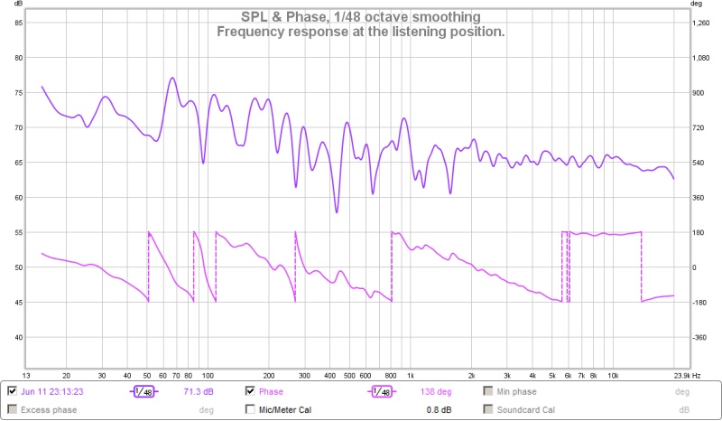

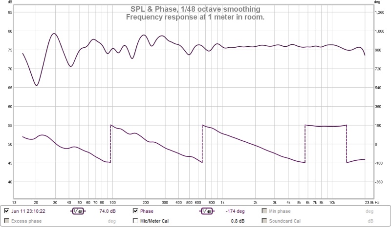

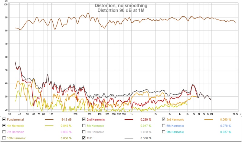

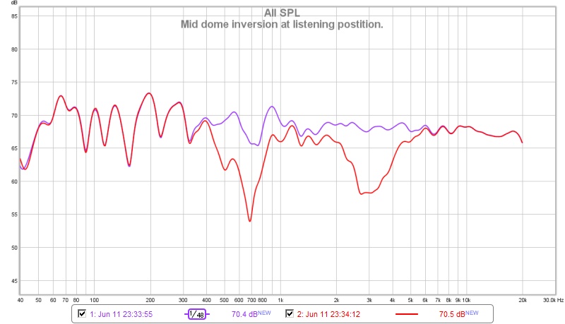

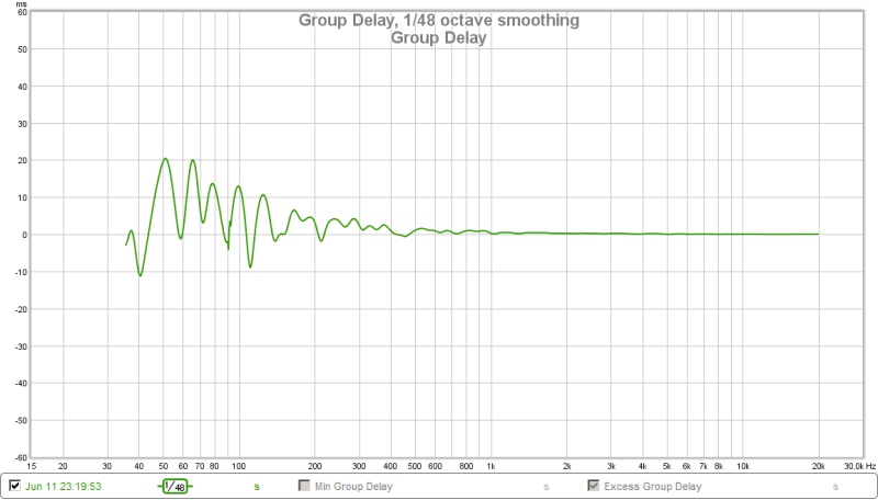

Here are some obligatory measurements just to give an idea of my initial crossover working. Currently all LR4 slopes.
