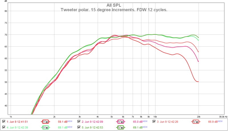

OK, so finally got some decent measurements done...
I am shocked by the effect placing both the tweeter and particularly the Volt VM752 into minimally diffracting spherical enclosures has had upon the polar responses.
The Volt particularly was always a nightmare to manage, with a fairly uneven frequency response and a really nasty dip around 2500hz, which you could EQ on axis, but would of course then have an off axis issue.
Check out these polars - particularly the volt dome, the polar response has been transformed!
