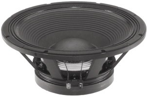

Speakers for ported boxes have signifigantly lower Qts than those designed for closed box use. A Qts below 0.38 is low and those above this figure is high. This indicates a large box for speakers with high Qts. If a small box is used then then the speaker should have high Qts with high damping. That's a bit tricky for the average constructor to get right.
The box size also depends on Vas of the driver parameters.
Eminence do several versions of 15 inchers with wild specs.
The Hi Per 427 Qts of 0,38 gets used alot here in power cabinets. The standard 427 has a Qts of 0,87. That is specifically intended for a car boot with piles of Cu volume.

Hi mikee12345........that 15 incher
With Qts of 0.32 and Vas of 4.52, that should make an excellent reflex enclosure of B4 alignment with no peaks or dips,i.e 0dB flat.
My cals show fb=29Hz; f3=32Hz. Box size = 2.6Cuft.
This is for reflex.........for dynamite peformance use port size min 5" dia or space permitting 6 inch. The length of the port shouldn't be more than 2x port width and not extend more than half the depth of the box. A large port on the front should be some distance from the driver to avoid any upper frequency sound reflection through the port.
A larger box will lower system Qts; result in poorer bass and lower power handling.
A smaller box will raise the Q, and up goes the other freq parameters and will probably boom. Not worth the hassle...
....... a typ stage speaker.
Using this type frame in a closed box isn't on.
Hope this helps
rich

hi Nielsio....... I'm working on the other ones. You won't get far on the quality and performance by just putting any loudspeaker unit to a box without knowing the characteristics. Some are designed specifically for closed box and others for reflex loading, and perhaps others. Trying to keep this simple,
Loudspeaker units for reflex loading have deliberately low Qts below 0.38 with also low Vas....if you shove a speaker unit with a low Qts into a closed box then for the fb and response to reach 0dB or slight + will result in a seriously restricted low frequency response. To get the design right, it requires Qts;Ls resonance fig and speaker compliance parameters to <fit> a particular unit to a box.
If one tries to fit a speaker specifically designed for closed box into a reflex loading box, it may not like it and may sound dreadful with very poor bass...overdamped...with a low Q. This implies large boxes for speakers with high Qts. Speakers for car boot have high Vas and high Qts, there is enough Cubic area to satisfy both parameters.
Fitting a high Qts speaker into a HiFi box will sound dreadful and have a very high uncontrolled Q. Controlling the Q isn't quite so easy....so much depends on surroundings and acoustics.
Have a look at this site: www.wilmslowaudio.com; may persuade you to head for a kit.....
I don't know what your application is.....looks like Hi Fi, ?Are you more interested in closed box apps ?
285GMF this one ain't too bad....B4 alignment at 5Cuft;
fb=47Hz;f3=47Hz. This unit would be good for a French Juke Box. Sound better than the JBL but look at the power handling!
There are better units for the deepest bass. The double impedance peak in a well tuned reflex will extend the response lower than fb. There are other problems and I can deal with them later.
The 135 is a midrange unit.
Try to select units; bass-mid-upper with equal reference sensitivities i.e SpL 90dB/m
rich

Vb =5 Cuft sized box; system Q = 0.55.......way too low....poor very thin bass and waste of speaker capability. f3 = 93Hz way way too high. (f3 = begin LF cutoff freq)
If I pump in Vb = 3 Cuft sized box, syst Q = 0.62 still too low. f3 = 88.6Hz.
If I pump in Vb = 2 Cuft sized box, syst Q = 0.72 (not for rock music). f3 = 87Hz.
(Cuft to litres x 28.27)
Classical music buffs like sys Q less than 1. The bass won’t be prominent.
For all round types of music; a sys Q of 1, and most modern speakers trend for somewhat boomy Q of 1.4. This last one is quite popular and will give prominent bass. A 2 cu ft cabinet is really too small for a 15 incher.
rich
I get the following figures:
rich
