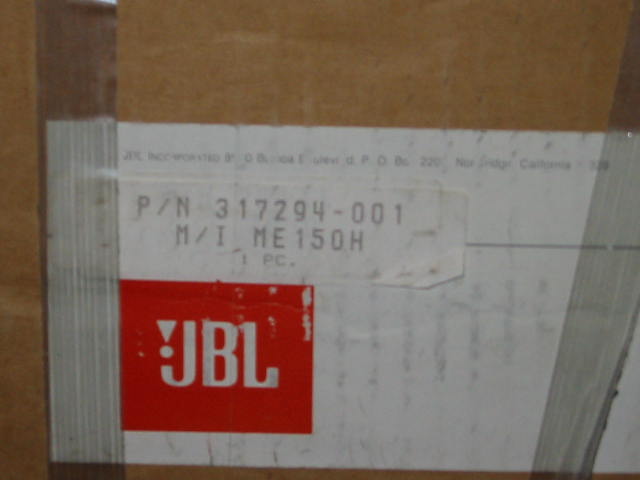

I can get some of these Woofers:
JBL 15" marked: ME150H
Anyone know about them?

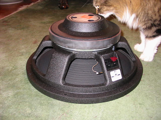

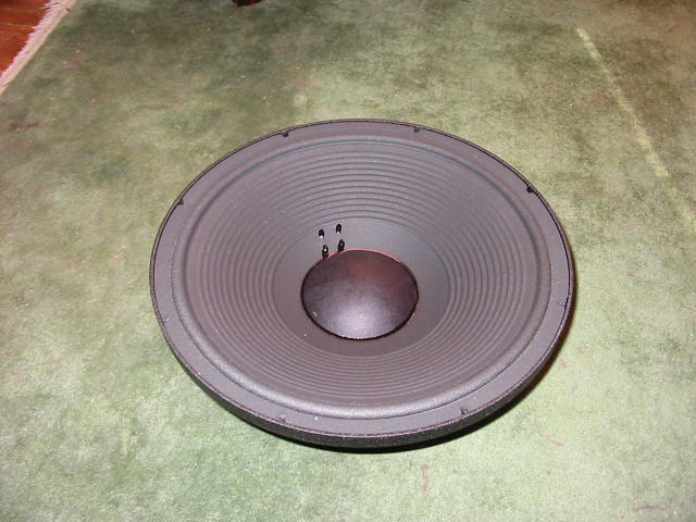

I got my 15" JBL's today. Here are some pics.
The carton they are in is addressed to the JBL consumer division which would jibe with the little info I have that they were for a $2500 home speaker (each or a pair? 😕 )
They are certainly built to pro PA standards!
Anyway they are new and are 8 ohm and the surround is a type of foam but I pressed on it and no cracks and it sprung back fine. The cone is coated with something (aquaplas?) but feels light. The frame is massive and has black crinkle paint. The magnet is massive and the whole thing weighs over 25 lbs.
I may be able to get more . The price would be around $125 each I think in quantity, plus shipping which is about $25 each I'll bet. If I decide to do this I'll post in the Trading post. E-mail if you would be interested.
