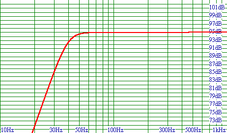

Here is a very interesting selection. The McCauley 6242.
Has Thiele-Small specs which appear tailor made for a 4 Ft³ box with an F3 of 40 Hz.
Made in Washington State. Not that much buzz around here, but ran into a band whose sound man refuses to use anything but McCauleys. Searches on the internet seem to indicate a speaker generally regarded as a cut above Eminence.
Price is a cut above Eminence as well. Internet Light and Sound has them for $279, Speaker city for $338. $279 is a little higher than your spec, but not terribly so.
http://www.internetsoundandlight.com/speakers.htm
But what specs. Here is the simulation for a McCauley 6242 in a 4 Ft³ box tuned to 39 Hz. Significantly more low end than the others.
