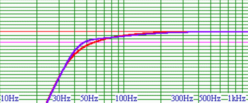

So, I tried adding weight to the cone in Win Isd and the response output mainly gets higher at Fs, but doesn't go lower. Now a 300 liter cabinet goes down plenty low, but that's one big cabinet.
What parameters need to be changed to lower the response in a reasonable sized box of say... 120 liters?
Then there's something wrong with either how you inputted it or the program (I know WINISD has some 'bugs' and don't trust it one whit) since adding mass lowers Fs/eff, raises Qts, increasing Vb/lowering Fb for a max flat alignment.
mass(m) = (22.428*dia^4(cm))/(Fs^2*Vas(liters))
m' = m + mass added
mass ratio(mr) = m'/m
Fs' = Fs/mr^0.5
Qes' = Qes*mr^0.5
Qms' = Qms*mr^0.5
then: Qts' = (Qes'*Qms')/(Qes'+Qms')
Vas is unchanged
n0' = 9.614*10^-10*Fs'^3*Vas(liters)/Qes'
SPLeff' = 112.02+10*Log(n0)
You can juggle numbers to get the desired Vb/response, but the easiest is to spec (in this case) Vas = Vb = 120L, Fs = Fb = 0.707*40Hz = 28.28Hz, Qts = 0.403.
The greater Vas is and/or the lower Qes is, the higher efficiency is.

And the difference between Kappa Pro LF and Magnum Pro LF Is??
Below is a WinISD simulation for both the eminence Kappa Pro 15LF and the Magnum Pro 15 HO. Each are in a 4 Ft³ box tuned to 40 Hz.
Differences?
Less than 1 dB difference at 50 Hz. And the difference goes down from there.
Kappa achieves symmetrical magnetic field with an extended pole piece. Magnum uses Faraday ring.
Kappa lists for $189. Parts Express should sell cheaper. Magnum more expensive.
Kappa Pro 15 LF in red.
Magnum Pro 15 HO in blue.
