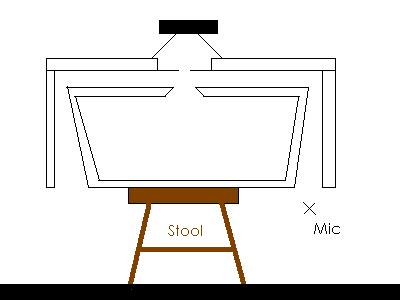

I just made the 10"version as stated in the 'holliman doc' that floats on the net.TwisterZ said:Can you list your design measurements, Resonator volume, port sizes, and X1 length.
Overall INSIDE width: 32cm
Resonator: Trapezium shaped, 70.9cm bottom, 78.1 cm. top, 27.6 cm sides.
Chamfered hole is 10cm diameter ON TOP (inside the resonator it's larger, due to the 45 deg. chamfer (I just cut it with a jigsaw set at 45 deg.)
Overall width: 88.1 cm
'Little hole in thin layer just underneat the speaker' is 50mm
'Height' between the baflle and the resonator: 30mm.
I did NOT put the 'standing wave inserts' in the resonator (yet?): I think the resonator is to small for any wave in it's bandwidth... They'll help for strength, though...
Ow, yes, I modified the driver a bit (In a rather nasty way 🙂 ) I glued some heavy nuts on it, to increase the Mms 😀
Here's a little drawing I just made to show how I measured: I placed the box as showed on a stool (45 cm. high) and put the mic in the spot 'X'...
More to come!
Paul

Is the 27.6cm for the side the length of the side board or the distance from the top to the bottom?

There are three links right at the beginning, one of them is for the doc with the full plans that Bibster used. It is the second link. Also included is a chart showing exact measurements of each piece used. It should answer all questions concerning his build.
By the way, what effect does the taper in port x1 have on your caculations, if any, or is it just the overall length that you are taking into consideration?

IMO the taper is to give the port a zero length like the body of a guitar or violin (See post #116 for the link). The calculation requires an adjustment for edge effect, Multiply port radius by 1.7 for the effective port length. Then add X1 length for the other end of the bandpass enhanced by the design.
