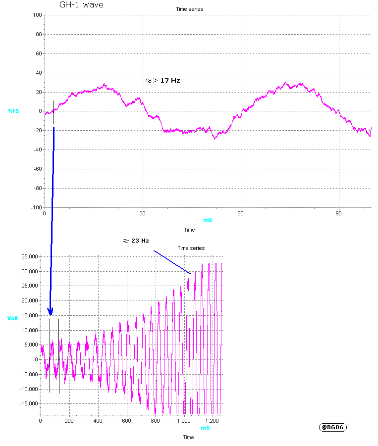

I haven’t seen the slightest suspicion of infra sound in the GH-1.wave sample given in post # 131.
I wouldn’t even call this a sample of a ‘good in the ballpark’ sub as the cut-off is just below 30 Hz where the signal is distorted and noisy.
Anyone with an oscilloscope or a spectrum analyzer can examine the signal content in GH-1 wave and is then not fooled by ear judging nonexistent infra sound that in the reality shows up as noise instead of real infra sound.
See attached picture 1 showing the most important signals from GH-1.wave.

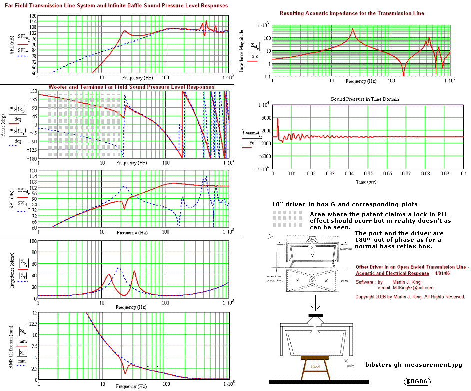

The conclusions I have drawn from the picture 3 or G/ is that for this cabinet no secure PLL like ‘lock- in’ will occur as a phase aligned result over the whole port bandwidth and extension into the infra region.
This ‘lock-in’ is not even securely mantained for infra signals when the load is equipped with just long enough tapered ports, X’, as the use of short widening tapered ports as in picture 3 is counteractive to a correct load for producing infrasound.
I think Holliman fiddled with the X’ tapering and noticed how fragile this pivot point was for the so-called ‘lock in’ action and extension to infrasounds.
Even small room attributes, like an open door could affect the operation he wanted to be maintained.
The acoustic phase for the X’ ports is simply normally lagging 180 degrees, velocity coupled or not with respect to the driver in the infra region.
Only port frequencies over about 22 Hz in picture 3 are in phase and augmented by the output from the Helmholtz volume thus when 0 degree phase difference exists.
This is also in line with what I found the GH-1.wav sample. Look at picture 3, the second plot, no infra signal whatsoever.
The only way to secure extension down to the infra region is to increase the length of X’ or by using the opposite counteractive length tapering, I also find is valid for this case.
This makes unfortunately the speaker not a reproducer anymore but rather a… producer… of sound as the initial perfect transient is later followed by a delayed low Q higher-level variant, this causes low frequency ‘ringing like a bell’ sounds for hundreds of mS if not tapered with widening ports as in picture 3.

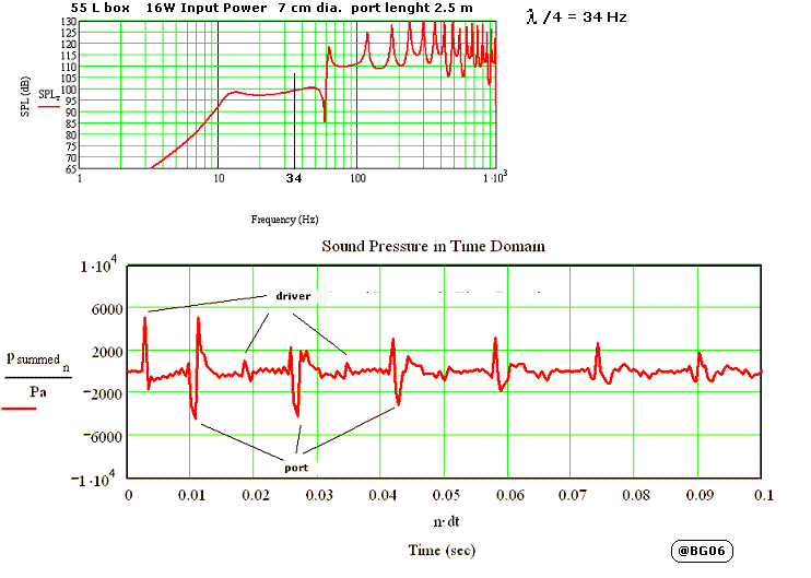

Otherwise this will be the case: picture 4, the transient response for my driver in a 55 L box but with one 100” straight port in a very similar box as in the Wilmslow paper.
I have 2 Holliman boxes to be examined in the pipeline, the first as picture 3 will probably be discarded due to the flaws I found but a new net 223 L sectioned box will hopefully be put together this weekend equipped with a old driver ‘Sinus 25WBA12,4BP8’.
