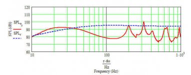

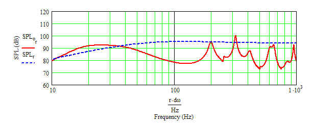

I've been playing a bit this weekend, and found out that the design is noisy. anything under say 22Hz, starts to become 'flop flop flop' as soon as I cranked up the volume.
This happens before the driver starts to 'give up' (Which happens rather soon!) it hits Xmax quite quickly I think, going kgr kgrrr kgrrr.
I've done some rahter failed measurements, which show a 'bandpass like' curve, say 20 to 100 approx.
I'm way to unexpecienced to what's causing this, I can hardy distinct the diffrent types of distortion involved.
When playing 'breathe' of the DSOTM, the heartbeat 'bangs' but I think i't has some (unwanted) 'tick tick' (Hi freq) sound over it. Could be the driver hitting something.. (Xmax? Boundary? wood? )
My wife said, when playing it (too) loud (compared to the mains) that it sounds 'desagreable' (unconfortable), but then she sais that anytime I play rather loud bass. Could be things rattling in the room..?
Anyhow, I suggest someone with a larger range of drivers at hand, builds the box (Go for the 15 inch, as in the patent) and continues my (our collective) research/testing/measuring.
I'm pretty sure it goes way low, but it could end up being some or other bandpass design after all...
A little disencouraged, but nevertheless happy about this experiment,
Regards, Paul
PS: Continue, so will I!!

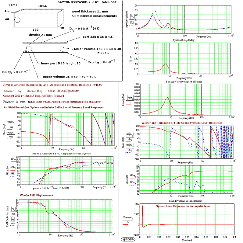

Look at the submitted picture where a 10” Dayton speaker driver http://www.partsexpress.com/pe/showdetl.cfm?&Partnumber=295-460 is modeled in a double bas reflex (BIB?) enclosure, capable in room SPL of more than 90 dB at 8 Hz and low ripple that any room will hide.
Not a Holiman but this less than 1 Litres total stroke-volume (2 x X-max x Sd) 10” based infra DBR driver covers 8 - 80 Hz and will work in any room because of the built in air velocity conversion. J
The size is quite large (427 L), but more than + 8dB is gained at 8 Hz compared to the corresponding IB type and the driver is within linear X-max with a low 16 W RMS input when producing 90 dB SPL at 8 Hz.
With typical + 9dB ‘room gain’ at 10 Hz an f-3dB at 6 Hz can be expected in most living rooms even if doors not are closed.

Bjorno's proposed dual reflex box: I love the range - 8 hz to 80 hz is incredible. I don't like the size so much, as this box is larger than the largest Holliman box and it would take 4 or 5 of them to get as loud as GM's bandpass
GM's bandpass: size vs output ratio is much better than Bjorno's box but frequency range is limited. The bandpass will get a lot louder, but that's because it's a much more capable driver in terms of displacement.
Ascendant Alliance ported: I did some WinISD sims with the Ascendant replacement for the Avalance 18, the Alliance 18 HT sub (although this model seems to be discontinued at this time as well). It had a 14 hz fs and sold for about $400 I think. The WinISD -6db EBS ported box was large (about 45 cubic feet) and tuned to somewhere around 10 hz. I think I remember excursion limited output of about 110 db (maybe more) with a couple hundred watts. This sub would be down 6 db at 10 hz, compared to Bjorno's and GM's which are down at least 9 db at 10 hz.
I realize there are other infrabass options worth discussing. For example, the Ascendant Alliance driver (if you could get it) would probably outperform my WinISD ported models in either Bjorno's dual reflex or GM's bandpass (modified to suite driver, of course). It is the most capable driver I have seen to date for low tuning; flatter and lower than the Avalanche despite less Xmax. I am really interested to see what Ascendant replaces it with. This, or something like it, would be my driver of choice for infrabass applications. The box is going to have to be huge, no matter what type, but it puts out enough to make it worth it and the low fs ensures it will go lower, flatter than any of it's competition (that I know about, hopefully this will change).
I think these characteristics are important because at these low frequencies, the accumulated roll off of the system (source, active XO, amp, etc) will negate the bottom end boost you would expect to see from room gain. I don't want to be more than 6 db down at 10 hz, I'd rather have to eq down than try to eq the low end up.
The whole point of the Holliman experiment was to see what is possible with smaller sizes and cheaper components. 4 Daytons, or 1 Tumult, or 1 Alliance and a box to hold them are a considerable investment in terms of cost and space. An Alliance in a low tuned dual reflex would be the size of a closet. The Holliman 15 is the smallest of all the boxes discussed here. I'm still interested to see what it is actually capable of.

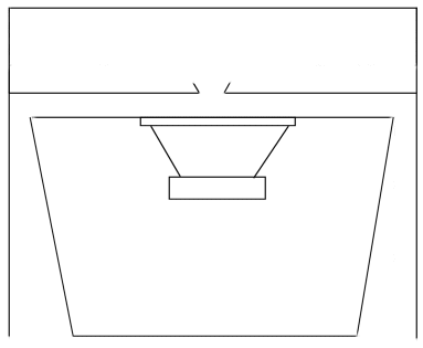

Has anyone considered placing the driver in the chamber to give it a sealed box? This would allow the placement of another box on the other side of the port which gave the Holliman effect to tune with. It could be sealed (as in the picture I have uploaded) or ported or near-free with a passive radiator.
EDIT
Alternatively passive radiators could be attached to the sides of the sealed chamber causing the port volumes to "flex" for a slightly "wider" tuning frequency, or to knock off peaks.
EDIT
Graham holliman
This appears to be worthy of a little expreimentation. From your drawing I'm assuming that you would build the enclosure and duplicate everything except the placement of the driver baffle and the chamber on top of the enclosure.
What would be the advantage of a ported or near free chamber? Wouldn't using a pair of PR's decease eficiency except at the pr's resonant frequency? something like a 18db rolloff at 6hz away from the pr's RF?
Of course if tuned properly, the resonant frequencies of the separate PR's could be spaced far enough apart to gain bandwidth. Though I do not know if the resonant frequency of the opposing chamber is the upmost factor in the tuning of a GH enclosure.
