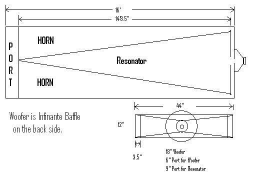

Yeah, I can't see what you attached either.
From the description, it sounds like you scaled it up for an 18 inch driver, correct? What kind?

Sorry about the Pic, not sure how to post it.
I did scale this up for an 18" woofer (Mach5 or FIaudio IB). This started with trying to get an IB to work in my room. The attic space is in the back of the room but I didn't want the outlet in the back of the room. When I read the forum I thought of the space between the ceiling and roof. My roof has 4x12's on 4 foot centers. With the horn and resonator in the ceiling the woofer backwave can be IB to attic and the port would be behind my screen in the front of the room.
If you want to email the picture to me I'll post it for you. I'd still like to see it, as you mentioned the ports taper to a point so I'd like to see what you are up to.
I'm still far from convinced that a driver with "normal" parameters is optimal. But since I really know next to nothing on the subject, I'm wondering if maybe you have previous experience with the design, or maybe just know somehow what type of driver will work. Or are you just guessing, like me?
By the way, if the Mach 5 driver works this could be an incredibly cheap project considering it's output frequencies.

Just a Guy,
The sheet 'as it is' takes some end-correction into account: a value of 0.8*diameter. This should be 0.732 according to someones link above. No really spectacular changes it makes, though... (I mean 0.8 or 0.732)
The problem with this box is that it's supposed to 'do its job' in a 'suitable' listening env. (Says the patent) e.g. a fairly well 'sealed' room (says the maker of the .doc that floats around)
Add the fact that we have (hardly) no idea what driver specs to search for.... And we find ourselfes back in trial'n'error land!!!
I don't quite have the means to make measurements, but I don't think the box does what is says it should do: Bang-bang between 5 and 25 Hz. It does go low, I think, though!
This could be the lack of 'suitable' listening env?
