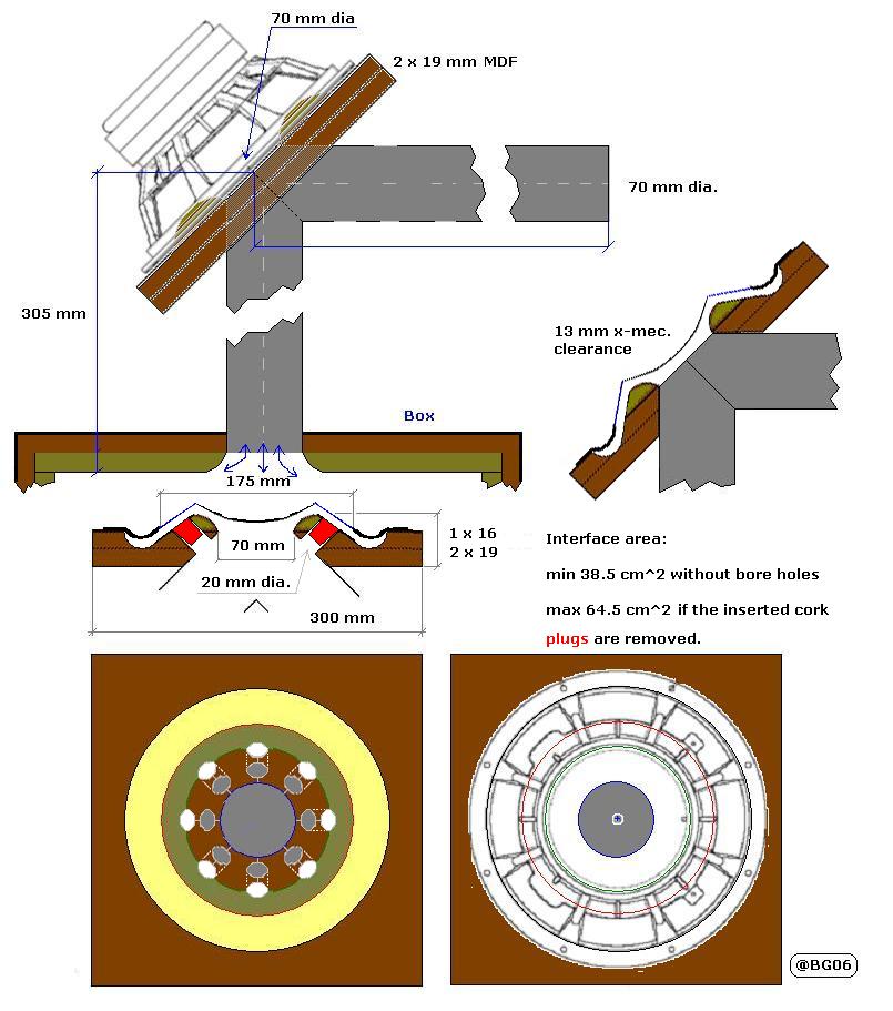

If you state it must be a 100L box for a 10” driver then a specific driver I don’t know the brand of and must be chosen for some for me unknown reasons.
Show me the data of the 10” rec. Holliman driver and a will tell you if there is any substance in your statement.
Of course my design is not a Holliman design it’s only my attempt to find out if the principle works like I do with many other designs I test for curiosity.
Show me a Holliman design with all information included as CSA’s and the specific driver in quest and I will consider building one and testing it in an acoustic laboratory I have access to.
moray james,
Please draw a picture, it would be very interesting to explore this more, and I have to admit that I have a problem to visualize the whole.
just a guy,
Quote;
‘But I would really
like to see a picture of your prototype model, in
particular, the part where the driver fires across
the beginning of the ports and into the resonant
chamber.’

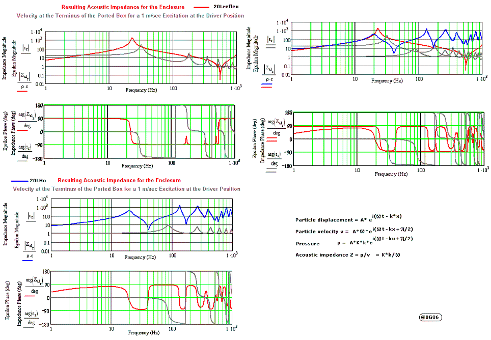

Submitting a picture 1(2) I forgot to post, comparing the 20 L reflex box to a 20 L Holliman internal acoustic impedances and particle velocities i.e. the pressure load on the driver I really think reveals a lot of the so-called ‘unique loading method’, and 2(2) a drawing I i.e. made for my personal use only.

Please show me a plan of approved Holliman, not those I can find here via DIY.com links where no secured performance data is submitted or shown with sloppy drawings but a drawing with all necessary data included preferably a box less than 100 L that will do fine in my home.
I really want to build one and to measure the performance.
Tell me why my box isn’t valid to verify the principle of Holliman.
I’ve spend some time reading and searching for documents that I hope beyond doubt give reliable information from someone who really have constructed a Holliman successfully, but found nothing.
I hoped to find documented measurements that would give me a fair chance to compare with, other than a lot of I think, un-quantified unsubstantiated hypothesises how this in principle should work, the patent papers included which claims that the efficiency is higher than for a Helmholtz type of speaker when actually the opposite is the true.
What performance should I expect to find (acoustic and electrical measurements) if I follow exactly a Holliman schematic that you have approved?
Without showing hard measurable facts as arguments to back up how a Holliman speaker performs I find it impossible for anyone to judge if my findings are wrong.
Unless there is something else hidden that I have missed or caused by my ignorance in this matter, I will immediately excuse and confess if I’m proven wrong.
With all physical data on my speakers I now have given, please inform me in a proper technical language, with facts I can understand, like any accepted electro-acoustical model that show in adequate quantifiable terms what is wrong with my test and prove that my attempt to show this principle is vague and wrong using those hard facts I’m asking for.
If you don’t and nobody else does, I will lean back on my own experiences from this and try my own way, hopefully to design a good infra-sub speaker, if possible, relying on my own knowledge.

The build: (It's rebuild today!) made of 15mm MDF, thin top doubling: 3.2mm isorel/hardboard, battens: 20x30mm pine (30up).just a guy said:I would like some details of your build, please. In particular the driver used (specs I am interested in are qts, fs and vas) and the sensitivity of the design. I don't care if you measure with a meter or not, I just want to know if it keeps up with the mains. Also, how much power can it take before it hits xmax?
Maybe you can try a couple of different drivers with radically different qts? You could just hold the driver over the hole (without screwing it on) and test at low power just to get some impression of how different drivers will affect the outcome.
Hole 'B' (Coupling thinggy) is 50mm, Hole 'B' (the chamfered one) is 100mm (smaller side measured), chamfer is 45 deg. by jigsaw...
One of the sides is now glued to the rest, the other is screws only.
Couldn't cut, or have cut, the edged of panels 'F' (Sides of the cavity) under the right angle, so I just fit it, and caulked... (Yes, I should get a decent tablesaw....)
Didn't make pieces 'L' (Curved fillet) (yet?)
The pieces 'K' are yet to be fitted.... They don't seem needed to me... a 30Hz. wave wouldn't fit in the cavity ANYHOW... Please correct me if I'm wrong.
Now, the driver is the only 10" I have availible now... I said scrap, but should've said CRAP instead!! ah ah ah .... ahum.. anyhow: The T/S param's AS ADVERTISED by the constructor:
Qts: 0.45
Fs: 34
Vas: 145 (!!!!!)
Now, listening, very softly in my shop/garage, next to the childrens bedroom (11PM here)...

I've been paying a bit with the formulas offerd at that site: Pumped them into an Excel sheet.
Quite interesting results!!! Why didn't G.H. made the top of the resonator more like the vel. couping thing: Just a rather large (smoothed) hole, with a 'doubling' of thin material (==> no port length) over it.
I deduct that the 45deg. chamfer could be way 'smoother', in order to achive a null port length.
Have a look at my numbers (all in cm/m...)
Paul
Paul
I'm not 100% sure that the purpose of the chamfer is to simulate zero port length, it's just my best guess.
Good work on the chart, there's a lot of work there and it illustrates how much small differences in port length affects output. Hopefully the calculator I linked to takes the "end correction" that is referred to in the link from TwisterZ is accounted for in the calculator parameters.
