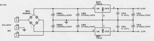

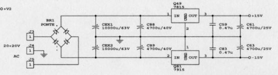

Peter Daniel said:BTW, this is the original PS that comes with a preamp.
yuck, those semi regulators.
Don't they sound positively grey and dynamically challenged?

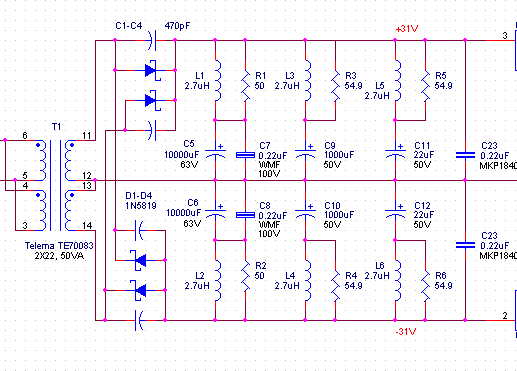

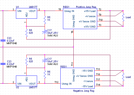

My last PS version from suggestions
From what I got from your suggestions, here the version that I will try first. First the section before the regulators.
