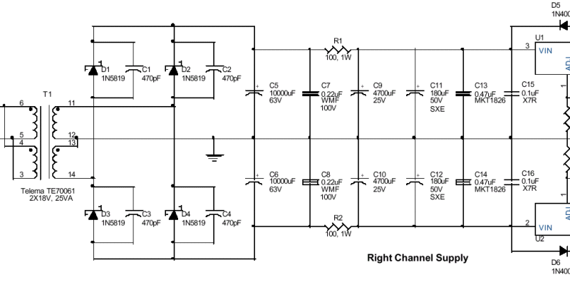

I'm about to begin my new Classe Preamp Clone and I want your comments on my Power Supply. This is what can probably be called an overkill supply, but I got most of the parts in stock. Let me know want you think and how can I improve it further.
I will post two parts of the gif picture (before and after the regulator). The complete pdf file will also be posted.

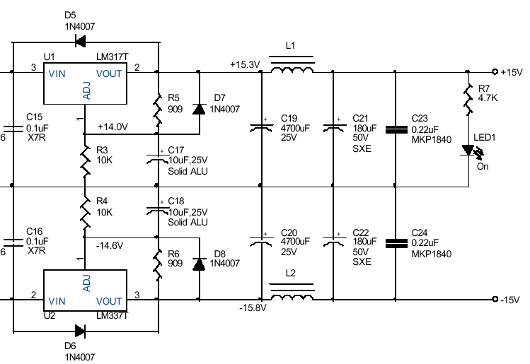

No, it is not an overkill at all. PS transformer rating is way too low to qualify as an overkill. Caps following the regulators are really excessive. 317/337 provide some kind of minimal acceptable sound quality in general, but it really matters what exactly are they going to power in this case (sorry, unfamiliar with Classe circuits). There are many fast opamp- pass transistor based circuits on this forum, which will beat a 317 unconcious. There are also interesting shunt regulators. If you do some search you'll find a wealth of regulator info here. Just curious: why a Classe clone?

I am not familar with the Classe preamp as well. I assume that it draws minimual current just like an ordinary preamp (see 100ma?).
a few observations:
1) the R1/R2 (100ohm each) seem to be awefully big. With good ripple rejection of the 317/337 regulators, you probably don't need them.
2) if I have to, I would put big caps after the LM, not before.
3) I think overall the circuitry is complicated (too complicated?).

did the datasheet recommend BG caps, gold-plated RCA, aluminum pads, or heatsinks dipped in dielectric oil?
Seriously, my thinking or guessing is that a regulated PS will have high transiant internal resistance (it cannot output a lot of current for a very brief period of time). Having a large "resevoir" after the regulator will help cure that.

But the caps are often useful for noise reasons.
Exactly.
And for most of their life the regulators won't have to regulate either.
It's wrong to look at this as a regulated supply, it is not.
The entire topology is exactly what I used in the PSU of one of my preamps, the juices come straight from the caps and the regs can be viewed as trickle chargers providing good isolation from the mains by the same token.

both designs are foundamentally flawed as it has more capacitance after the regulators, something even the datasheet does not endorese.
I don't know how much current a pre-amp draws (less than 100ma I guess?) but it cannot be too much. In that case, wouldn't it just be easier and cleaner to use unregulated one going through an R/C low-pass filter (with big caps)?
